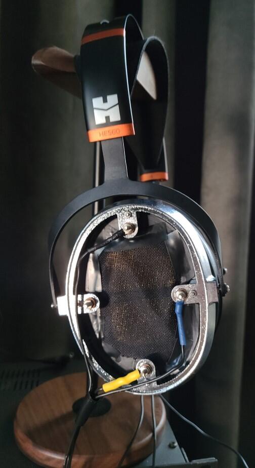

PolloLoco Posted September 6, 2020 Report Posted September 6, 2020 Thank you sir! As usual you're a scholar and a gentleman. I figured that by removing the PCB I divorced the two stators. I just verified it with my voltmeter, they're not connected. Is it possible that one of the stators is grounded, and that that might damage my amp? If so, can I just test by touching each stator with my voltmeter, and checking continuity with the cable? Edit: I just answered my own question. I remembered I had an extra driver, from the first broken pair of Koss ESP6 I had played with. So I busted out my voltmeter to verify that the top and bottom bolts are connected to different stators. The stators are not connected to each other once the PCB is gone. So my amp should be safe. The headphones might eventually die due to the high bias, but thats a risk I'm comfortable with. Quote

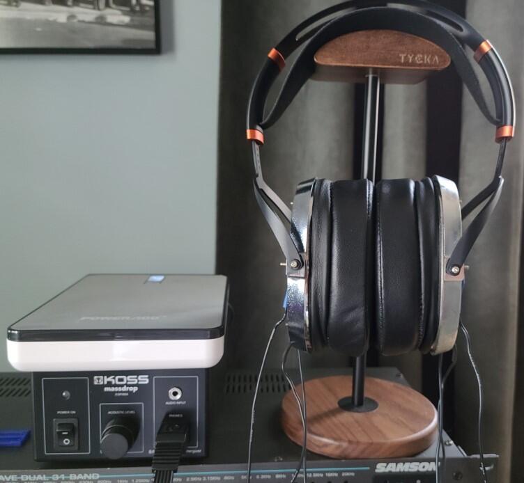

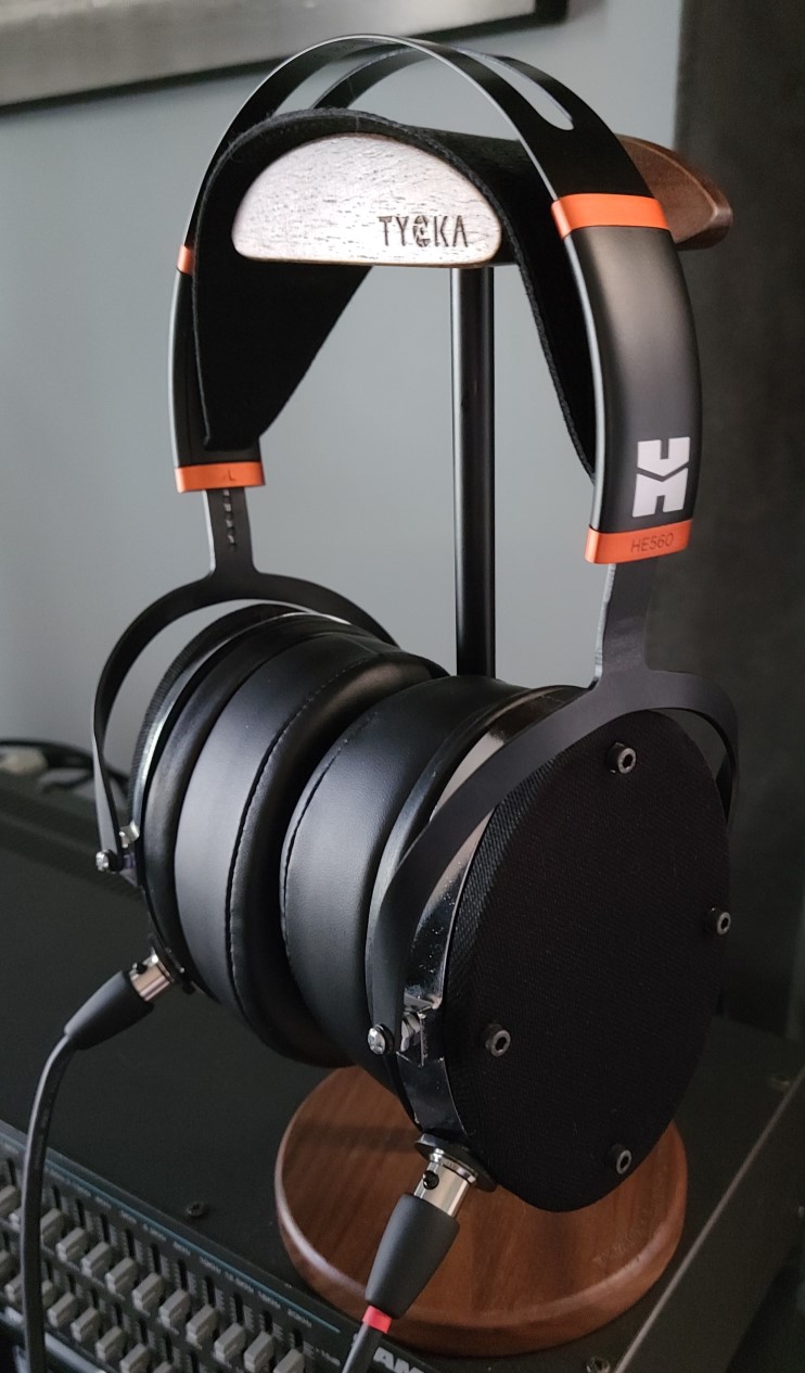

PolloLoco Posted October 9, 2020 Report Posted October 9, 2020 (edited) Here's a picture of my finished project. It's been super rewarding. I love the way they look. I had convinced myself that the ESP 6 conversion sounded better than my Koss ESP95X, but after a head to head review - that's definitely not true. Whether closed or open, or with the many different pads I've tried - I've been unable to get meaningful bass out of these. On a different note - I have the nagging feeling that when I went from my jury rigged cables to the removable Kaldas cables, I may have reversed positive and negative wires to each earcup. If so - if the positive wire is going to the back stator and the negative is going to the front stator - would I be able to hear a significant difference? Edited October 9, 2020 by PolloLoco clarification Quote
