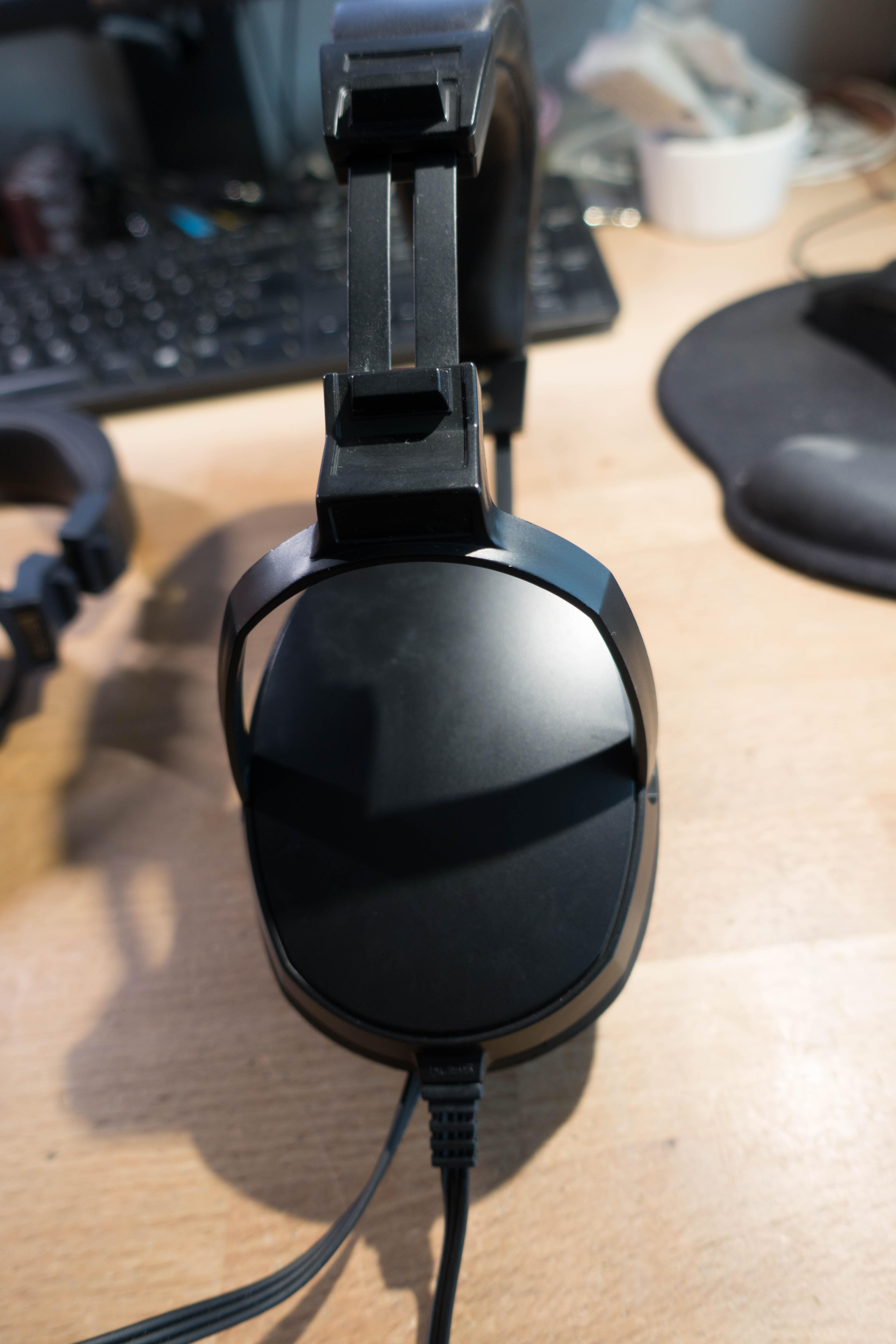

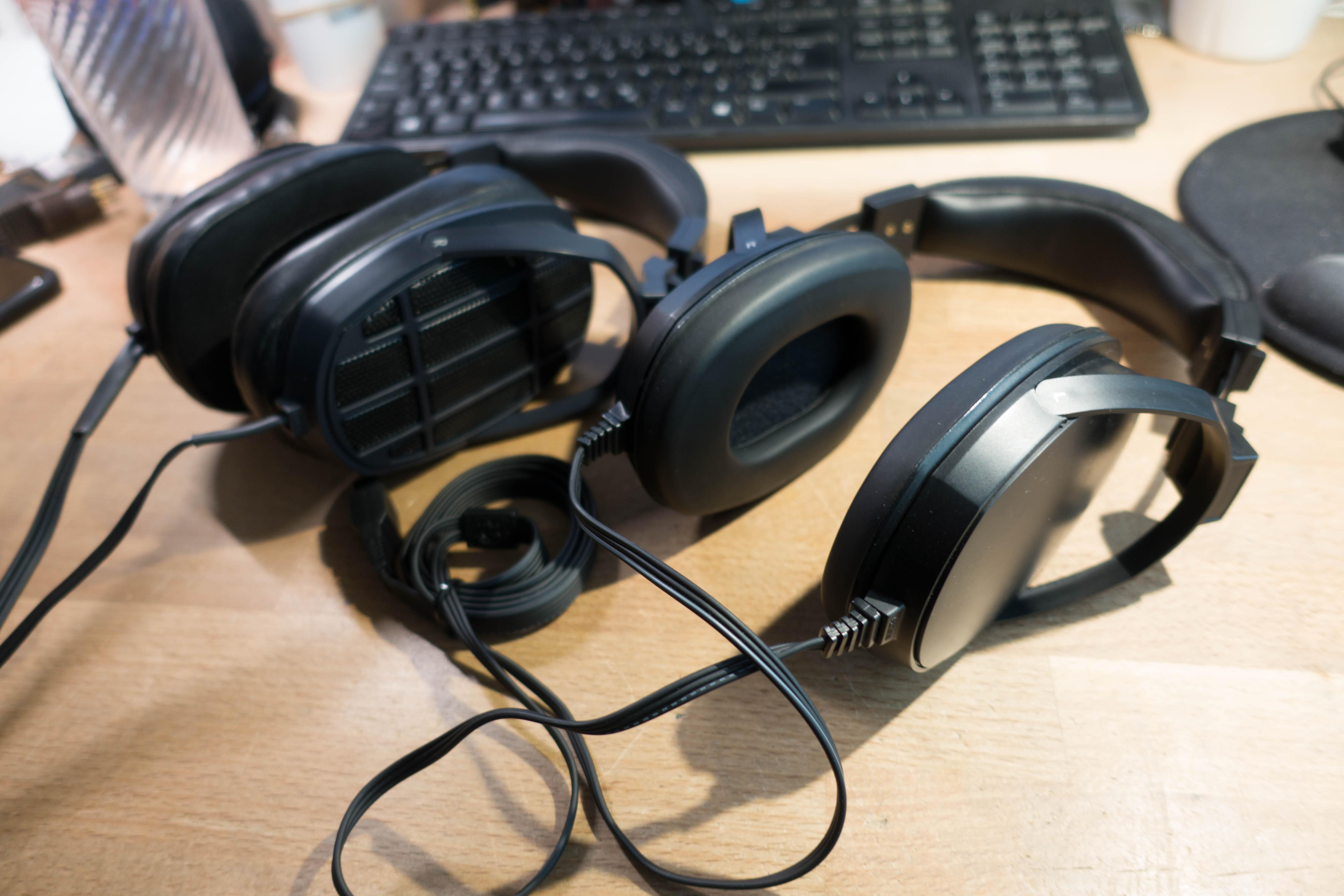

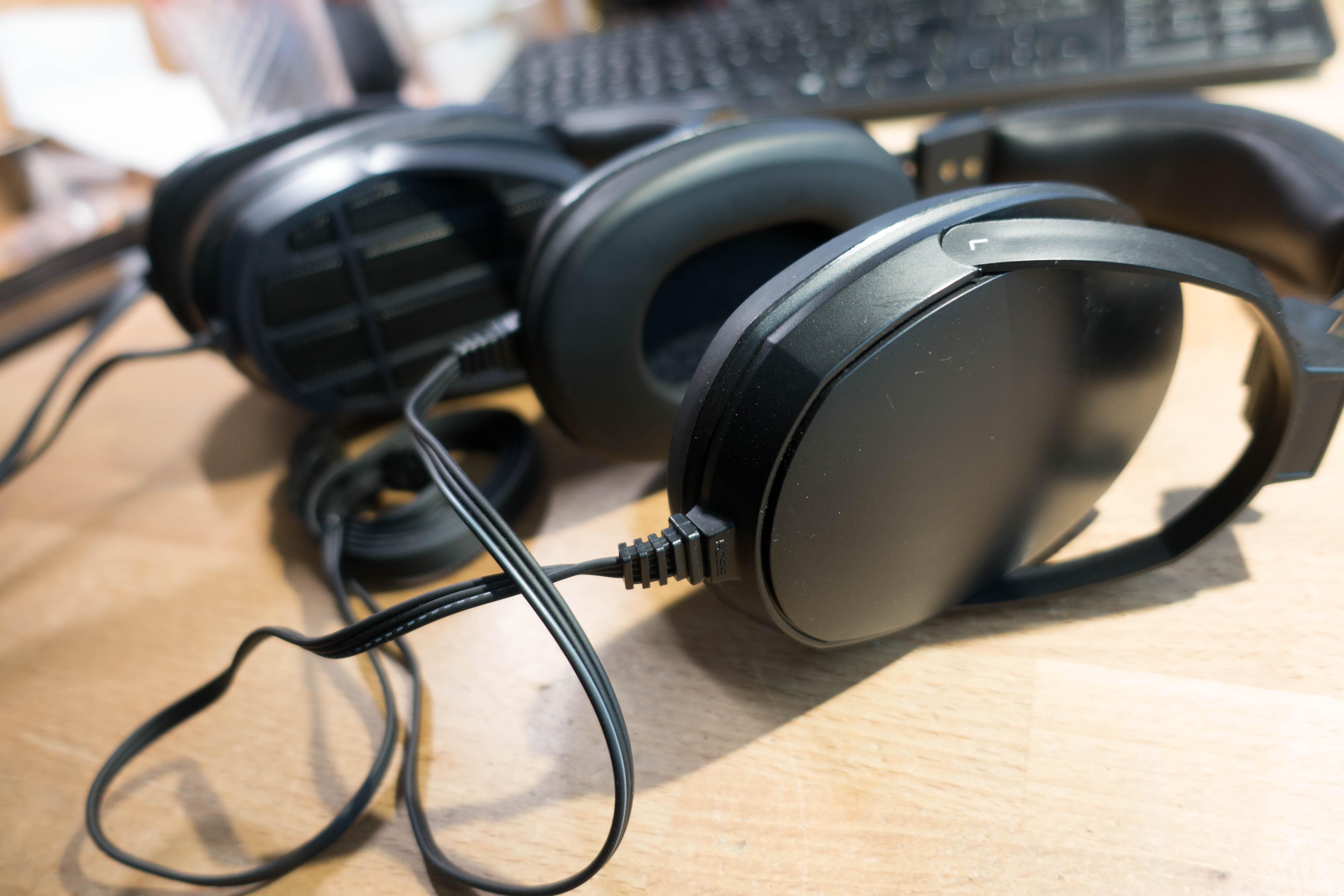

spritzer Posted May 31, 2019 Report Posted May 31, 2019 Now for something pretty rare... the ESP900... This is the closed back version of the ESP950 made for medical use such as MRI's etc. Not much is known about these and only a few sets have ever surfaced. I'll do a more indepth post about these when I modify them and dig into them a bit. Stock...well...they don't sound good. The earpads are unique to these so when you press them to the head...the sound gets better but it is no 4070...that's for sure. 10 2
