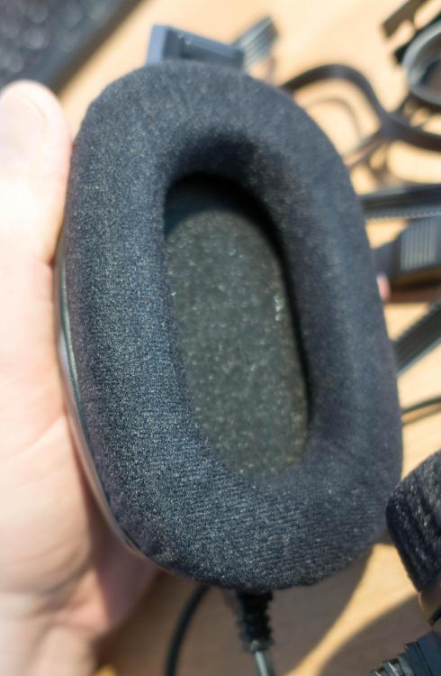

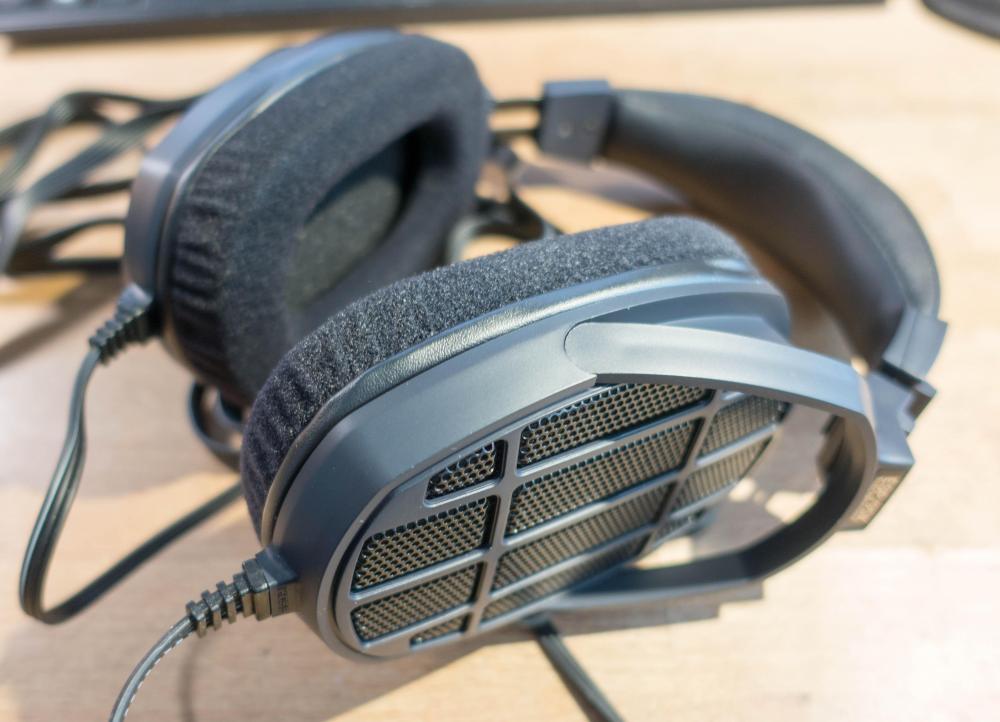

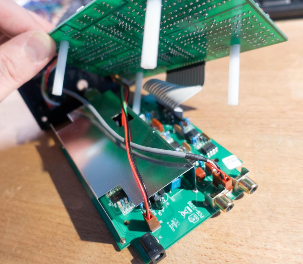

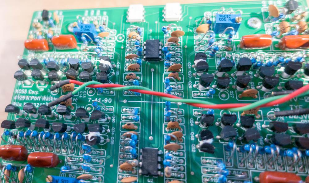

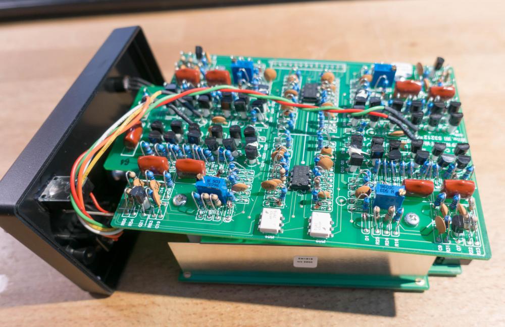

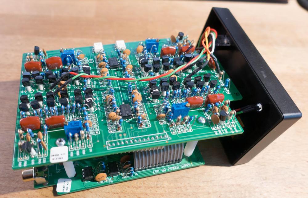

spritzer Posted March 15, 2019 Report Posted March 15, 2019 So I've had the Massdrop version of the Koss ESP/95X sitting here for probably a month but not spent any time with them. I know I'm awful... That changed today so first some pics: Let's start with the any real change from the stock Koss version, the earpads: Now the stock pads are terrible but these are somehow worse. Cheap and nasty fabric covering the same nasty foam...yeah they went into the trash. Get some Vesper earpads but more on that later. As for the amp, well here are some internal pics: This is the same as the last unit I opened, stock 1990 amplifier board but the new PSU board. It's the same circuit, they just had to update it for new parts such as the new nasty volume control. Now for some impressions of the phones. The cable situation is the same as before, rather short cable and then they supply an extension to make up for it. As if anybody is ever going to use these as portables... So I ripped out the stock cable and fitted a wide PC-OCC Stax unit and angled Vesper earpads. I also removed the foam they have on the baffle as the Vesper pads come with some dust protection. Now this is more like it, here is the true king of budget headphones. Granted you have to spend the 500$ for the set and another 200$ for new cable and earpads but that's still the same as Monoprice is asking for their very mehhh set. The angled Vesper pads I got were a custom order and they really add something to the set. The imaging is improved and the slightly smaller cavity really helps them spring to life. They are a tiny bit top heavy now but that helps them really, makes them feel more alive. All in though, very much recommended and nice to see this 30 year old design still shine. One small caveat though, this set which is one of the first from Massdrop did ship with some dust inside the right driver so they are no noise free. One kinda expects that from the ESP950 though so it doesn't bother me too much. 6 1
