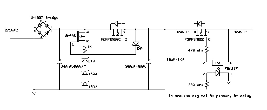

What regulator are you referring to? I'm not having much success right now finding something suitable. I am attempting to modify the transformer output version to use 45 DHTs and so far its a few pages of hastily scribbled schematics.
I've copied BH zener regulated PS to use for a DTH 45 (ignore the B+ delay/FDA217, I got an unpleasant thump).
Edited by Skooby
Hm hm hm hm, I will have to fool around with this. Many thanks!
