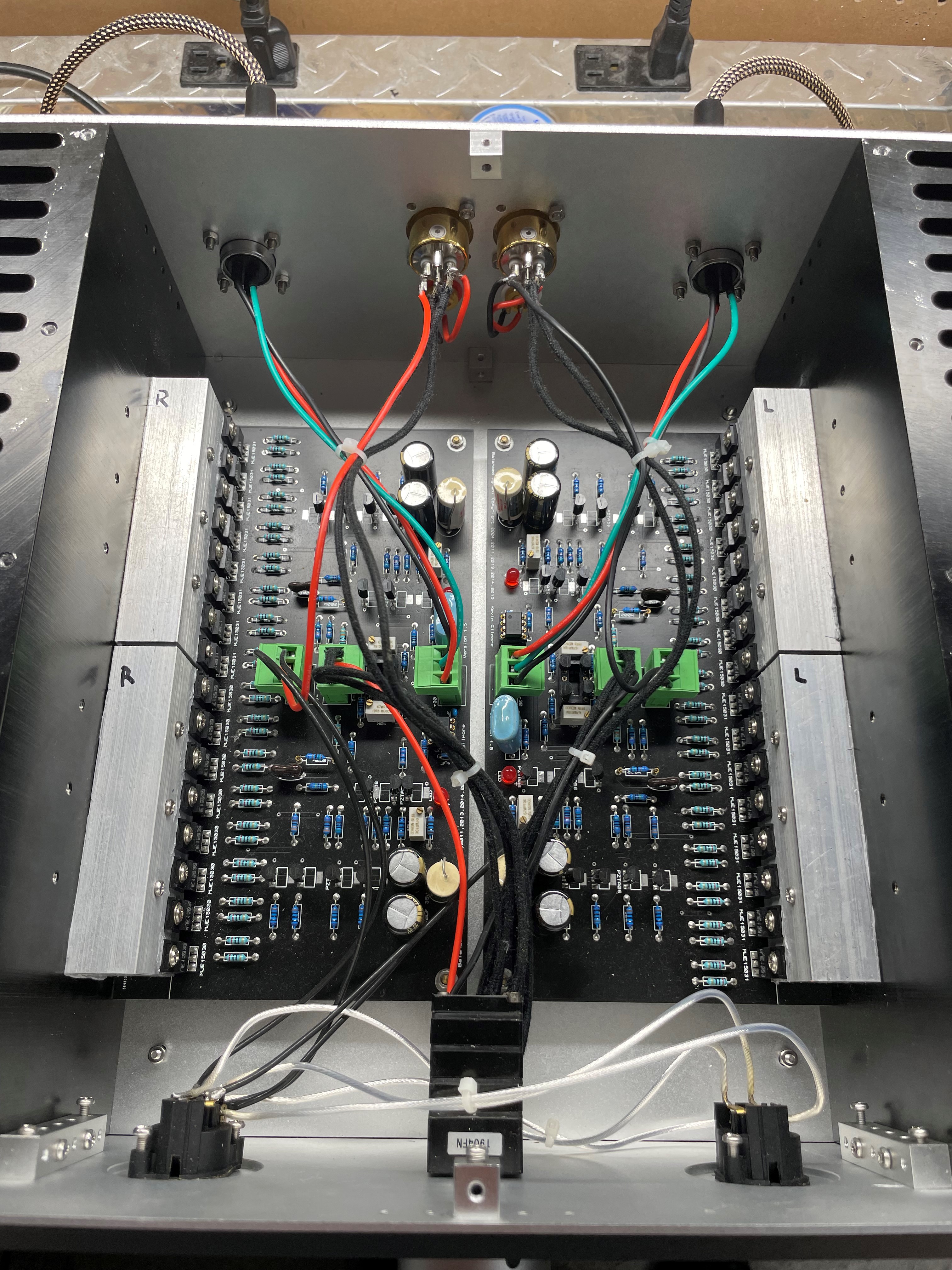

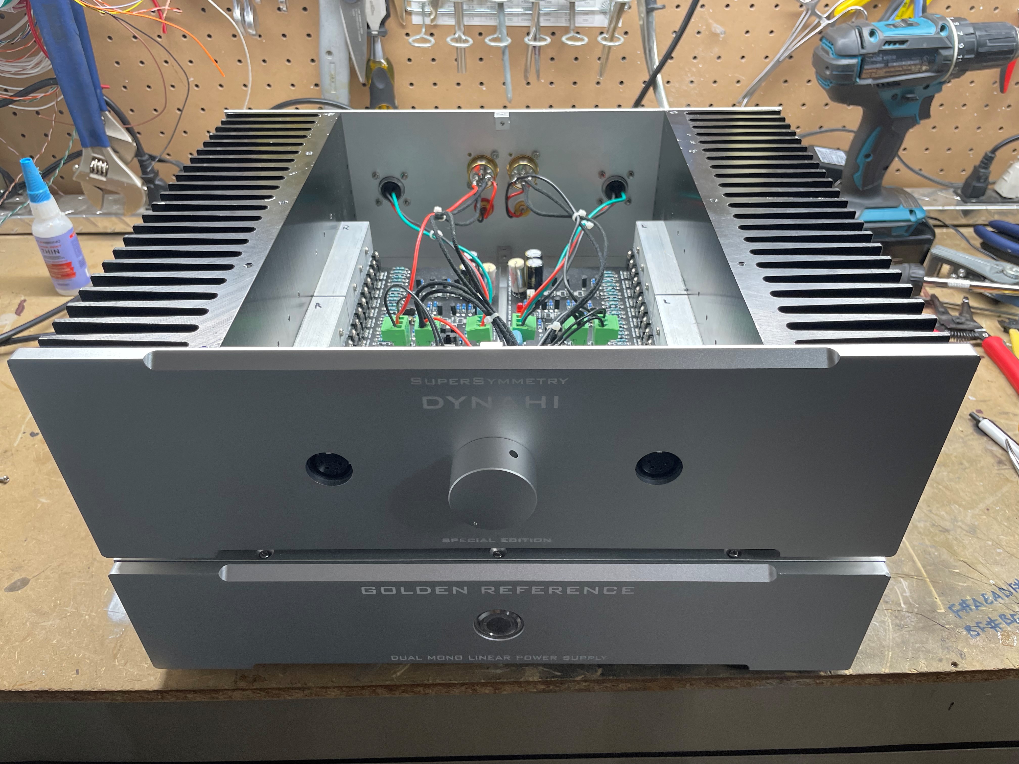

Satyrnine Posted February 16, 2023 Author Report Posted February 16, 2023 I should add I realize I don't NEED a Dynahi for LCD-2's low impedance, but my bud has said that it's a fantastic pairing regardless, and will let me try higher imp cans later on. My Darkvoice mods (usually ideal for 600ohm cans) were all about making it work for lower imp cans. 5998a output tube, higher B+, drastically increased output cap value, etc. Attached are pics of the Dynahi I biased/balanced for my bud. Quote
