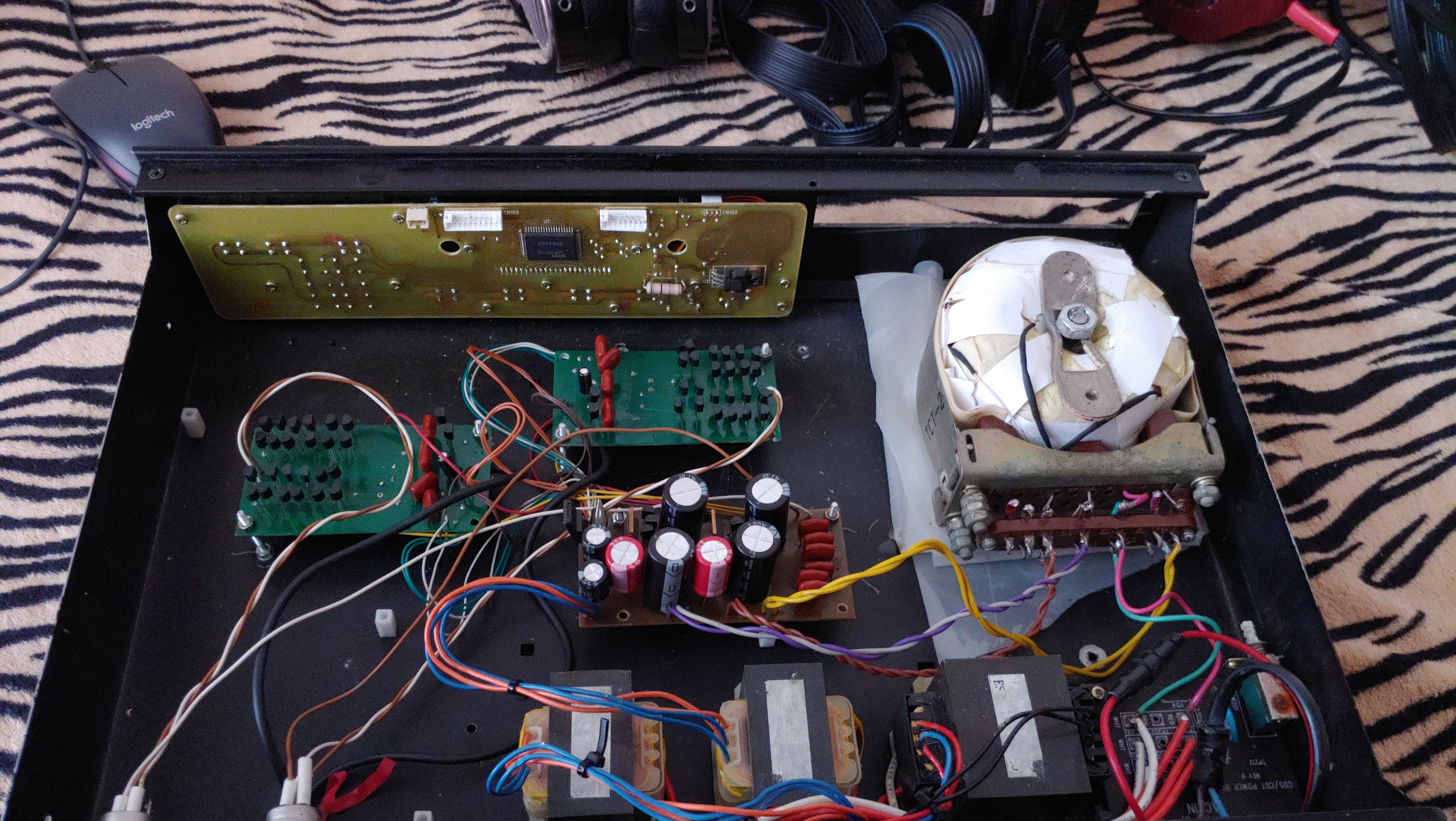

kevin gilmore Posted February 16, 2023 Report Share Posted February 16, 2023 (edited) you mean like this there was another koss circuit on ebay from a guy in ukrane, i did not save that picture. it was even worse. the soviet era toroid transformer is a real gem. Edited February 16, 2023 by kevin gilmore 2 2 1 Quote Link to comment Share on other sites More sharing options...

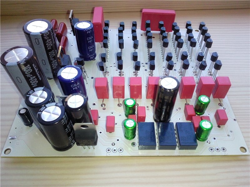

kevin gilmore Posted February 17, 2023 Report Share Posted February 17, 2023 here is another koss circuit. this one seems built better. Quote Link to comment Share on other sites More sharing options...
spritzer Posted February 22, 2023 Author Report Share Posted February 22, 2023 The Koss unit draws 9W from the wall, max so factor in PSU losses, very high rail voltages, that you driving 4 amplifier channels and yup, there is not a lot of power there. So Woo has a new electrostatic amp out, WA7e... who wants to guess that it is a tube pre driving some Apex modules? 1 Quote Link to comment Share on other sites More sharing options...

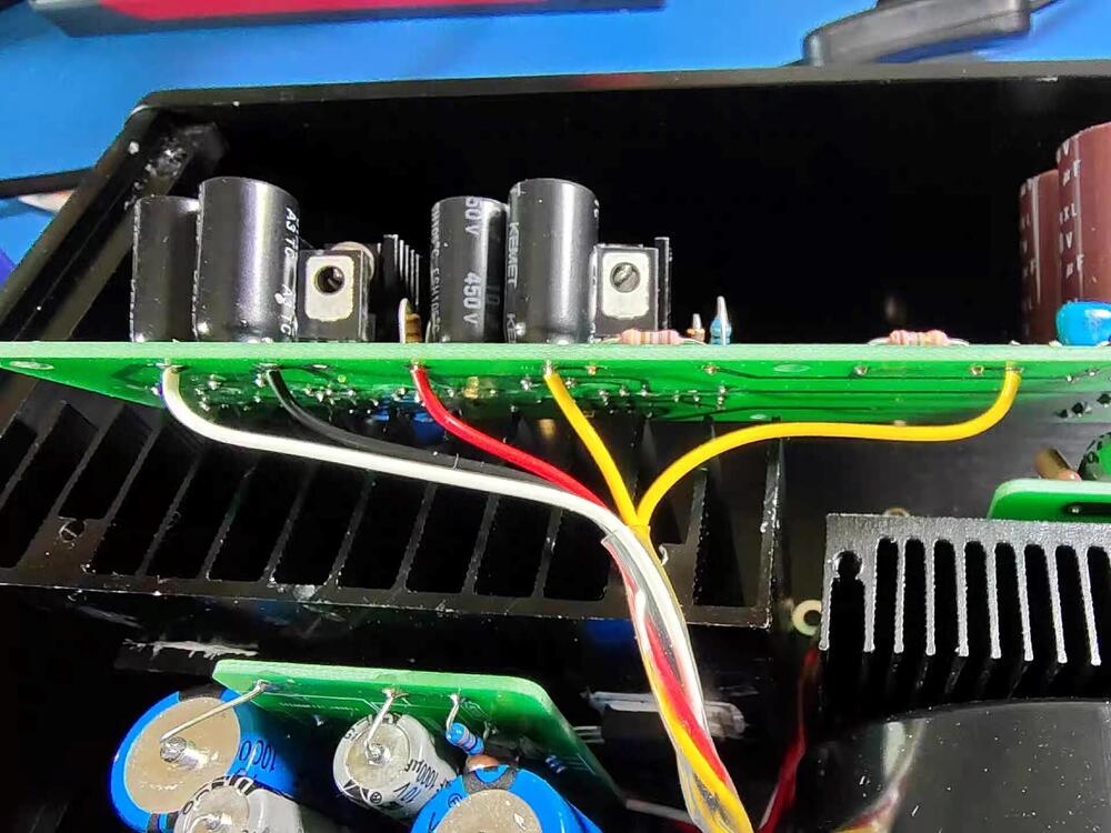

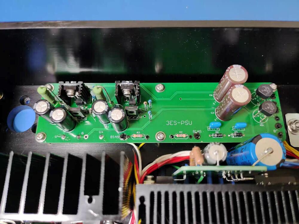

kevin gilmore Posted February 26, 2023 Report Share Posted February 26, 2023 Contrails said: @Ciggavelli did you ask Woo about their 3ES amp and their false advertising? I did. He confirmed it’s not a 300B output. He said the 300B isn’t powerful enough so it needed a Mosfat for the output, but I’m not really sure what that means. reference: CanJam NYC 2023 Impressions Thread (February 25-26, 2023) | Page 16 | Headphone Reviews and Discussion - Head-Fi.org so lets be specific 1) mosfet for output. lets rephrase that. 4 x apex class C high voltage power opamps. 2) 300B not powerful enough? pair of tubes is good for 18 watts. more than enough to damage your hearing. All of my tube designs that use el34 you can substitute emission labs 300b. with an adapter and extra filament transformers. Works great. plenty of power. including bh, gg, t2 and megatron. and justin's grand cayman. just because jack does not know how to correctly design amplifiers with 300b... 6 1 3 Quote Link to comment Share on other sites More sharing options...
