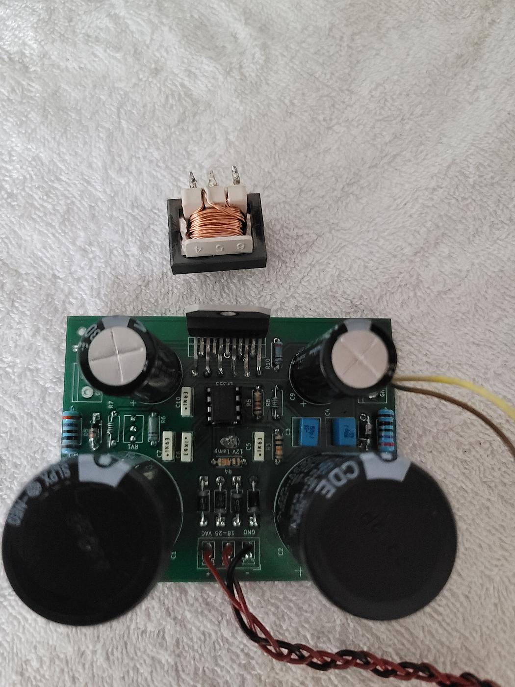

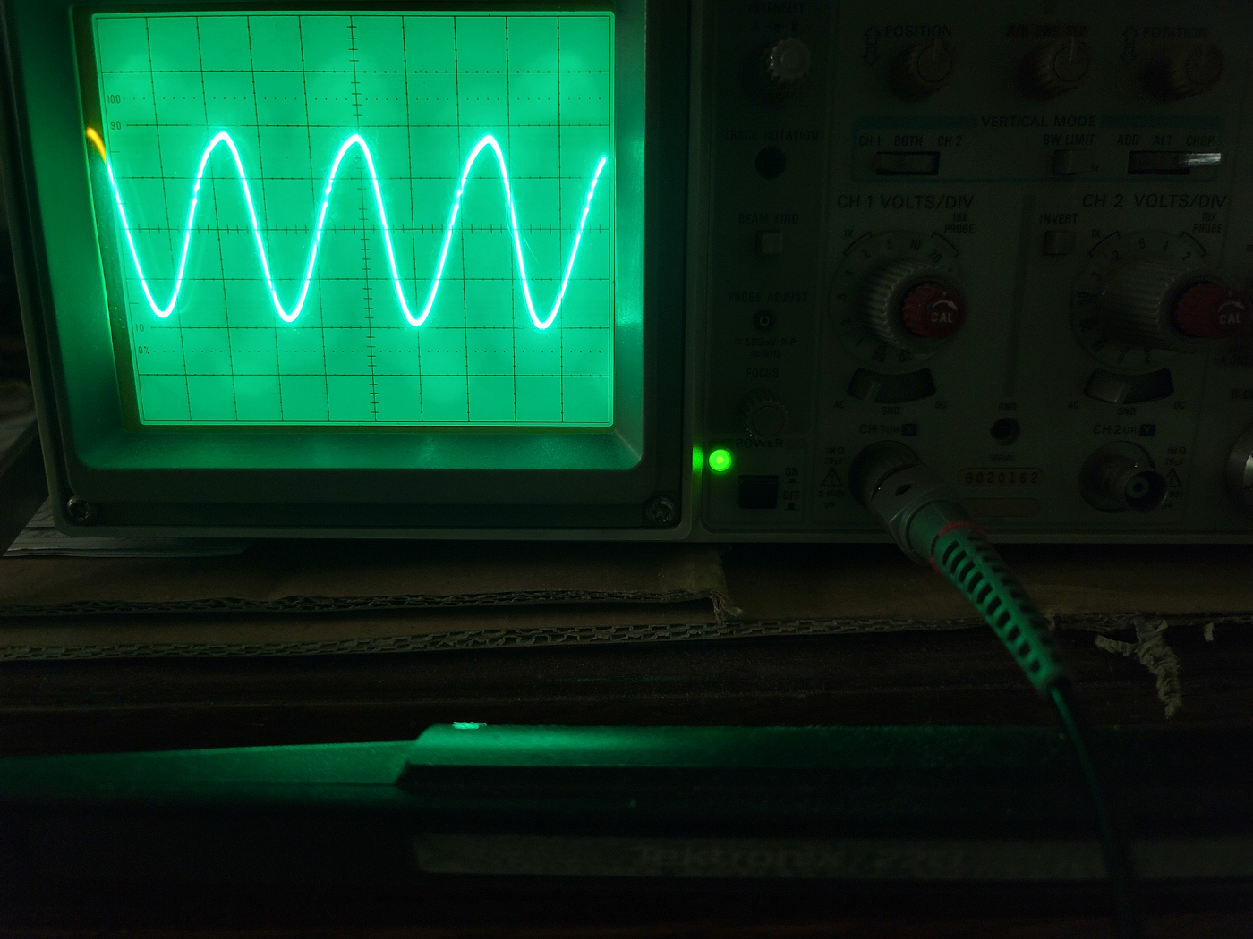

Skooby Posted January 27, 2024 Report Posted January 27, 2024 Thanks Dr. Gilmore, Got a pbc made from the schematic. Played around with R1=120-ohm to get a good-enough sinusoidal wave; adjusting R2 and R3 to 10K to get 76kHz wave. Hand-wounded trafo, not pretty but does the job... 1 Quote
