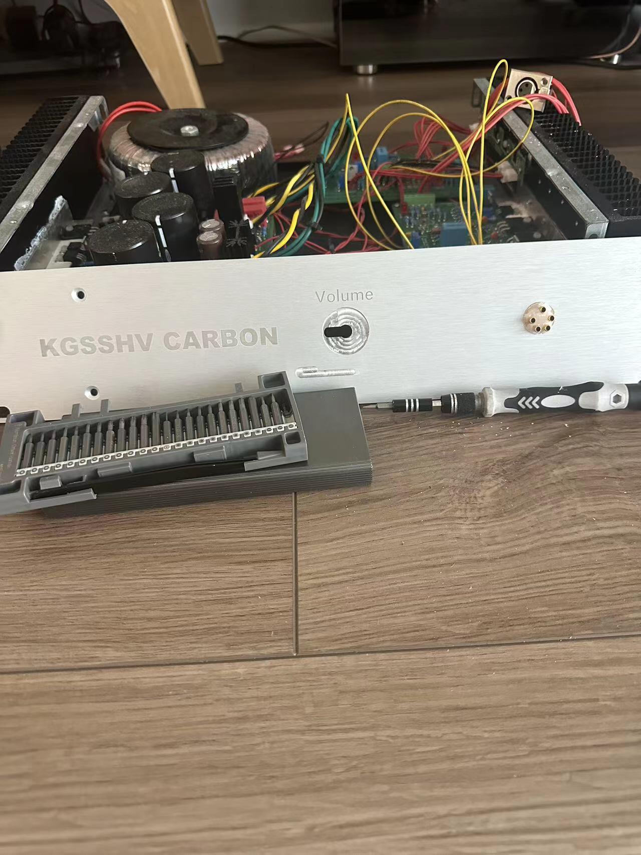

    I got bored waiting for the replacement bolts to arrive and so purchased my own and finished installing the missing bolts. Here is my first CNC project: Making my own Stax 5 pin sockets usin

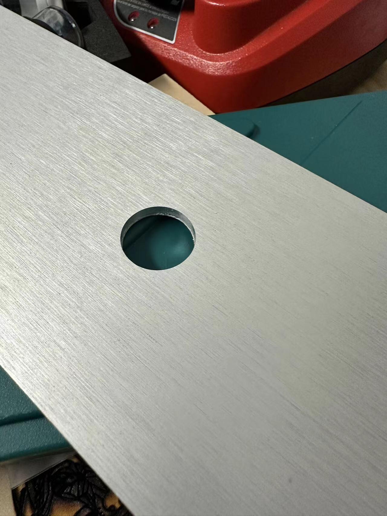

  • First attempt at a complete front panel. Single flute 6mm end mill and 0.1mm V bit used. Depth of cut 0.02mm on the engraving. I also used tape and CA glue as the hold down method for the first time -

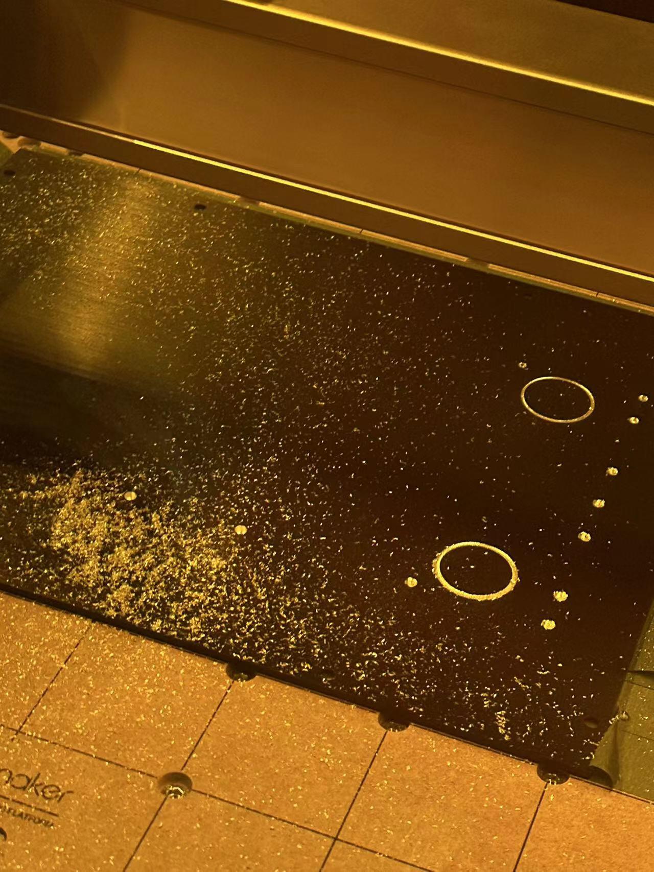

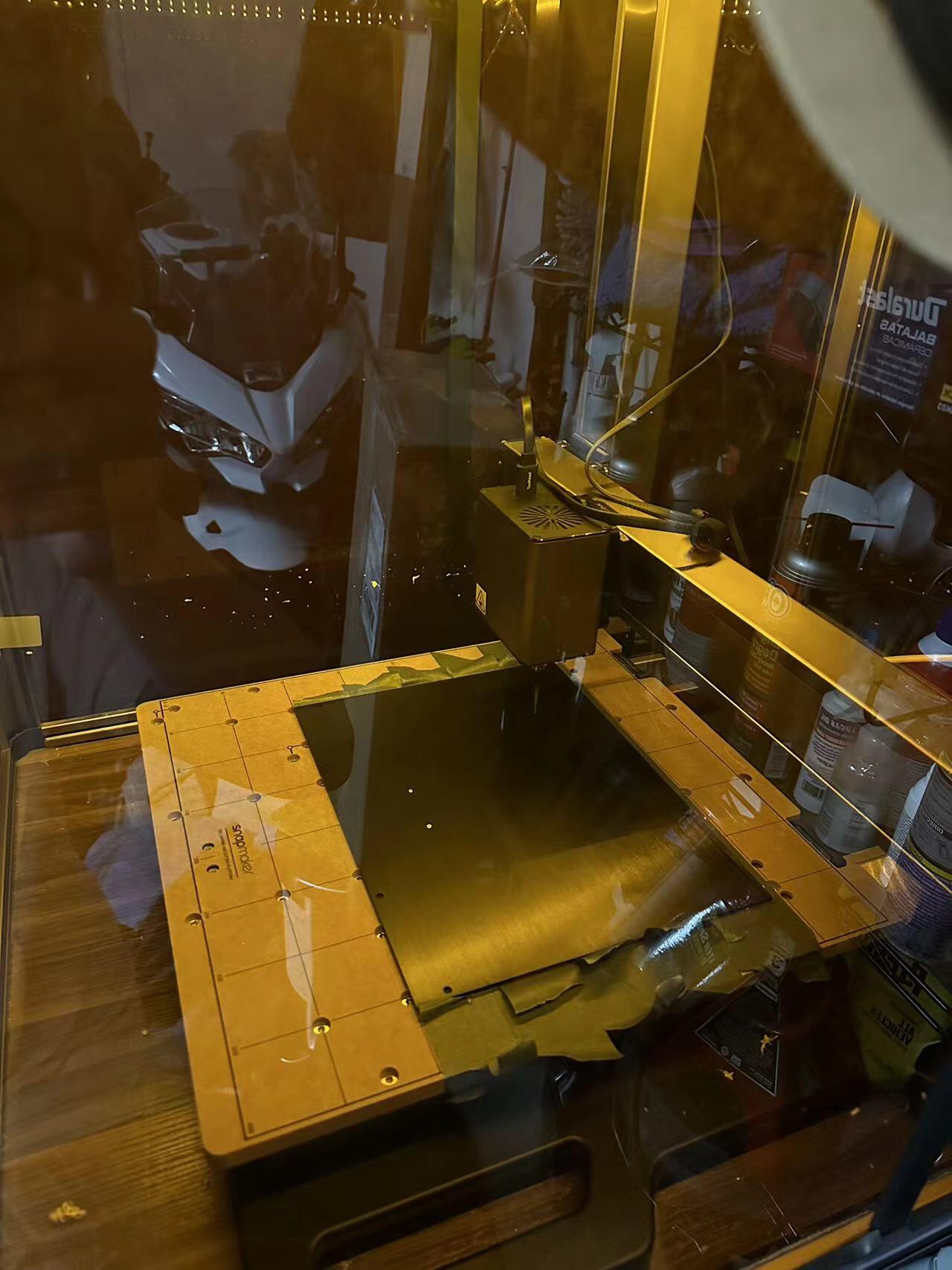

Another option for the desktop CNC machine that I purchased from Snapmaker works as well.
The working space makes it easy to fit the whole chassis unit with the enclosed cover.
It has two different laser modules that work perfectly for engraving.
I have some pics shown while I was working on the GG upper and front panels. Milling the holes for tubes, Stax jack, and screws. I settled the speed to 100mm/min and 0.1mm step which gave me the balance of speed and a nice outcome. The bit is from Datron, 3mm Single Flute End Mill. I have another 2mm ball end bit from Snapmaker which I also used for milling the M2-size screw holes. The only complaint about it is the limited 200W CNC power which does not allow the drilling process. The 8nm laser module is the most satisfying. Easy to manage and nice outcome for the front and back panels engraving.
