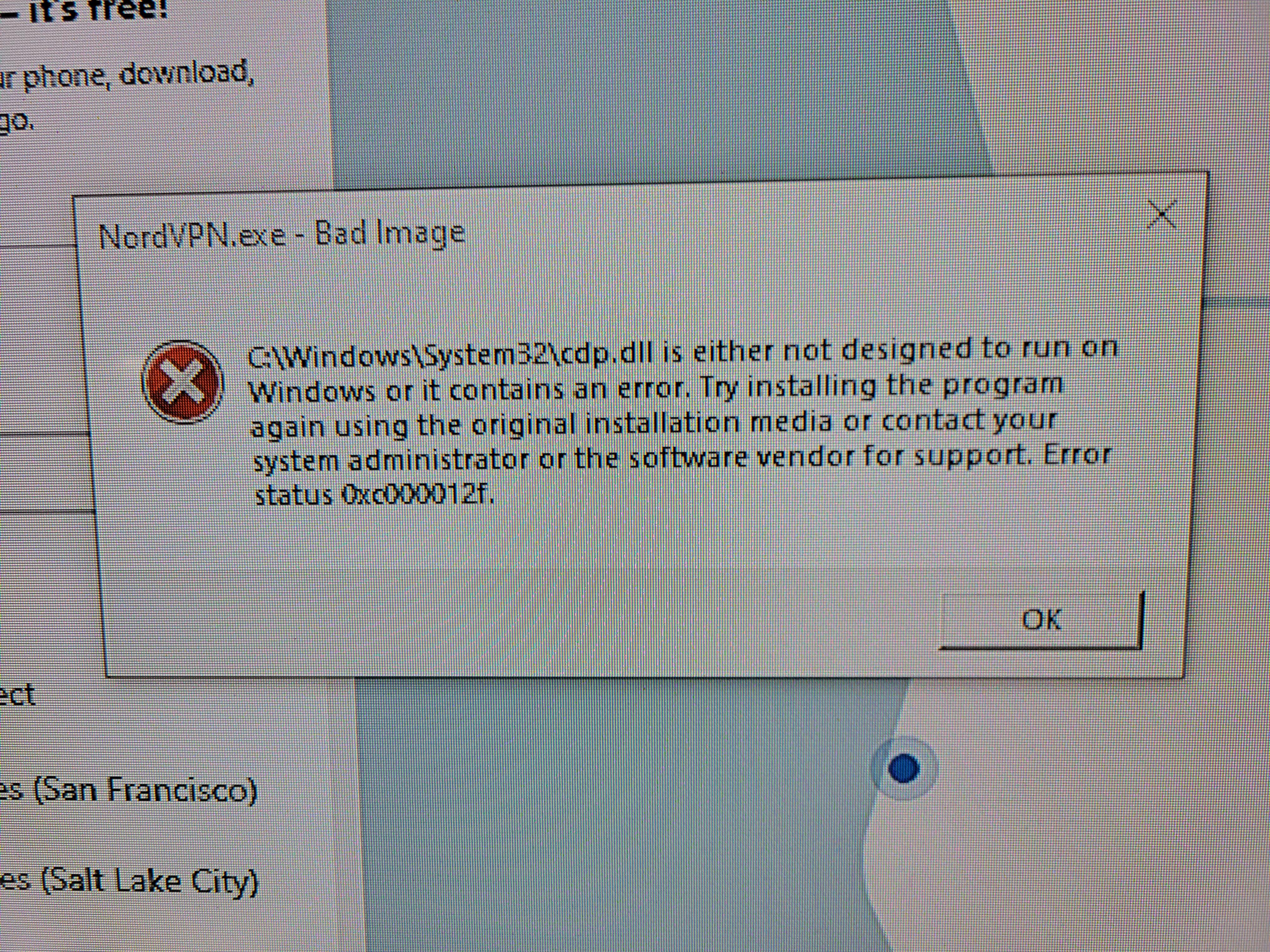

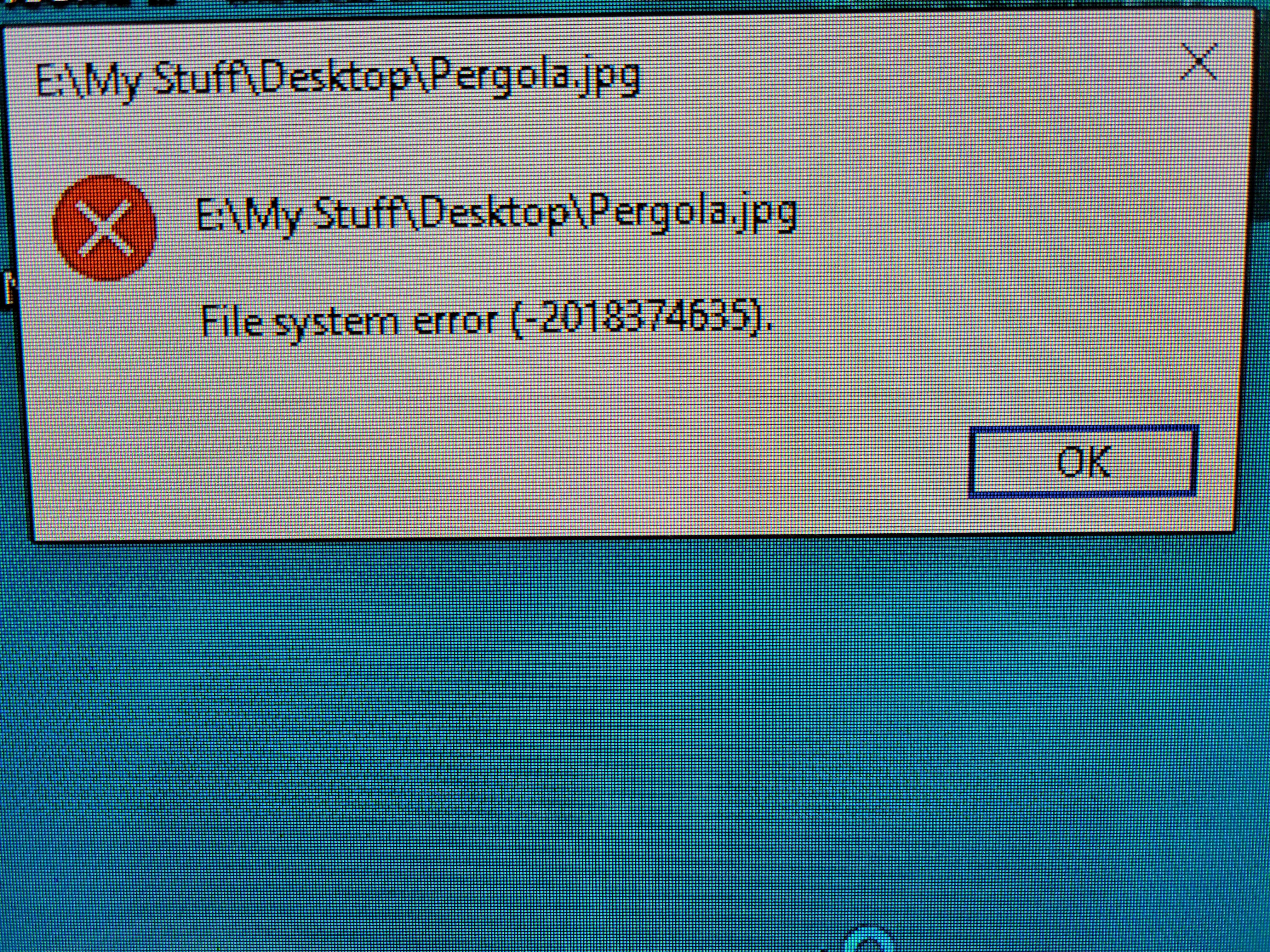

Augsburger Posted March 19, 2022 Report Posted March 19, 2022 Well it seems microsoft has done it again to me. For years off and on I have had problems whenever microsoft has done an update and it would screw up everything. This time in early February there was some type of update that FUBARed my whole computer. First I suspected it was the NORD vpn update but I deactivated it and there was no difference. The problems are- I cannot access any apps. The startup icon and search bar do not work, When I hit startup button+R, I can see the HDs with some documents but no apps, MS Office, Windows Accessories etc do not appear on the HD tree, When attempting to pull up saved docs I get error messages which makes me think that somehow the links to the apps were corrupted or vanished, What "fixes" I have attempted so far- Since my computer skills are as limited as my woodworking and amp building skills I have just stayed with the basics. Restated the computer, shut the computer down and turned it on, attempted reloading Win 10 Pro from disk. I cannot roll back the computer updates because I am unable to access any apps which limits options for further trouble shooting. Screen shot of error messages - When attempting to pull up old jpgs from my desktop I get this error message causing me to suspect the link to my apps was corrupted. Any ideas or suggestions? Hopefully there is a solution other than doing a complete wipe of the main drive and reinstalling Win 10. BTW when I searched MS they stated that my system was not compatible with Win 11. Thanks for any advice. 1 Quote
Iron_Dreamer Posted March 20, 2022 Report Posted March 20, 2022 Boot from a windows install disk/key, and choose command prompt. Enter "sfc /scannow" without quotes, and see what that does. It's also possible that you have disk or memory corruption that manifested independently, but coincidentally, with the Windows update that precipitated this issue, In which case your hardware is bad and would need to be examined/replaced. You could make a boot disk of Memtest86 to check your RAM for corruption issues. 1 Quote
Augsburger Posted March 21, 2022 Author Report Posted March 21, 2022 Unable to boot from disk. Tried the sfc/scannow but nothing happened. It appears all apps disappeared from HD. I think I am fooked, probably some hardware issue. Quote
Iron_Dreamer Posted March 21, 2022 Report Posted March 21, 2022 Hard to say without looking at it, but it certainly sounds like a failing disk drive to me based on what you've described. Quote
Augsburger Posted March 21, 2022 Author Report Posted March 21, 2022 Looking more like it as I try too trouble shoot. Time to shop for new hardware. Quote
n_maher Posted March 22, 2022 Report Posted March 22, 2022 Would be interesting to know if it’s corrupted hardware or OS that’s plaguing you, Greg. Any ability to pull the drive and try to mount it as an external and see if data recovery is possible? The fact that it’s just the apps that disappeared have me thinking more software than hardware. Quote
Augsburger Posted March 23, 2022 Author Report Posted March 23, 2022 Great idea Nate, I thought about that a while back but forgot along the way with all the other things going on here. Seems to me it was a software issue but I can't imagine why just the apps disappeared. I tried reloading Win 10 multiple times which should have yielded some progress but not so. I will pull the HD's later this week and try to see if any data can be recovered. I have not had any success finding anyone with a similar issue due to updates. Quote
n_maher Posted March 23, 2022 Report Posted March 23, 2022 Greg, I looked into this a bit and it sounds like it could also be an issue related to your account. You might trying signing out of M$ (on the PC) and back in to see if that triggers anything. There are a few support articles related to this but not knowing the apps that you’re talking about and whether or not they were purchased direct from M$ or if you mean programs you downloaded/installed. Also, I think the start button and search function being offline point to a smoking gun internal to the Win10 shell, not hardware. http://woshub.com/start-menu-taskbar-search-not-working-windows-10/ If you haven’t tried some of the suggestions in that link, you might try. My bet is a corrupted registry key as that can turn the whole cart upside down and if you can get that to regen you might get back to a workable state. But I also find that when Windows has effed itself this badly the best solution is to grab all the data that you need from the HD, wipe, and start fresh. 1 Quote

Augsburger Posted April 27, 2022 Author Report Posted April 27, 2022 Nate, you are partially correct. Out of frustration I cleaned the cache, logged out of MS, reset the password, utilized various MS online trouble shooting links which did nothing but load tracking cookies, turned off the computer then booted from disk. It worked, things are back to the way they were. I hate Microshaft. 1 Quote
