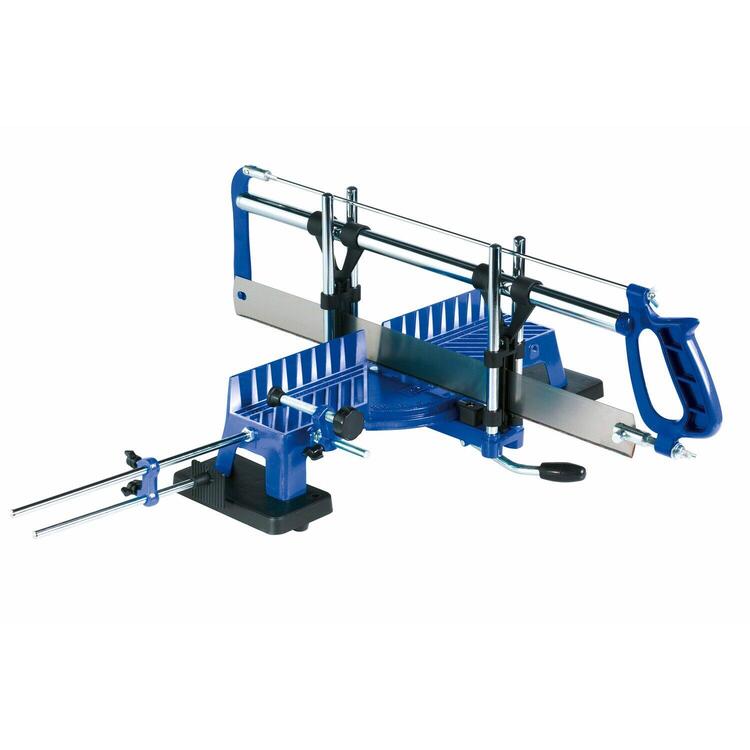

Pars Posted March 27, 2022 Report Posted March 27, 2022 Nice! A couple of questions: How do you guys cut the angle brackets so nice and clean? What are those test point pins used in the boards? Do you have a part number/source? Thanks! Quote
audiostar Posted March 27, 2022 Report Posted March 27, 2022 (edited) Hey Pars, these are Mill-Max p/n 4275-0-00-80-00-00-08-0. There are different sizes available. For bigger holes check Mill-Max p/n 4357-0-00-15-00-00-03-0, take a look at the catalog, there lots of options. Something like this will cut you perfect right angles, cost around $20 or so. You can then make a wooden base for it (attach instead of the black plastic parts) and clamp it to a table to make it rock solid. Edited March 28, 2022 by audiostar Quote

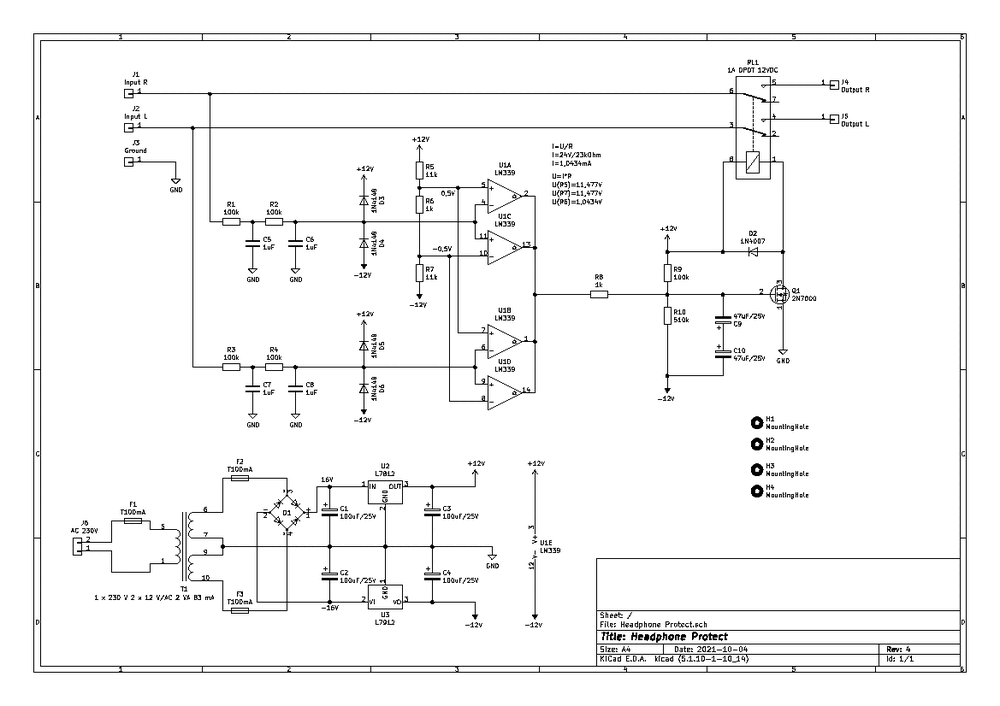

AlexS Posted April 3, 2022 Author Report Posted April 3, 2022 (edited) After having double checked that the input voltages to the 78/7912 are within limits (max 35V)... measured 31V, I added the remaining 7812 and 7912 to generate the supply voltages for the protection circuit. And modified my prototype so that it no longer needs a individual power supply. The audio 50Hz humm also went away after I no longer crossed the audio input lines with the 230V power cord!! Edited April 3, 2022 by AlexS 1 Quote

AlexS Posted April 16, 2022 Author Report Posted April 16, 2022 Easter update... a friend of mine has a 3D-Printer: And this is what those parts are for: There will be an additional PCB mounted on top of the volume pot that will also serve as wiring distribution and protection circuit. I will only need tapped holes to the heatsinks, all PCBs are otherwise held in place by the plastic spacers. 5 Quote
