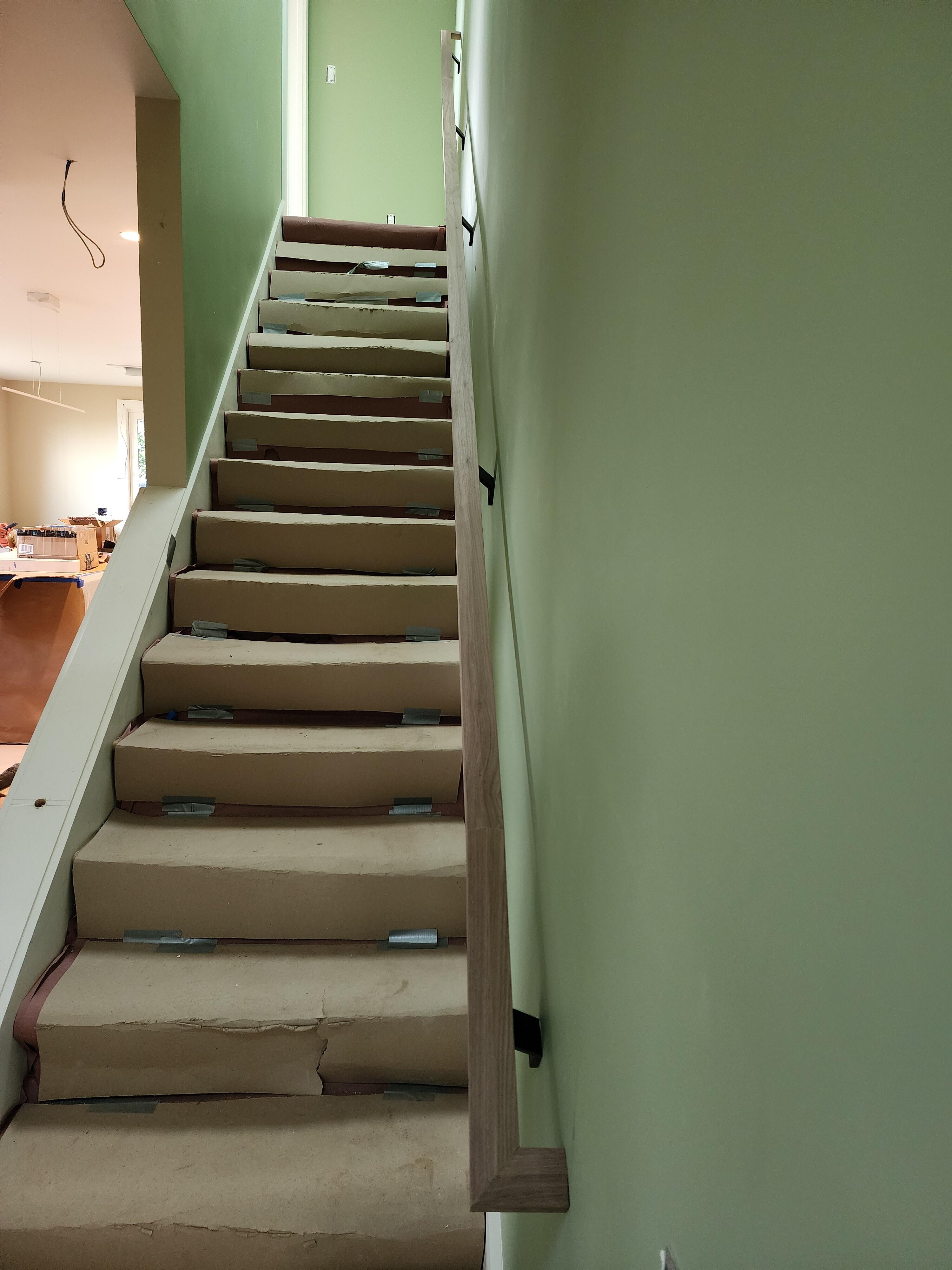

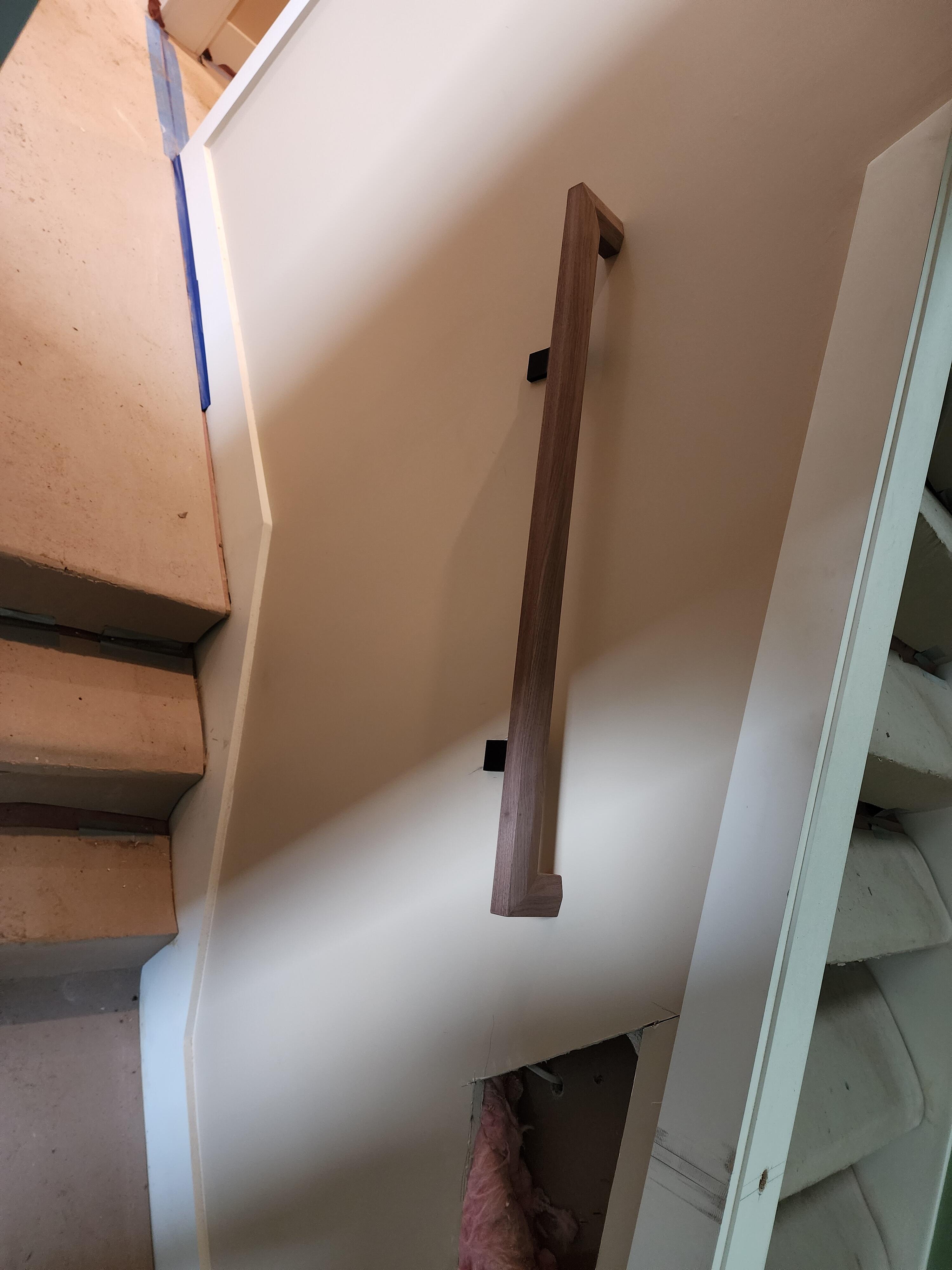

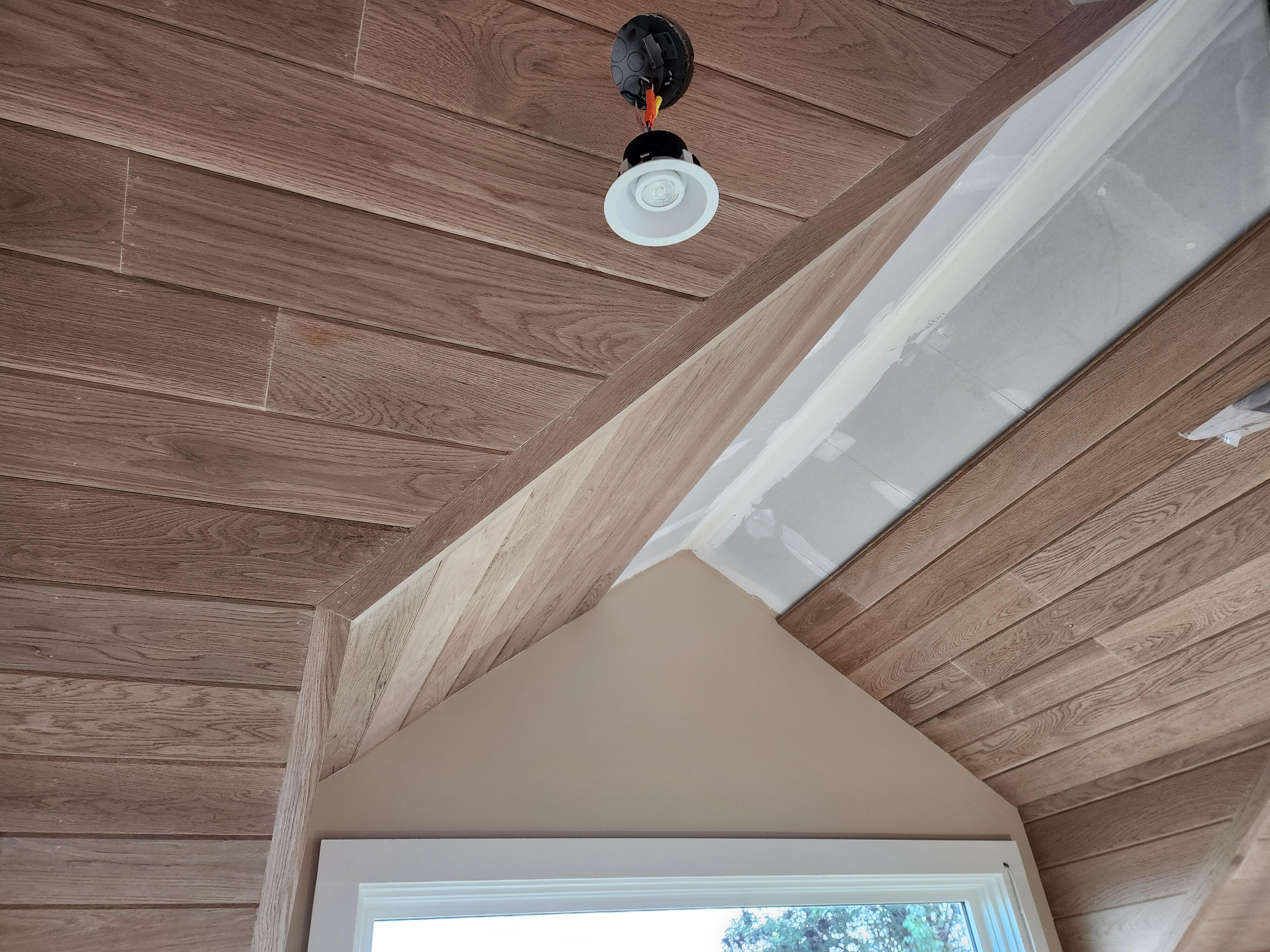

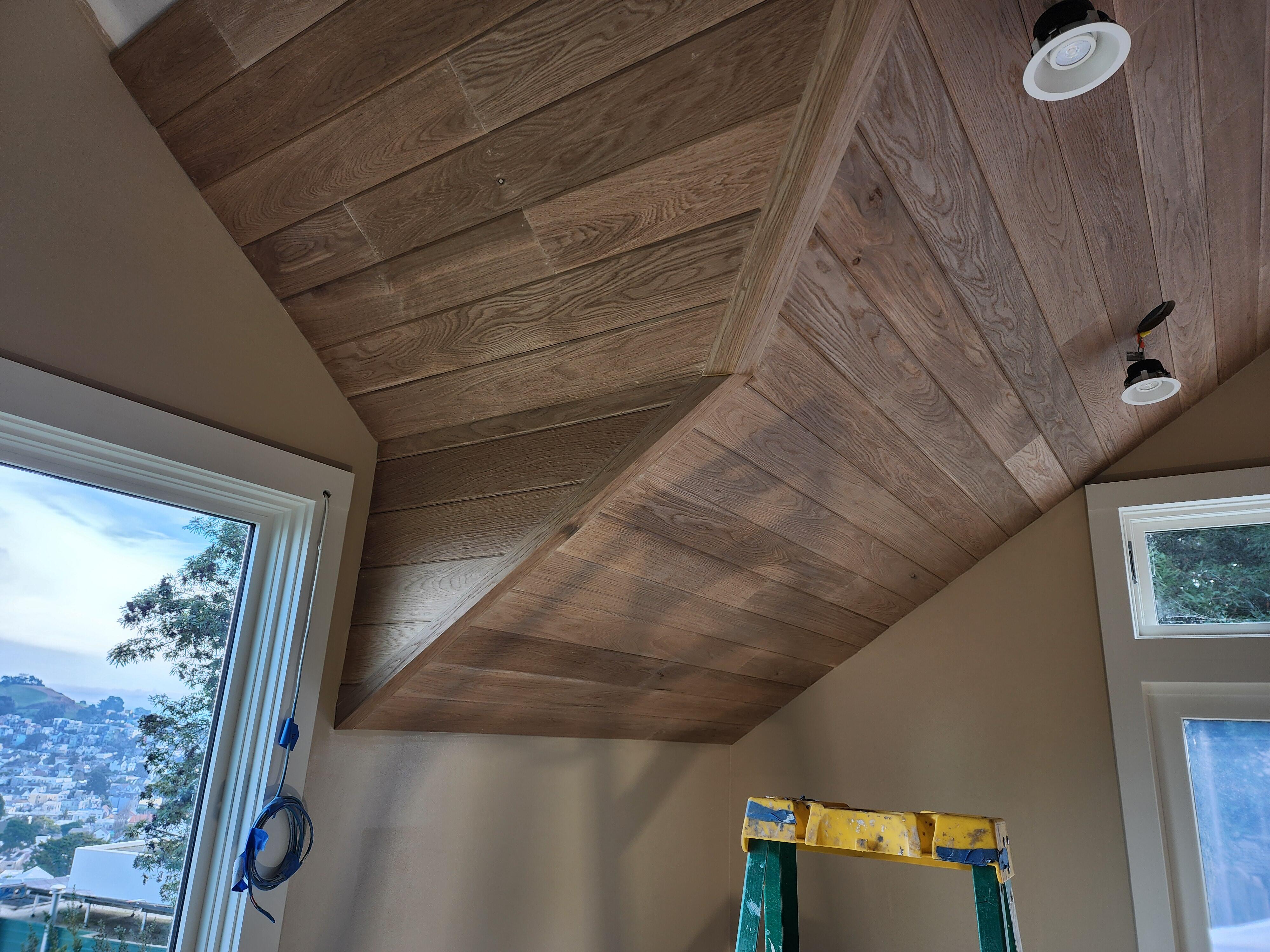

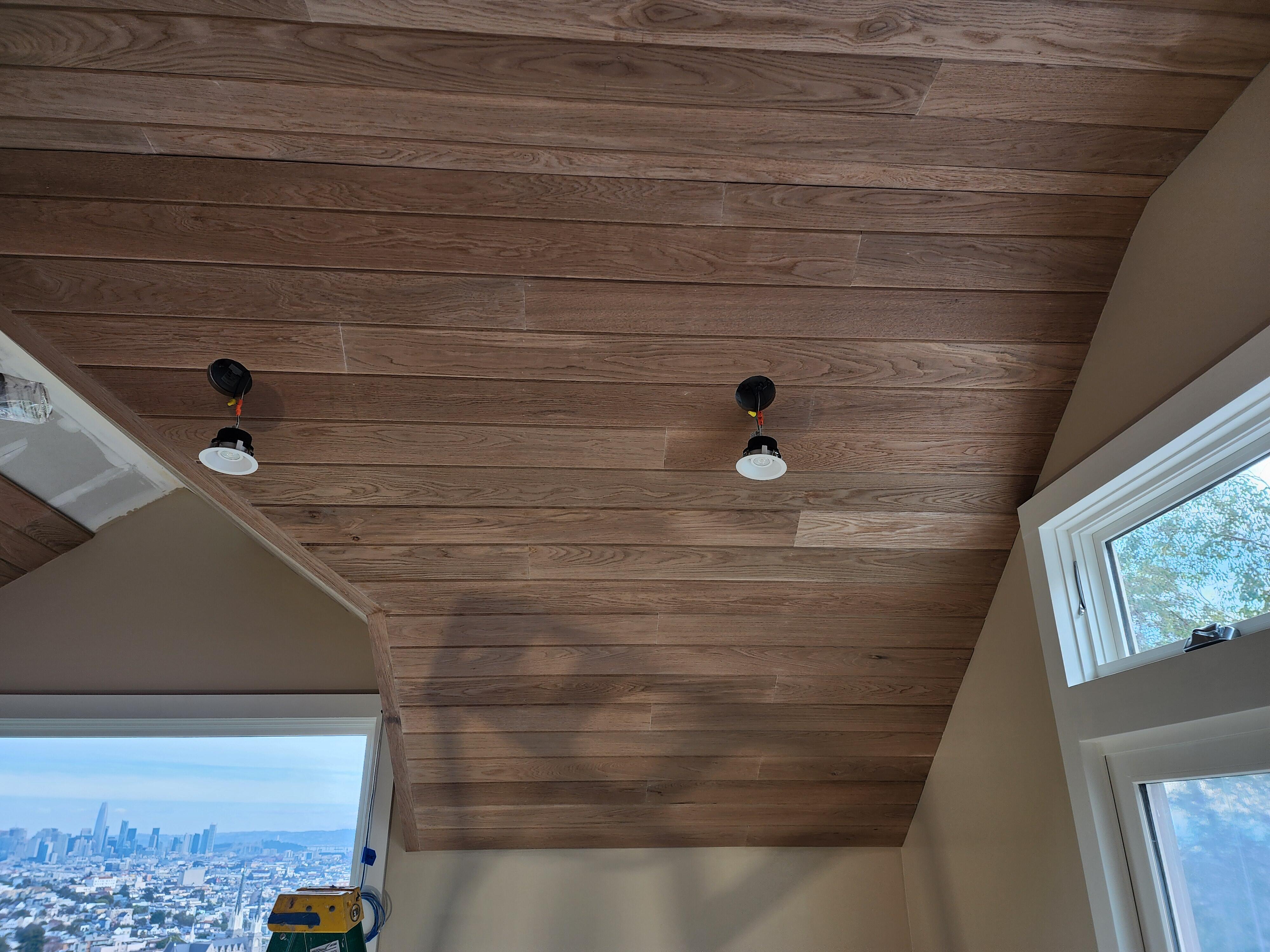

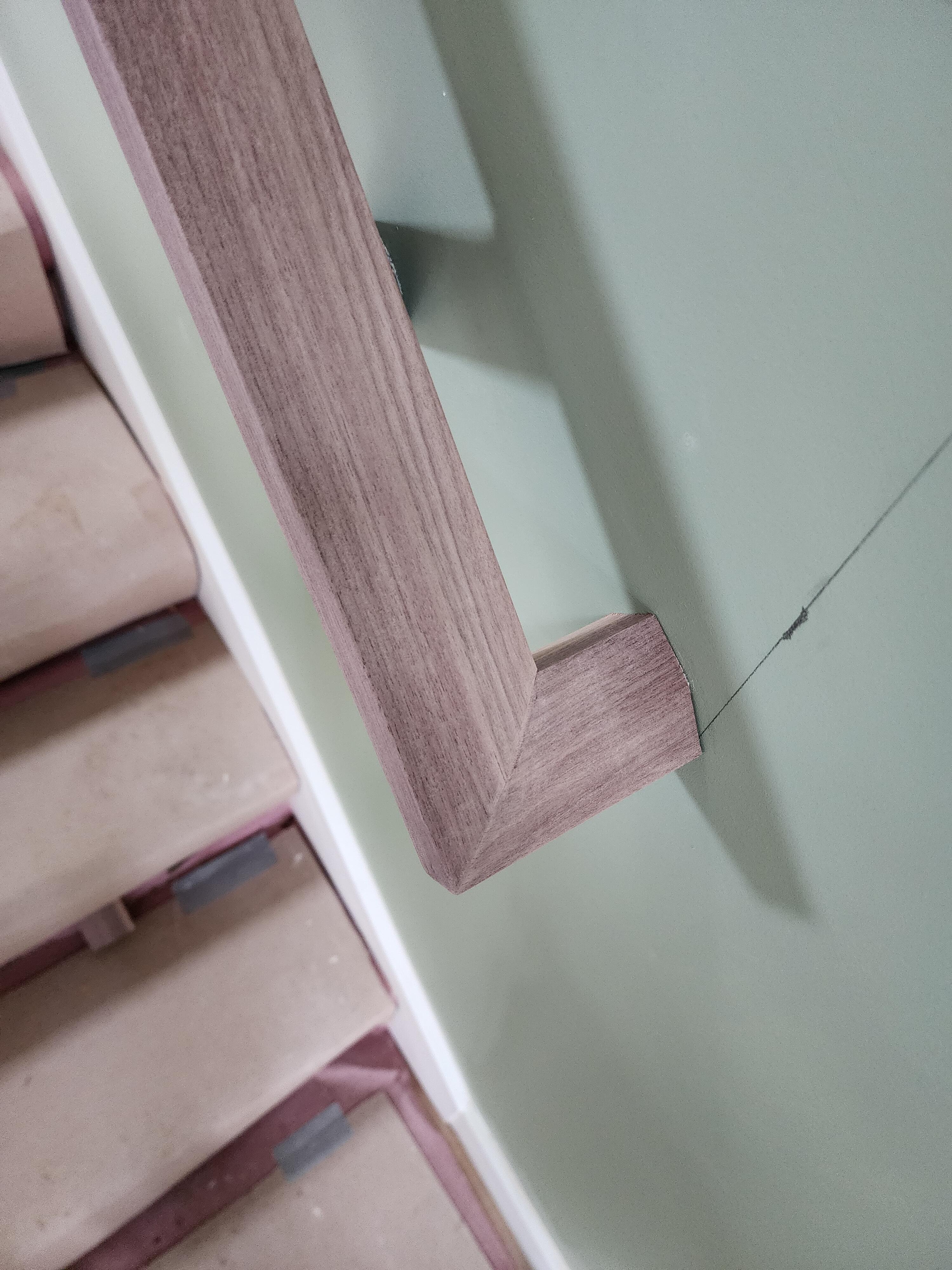

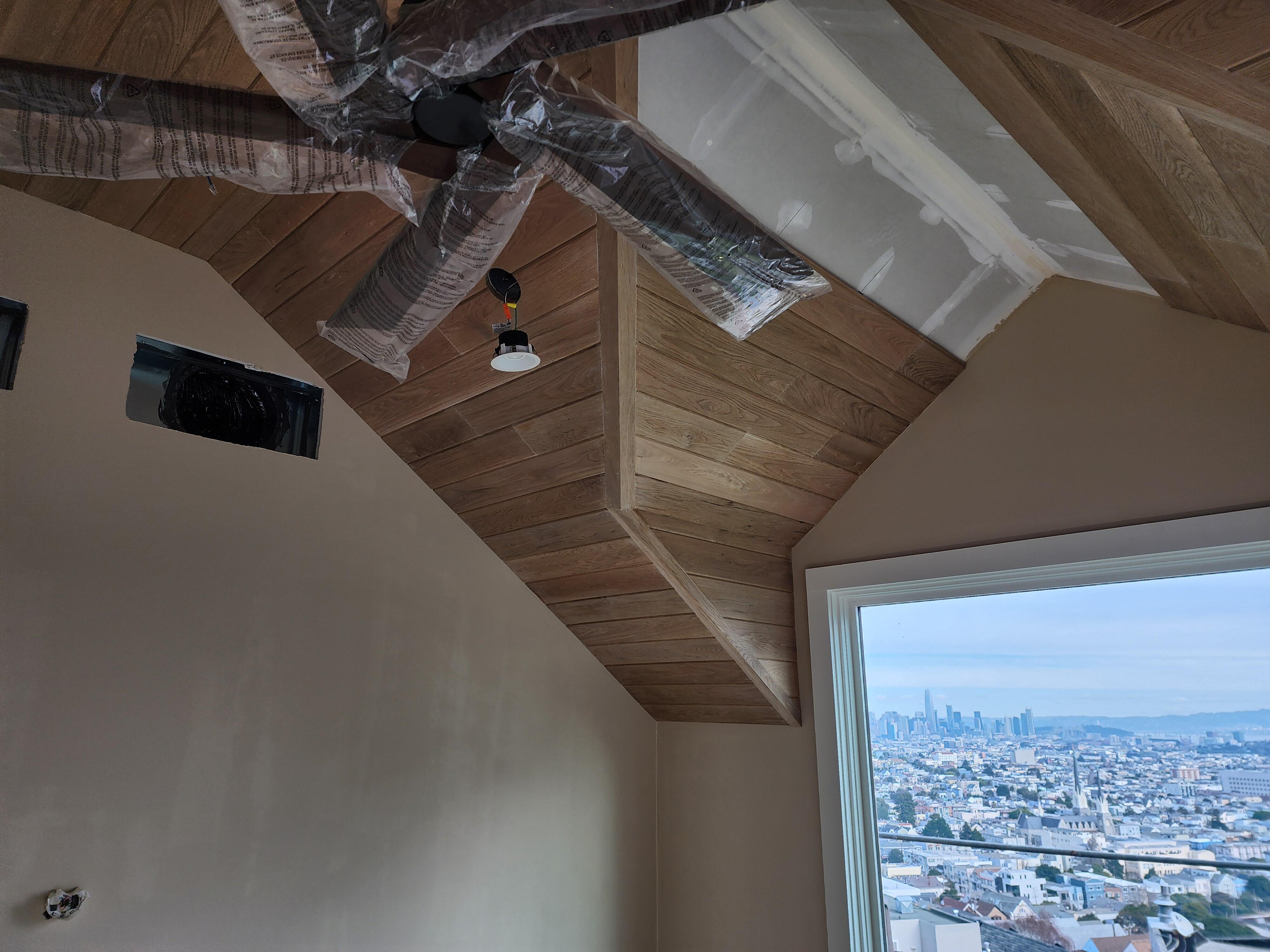

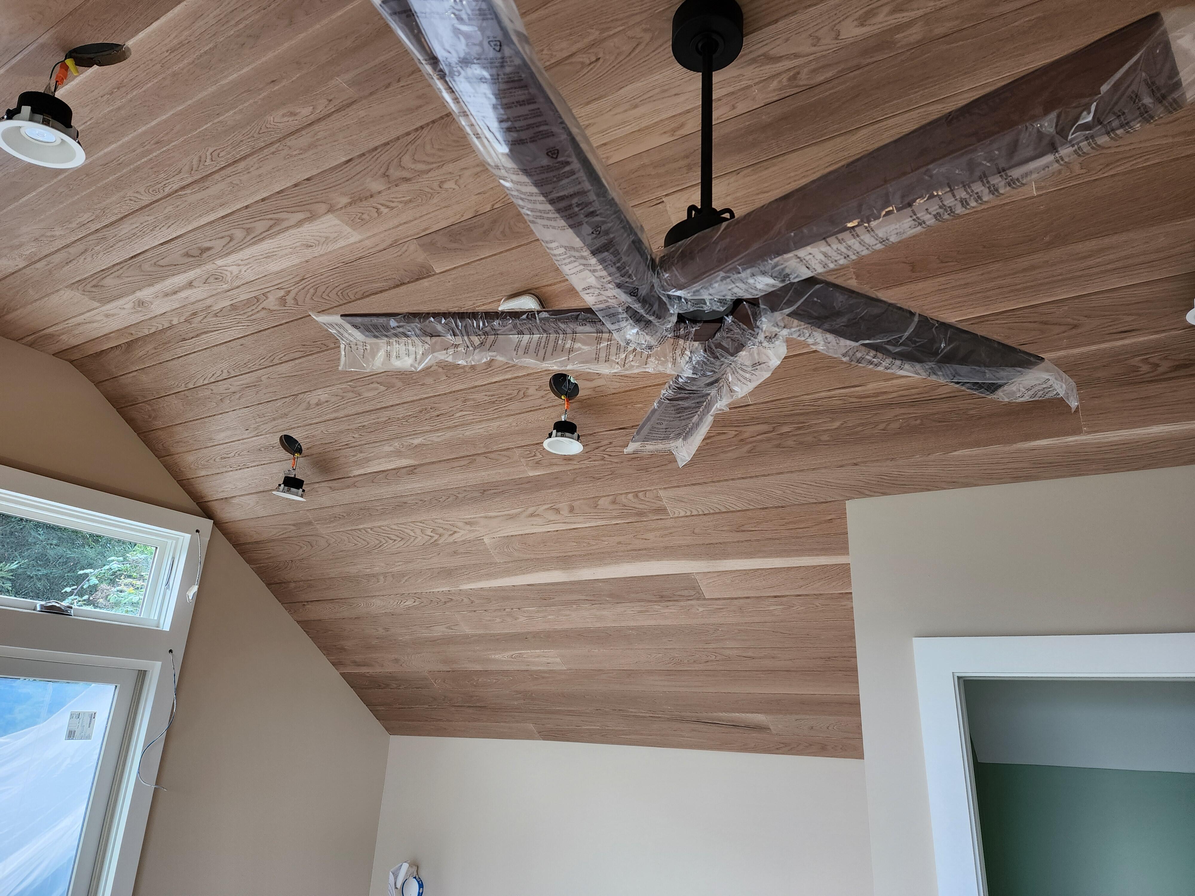

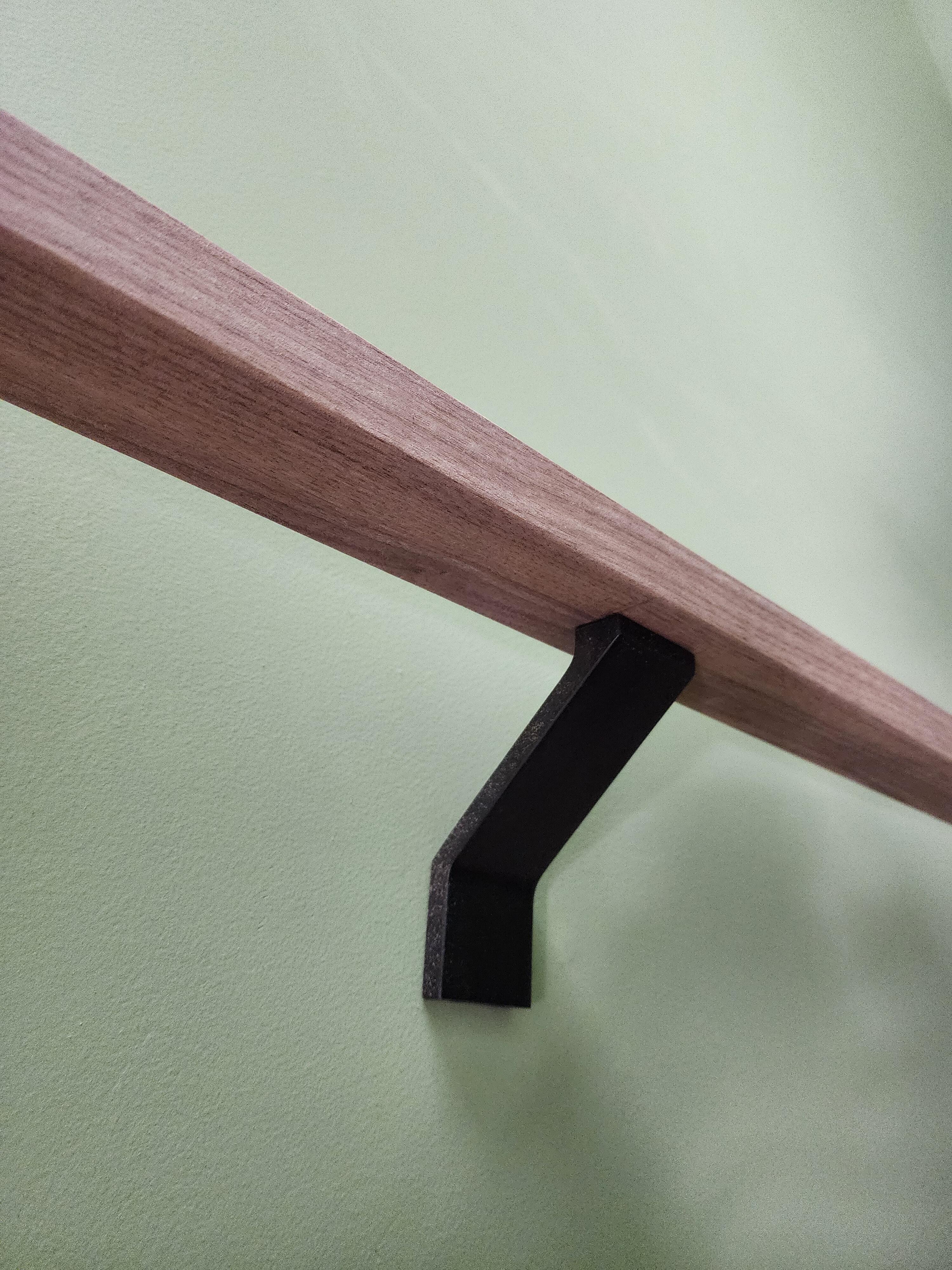

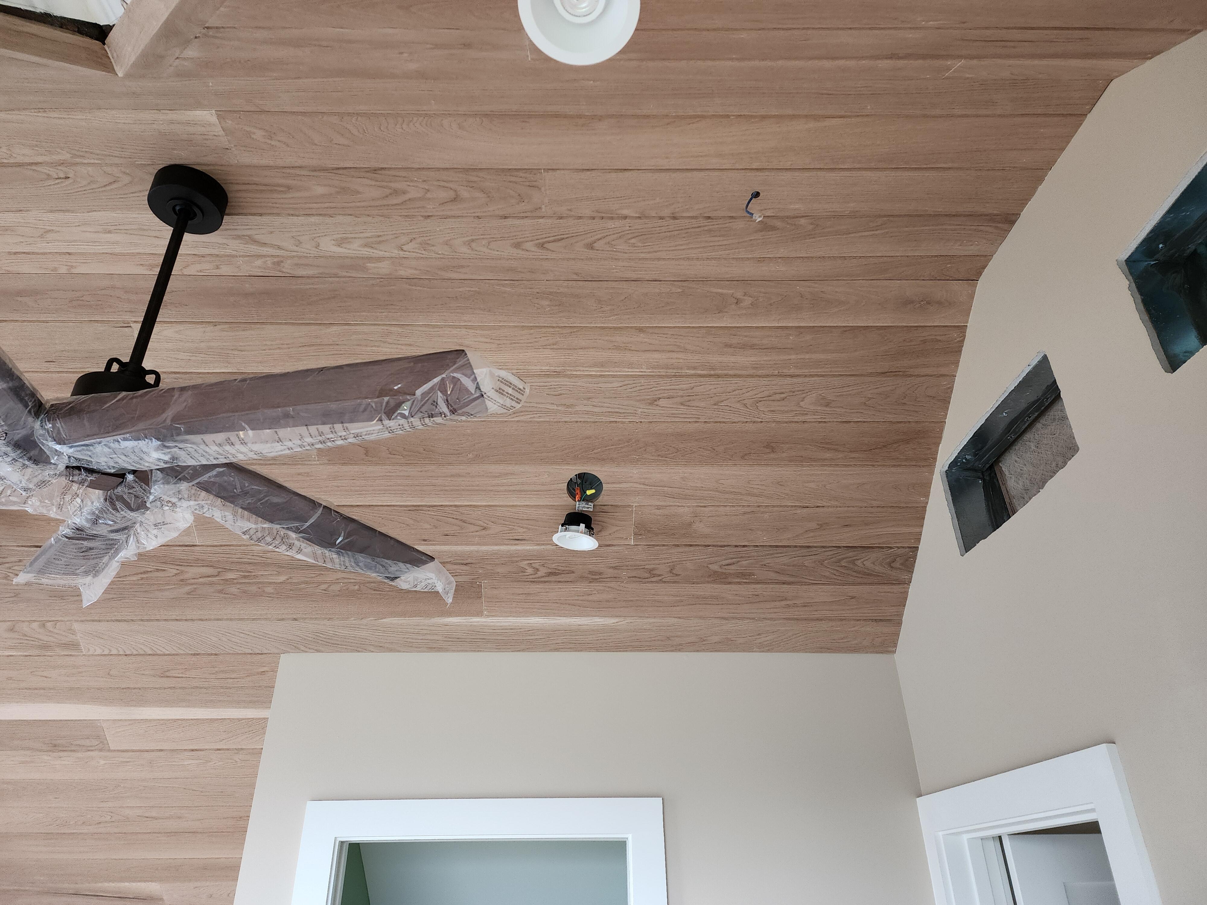

swt61 Posted January 15, 2024 Author Report Posted January 15, 2024 I made custom handrails for my current work site project. This morning I finished up the upstairs two rails in Walnut. Am now working on the same layout downstairs, in White Oak. And have some metal rails coming later today, that will get capped in the same Walnut and White Oak. Those pics to come later. Last week I was working on the master suite ceiling in White Oak tung and groove. Made more interesting because the architect specked that the trim would be flush with the tongue and groove. 10 Quote
swt61 Posted January 15, 2024 Author Report Posted January 15, 2024 Lots of crazy compound angles! Quote
swt61 Posted January 15, 2024 Author Report Posted January 15, 2024 You can't see from these pics, but the handrails have a pitched top. Kind of like a 4/12 roof. Quote
n_maher Posted January 15, 2024 Report Posted January 15, 2024 2 hours ago, swt61 said: Lots of crazy compound angles! Goddamn impressive, Steve. 1 Quote

Voltron Posted January 15, 2024 Report Posted January 15, 2024 The handrails look great. Are you going to use the Rubio on them? Quote
swt61 Posted January 16, 2024 Author Report Posted January 16, 2024 I'd like to, but the customers picked out a Mahogany stain? Luckily it doesn't change the look of the Walnut much. Just darkens it a bit. It'll get a water based clear poly on top of that. I would have gone with Rubio mono-coat in Walnut. Quote
swt61 Posted January 16, 2024 Author Report Posted January 16, 2024 They're trying to match the finish on the nearby Walnut kitchen cabinets, and thought that was the closest match. It really was close. Quote
VPI Posted January 17, 2024 Report Posted January 17, 2024 So how did you do the tops of the rails some kind of Moulder, huge router bit or a crazy cut on a table saw? Quote
swt61 Posted January 17, 2024 Author Report Posted January 17, 2024 I just set the table saw to the desired angle and ran it through, turned it over and ran it through on the opposing side. I did have a second set of hands attached to Al. Quote
