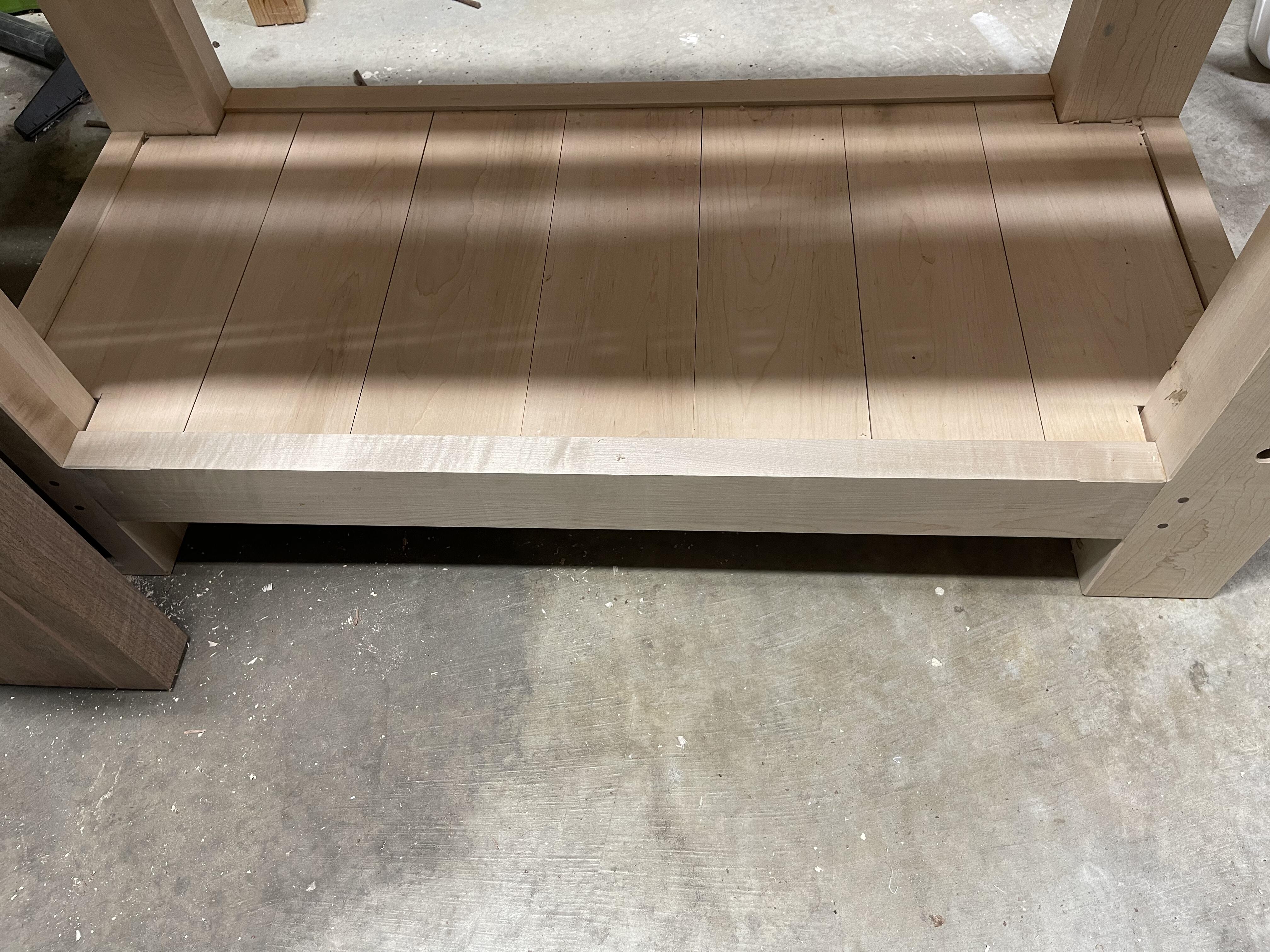

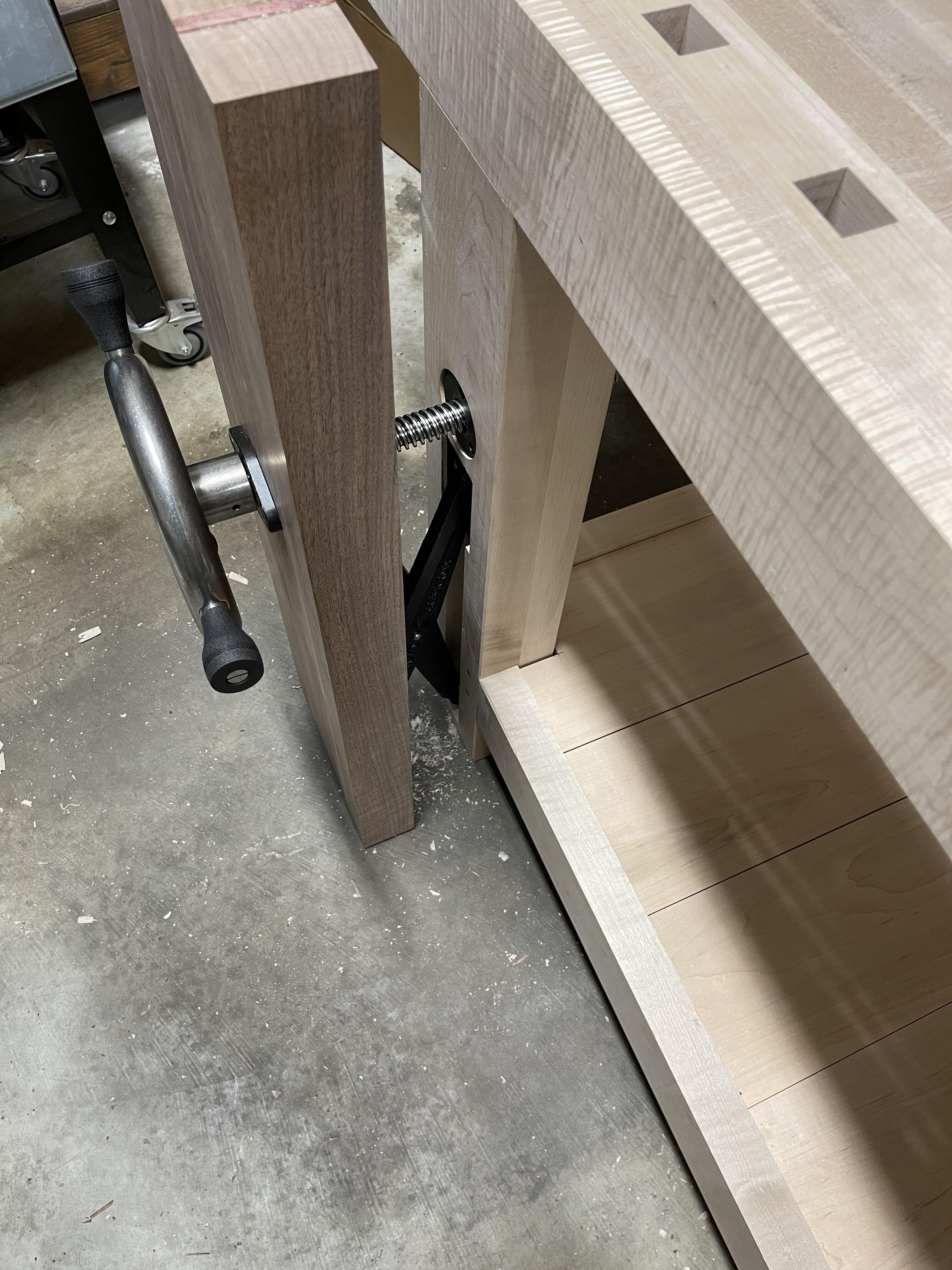

naamanf Posted November 3, 2021 Report Posted November 3, 2021 Built the lower deck and made the chop. Still need to cut it down and make it presentable but I wanted to make sure the glide fit and worked well. It sure does. IMG_5519.MOV 6 1 Quote
swt61 Posted November 3, 2021 Author Report Posted November 3, 2021 That Curly Maple is gonna dance with some finish on it. 1 Quote

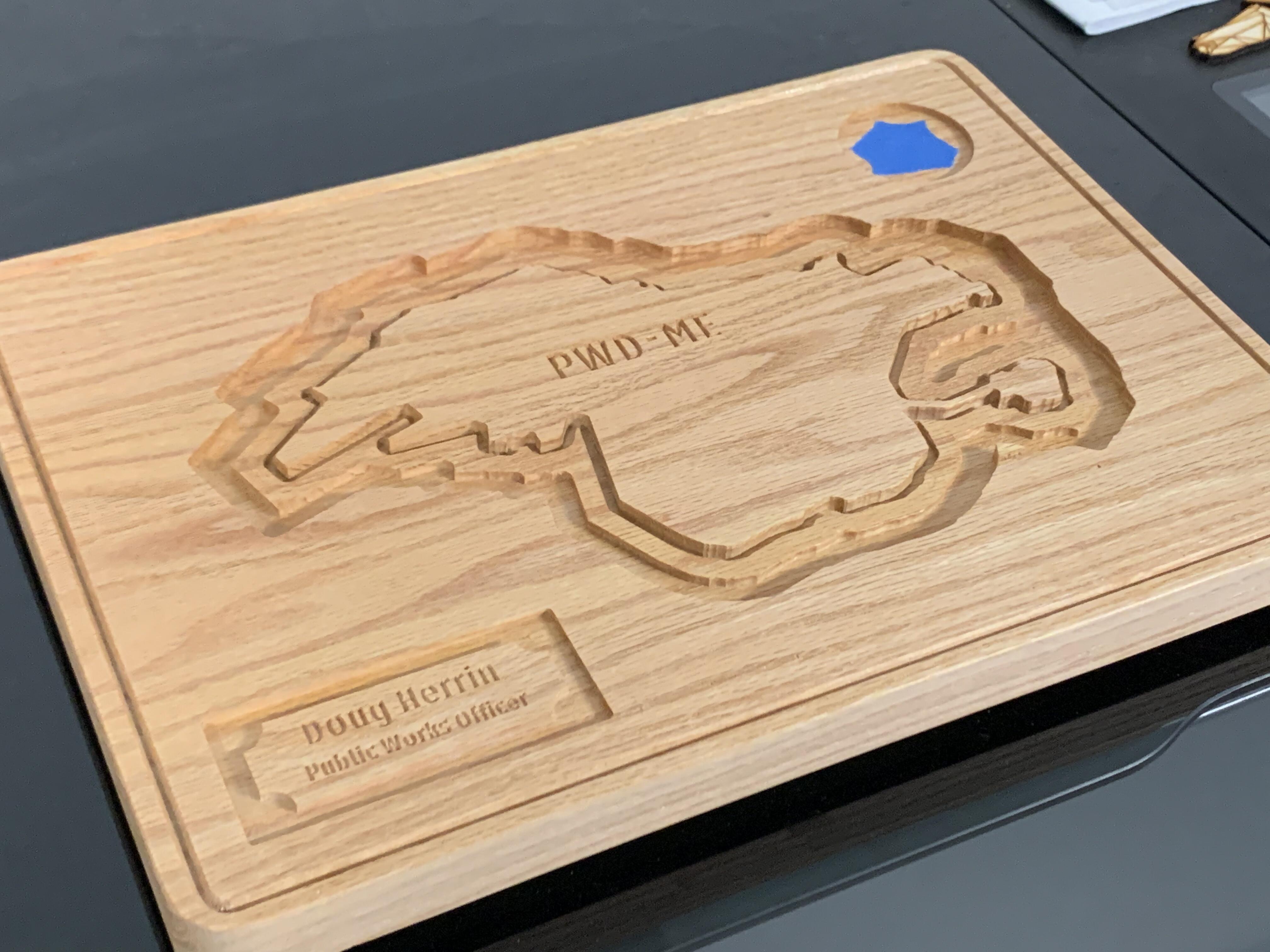

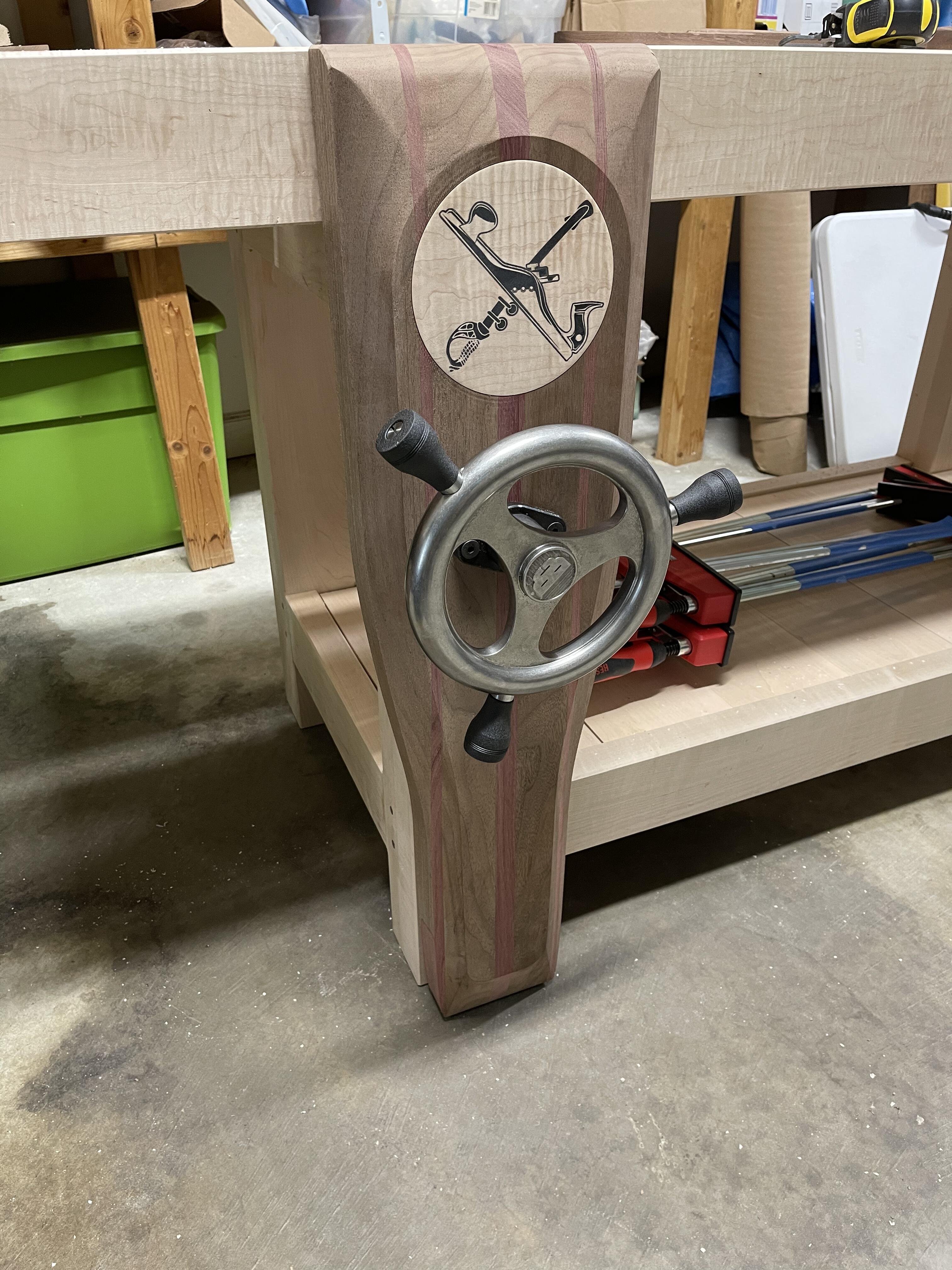

naamanf Posted November 5, 2021 Report Posted November 5, 2021 Totally messed it up being a Fusion360 noob but I present Chop V 0.5. I’ll redo it in the near future, also not super happy with the aesthetics. 7 1 Quote
kevin gilmore Posted November 5, 2021 Report Posted November 5, 2021 even the mistakes are outrageous. 5 1 Quote

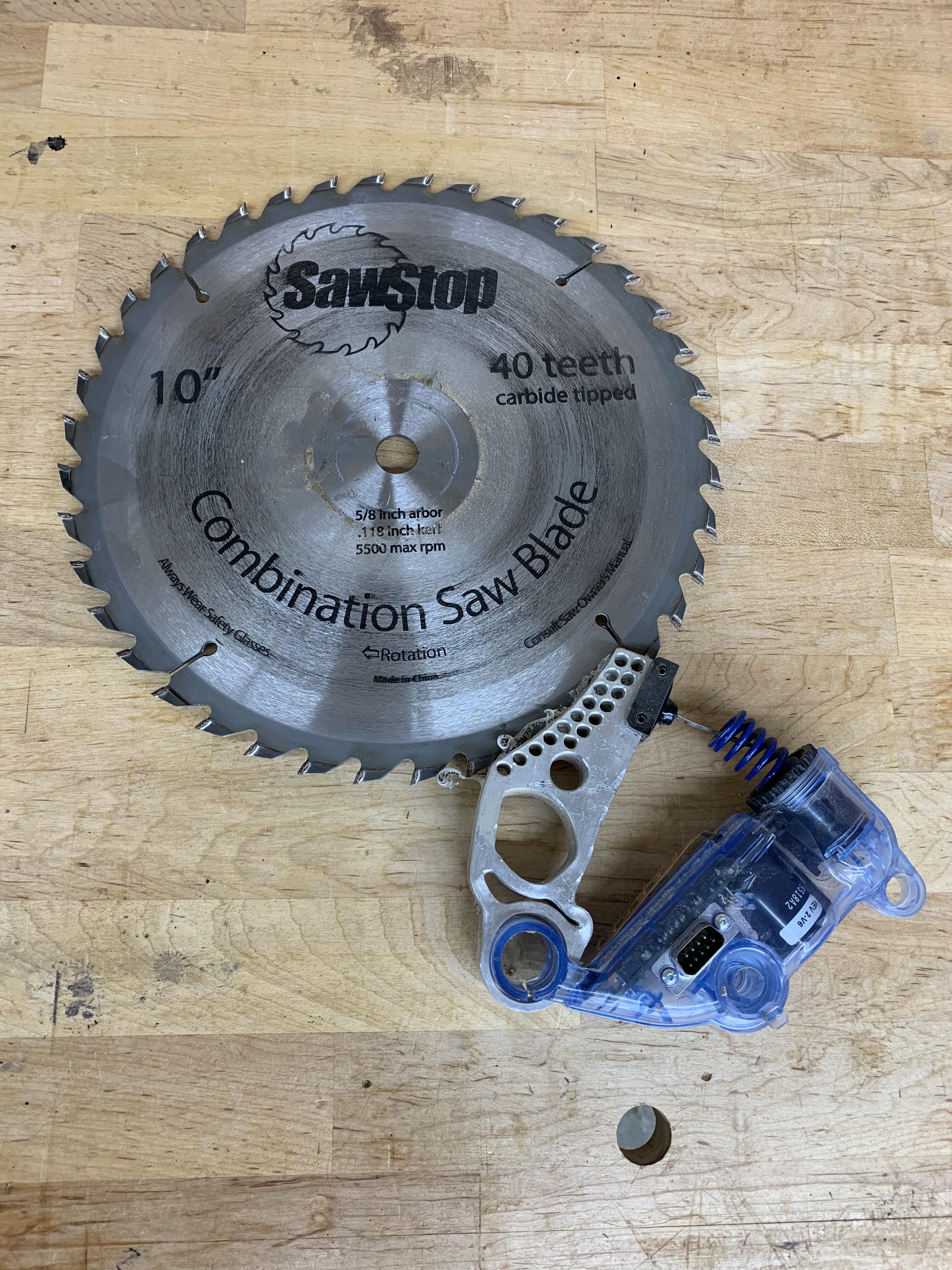

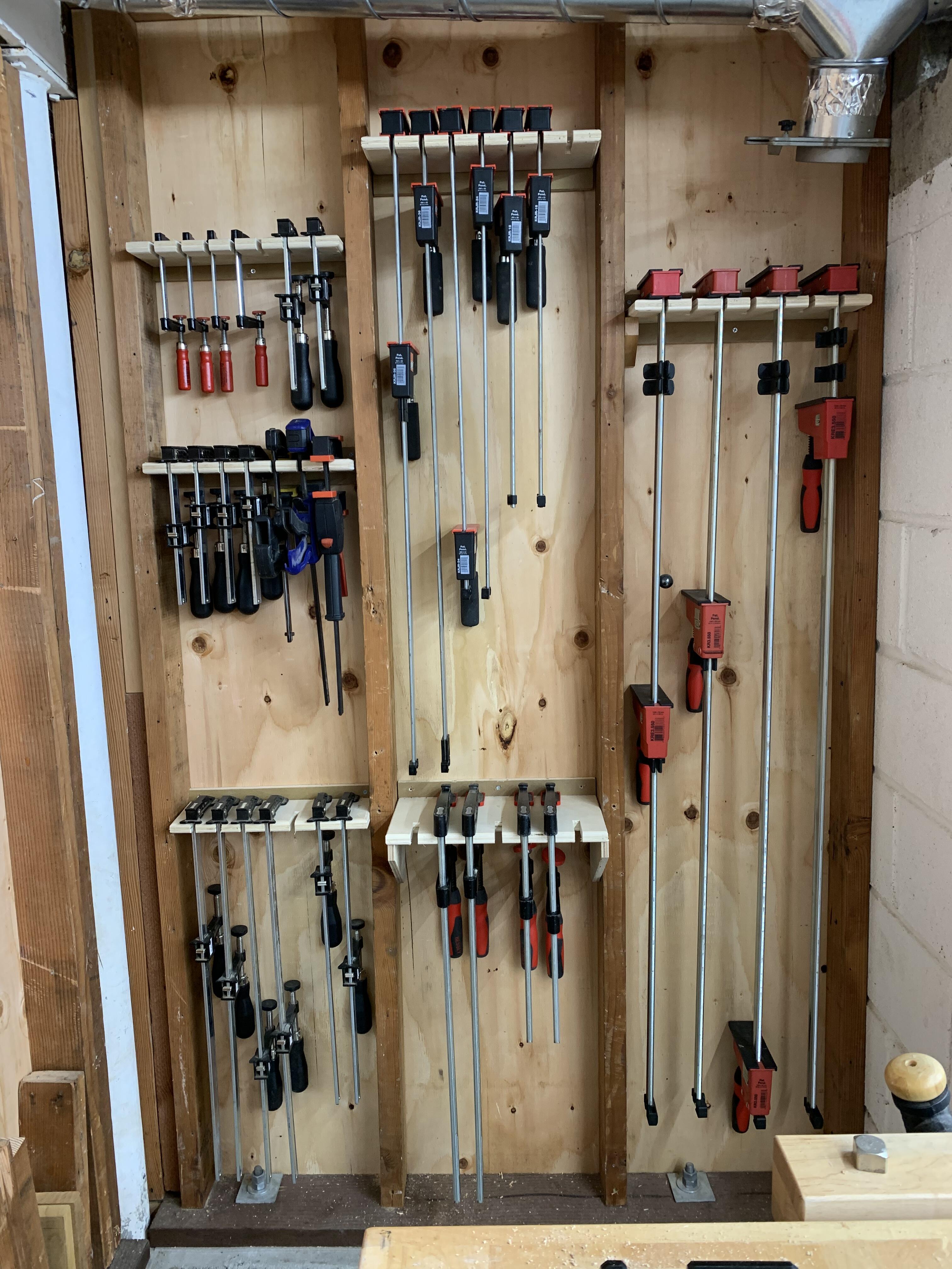

Voltron Posted November 6, 2021 Report Posted November 6, 2021 I made some clamp hangers and I'm OK with the aesthetics. This week has been weird and potentially dangerous on and off. On Wednesday, I was getting ready for the electrician to finish work in the new shop and he suggested that I could remove peg board from the back wall and drill the studs to run wire for the new outlets. I cut out pieces of the peg board and started drilling the stud closest to the corner with a spade bit. Arcy sparky popping circuit, I drilled right through the romex stapled to the back side of the stud. I didn't die. That same afternoon, I was going to make those clamp hangers and decided I would use a fancy Incra miter sled I have. The Sawstop miter track is in a different spot so I had to cut the sled on the saw and moved the metal fence way back away from the blade because it shouldn't get cut but also because the Sawstop safety feature triggers with metal as well as flesh. Long story short, I moved the fence back to near zero and went to cut the first board. It seemed like the the blade was still cutting the sled slightly so I looked closely at the fence and blade and it seemed OK until the mechanism fired and the blade disappeared. Fuck me. I got through yesterday without major mishap, and today I wanted to try clearing out outdoor drain before the next atmospheric river hits on Monday. I was using our new Ridgid Powered Drain Cleaner for the second time. The drain is very low and I had to learn over into the drain while feeding the snake, which is operated by a foot pedal. Long story short, my beard got caught in the cable snake spiral and it ripped out a big chunk before I could turn it off. That was quite freaky, and after cleaning up I couldn't quite take shaving for the first time in years. I didn't like the halfway look of disgruntled mayor of Whoville, so I have ended the day with a bit of Marshall Matt Dillon. The drain is clear, now that I got a tennis ball and lots of rocks and leaves out. 3 1 9 Quote
naamanf Posted November 6, 2021 Report Posted November 6, 2021 OMG that is a terrible run of misfortune. Fortunately you made it out mostly unscathed. On a positive note you are all set for beatnik poetry night. Just need to find your beret. I’ve read multiple times about the Incra cause of Saw Stops to trigger. Clamp rack looks great! 3 1 Quote

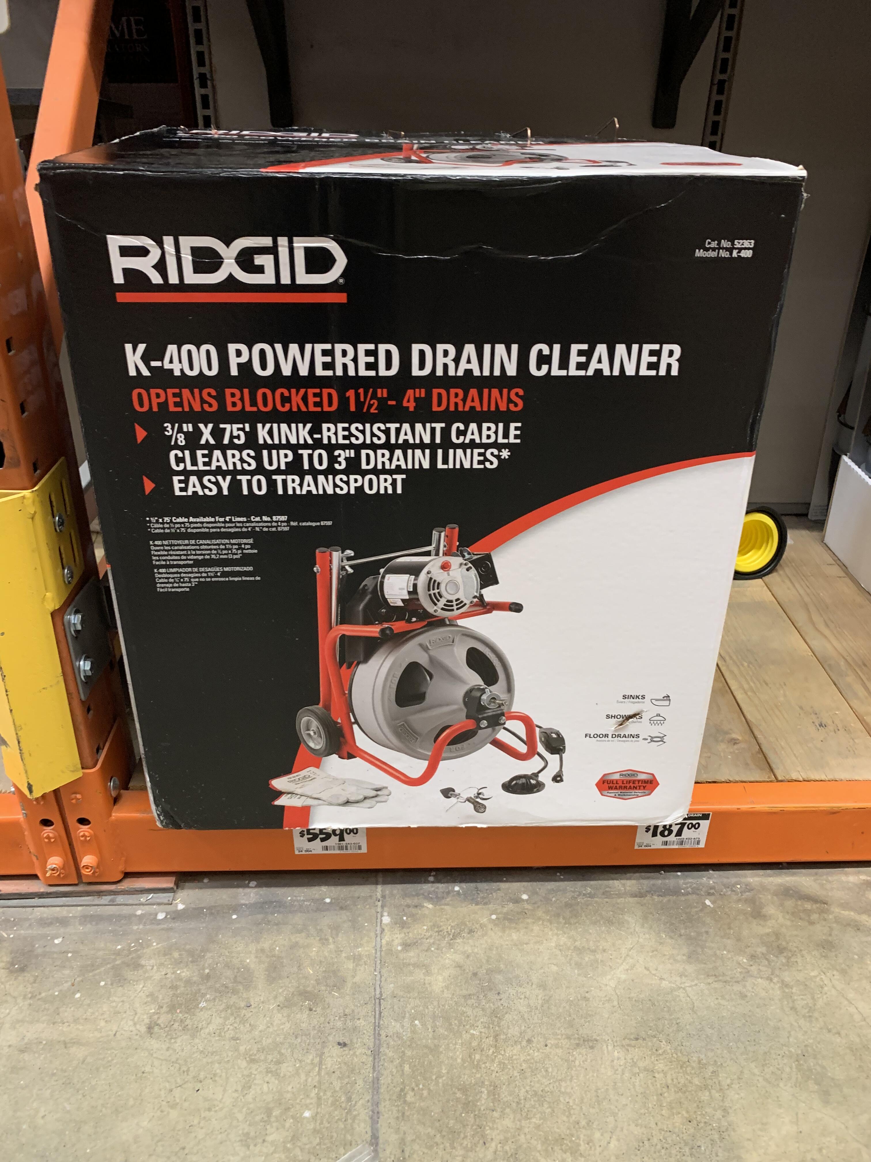

Craig Sawyers Posted November 6, 2021 Report Posted November 6, 2021 Bloody hell Al. Could have ended much worse with that drain cleaner. Kind of glad that mine is manual (the worst that has had to deal with is cooking fat blockage) I really like the clamp rack. Darned sight tidier than mine. 1 Quote
