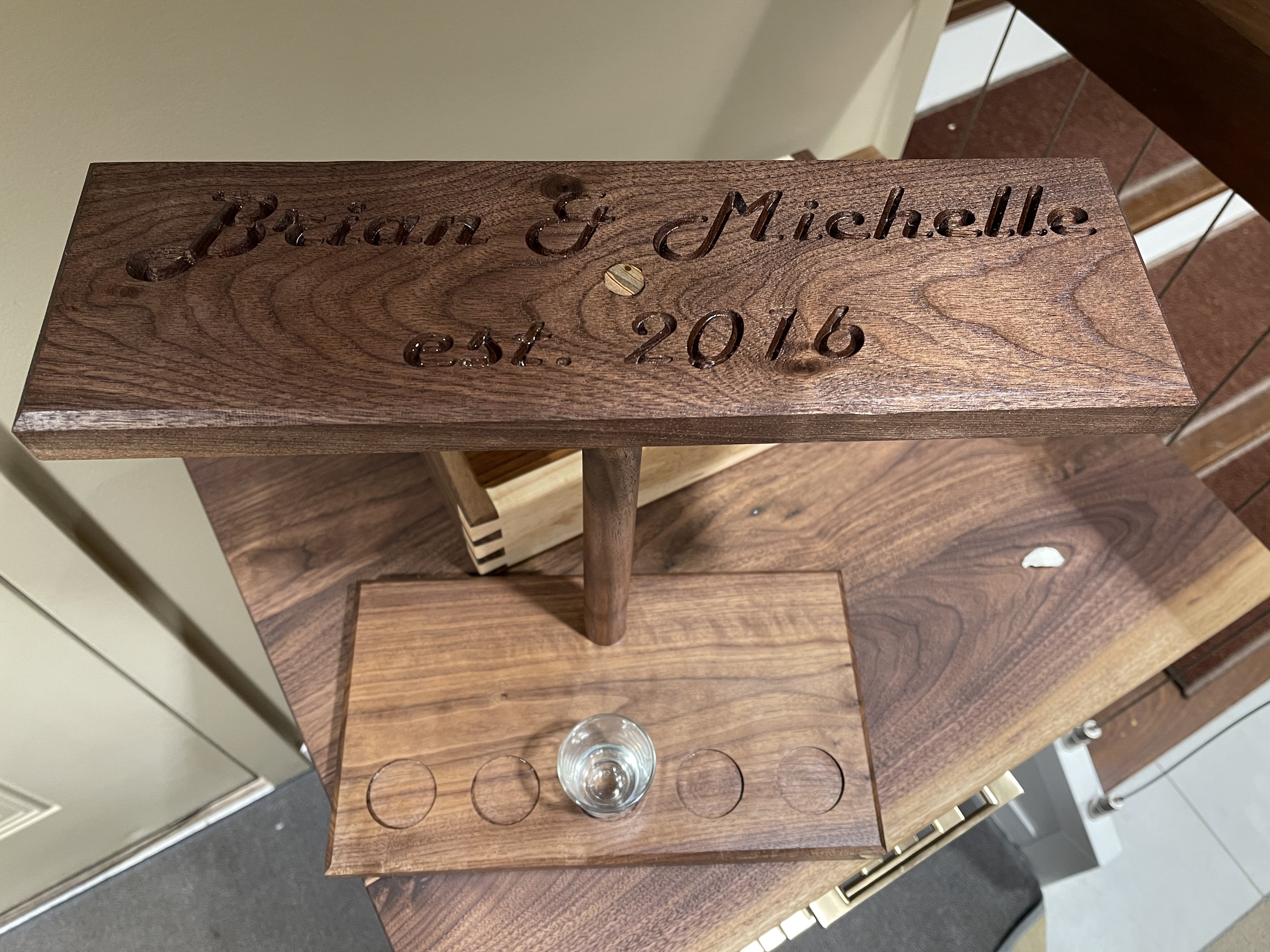

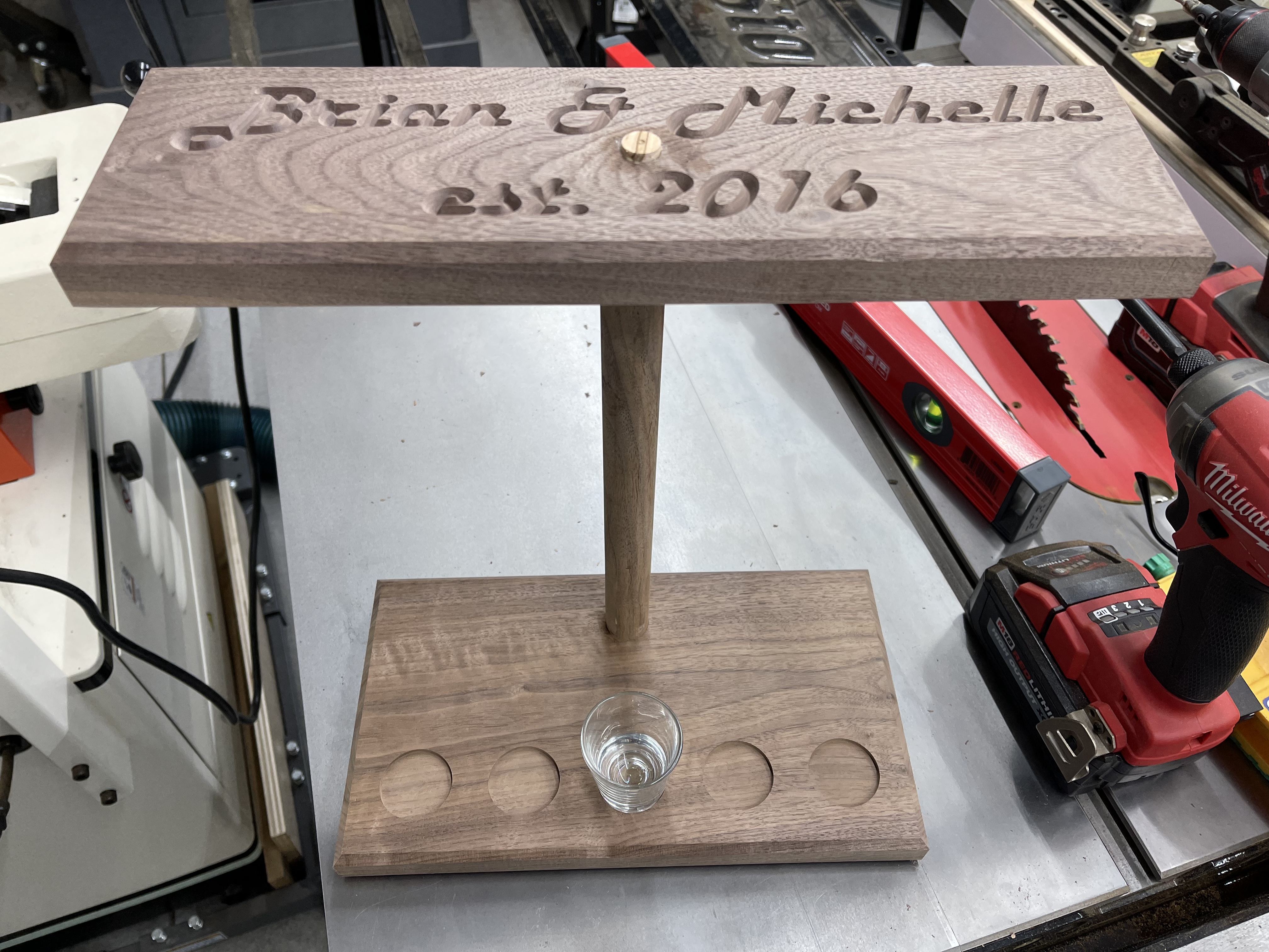

luvdunhill Posted December 16, 2022 Report Posted December 16, 2022 Careful, that might be construed by Larry as being a headphone stand 1 Quote
VPI Posted December 16, 2022 Report Posted December 16, 2022 (edited) Yeah, I have no eyelets to hang the strings and it is snowing now so it will have to be a headphone stand with drink holders for right now.Ā Edited December 16, 2022 by VPI Quote

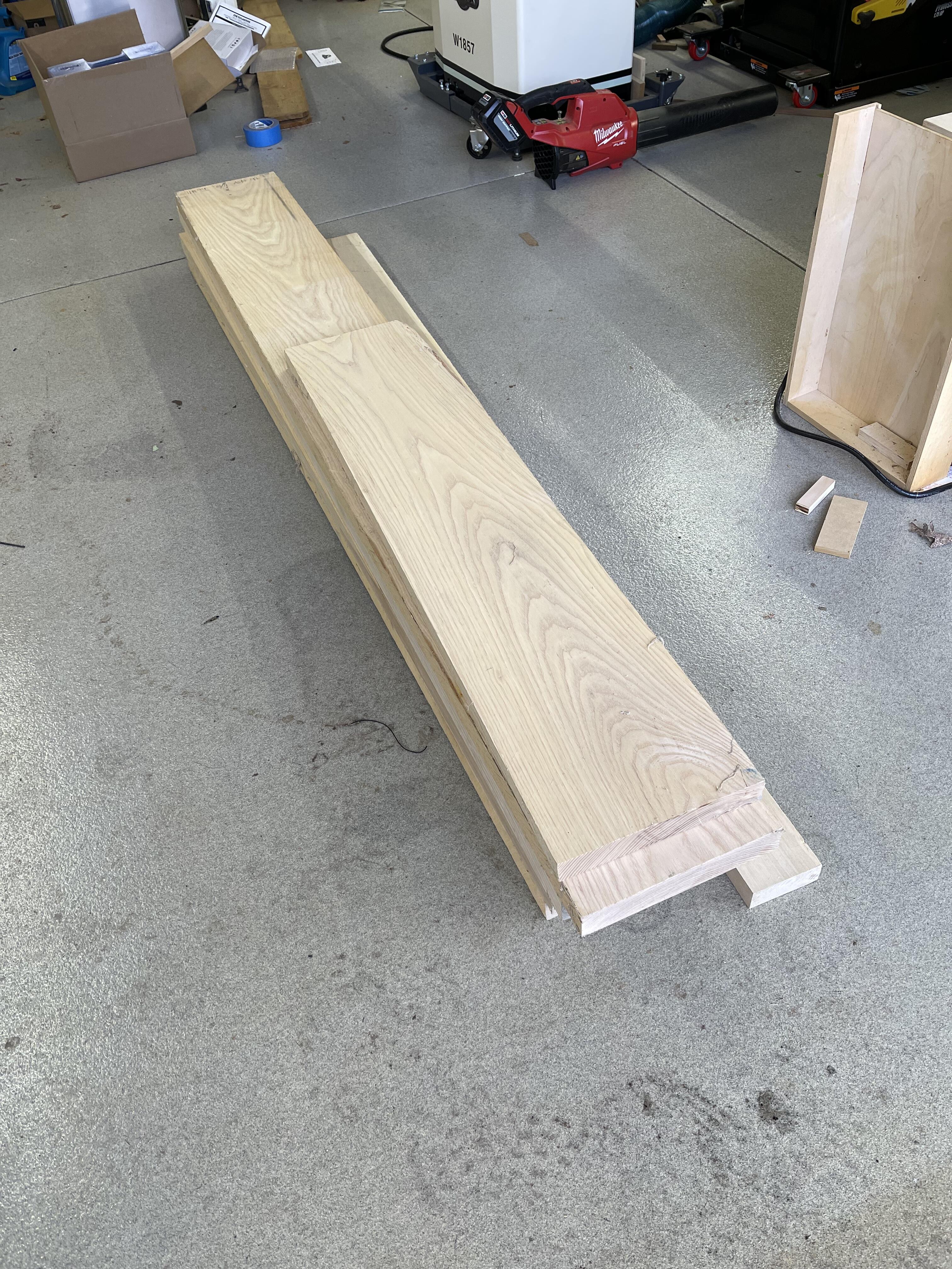

VPI Posted December 18, 2022 Report Posted December 18, 2022 Found another cabinet maker going out of business that had some 8/4 ash that I am hoping to use in the bench build for pennies on the dollar. Maybe the legs with hard maple top if I can find it for a reasonable price.Ā Ā 4 Quote
swt61 Posted December 19, 2022 Author Report Posted December 19, 2022 Love the Ash! Not sure I'd pair it with Maple. I think something darker would be a better contrast. Cherry and Ash look great together. Or tint the Maple with a dye. Quote
VPI Posted December 19, 2022 Report Posted December 19, 2022 I still have 100s of BF of 8/4 walnut but not sure it would not make better legs than top.Ā Quote

VPI Posted December 19, 2022 Report Posted December 19, 2022 (edited) Yes, definitely less informative than his YouTube videos. I guess it cannot be that detailed as people that watch that channel mostly just want drama and not education. I am working on a small Roubo Split top design and was thinking Walnut bottom with Maple top with some walnut accents. Now I might switch to Ash top.Ā Edited December 19, 2022 by VPI 1 Quote

n_maher Posted December 19, 2022 Report Posted December 19, 2022 Walnut seems entirely too beautiful to use for legs unless the pieces that you have just don't have much character.Ā Ā Quote
dsavitsk Posted December 19, 2022 Report Posted December 19, 2022 For a Roubo, I'd do ash for the legs for strength and flexibility, and maple for the top for hardness. Quote
VPI Posted December 19, 2022 Report Posted December 19, 2022 Was hoping to dump a ton of this 8/4 walnut I have laying around everywhere in my shop and storage unit into the base and just use the 70+ bf of Ash for the top. Then I got some 9/4 birdseye maple for vices.Ā Waiting on pricing for the 50Bf of Maple for the top that I think I would need for my mini Roubo to see if the Maple will be feasible.Ā 1 Quote
dsavitsk Posted December 19, 2022 Report Posted December 19, 2022 To be clear, the walnut will work fine for the base. Better than fine. Ash would be optimizing, but it is guilding the lily and any hardwood is going to do the job. Similar for the top - if i had a stash of stock that I wasn't going to use for anything else, I'd use it there. If I were starting from scratch and deciding what the buy, I'd do something like the ash/maple combo. Quote
VPI Posted December 19, 2022 Report Posted December 19, 2022 If I can get the maple for the top I will just do the ash legs and walnut accents/tool tray.Ā 2 Quote
swt61 Posted December 19, 2022 Author Report Posted December 19, 2022 Just to be a stickler, we're talking hard Maple. Not just any Maple would be optimal.Ā Quote
VPI Posted December 20, 2022 Report Posted December 20, 2022 People go both ways with the maple type, but I am thinking hard maple. Some say the softer variant is less likely to damage a workpiece, but I really see no way that the workbench is going to damage a work piece because it is too hard.Ā Ā Also, I found about 50BF of hard maple over in the storage unit so I think that will be enough for a top.Ā 3 Quote
