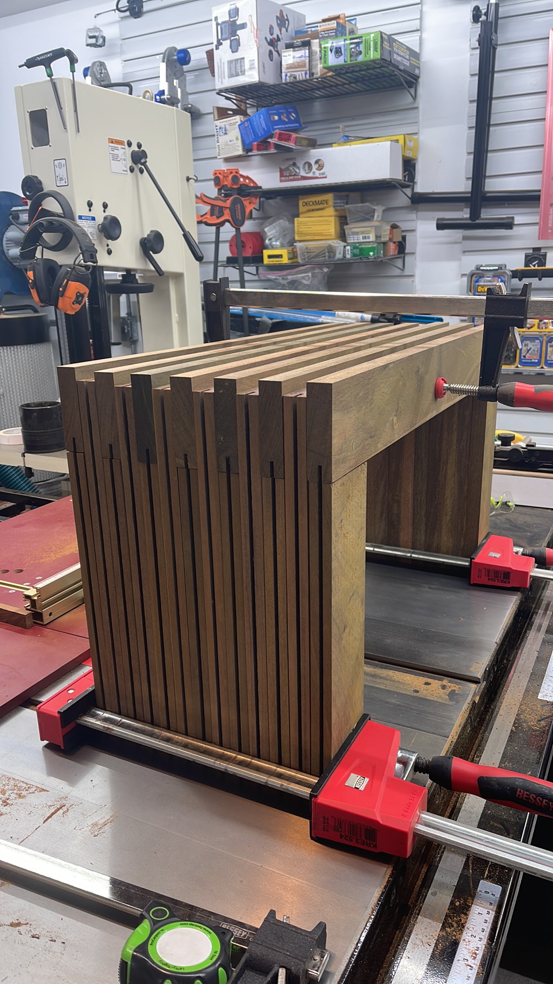

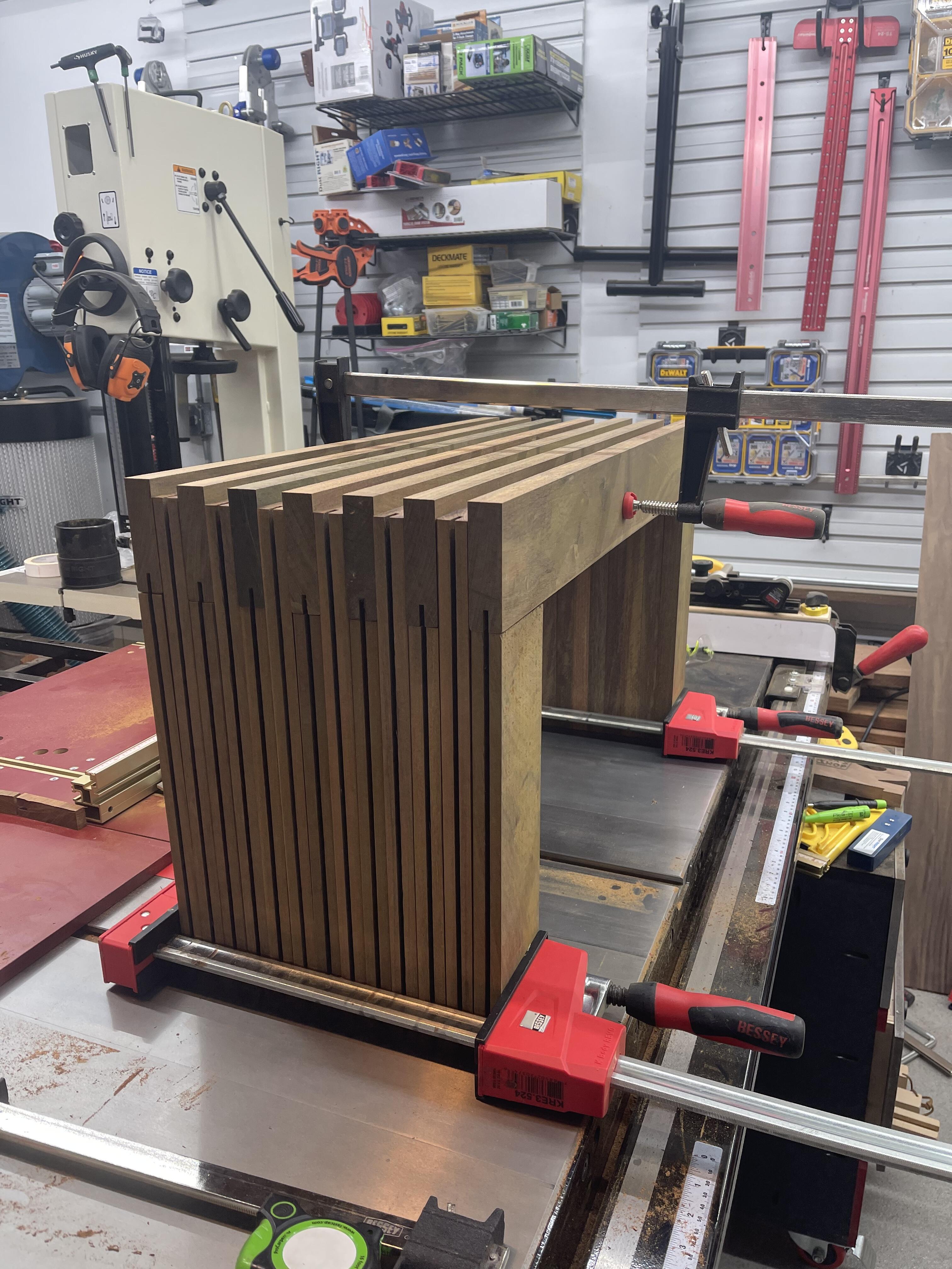

VPI Posted December 6, 2022 Report Posted December 6, 2022 Mock-up of the bench as I try to decide how high to raise the seat slats above the legs before doing a thumbnail roundover on all the slats. Thinking I might take off an extra quarter inch before the roundover to blend the slats and legs better. Also trying to decide if I want it to be a bit deeper.

Voltron Posted December 8, 2022 Report Posted December 8, 2022 It's gotta be over 100 lbs! Looks good, and I wasn't sure if you were leaving the groove but it gives the sides some texture and interest. 👍🏻 2

swt61 Posted December 8, 2022 Author Report Posted December 8, 2022 I think the implementation will make or break it. 1 hour ago, Voltron said: It's gotta be over 100 lbs! Looks good, and I wasn't sure if you were leaving the groove but it gives the sides some texture and interest. 👍🏻 I was thinking the exact same thing. Really gives interest and texture to the project.
VPI Posted December 8, 2022 Report Posted December 8, 2022 Yeah, I left the grooves as it is a fairly boring and blocky bench without it. Not really a pretty piece, but at least it burnt through a lot of this annoying wood pile on my driveway.

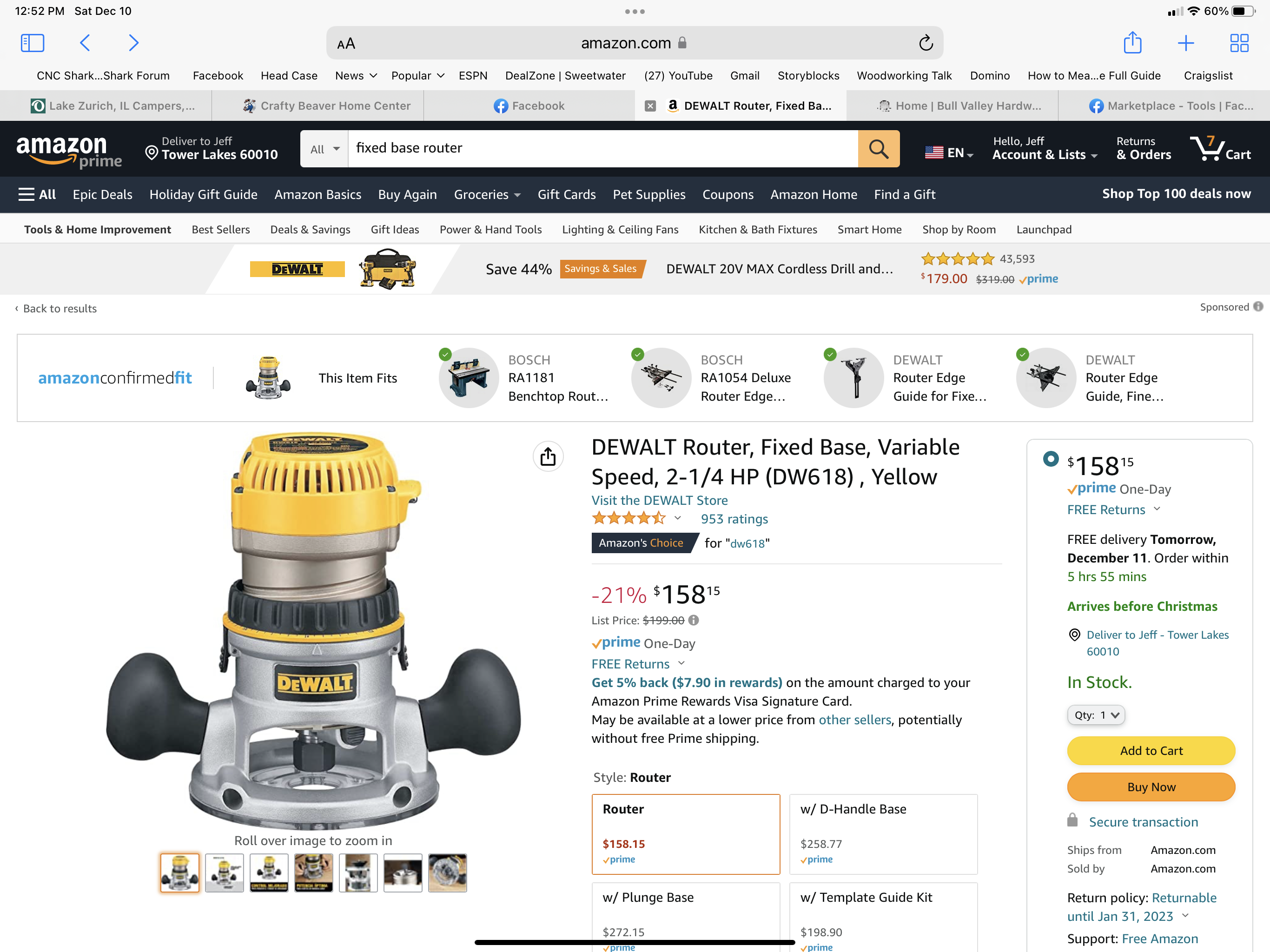

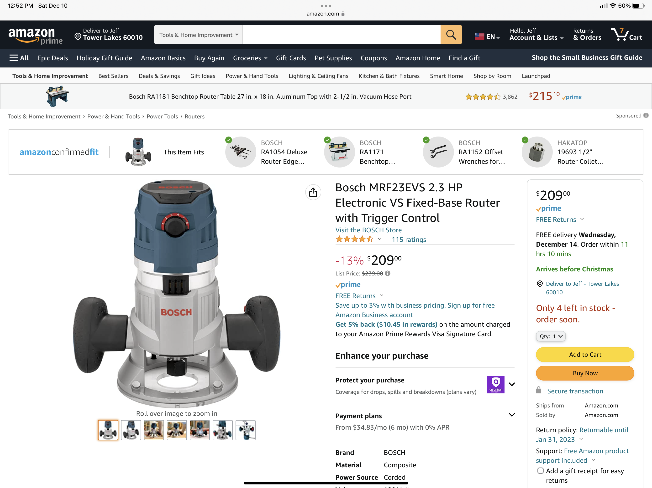

VPI Posted December 10, 2022 Report Posted December 10, 2022 Picking out a fixed based router for the Leigh jig. I like the trigger on the Bosch but I like the height adjustment on the Dewalt I think. Anyone have either one? The Festool plunge routers are just too top heavy to get clean dovetails.
dsavitsk Posted December 10, 2022 Report Posted December 10, 2022 Can't speak to either of those, but I would look for one with built in micro adjustment. And perhaps for something even smaller (1.5HP) since weight is a factor. 2
VPI Posted December 10, 2022 Report Posted December 10, 2022 2 minutes ago, dsavitsk said: Can't speak to either of those, but I would look for one with built in micro adjustment. And perhaps for something even smaller (1.5HP) since weight is a factor. Makes sense.
dsavitsk Posted December 10, 2022 Report Posted December 10, 2022 I think the Tritons might have that feature. I've not used one so I don't know how well it works. 1
VPI Posted December 10, 2022 Report Posted December 10, 2022 I do have the VRS on my Leigh so the weight is not really felt as it rides on the router support the whole time. There seems to be few sub 2hp non palm routers out there.

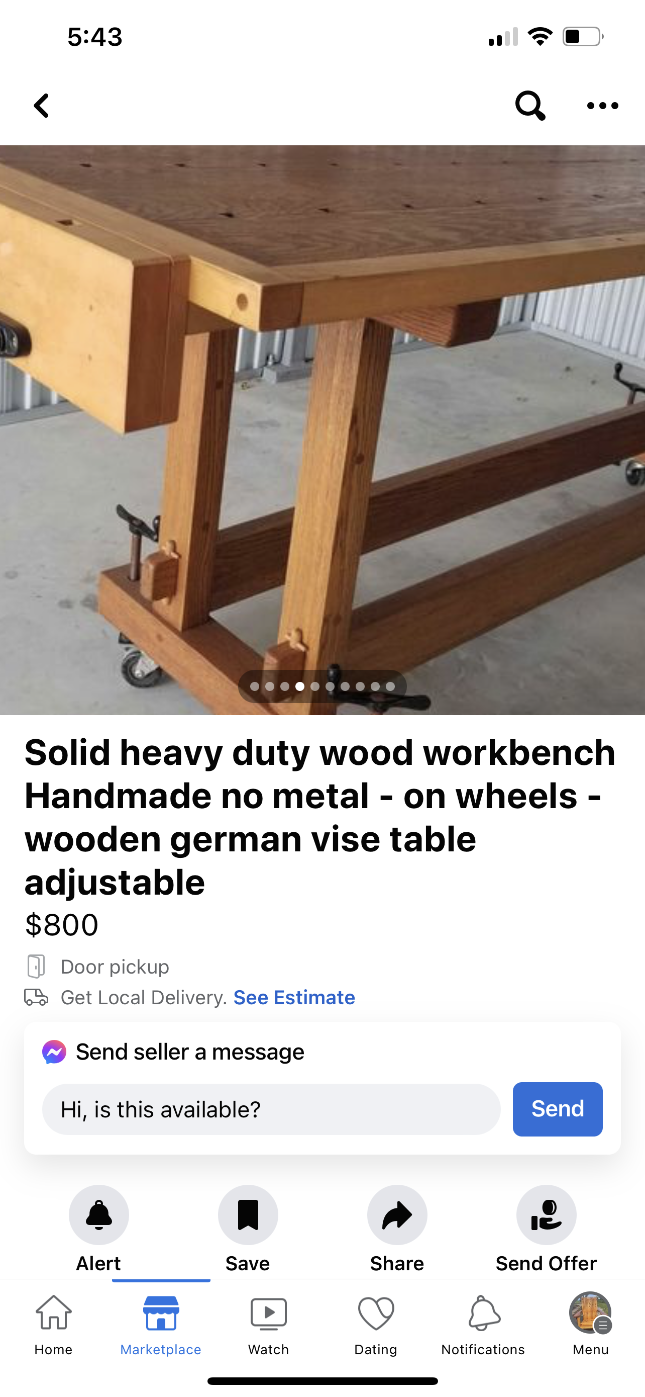

VPI Posted December 11, 2022 Report Posted December 11, 2022 I have been looking at bench designs, trying to decide between a dedicated hand tool bench and a combo with assembly capabilities. Saw this one for sale locally that looks pretty well made. Not sure I would want the Oak, but the wood alone is probably at least half the cost of the bench. Looks big enough to be a multipurpose bench and probably less than I would pay for the lumber and equipment if I tried to build my own. Just wish it was a bit shorter.
dsavitsk Posted December 12, 2022 Report Posted December 12, 2022 Doing a lot of hand tool work, particularly planing down boards, will put a lot of side to side pressure on a bench. The advantage of the Roubo design is that the legs through the top helps prevent racking. I have a Sjoberg that is poorly designed in that regard, that needs to be re tightened regularly, and that is probably going to fail soon. But if you aren't hand planing, then it is not really a big deal.
VPI Posted December 12, 2022 Report Posted December 12, 2022 Probably only the bare minimum of planing. Really need assembly surface more than anything but would like the ability to use hand tools every once in a while. Contemplating the simple Rob Cosman Work Bench customized a bit for more surface area maybe.
