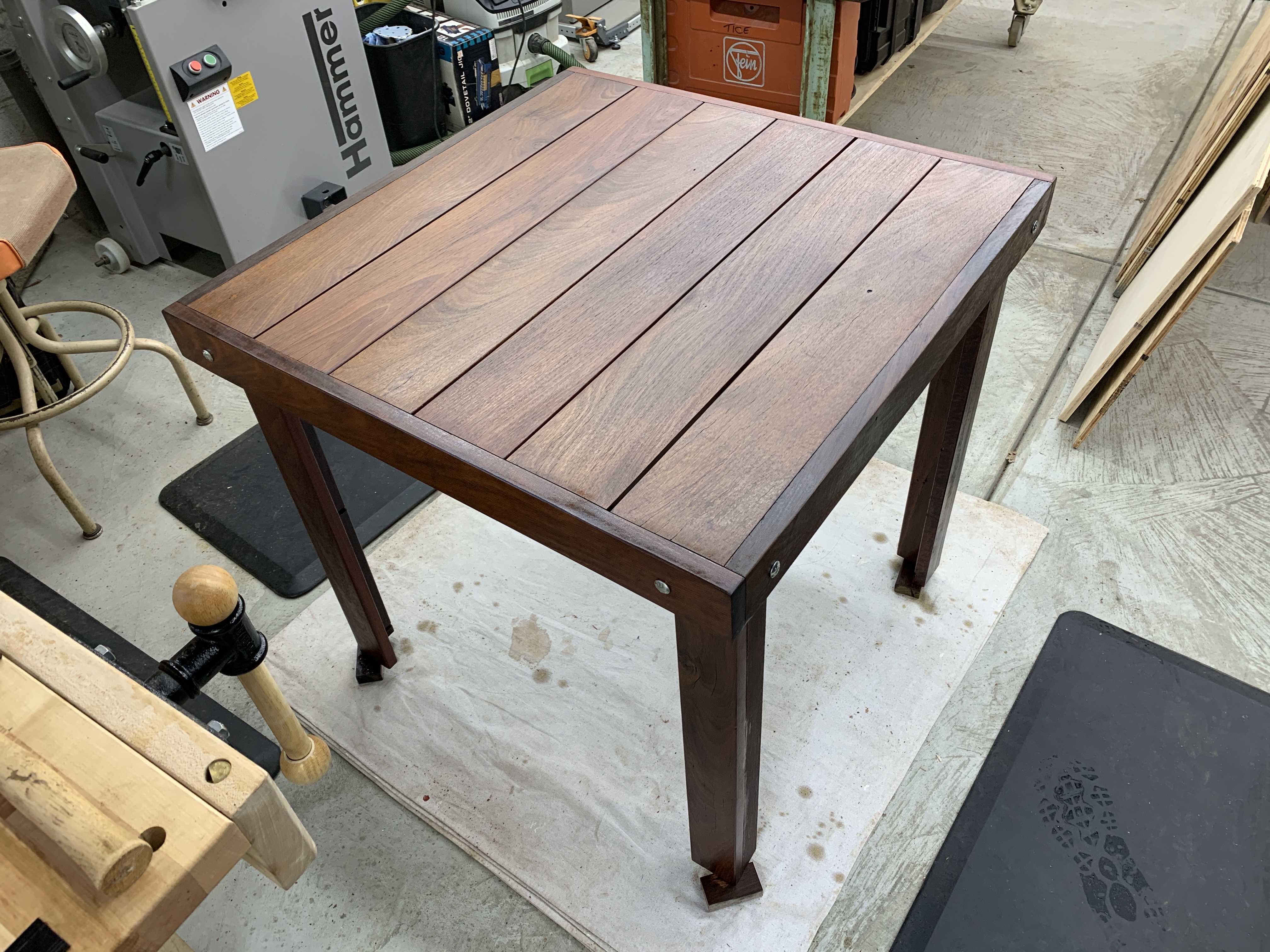

Voltron Posted December 5, 2022 Report Posted December 5, 2022 I've been trying to rehabilitate and revise the heaviest deck table in the world and in the process decided that the only thing I'm going to do with the leftover Ipe decking is make decking. Unreliable is a good summary. Annoyingly dense and brittle at the same time. Death to most screws. Resistant to finishes. 1 Quote

VPI Posted December 5, 2022 Report Posted December 5, 2022 I have found any untreated ends will crack like crazy, but if you apply the sealant after cuts to stored sticks, they do not develop the cracks. Simply gluing everything together with hardened Epoxy (Thixo) has worked well so far and the Penofin Hardwood penetrating oil makes a fantastic finish with minimal effort. Remains to be seen if any of it holds up over time though. I just want to go through this giant stack of Ipe in my driveway/under my deck. Quote
Voltron Posted December 5, 2022 Report Posted December 5, 2022 My experience is that no finishes really last on this stuff, but I saw Penofin Transparent Ipe at the hardware store this morning so I got a can. I reconfigured this table a bit, made stronger legs from the old ones, and bolted them on instead of using screws and glue. We'll see how it holds up all around. 5 Quote
VPI Posted December 6, 2022 Report Posted December 6, 2022 Looks gorgeous. The wood is a bitch to work with. Processed 36 linear feet today and it was not enjoyable. My table and coasters have been outside for about a month with the Penofin and I cannot tell the difference from when I put them out. I wish I had a hardware store selling Penofin locally; I have to drive an hour each way. 1 Quote
