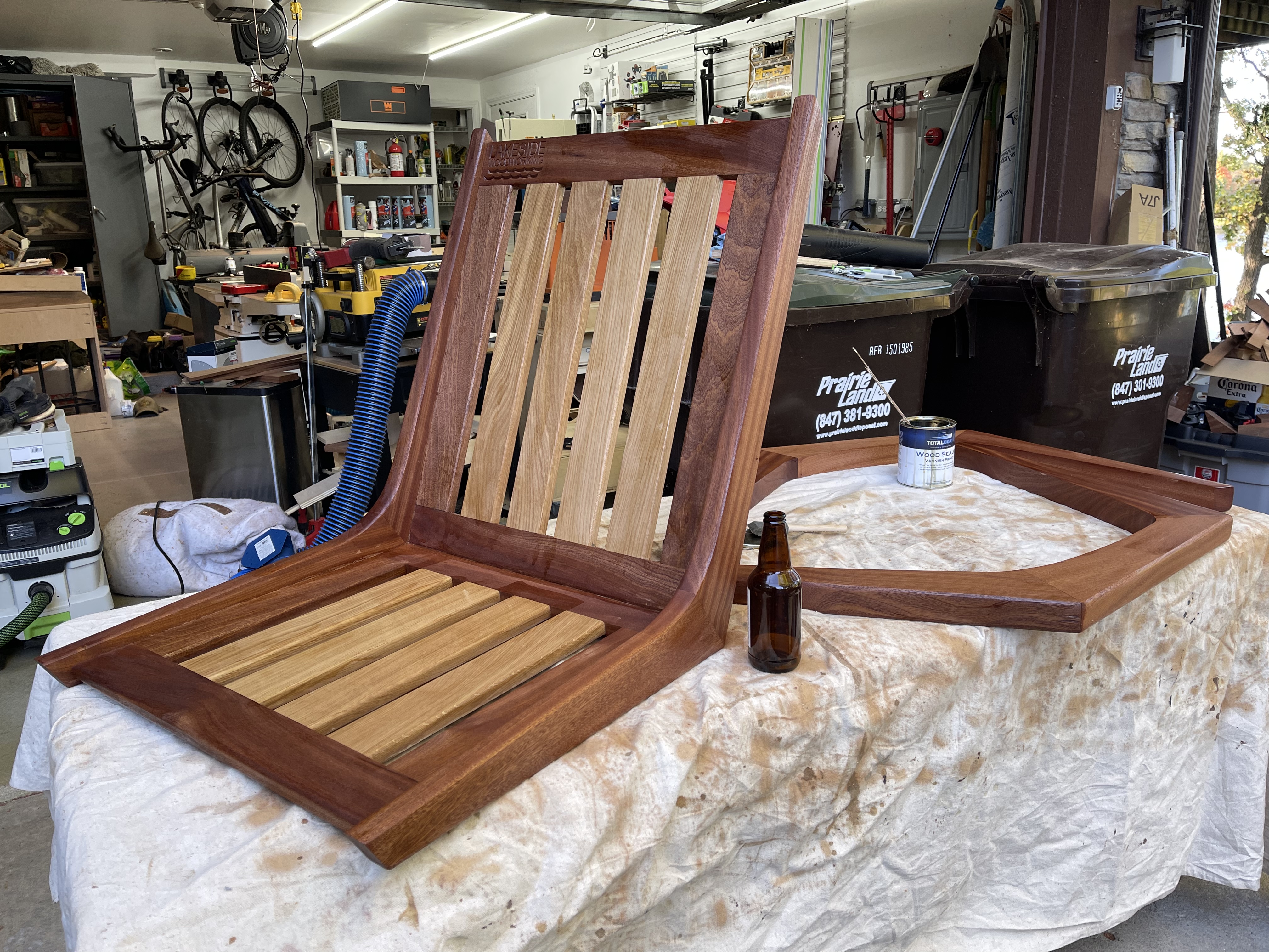

VPI Posted October 8, 2022 Report Posted October 8, 2022 Okay wood peoples, what are your preferred finishes for the outdoor stick furniture? I use penetrating oil for the cedar sticks but contemplating a Halcyon boat varnish, teak oil, something else for the Sapele/White Oak lounge chair.Ā Probably 30% sun and direct rain/snow exposure.Ā Quote
swt61 Posted October 8, 2022 Author Report Posted October 8, 2022 There is no maintenance free finish. Every outdoor finish will need work over time. The only maintenance free finish is no finish. But if you don't want a silver/grey oxidation, then I think a spar varnish or boat finish is probably your best option. 1 Quote
Voltron Posted October 8, 2022 Report Posted October 8, 2022 Le Tonkinois is a natural non plastic boat varnish that is excellent. Doug turned me on to it. The Marine Varnish No. 1 is meant for boats and other exposed woods. My only concern is how dense and oily the sapele is -- the Tonkinois didn't penetrate and bond with ipe as well as I hoped. http://www.tarsmell.com/number_one.html 1 Quote
dsavitsk Posted October 8, 2022 Report Posted October 8, 2022 28 minutes ago, Voltron said: My only concern is how dense and oily the sapele is You guys must have used very different sapele than I did Quote
swt61 Posted October 8, 2022 Author Report Posted October 8, 2022 Doug is right. If it's actually Sapele, the Le Toninois or any other marine varnish should be a great match. If it doesn't penetrate, then it's something other than Sapele. Having seen pics of the wood, I'm sure it's a Mahogany derivative of some sort, and therefore should take the top coat well. I had forgotten about the Le Tonkinois. It is a beautiful, durable and more natural finish. It has held up beautifully on Al's garage door in the city. And that door is somewhat near the ocean, so it's not an easy environment.Ā Quote

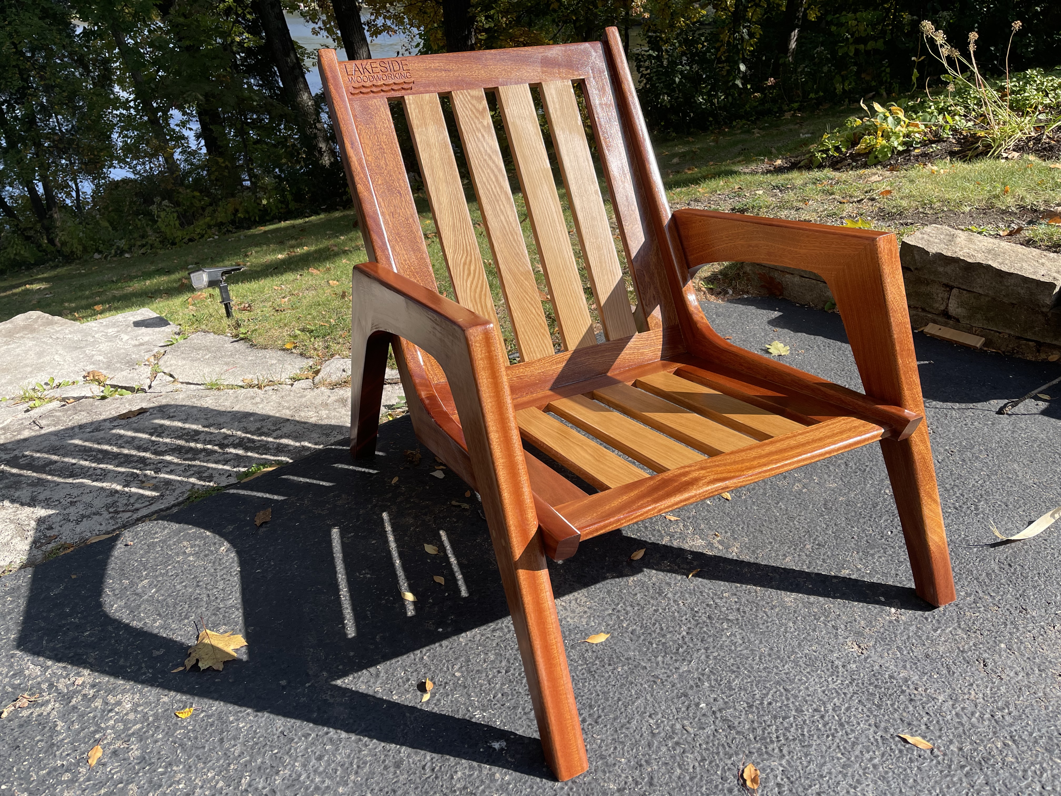

VPI Posted October 8, 2022 Report Posted October 8, 2022 I have total boat Halcyon, so Halcyon it is as I have too much stupid shit to do this weekend to go shopping. Ā So far just put the Total Boat varnish sealer on.Ā Ā Ā 3 Quote
swt61 Posted October 8, 2022 Author Report Posted October 8, 2022 The Total Boat will work just fine. At some point it will start flaking and need to be refinished. No way of knowing how many years down the road that will be. Total Boat is a quality finish though! It's looking gorgeous Jeff! 2 Quote

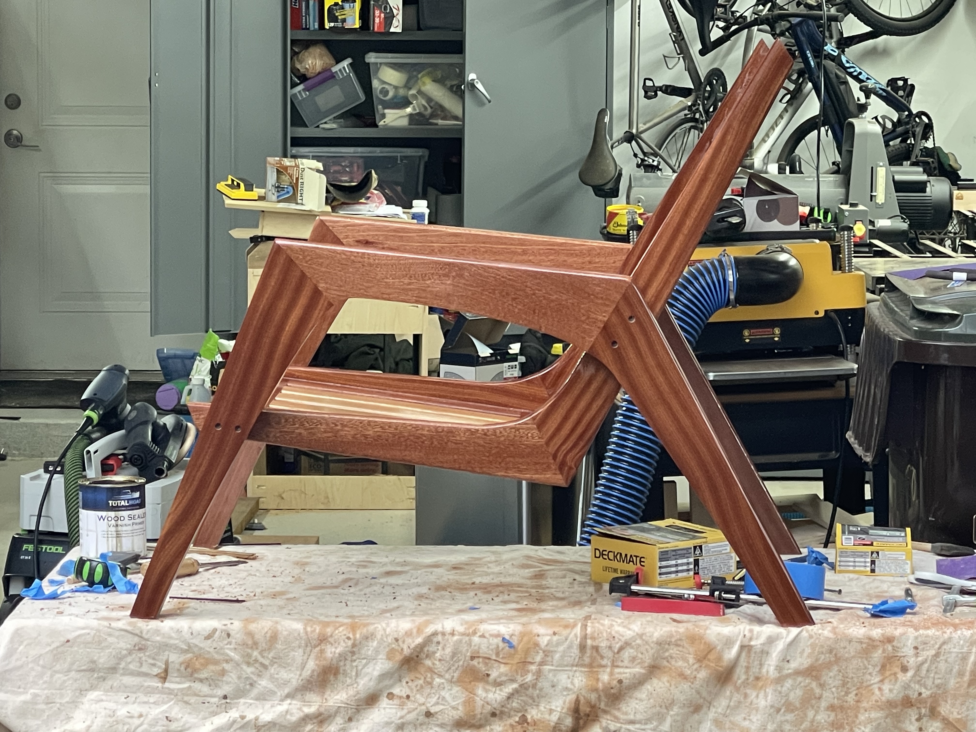

VPI Posted October 9, 2022 Report Posted October 9, 2022 So I ended up putting the legs on but I am not entirely sure I trust the 150 hipsterās design to hold real people weights.Ā It is just two areas of glue up and 4 2ā screws per side (my addition).Ā Trying to figure out some kind of reinforcement I can throw on the chair so I donāt get sued when it collapses under someone.Ā Ā Quote
swt61 Posted October 9, 2022 Author Report Posted October 9, 2022 The legs are splayed a bit, but it still seems to me that most of the weight is placed in a downward force on the legs themselves. Not the joints. As for the screws, they are holding the weight horizontaly, not vertically. So there's no danger of the screws pulling out. It's all about the shear strength of the screw, not the holding power of the threads. It seems like a pretty sound design to me. A piece connecting the front and back legs, down low would add a lot of strength, but probably take away from the overall esthetic.Ā 1 Quote

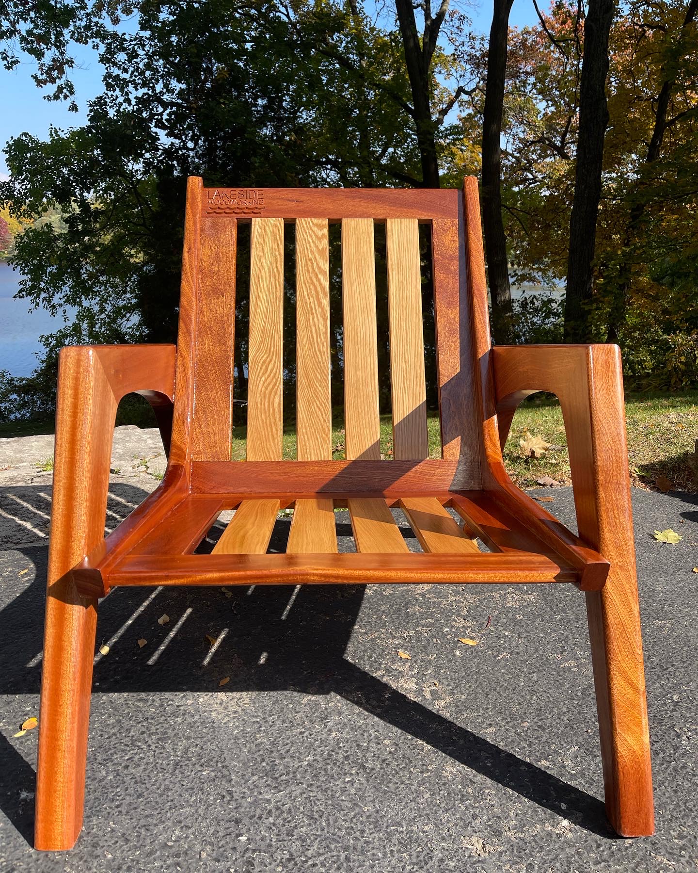

VPI Posted October 11, 2022 Report Posted October 11, 2022 I really need to hire an intern for finish work. Ā I suck massively, especially when doing a million angles as I get at least one streak in every coat.Ā As good as I can get it.Ā 11 Quote
n_maher Posted October 11, 2022 Report Posted October 11, 2022 Looks pretty great to me, Jeff. How much does the internship pay? 1 Quote
Voltron Posted October 11, 2022 Report Posted October 11, 2022 It came out great Jeff! And it seems you haven't ended up on the ground in a pile of sticks so it is holding together! Quote

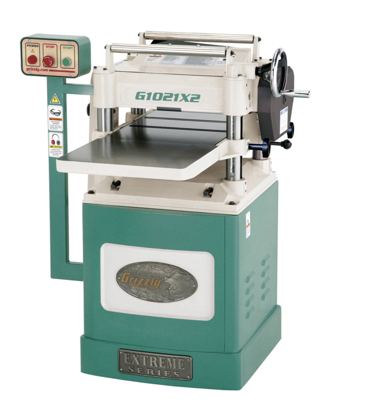

VPI Posted October 11, 2022 Report Posted October 11, 2022 Just to make Doug shake his head in disgust, I upgraded the Dewalt planer during the two day sale at Grizzly.Ā Ā I KNOW, I should have just bought a Hammer combo. I am not a smart man.Ā 2 1 Quote

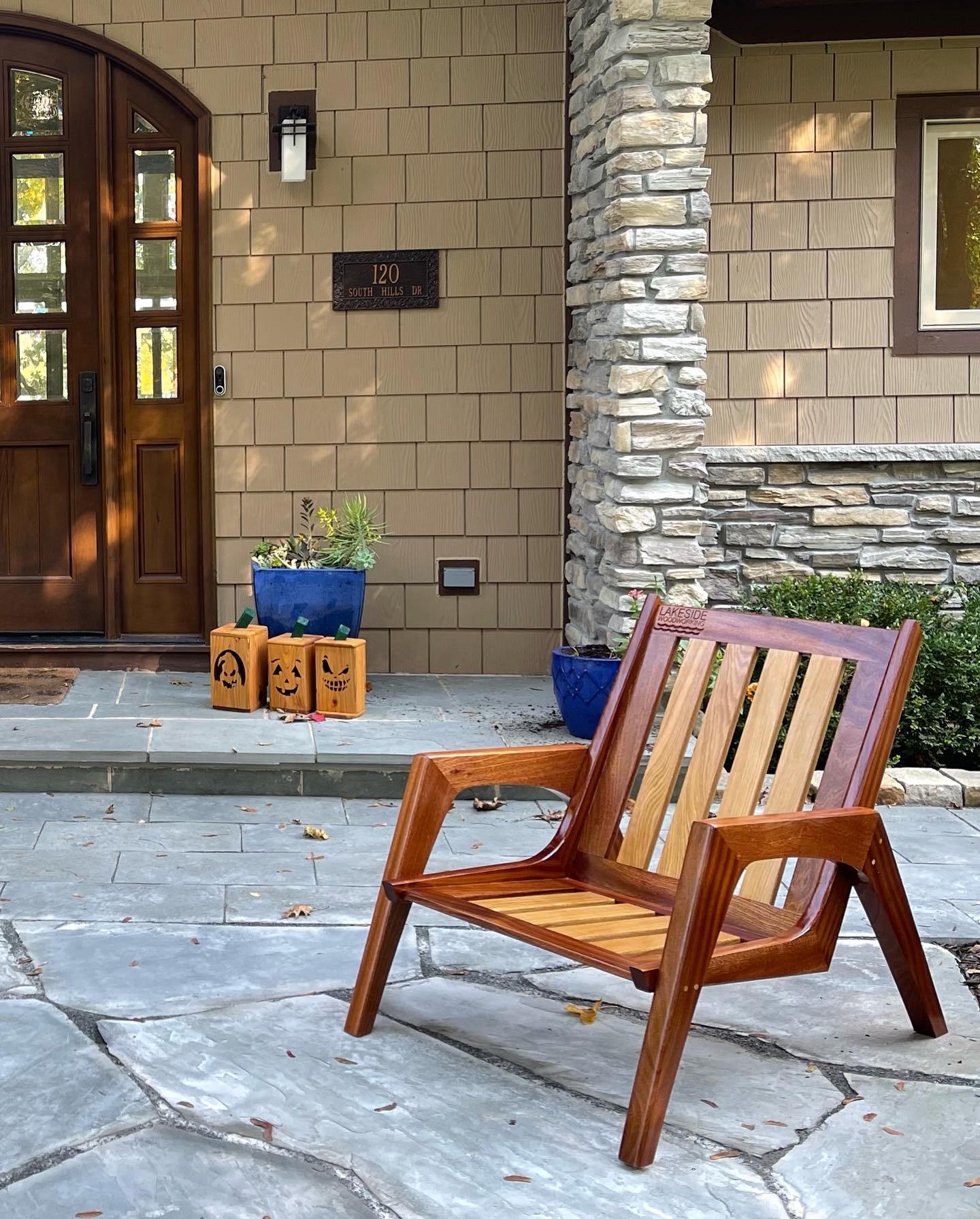

VPI Posted October 18, 2022 Report Posted October 18, 2022 Also, I think I need to raise my Adirondack pricing.Ā Ā Quote
