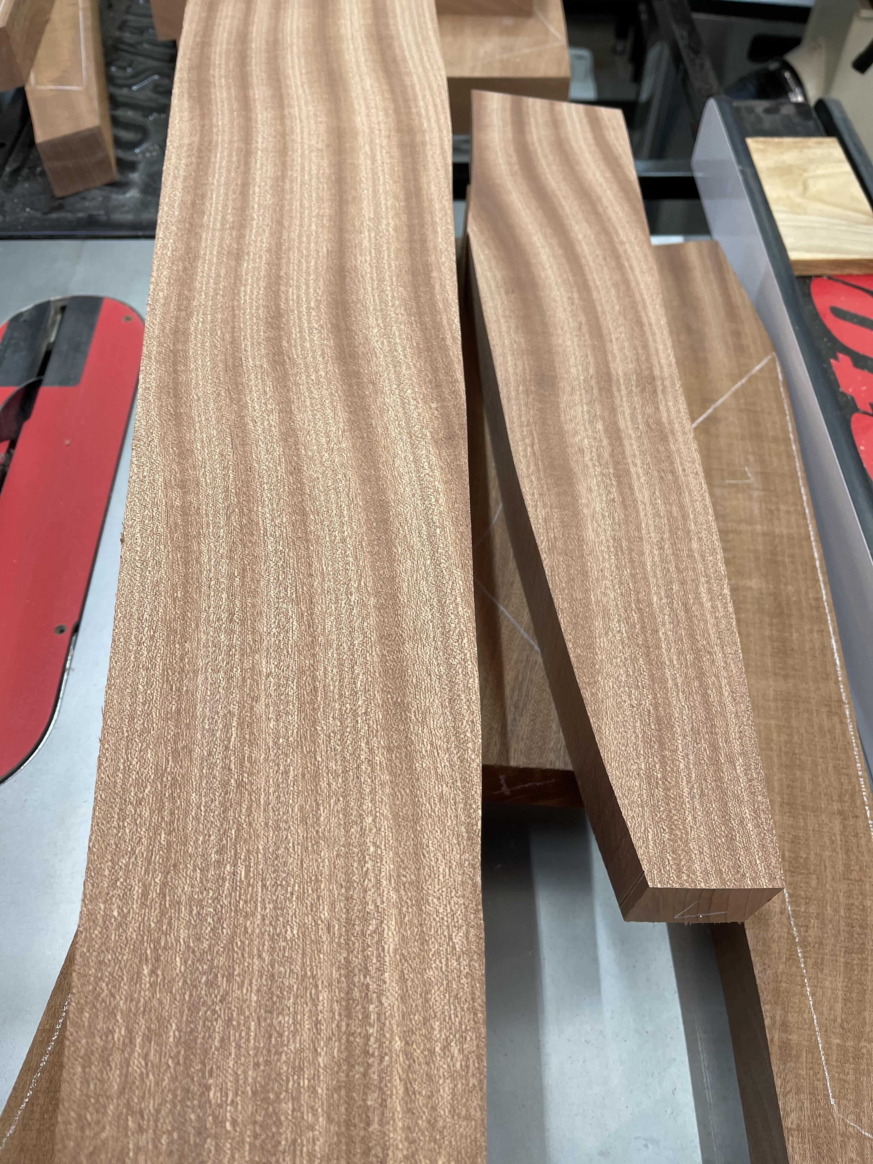

On 9/28/2022 at 11:45 AM, swt61 said:
Those are going to be some gorgeous chairs. Really beautiful wood!
The Sapele is certainly looking nice after jointing.
Also, I should have gotten the big jointer and automate dust solution a long time ago
Edited by VPI
  • Like 5

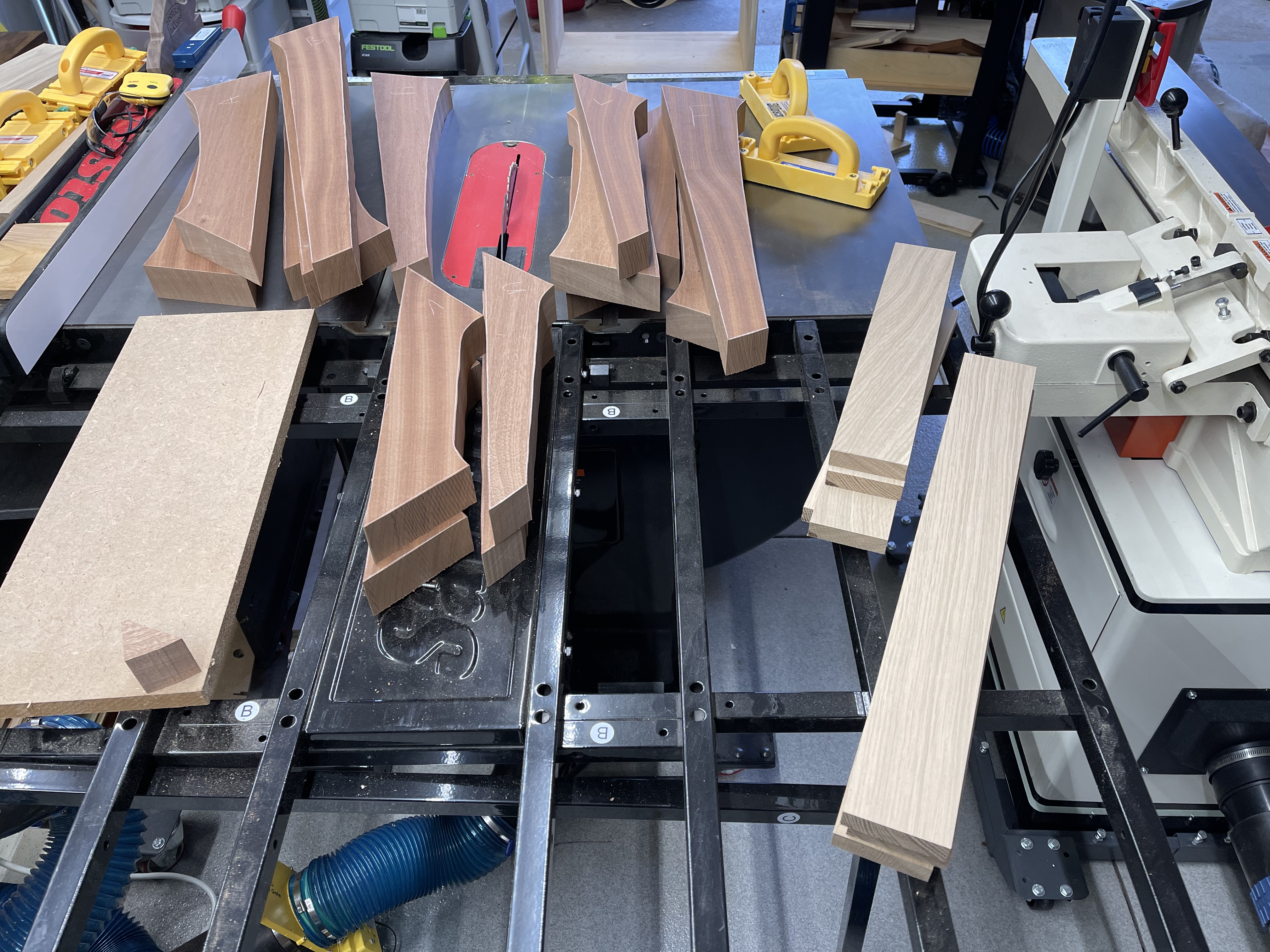

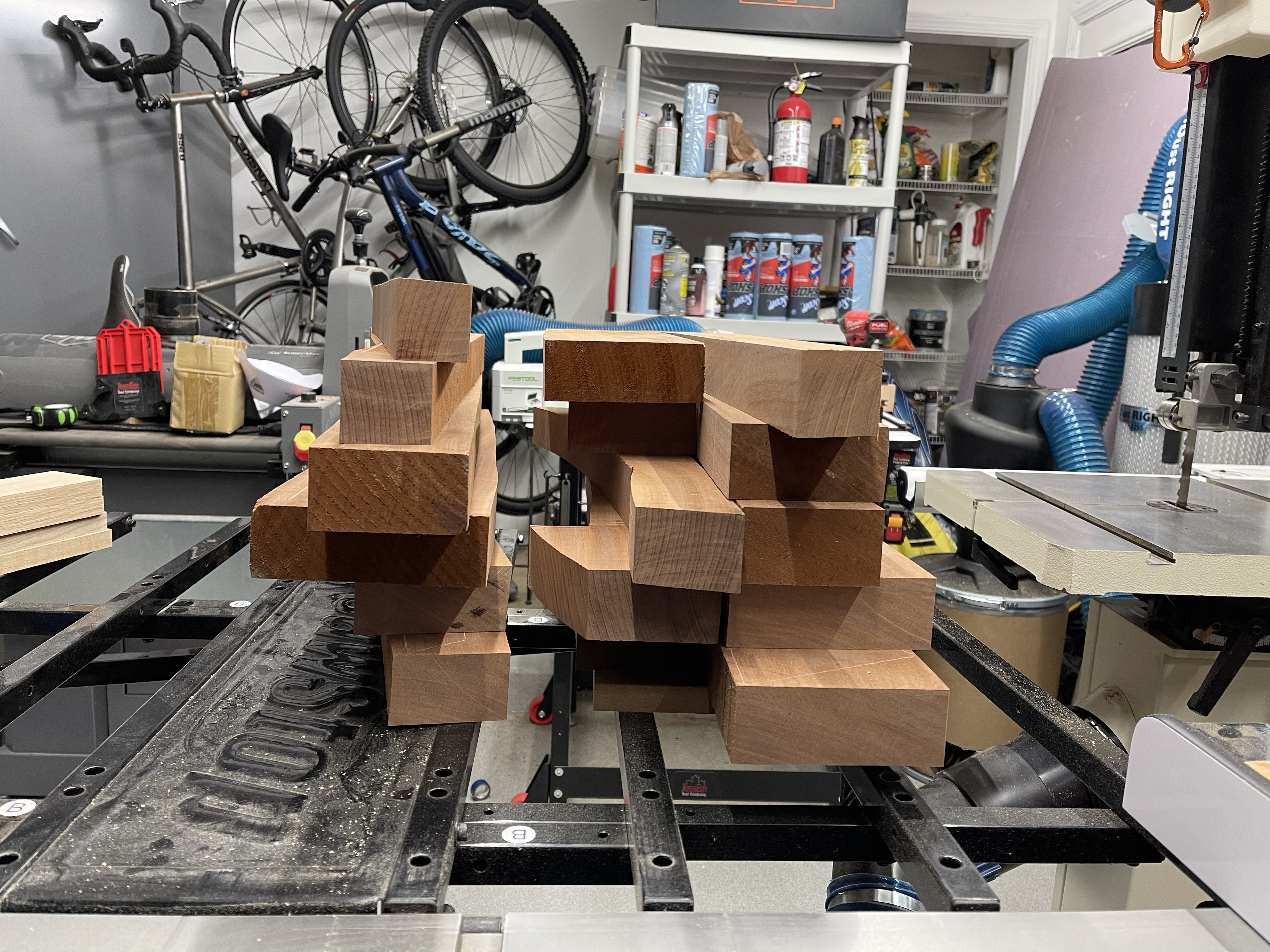

Posted
Did a ton of bandsawering for the legs and seat edges for the chair and managed to make a giant, expensive pile of weirdly shaped cutoffs I need to come up with a project for.

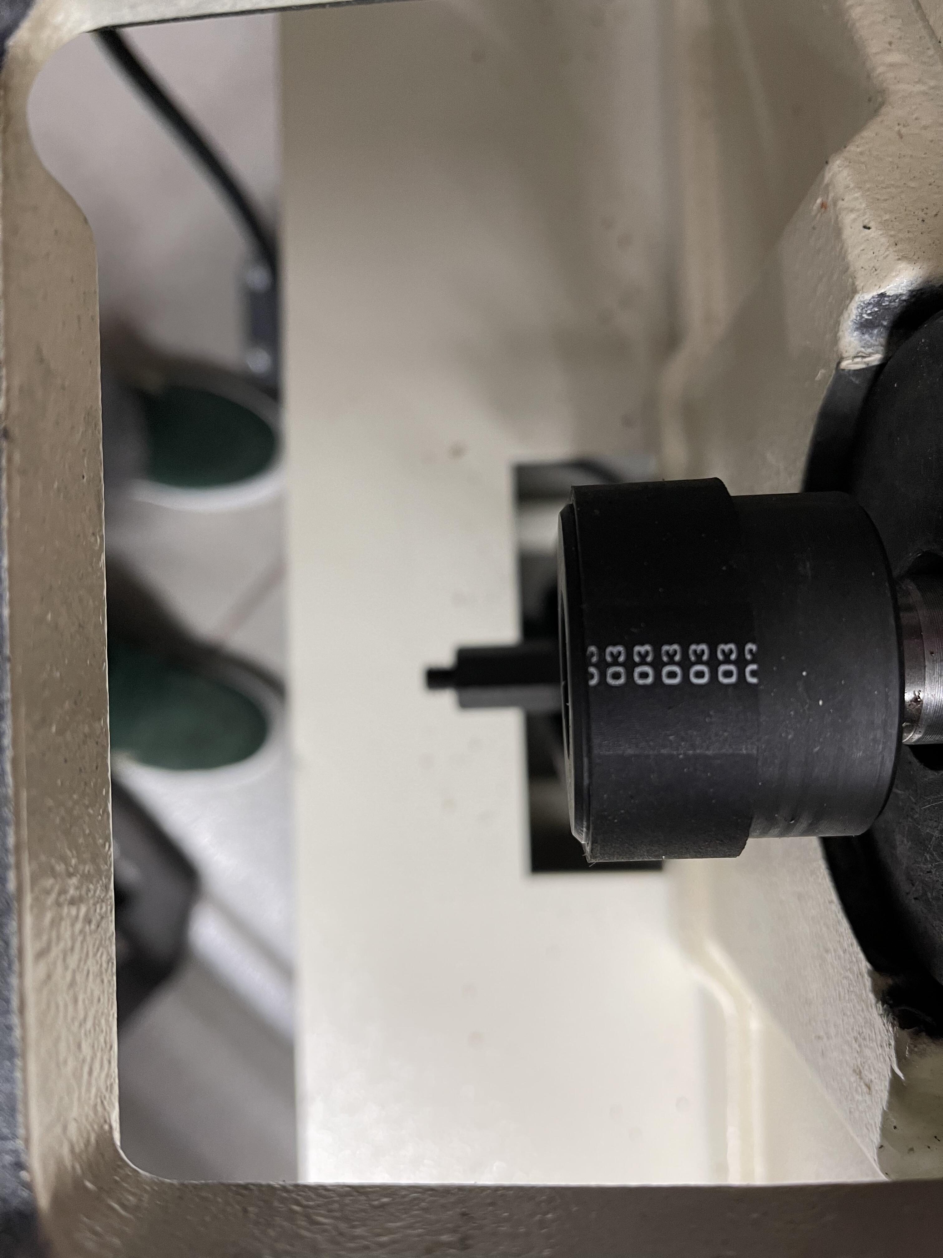

Posted
So regardless of the coplanarity, I decided to use a digital angle gauge and zero it on the top pulley and see if the motor pulley matches and it is a full 2.4 degrees off. Not exactly accurate due to the gauge but seems excessive and could certainly be attributing to throwing the belt.
The motor mount slides down at an angle on the dust chute so I am having trouble figuring out how to level the pulley. Shims under one side???

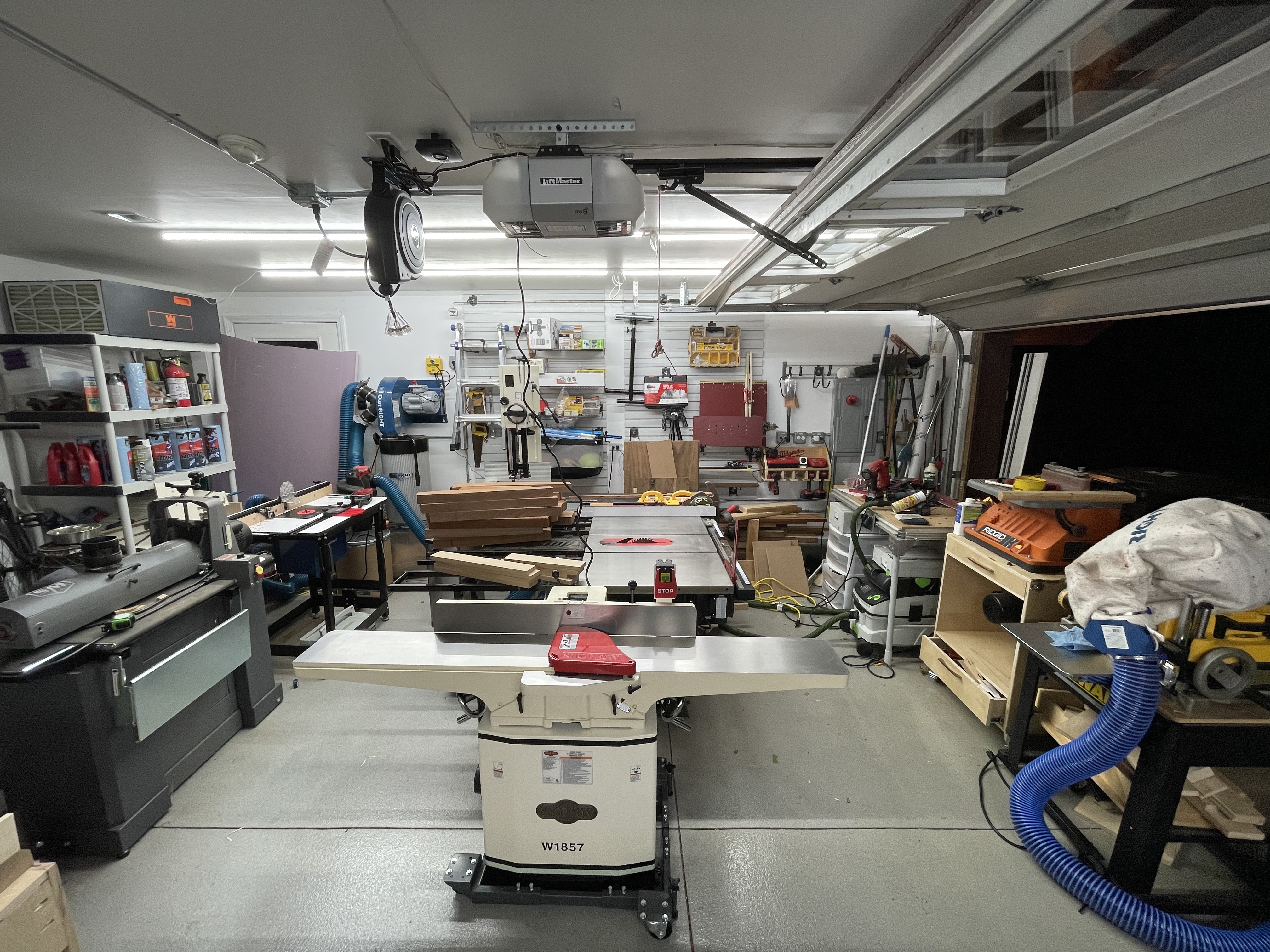

Posted (edited)
3 hours ago, swt61 said:
I can only assume others with the same model have had this issue. Surely there's a forum where someone has found a fix?
I've never had the room for a bandsaw, so have no real experience with the day to day operation
Yeah. This is the new jointer, but going through threads on Grizzly/Shop Fox to see if anyone sees this issue. Most have problems with misaligned pulleys so I will go with what the plumb Bob is showing me and move the cutter pulley back a 1/4” and see what blows up next.

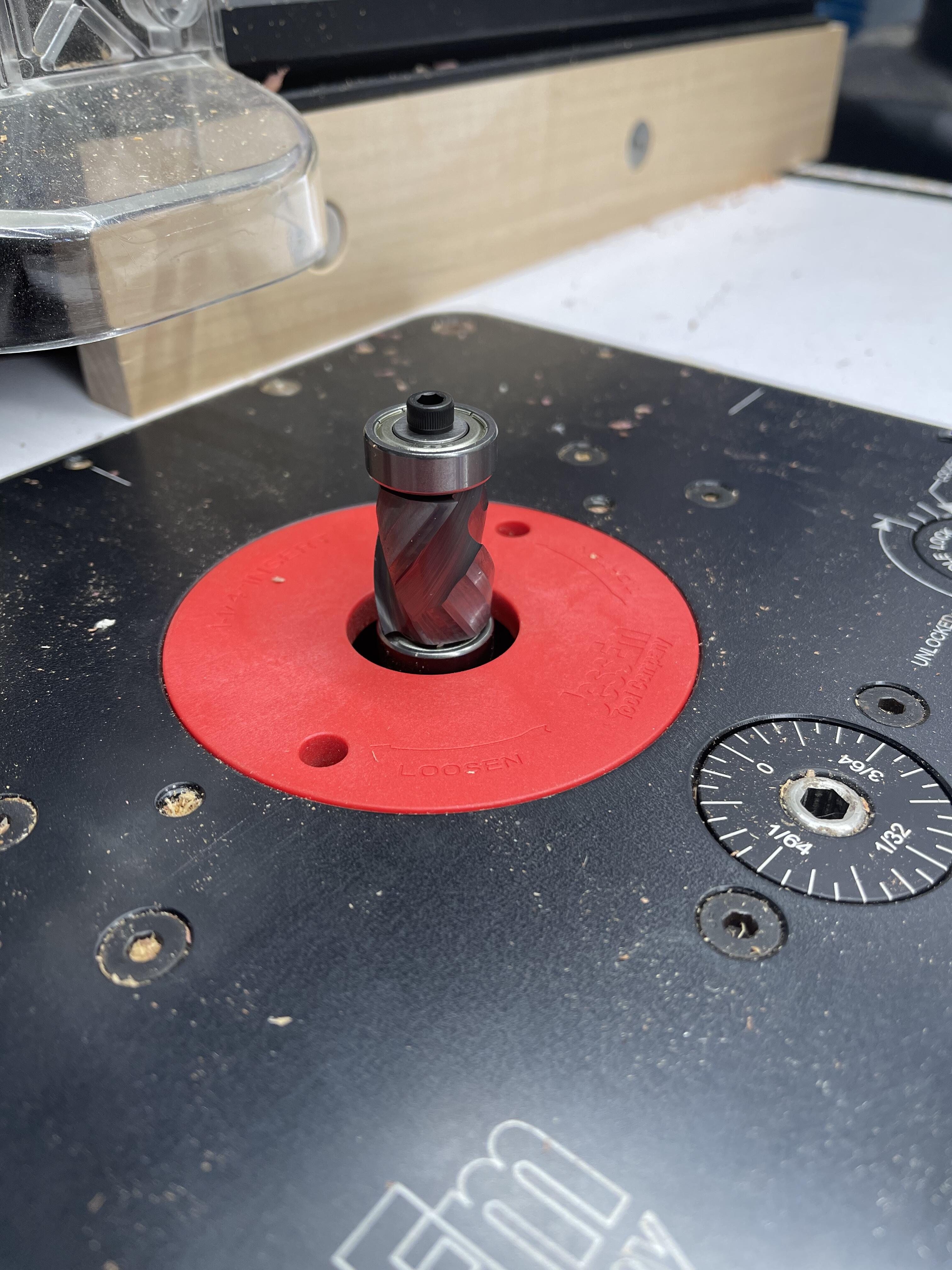

Posted
I really want to get a nice set of downward spiral and upward spiral flush trim bits.
I love that you don't need to worry about grain direction and chip out. I have heard that the closer you cut to your template first, the better the routing results. Which is just good practice even with a common flush trim bit.

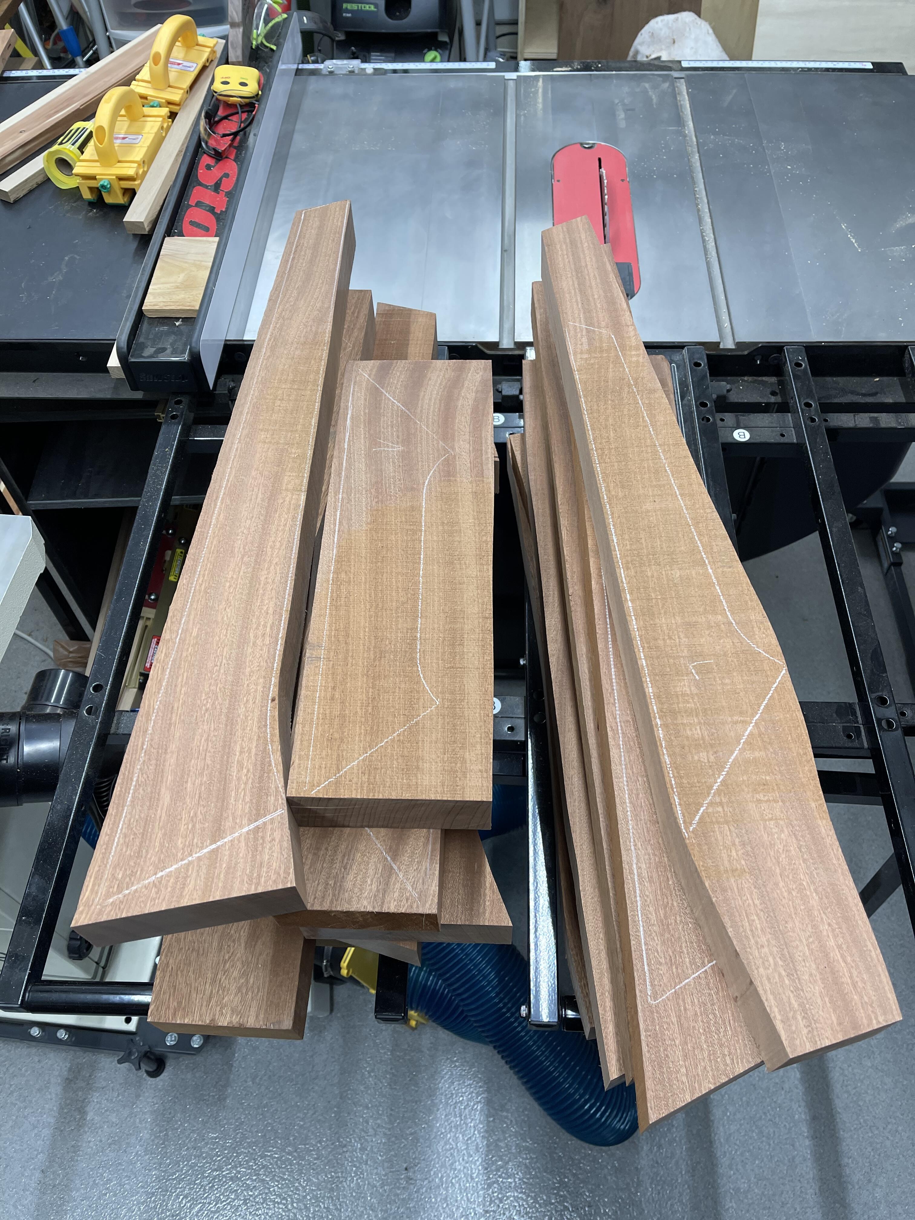

Posted
Yeah, my primary problem is the thickness of the legs. 1 3/4” and the ultimate is only 1 1/4 so I had to start with handheld router to copy the template onto the wood and now I will use that cut out as the template for the big bit.
  • Like 1
