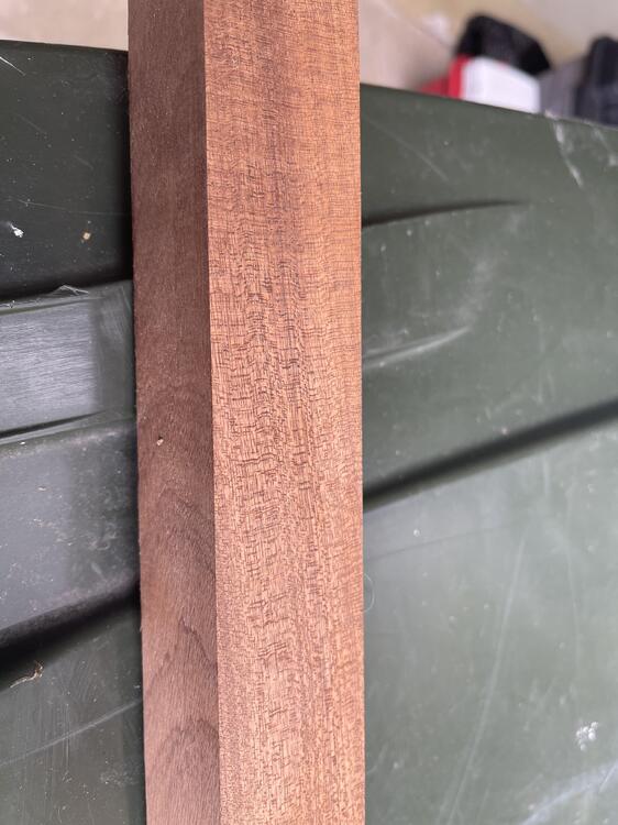

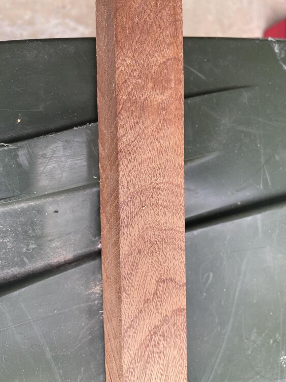

VPI Posted September 15, 2022 Report Posted September 15, 2022 Any wood guys that can guess the type of wood? I have over 100 1.5x1.5x8’ strips of this wood. Really heavy, almost looks like Mahogany on the edges but I am not sure. Quote
swt61 Posted September 15, 2022 Author Report Posted September 15, 2022 (edited) Hard to pinpoint exactly, but it's a Mahogany derivative of some type. Could be Sapele. Edited September 15, 2022 by swt61 1 Quote
VPI Posted September 15, 2022 Report Posted September 15, 2022 3 minutes ago, swt61 said: Hard to pinpoint exactly, but it's a Mahogany derivative of some type. Could be Sepele. That is what I am thinking. Looking for scraps to nail into a bench for the new front seating area. Quote
naamanf Posted September 15, 2022 Report Posted September 15, 2022 What Steve said. Sapele would be my guess. Quote
dsavitsk Posted September 15, 2022 Report Posted September 15, 2022 Sapele isn't particularly heavy. Quote

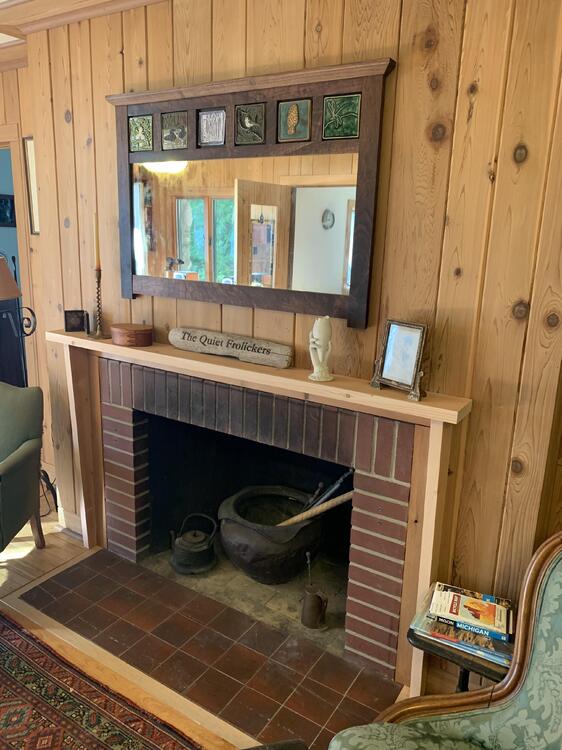

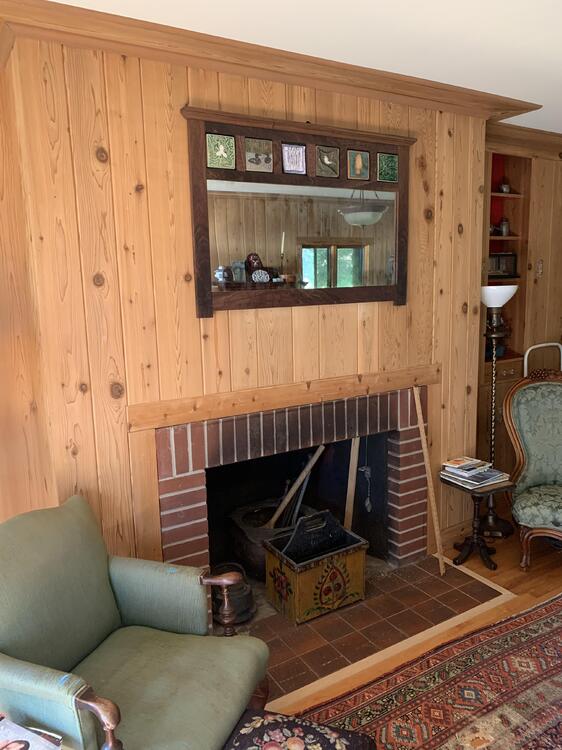

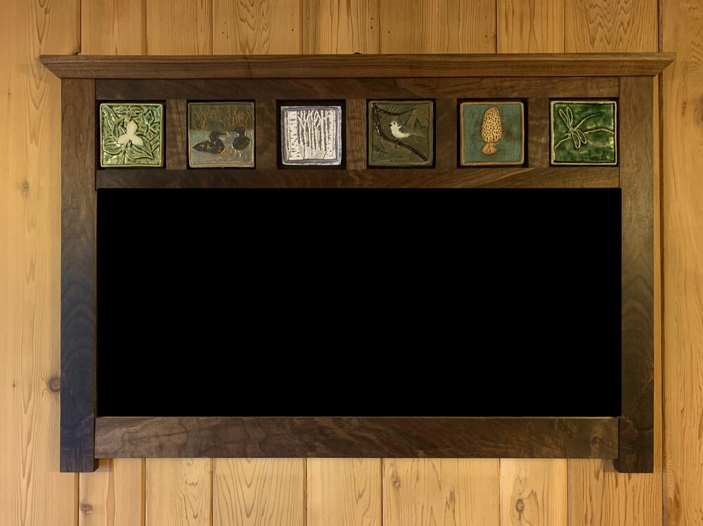

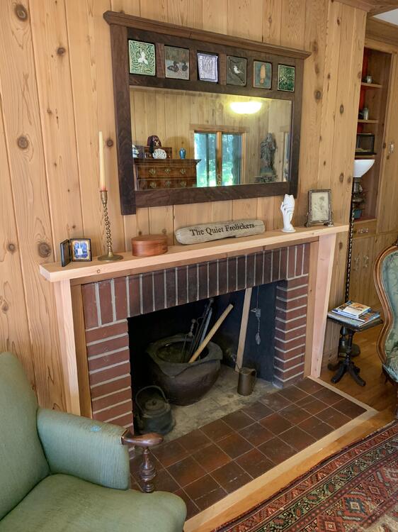

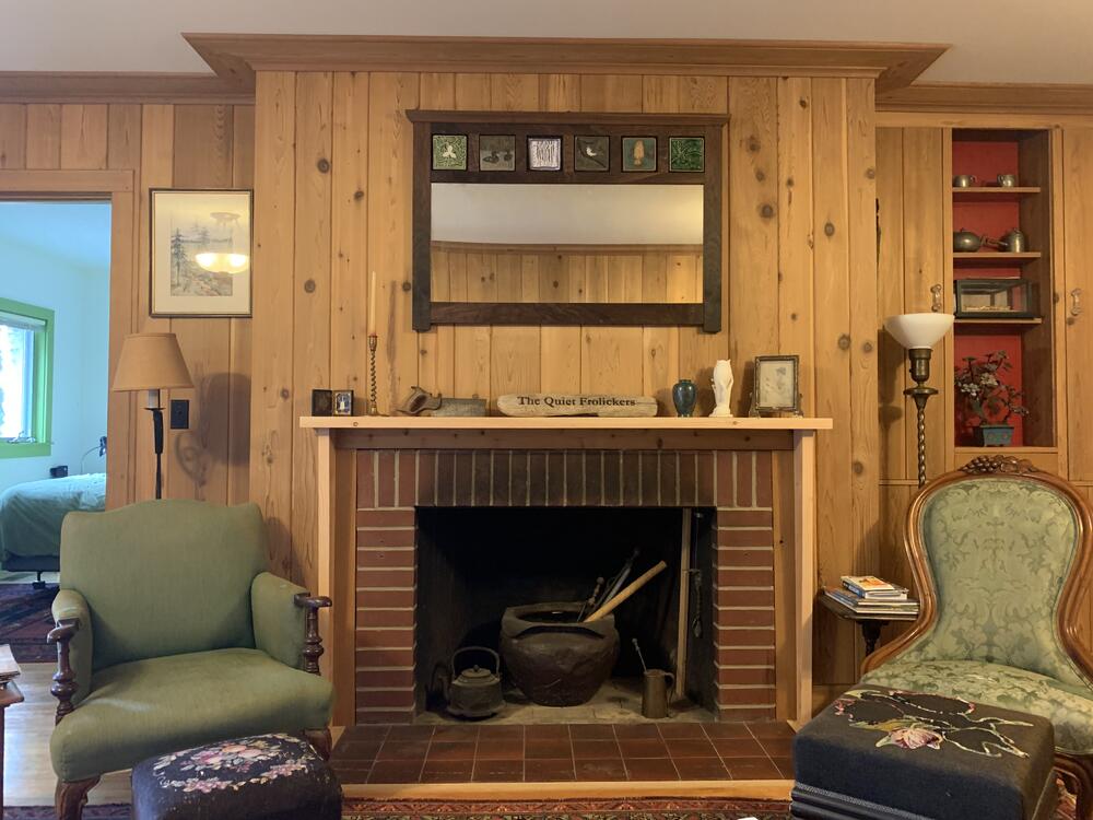

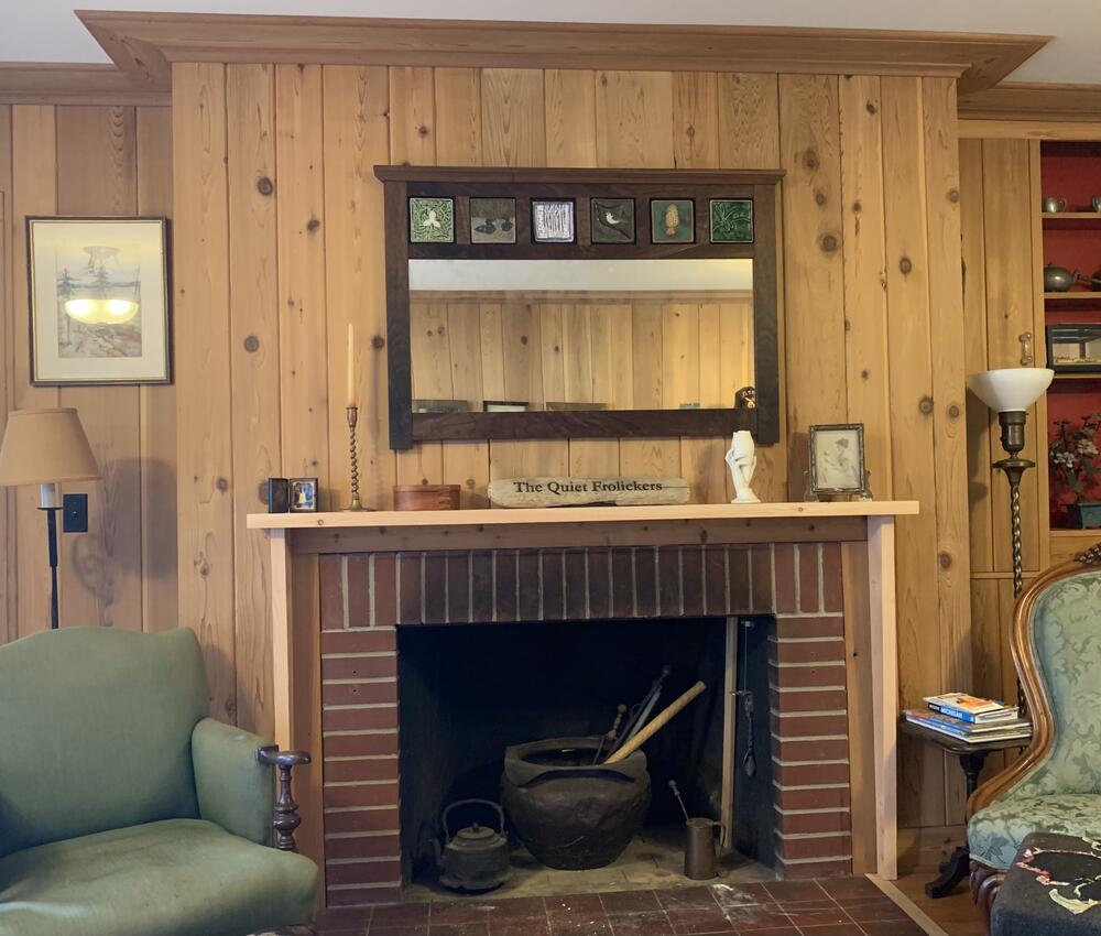

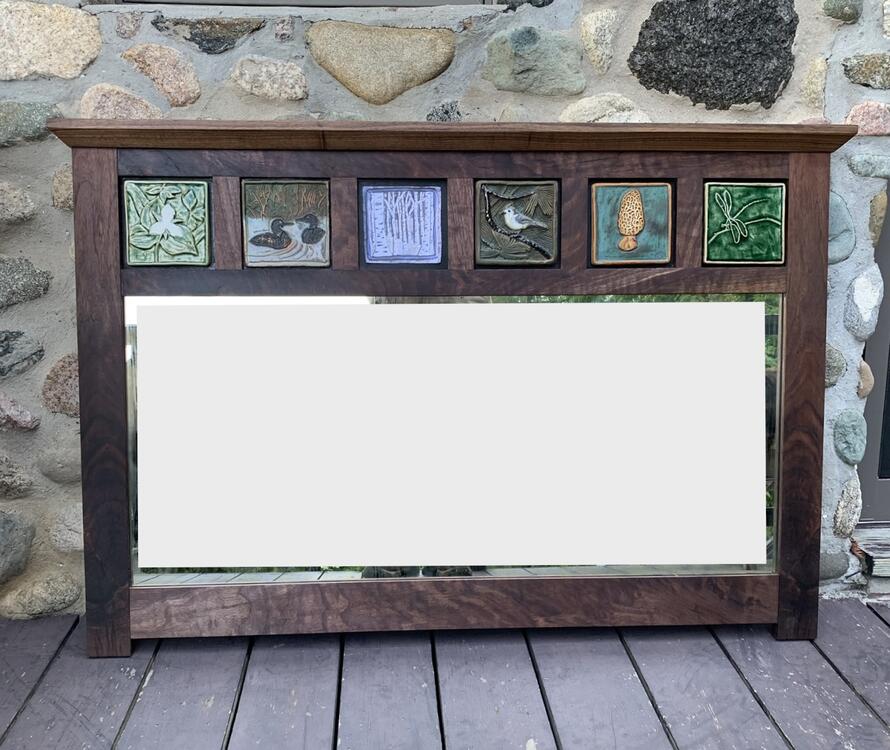

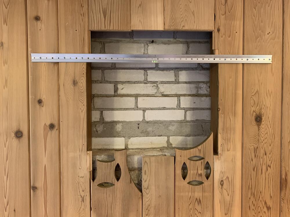

Voltron Posted September 17, 2022 Report Posted September 17, 2022 Well, it seems one person is anxious for this report on the simple mantle. The original idea was to make a mirror to cover a niche over the fireplace that had been occupied by a Madonna and Child sculpture for many years at Claire's family place in Michigan. The other idea was to incorporate decorative tiles made by a local artist that Claire's mom had collected. I built the mirror up here using vintage mirror glass that was in a basic frame and had Sat in the attic for decades. I milled some curly walnut from a chunky board I bought locally and also some nicely figured walnut from a chunk that was in the shop here for many years. Here is the mirror, with one place holder for a tile we have to add later: I didn't like how high the mirror Sat in order to cover most of the niche. Doug was here visiting for a few days so we decided to make some kind of mantle to add to the fireplace. I was thinking about walnut like the mirror but ultimately felt it did not match the simple room or the paneling that is pine, fir, or cedar or something in the soft wood family. The winning idea was to match the paneling to blend it in. In the shop, Doug immediately pointed out a 2 x 12 that was 6.5' long. I never would have thought about it but we used that to make the mantle. It was *just* wide enough and long enough to make a 6" deep top and the tapered legs. We drew out the legs on opposite ends of the remainder and used a jigsaw to separate them before using a tapering jig screwed to a long board to run it through the table saw. I also managed to get Doug to use the Kreg pocket jig and pocket screws to attach the top to the legs and the mantle to the wall. I still felt the mirror was too high. Claire and Doug separately suggested flipping the paneling boards above and below the niche so that the longer bottom boards were on the top and the pierced boards were on the bottom. Hard to explain without a before photo but here is the niche after I flipped them and made a new middle board from the former ledge shelf. I also really like the metal low profile French cleat I got for the mirror. So here's the mirror and the mantle as it is now. We are debating a little stain for the mantle versus waiting until it ages a bit, and secondly whether to chamfer the mantle edges or perhaps make a miter cut across the front to give the simple mantle a little visual interest. 11 Quote
swt61 Posted September 18, 2022 Author Report Posted September 18, 2022 Excellent! And the idea to swap the boards above and below the niche was spot on. Everything is proportionate and balanced now. I also love the simple look of the mantle, with the elegant tapered legs! Personally I would avoid staining. It never matches quite right, but I like how the lighter mantle kind of mimics the frame around the hearth tiles. Really nice design! 1 Quote
VPI Posted September 18, 2022 Report Posted September 18, 2022 I like it as is but for any additional interest I would go Mitre across the front and some finish that won’t see the wood non-uniformly darken with smoke for my vote. I found a woodworker neighbor that used to have a cabinet shop. He is offering my choice of these for a set of chairs. Both older models but fairly heavy duty and appear to be in good shape. I typically have about $450 invested in a pair of chairs at this point so either would be worthwhile, just not sure if I want anything that I have to try to track down helical heads for. https://www.grizzly.com/products/grizzly-8-x-65-super-heavy-duty-jointer/g1018 https://www.woodstockint.com/products/w1741w 3 Quote

dsavitsk Posted September 18, 2022 Report Posted September 18, 2022 Agree. Helical heads are nice, but not necessary. People jointed boards for a long time without them. The shopfox is 2x the hp, has more knives, and has some other features that might be worth having. Either should be great. 7 hours ago, Voltron said: Well, it seems one person is anxious for this report on the simple mantle. I think the simplicity belies the amount of consideration and thought that went into it. We went through a lot of design ideas before coming to this. Minimalism is harder than maximlism. 2 Quote

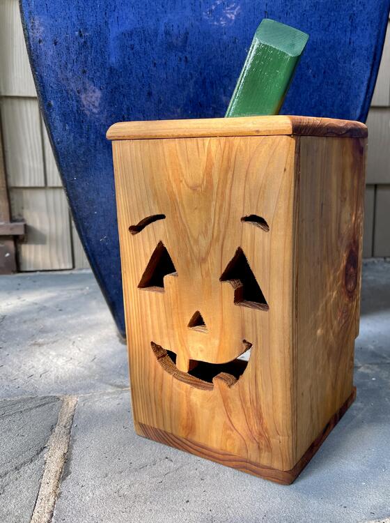

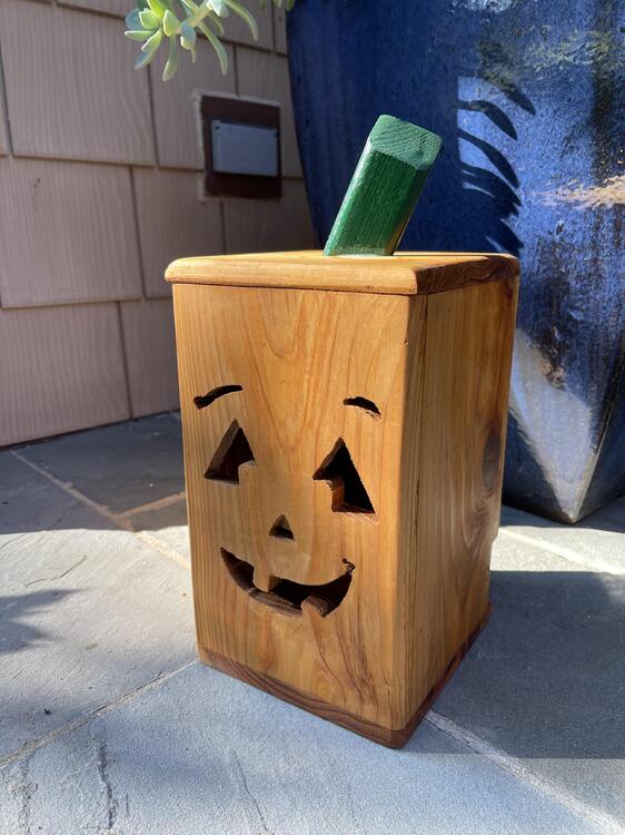

VPI Posted September 18, 2022 Report Posted September 18, 2022 According to YouTube, everyone with a wood shop should be making these now so, why not. I call this one “Brent, after they used the jaws of life to get that go-cart helmet off” 1 2 Quote

Voltron Posted September 18, 2022 Report Posted September 18, 2022 Yeah, I had that backwards in my head. Very similar design but I was thinking Grizzly was the better version. And as for the mantle, I meant to say that I am leaving it the way it is for now and will let it age and grow on us. 1 Quote
