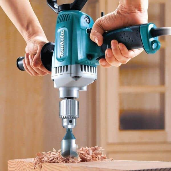

luvdunhill Posted May 30, 2022 Report Posted May 30, 2022 23 hours ago, n_maher said: My 2c is rent a beast and get it done, just make sure it is designed for 2-handed operation as you don't want that much power/torque without it, in my opinion. And it seems to me that this is a pretty task-specific tool so buying something is of very limited utility. The rental options this weekend were pretty much only a Makita SDS hammer drill and I wasn’t sure they would have a wood bit or if even such a thing exists, so I decided to try this: the battery life seems great but the tool seems to overheat way before the battery runs out. It was 100F outside, maybe that’s the issue? Hm. Quote

swt61 Posted May 30, 2022 Author Report Posted May 30, 2022 (edited) I'm almost completely battery powered these days, but I keep a big corded drill for some tasks. Mostly mixing grout and such, but also for boring holes. This is the one I own. It's around $215. You could do as many people do... Buy one at Home Depot, be careful with the packaging, use the drill, box it back up and return it. Tell them it didn't work well for what you need. Edited May 30, 2022 by swt61 Quote

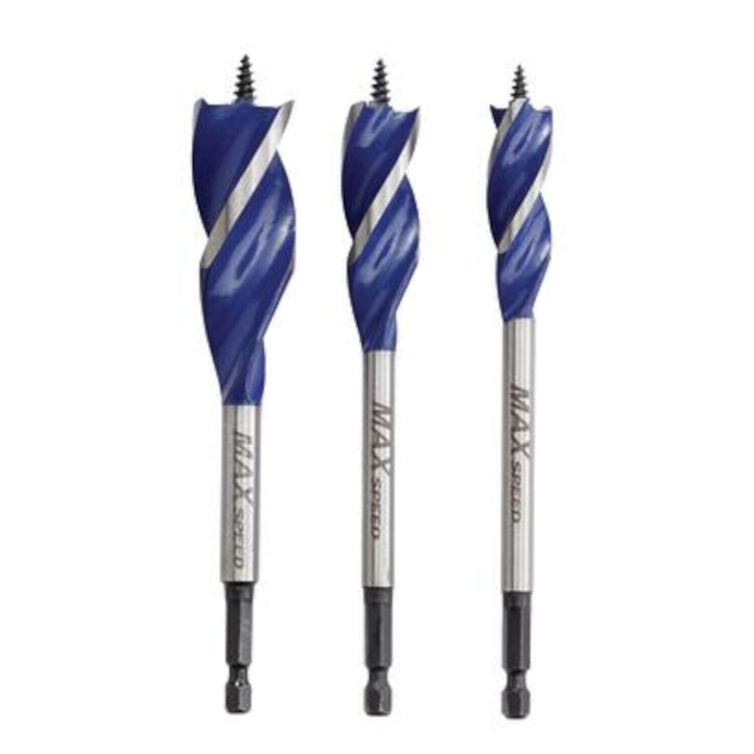

luvdunhill Posted May 30, 2022 Report Posted May 30, 2022 1 hour ago, VPI said: I love my Milwaukee M18 Fuel gear. It is pretty much my whole arsenal from chain saw to leaf blower here. Spade bits are fucking awful bits for pretty much anything and if it is no longer sharp after hundreds of holes, I would ditch for a 1” auger bit. That is what I used to drill holes so I could fill a stump with kerosene before torching it. No issues as all with the Milwaukee drills. There is no reason any drill cannot drill into cedar, unless the bit has been worn down to a spinning blunt object. I can’t find a 1” auger with 1/4” shank though. It’s going pretty well with the Diabolo bits. The impact driver won’t stay cool though, it’s insanely hot. Quote
swt61 Posted May 30, 2022 Author Report Posted May 30, 2022 It's too much friction. Your chances of burning up the motor are high. It turns out that there are some speed bore auger bits... Quote
luvdunhill Posted June 4, 2022 Report Posted June 4, 2022 Ok, returned the red impact driver and looked at the turquoise one but got the red screwdriver. Then left the orange store and went to the blue store to get the bit. Still overheats but works much better. Can get about 8 holes in before it’s too hot. 2 Quote

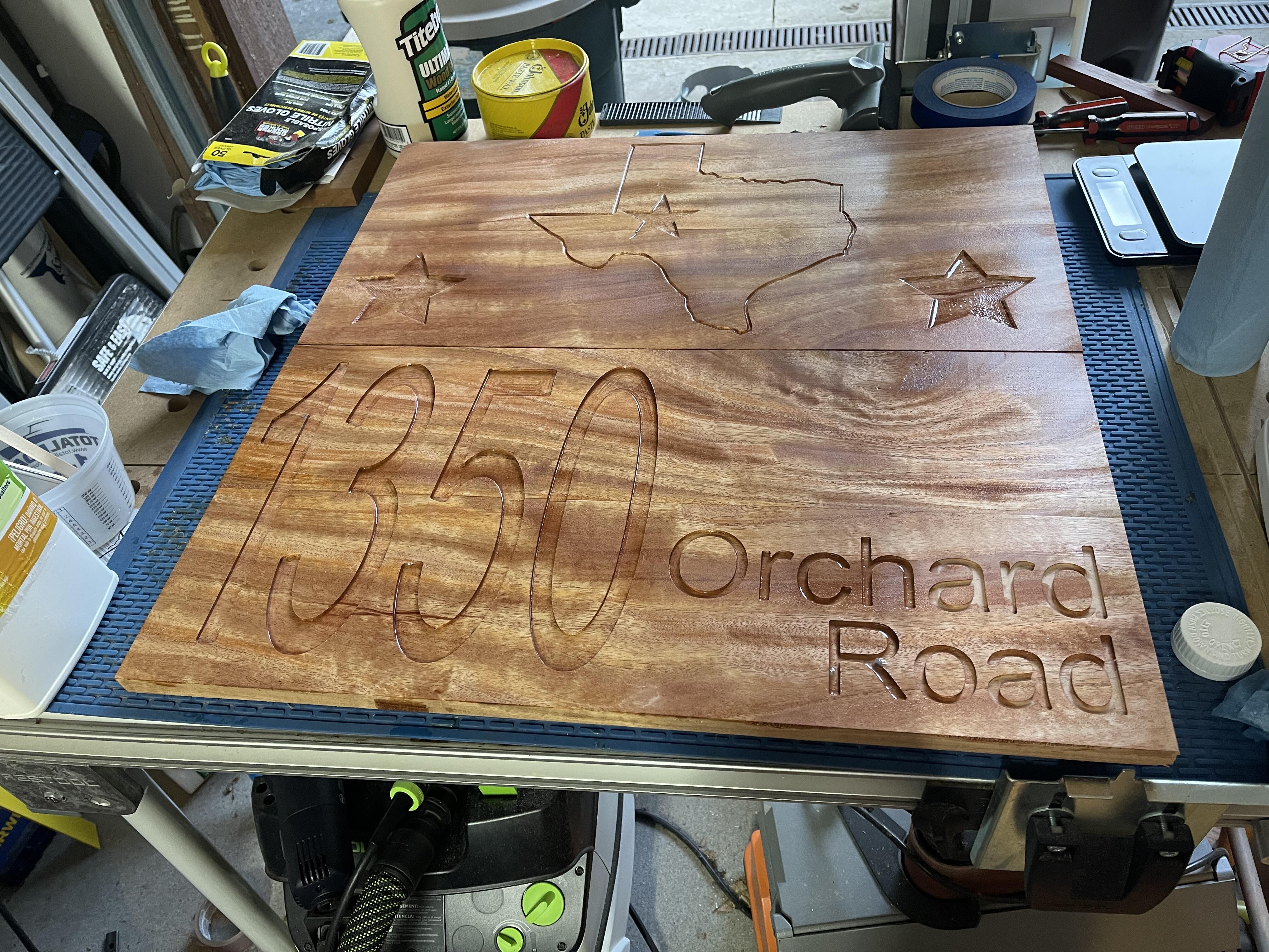

VPI Posted June 6, 2022 Report Posted June 6, 2022 Broke my first CNC bit. Clearance pass for a v carve on an inlay plug. Ended up being about .15 inches on the first pass, which evidently was too much for the 1/4” downcut bit. Quote

n_maher Posted June 7, 2022 Report Posted June 7, 2022 3 hours ago, VPI said: Broke my first CNC bit. Clearance pass for a v carve on an inlay plug. Ended up being about .15 inches on the first pass, which evidently was too much for the 1/4” downcut bit. See if you can figure out what exactly caused it. That's not all that deep a cut (just over half bit depth) so there's probably something else at play and it's always good to see if you can run that to ground before things get really expensive. The only time I broke a bit was incorrectly zeroing the stock and cutting about 3x the bit diameter at standard feeds/speeds. Other close call was an inadequately tightened collet, which caused the bit to slide out and progressively increase depth of cut without warning. Oh, and the one time I put a hold down too close (in) the tool path. Uh, yeah, be careful taking advice from me... Quote

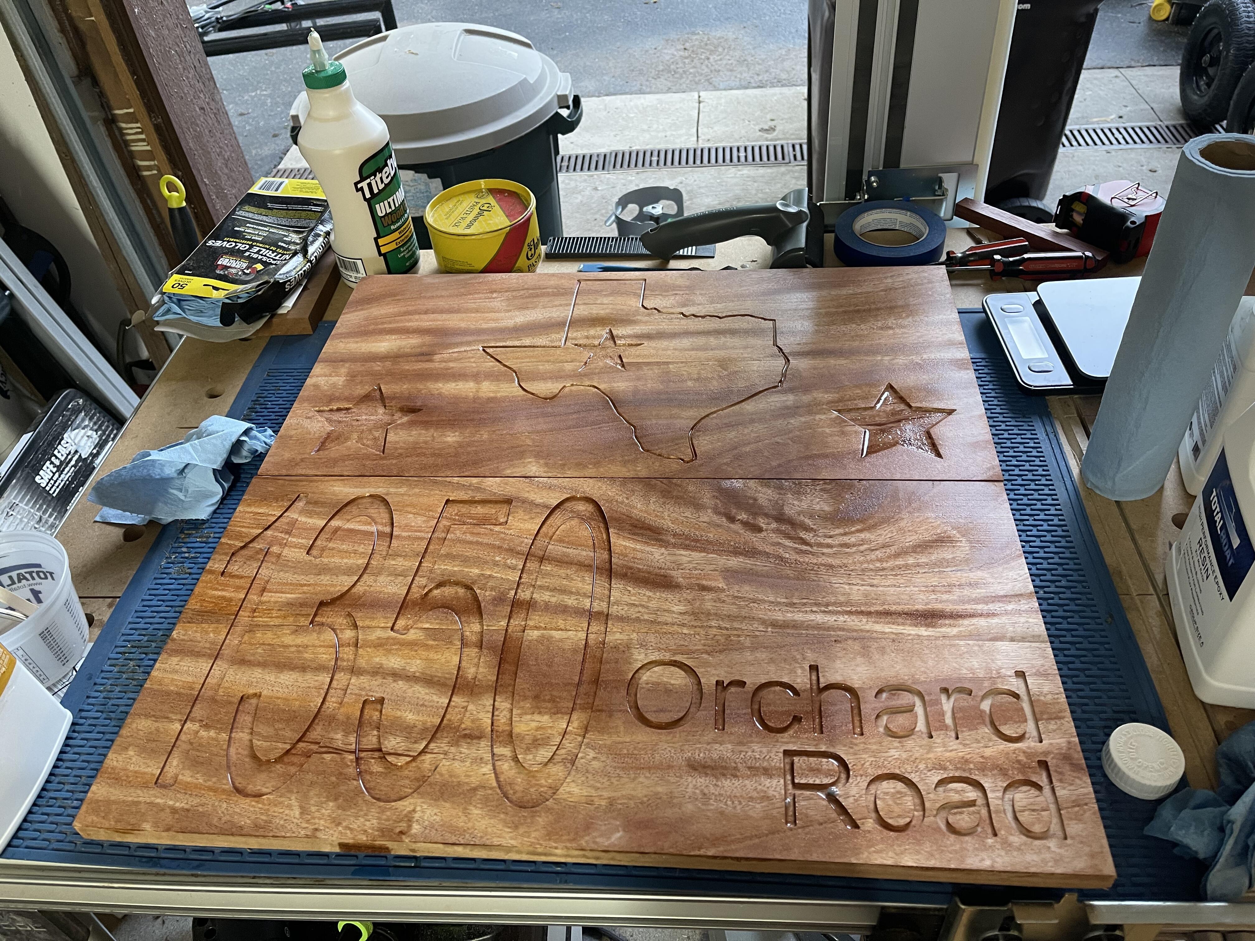

VPI Posted June 8, 2022 Report Posted June 8, 2022 This one was a strange cut as it was the for the plug of an inlay. In VCarve Desktop I cannot see any way to change the depth in the VCarve function by adding passes so I just went with it. Did the top of the clear out and then went to the middle and was not set to ramp so it plunged and started doing its loops and snapped off. It was an Amana Spectra Coated 1/4” down cut which had a nice clean shear right at the collet mark on the bit. Collet should have been pretty damn tight as I tend to be paranoid about random flying 19000 rpm projectiles. In better news I finished the carve of the next yard sign with no drama. This one has such interesting grain, I am not sure if a basic brown text resin will even stand out. Going to paint the Texas, as I was not smart enough to come up with a way to carve it that I could fill with three different resins without having a big purple Texas. 1 Quote
