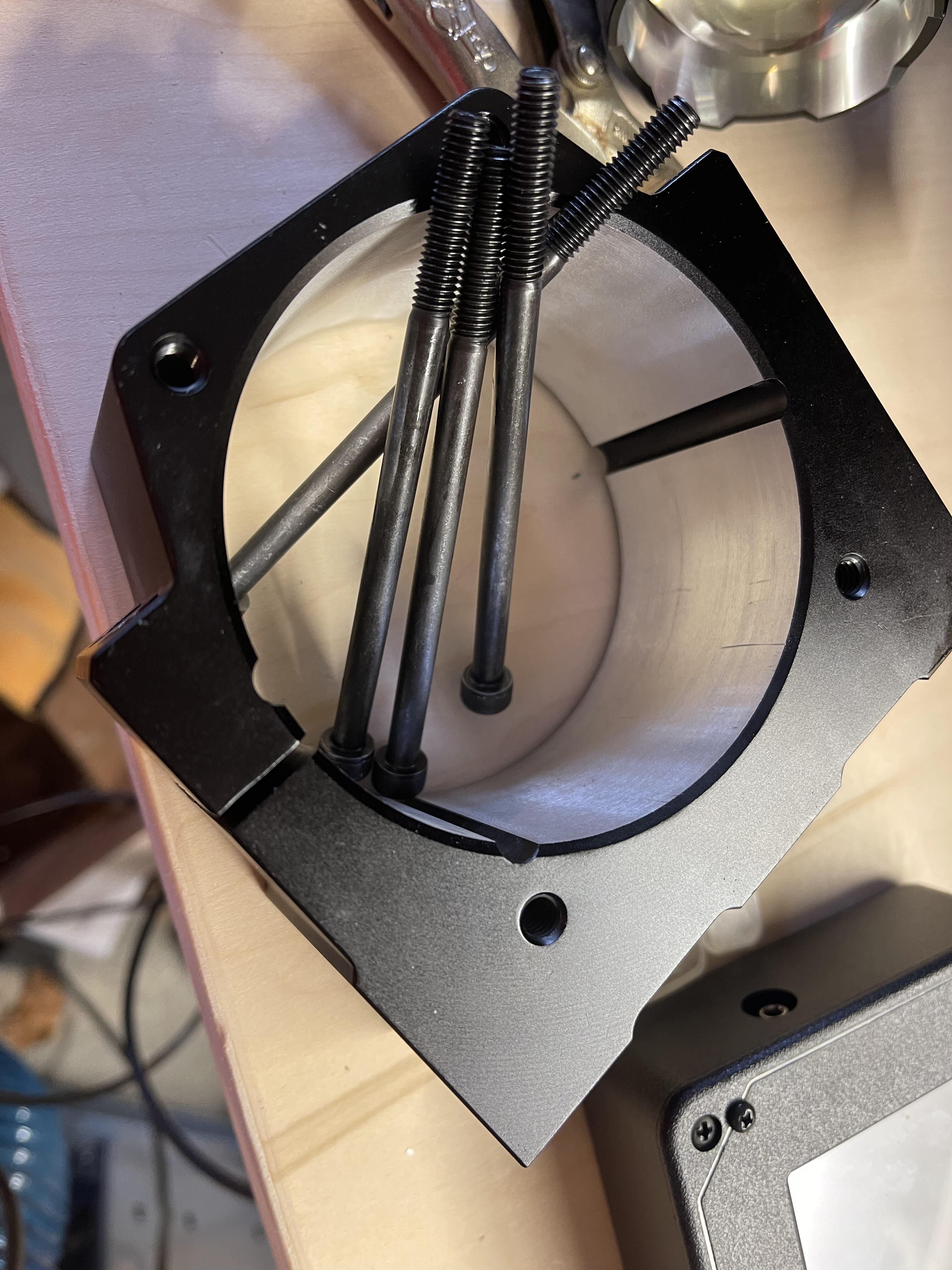

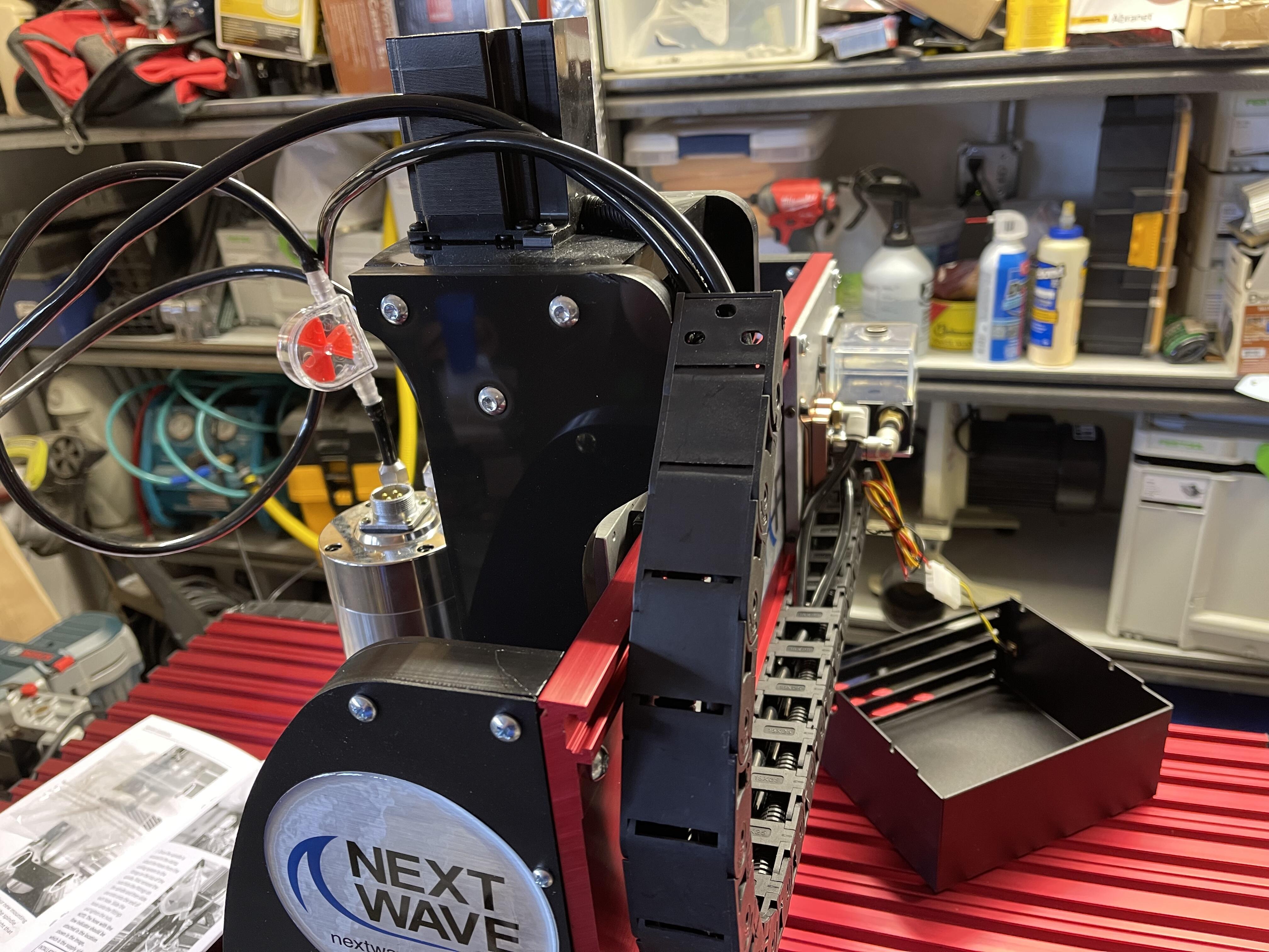

Holy fuck, what a pain in the balls. Finally got all four bolts out since this piece has to come off for the new spindle mount. The last bolt would not move with heat, mallet, etc. and the impact was just going to round it out. Ended up having to use a rubber mallet on the router mount to twist it around and finally broke the last bolt loose.

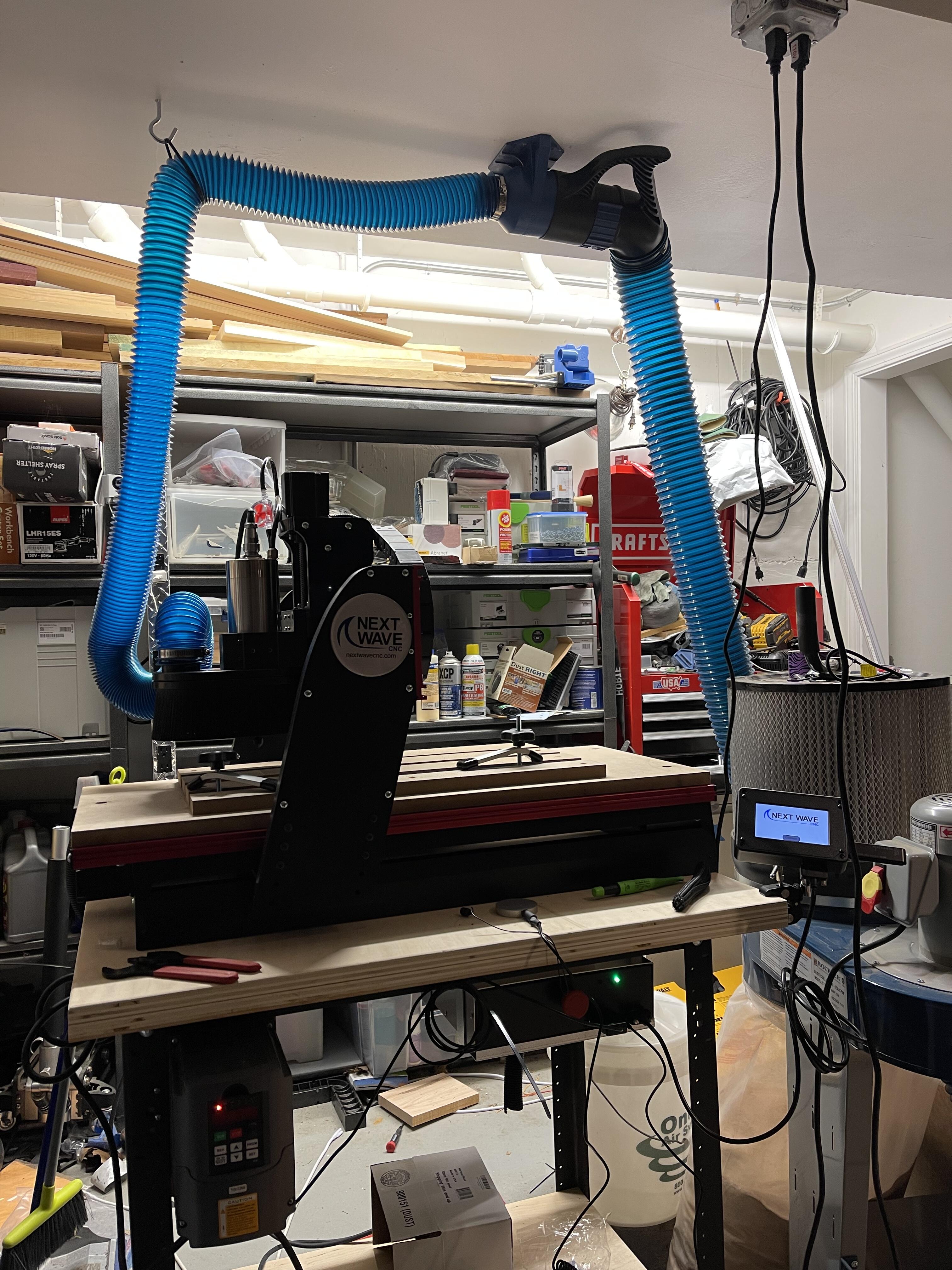

Making through plumbing and wiring now.
I find it hilarious that Next Wave tells you in several places that you should never support the weight of the dust collection hose on the gantry and it has to be hung from the ceiling, while saying nothing about adding 55lbs of junk and liquid to the gantry for the spindle.

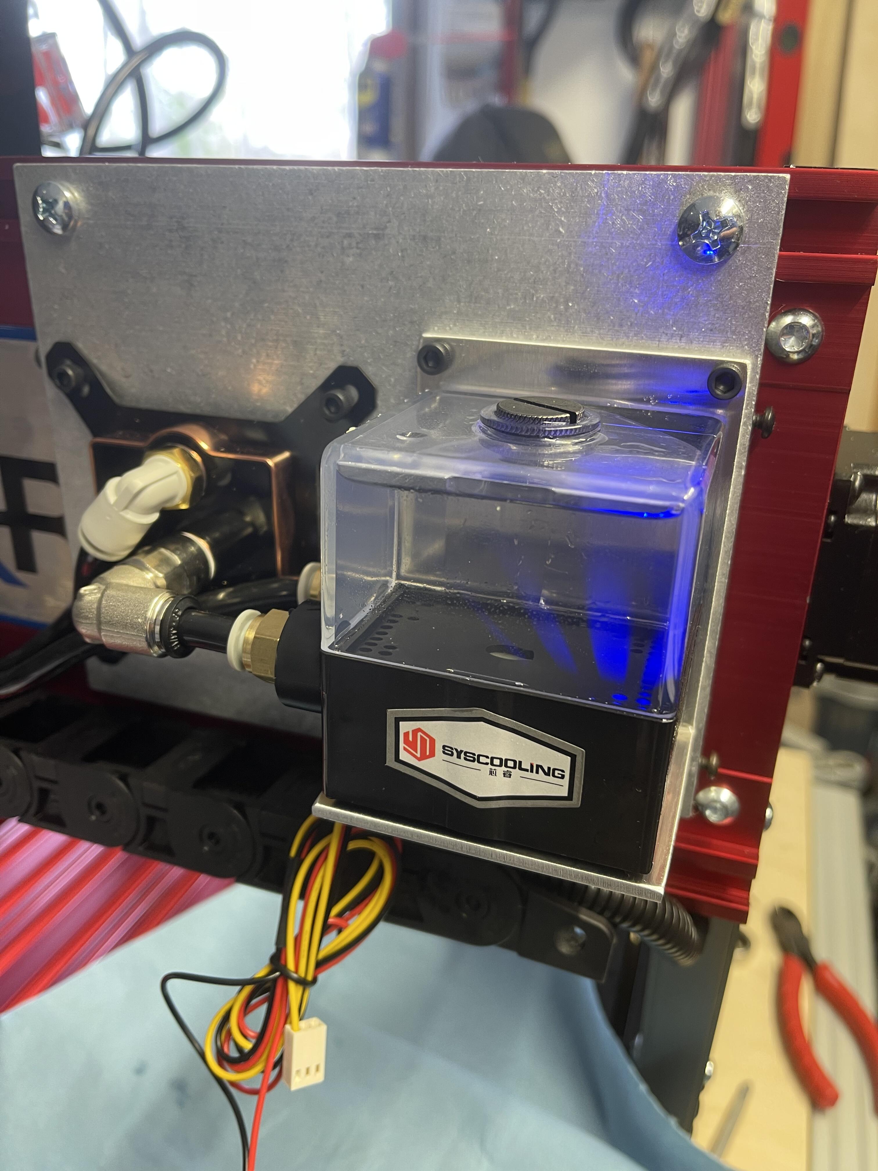

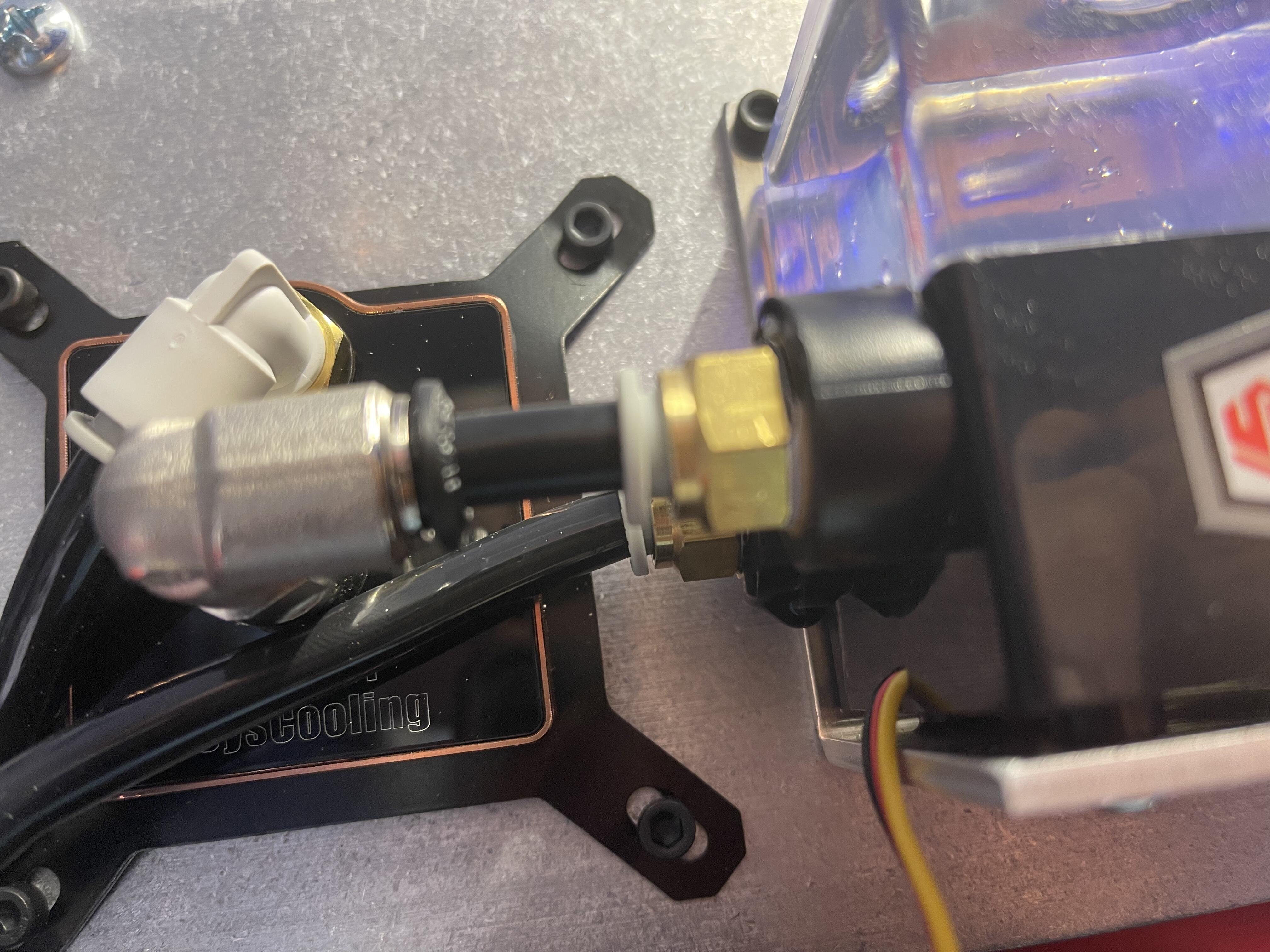

Cheap PoS Chinese cooling system is leaking at the hose leading back into the reservoir from the spindle and not spinning of the flow indicator at the spindle.
  • Like 1
Posted
Make sure it’s fully seated. Or pull it out and verify it was cut properly.
Posted
Full of Propylene Glycol at the moment so I have going to have to pump the whole thing out to see if the hoses that came attached were actually properly done.
Posted
Try seating them better? Sometimes it takes a bit of force to get them that last little bit to fully seat.

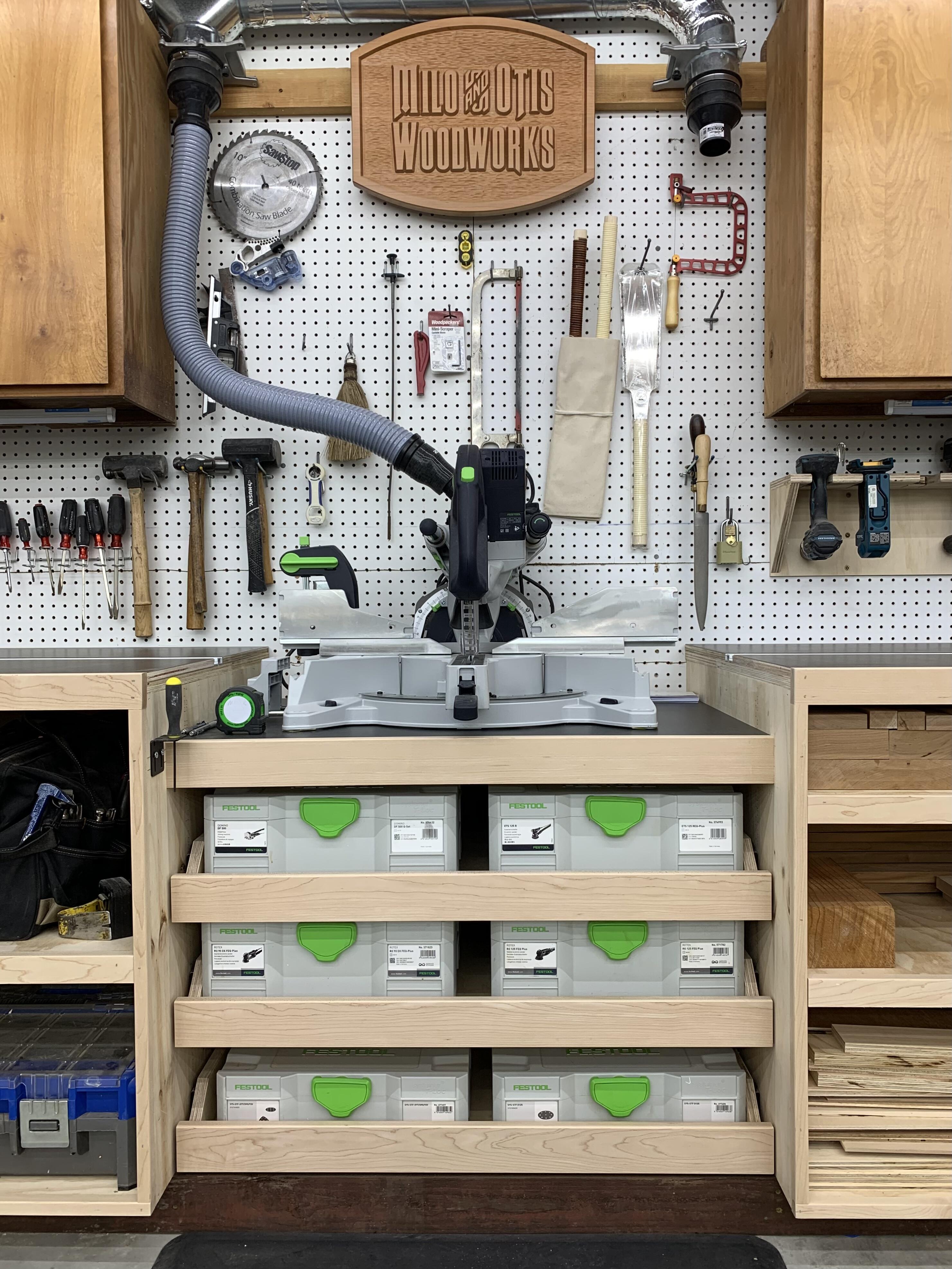

I've been meaning to post another plug for Doug's idea of waiting for a combo jointer/planer. I've been using my Hammer A3-31 in both modes to mill some maple and it is such a joy to use. It is very smooth to operate and the results are fantastic. The minor hassle of converting between modes is worth having both tools in one relatively small footprint. I'm sure it will take awhile to get one but it will be worth it.
Speaking of maple, Steve and I have finished the miter saw station gave frames and drawer fronts. Very happy with the station and its functionality. Not measuring most cuts because of the StealthStop works great and is really precise. I also got a hose adapter so I could use the 2.5" hose with the Kapex.

The micro adjustment wheel on the stealth stop system is awesome. We were cutting face frame pieces that were quite similar in length, but not exact. All I had to do was dial the micro adjustment a hair this way or that. IMO this fenceless miter station is brilliant.
If I ever am able to put together a decent sized shop, it's the system I'll use myself.

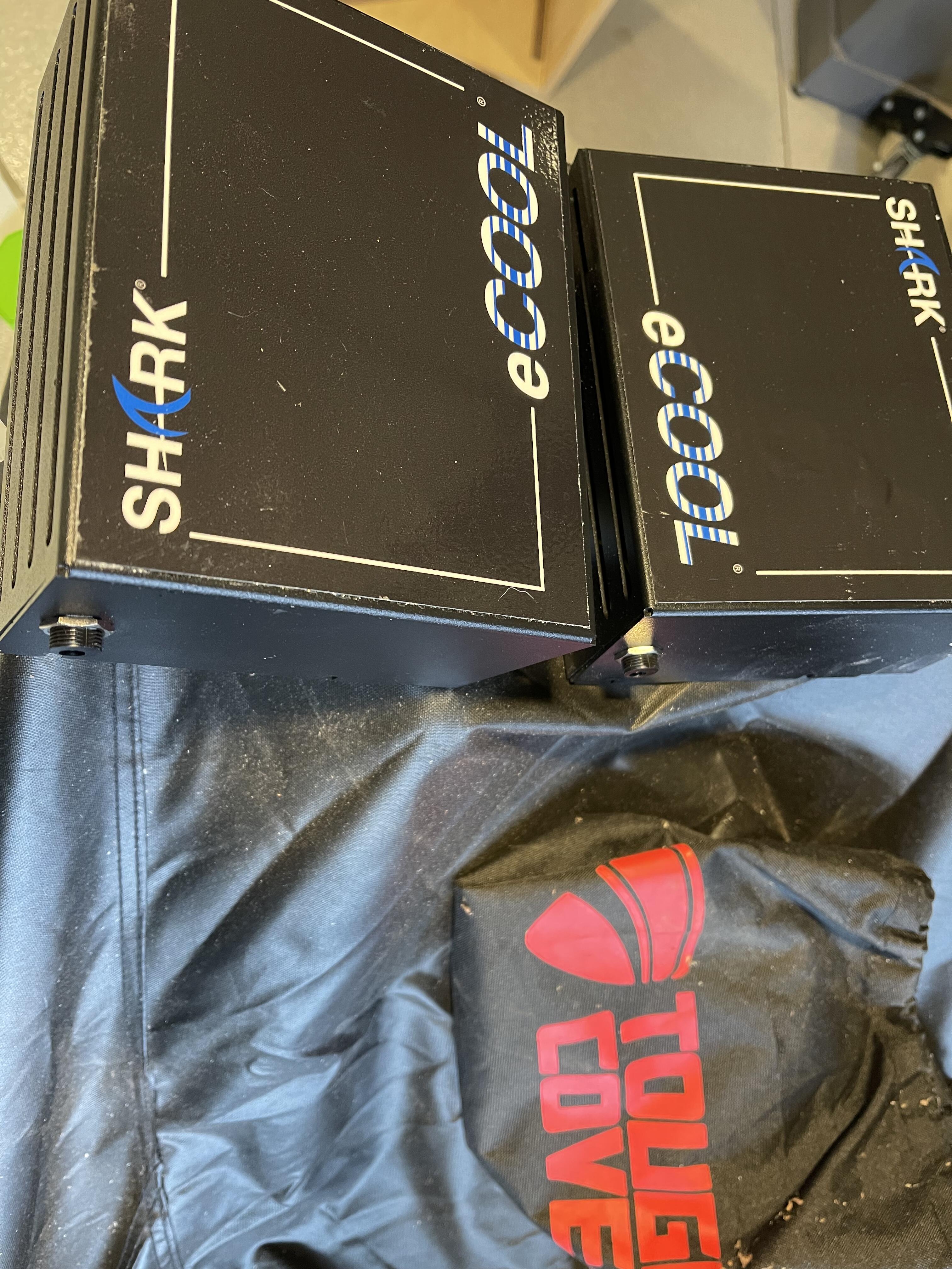

Shitty chilled water system is heading back to Ohio for replacement. Might just build my own without Ali Baba parts everywhere.
Posted

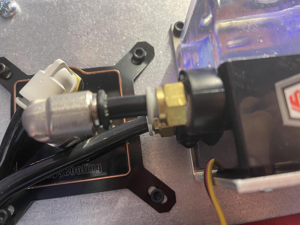

Got the replacement cooling unit. Missing one piece of tubing and the case has an issue some may spot. Quality QC here for sure.

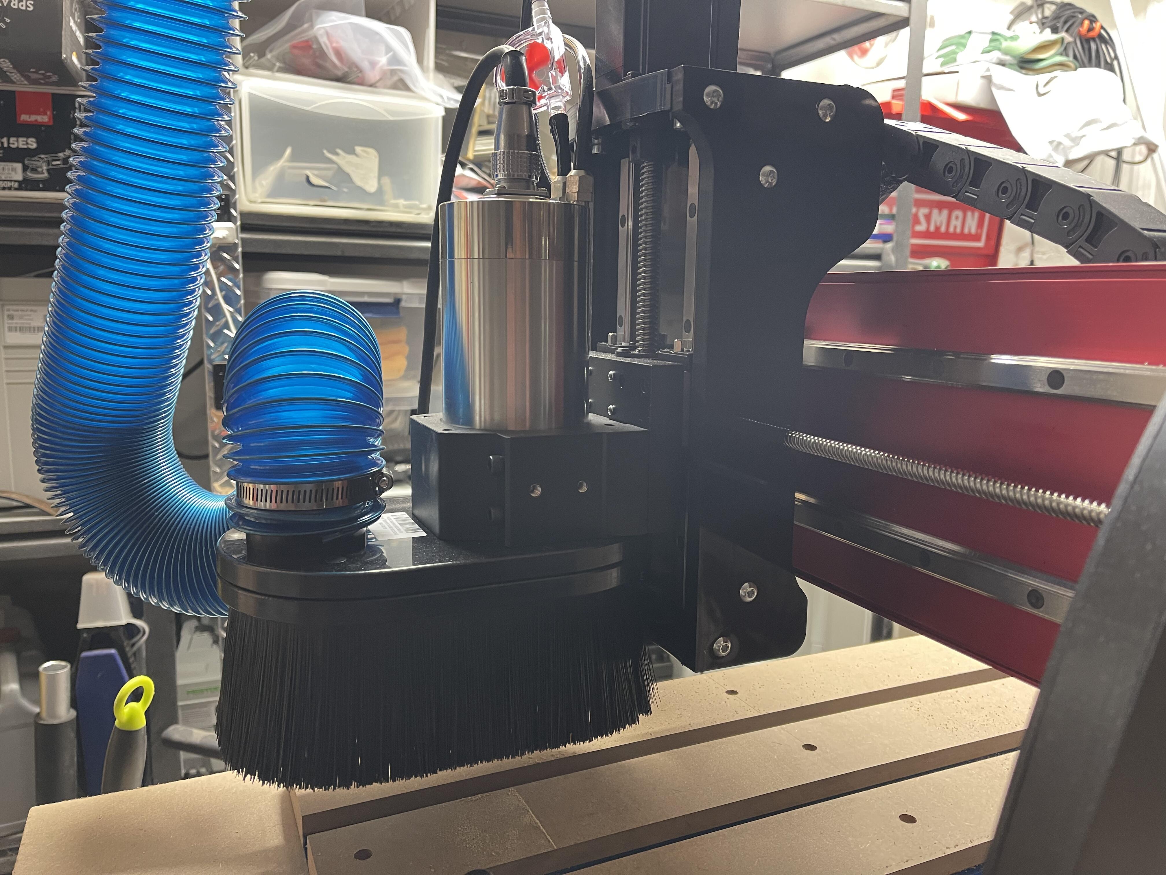

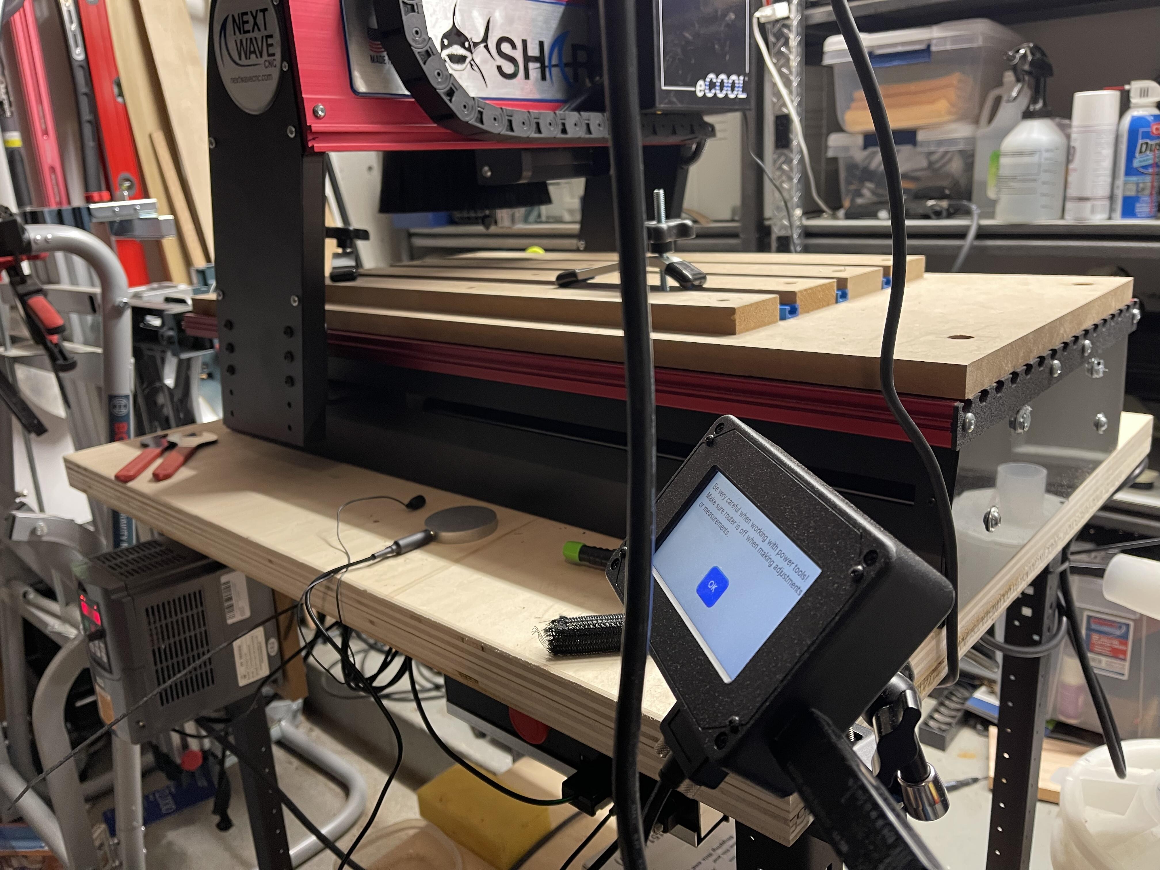

Finally got the whole magic side table together and did a test cut for an upcoming personalized drawer front project.
I guess with the new 3HP spindle it needs to be set almost all the way at the top of the clamp to allow the dust boot to actually enclose the bit and suck better.
  • Like 12
Posted
Managed one test before blowing the fuse, which I cannot get locally, with the giant 2 inch spoil board flattening disc. Will probably just plug the spindle into its own circuit and love with plugging it in each time instead of running off the controller power supply.
Finding the spoil board design to be lacking as I have too few t tracks. Might just use the base layer and screw/glue wood to the MDF, once the midget fuses finally arrive.

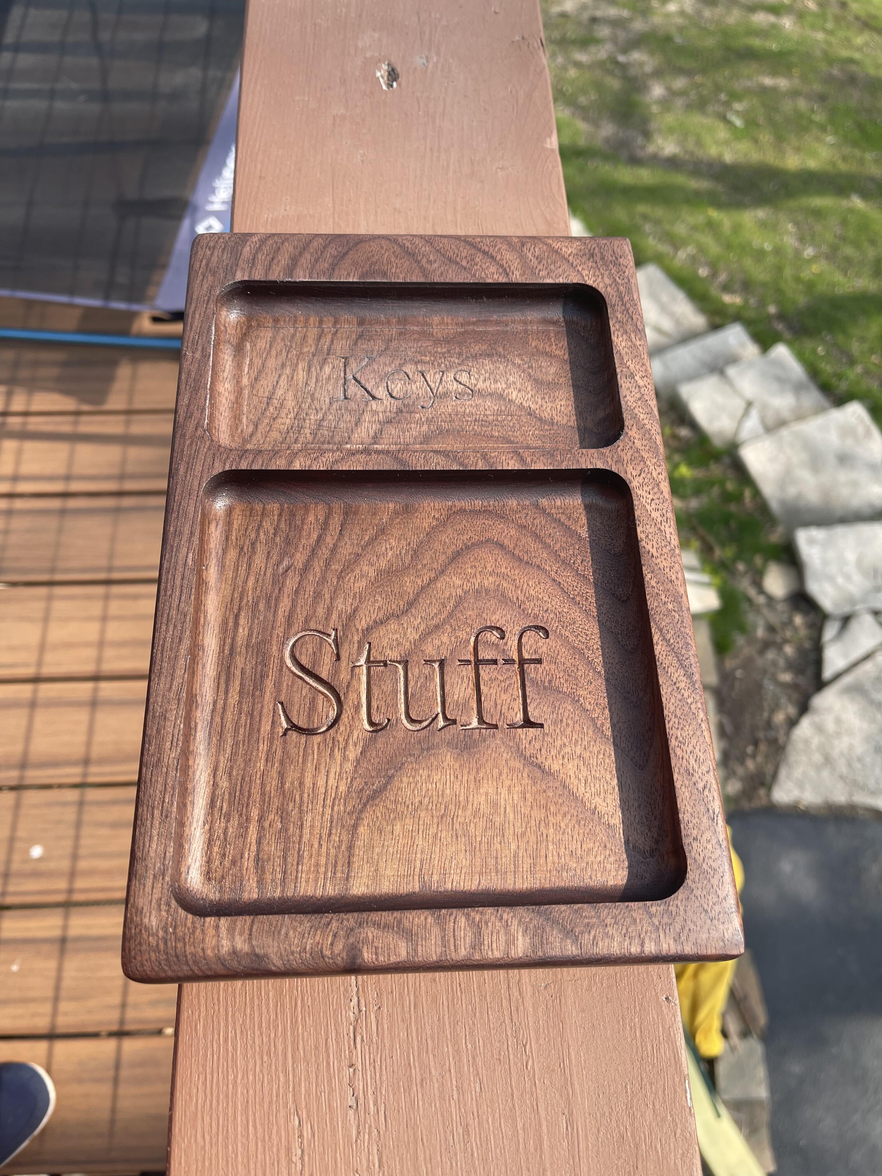

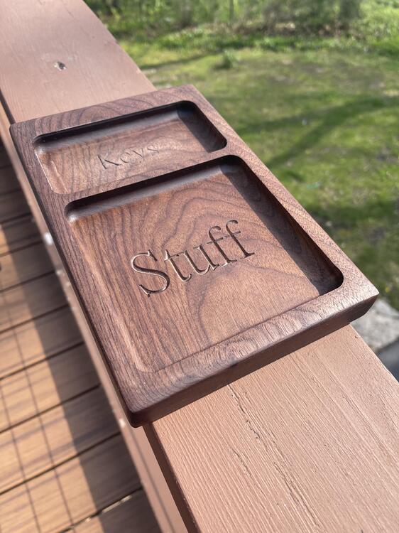

I did manage to finish the first “project” on the magic side table. Did the key tray with 1/4” downcut windmill followed by the bowl bit to round the bottom. The large one was done with the 3/4” bowl bit and came out much better.
  • Like 5
