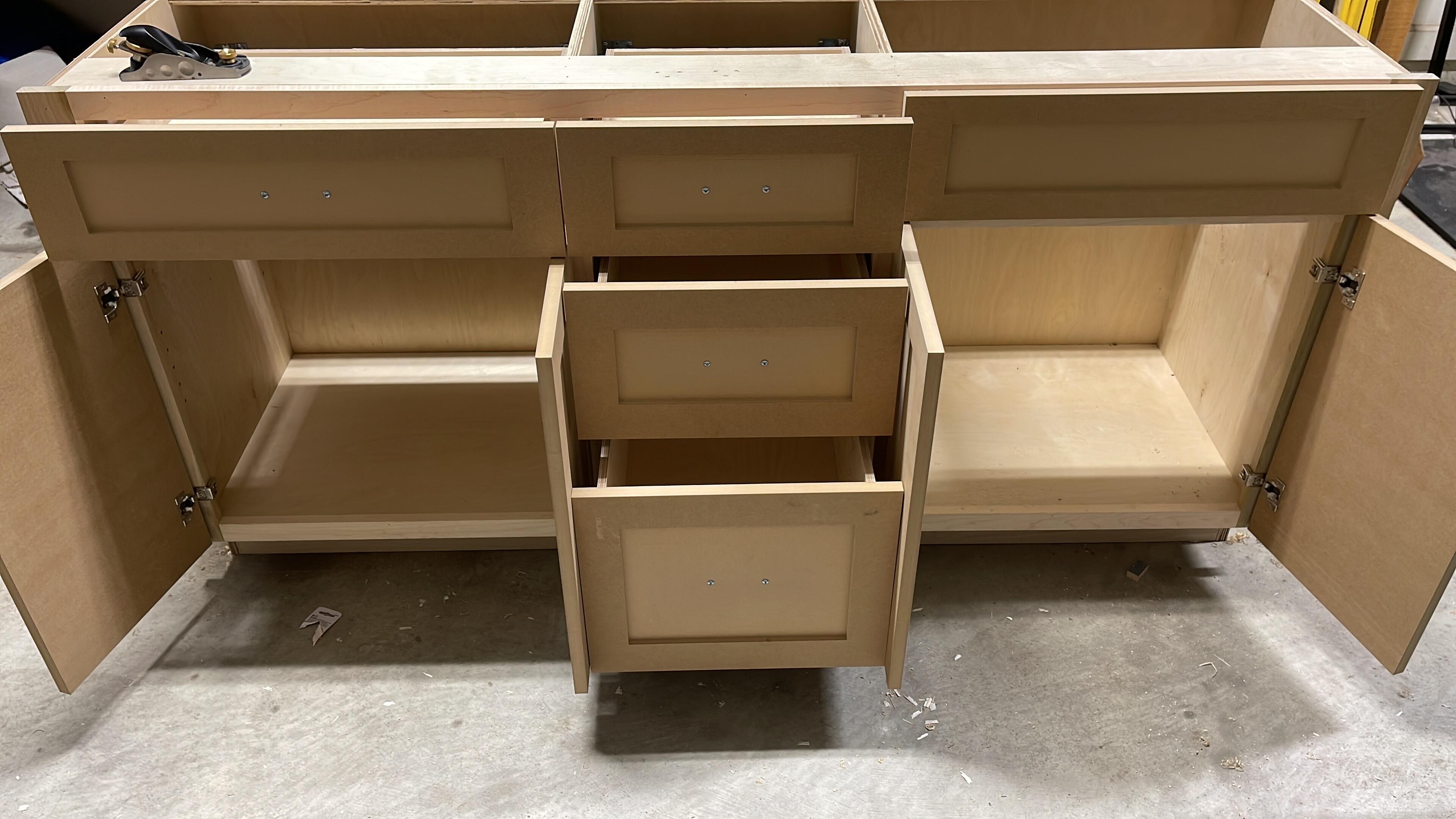

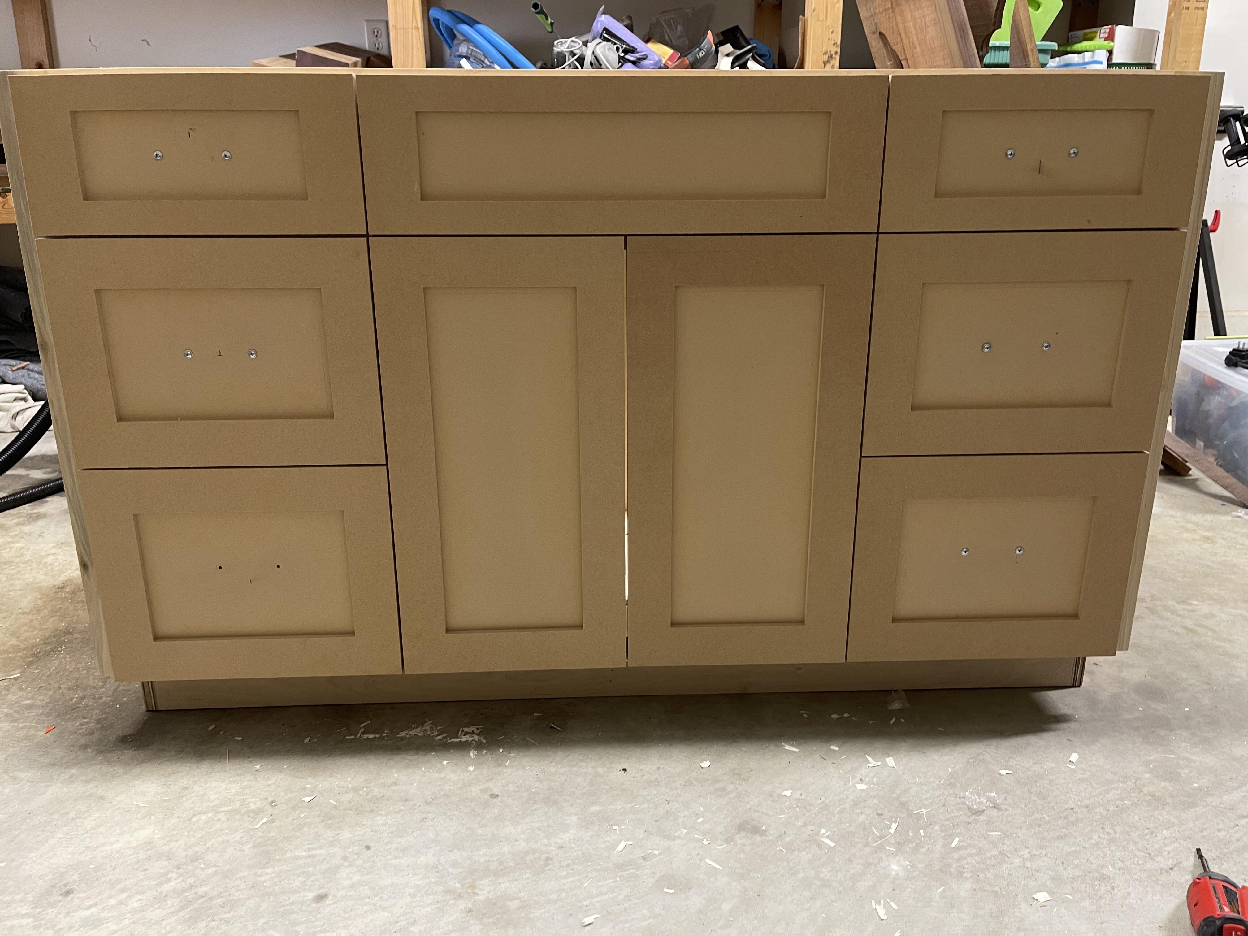

luvdunhill Posted January 24, 2022 Report Posted January 24, 2022 On 1/14/2022 at 3:26 PM, naamanf said: Put together a vanity. How to the door and drawer outlining sticks connect to the flat bits? Quote
naamanf Posted January 24, 2022 Report Posted January 24, 2022 Just now, luvdunhill said: How to the door and drawer outlining sticks connect to the flat bits? What? I’m guessing you are asking how the drawers and doors are attached? It’s a face frame cabinet Quote
VPI Posted January 24, 2022 Report Posted January 24, 2022 Or the drawer/door faces’ cope and stick construction. Quote
naamanf Posted January 25, 2022 Report Posted January 25, 2022 32 minutes ago, VPI said: Or the drawer/door faces’ cope and stick construction. One piece HDF from the ping pong table. Quote

swt61 Posted January 25, 2022 Author Report Posted January 25, 2022 I think Marc was asking about the panels in the door and drawer frames. I'm pretty sure the door and drawer frames have datos that the flat panels slide into Marc. That's the traditional way. Or they might have rabbits that the flat panel sets into. Looking closer I see that he ping ponged the frames out of a solid piece of MDF, so those frames would be rabbited on back and the panels would set in those rabbits. Correct me if I'm wrong Naaman. Quote
Voltron Posted January 25, 2022 Report Posted January 25, 2022 22 minutes ago, naamanf said: One piece HDF from the ping pong table. There are no panels. It's carved to look like rails and stiles and panels but I think it is one piece cut up on the magic ping pong table Quote
swt61 Posted January 25, 2022 Author Report Posted January 25, 2022 Wait, WTF? Are those raised panel doors and drawers carved out of a solid chunk of MDF? Al just answered my question. That's fucking crazy. Crazy cool! That's a first for me. Quote
naamanf Posted January 25, 2022 Report Posted January 25, 2022 4 minutes ago, swt61 said: Wait, WTF? Are those raised panel doors and drawers carved out of a solid chunk of MDF? Al just answered my question. That's fucking crazy. Crazy cool! That's a first for me. Al is correct. Raised panel HDF single piece doors are pretty common for painted cabinets. There are CNC bits to match just about every shaper knife profile. Quote

luvdunhill Posted January 25, 2022 Report Posted January 25, 2022 3 hours ago, naamanf said: What? I’m guessing you are asking how the drawers and doors are attached? It’s a face frame cabinet How are the drawers fronts then attached to the side and bottom of the drawer? Quote
naamanf Posted January 25, 2022 Report Posted January 25, 2022 (edited) 35 minutes ago, luvdunhill said: How are the drawers fronts then attached to the side and bottom of the drawer? The drawer box is built to be made into one piece with a dado on all for sides for the bottom to fit into. Then the drawer front is secured from the rear with wood screws. Edited January 25, 2022 by naamanf 1 Quote

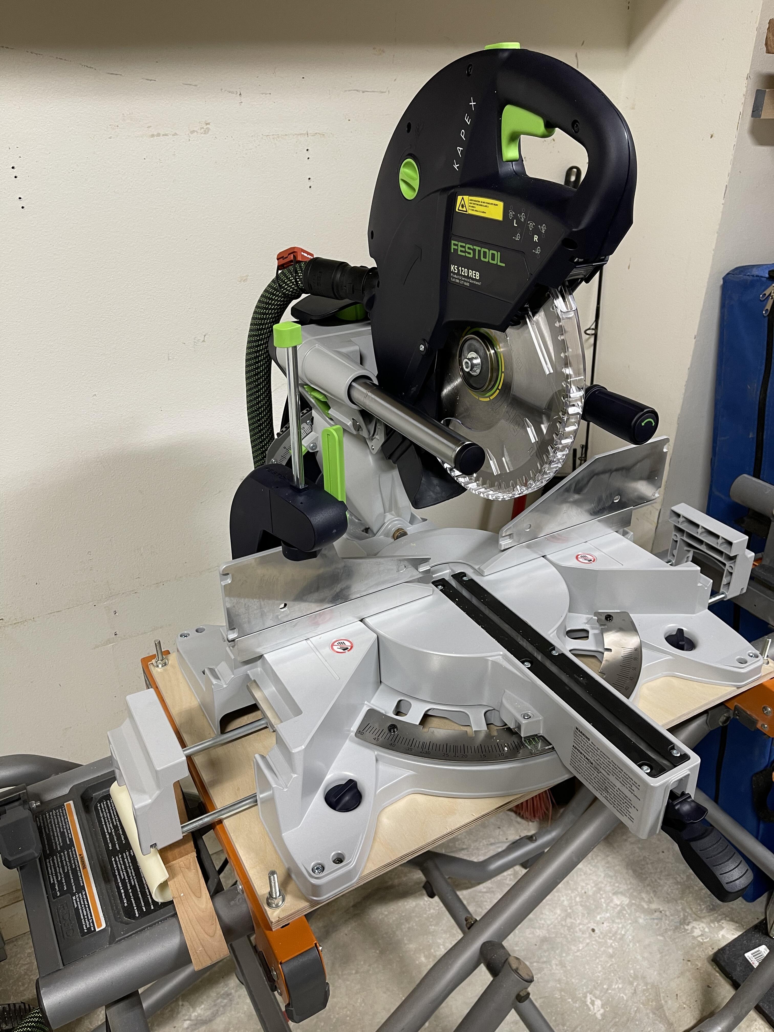

naamanf Posted January 28, 2022 Report Posted January 28, 2022 Put it on the stand. It cuts wood. 5 Quote
