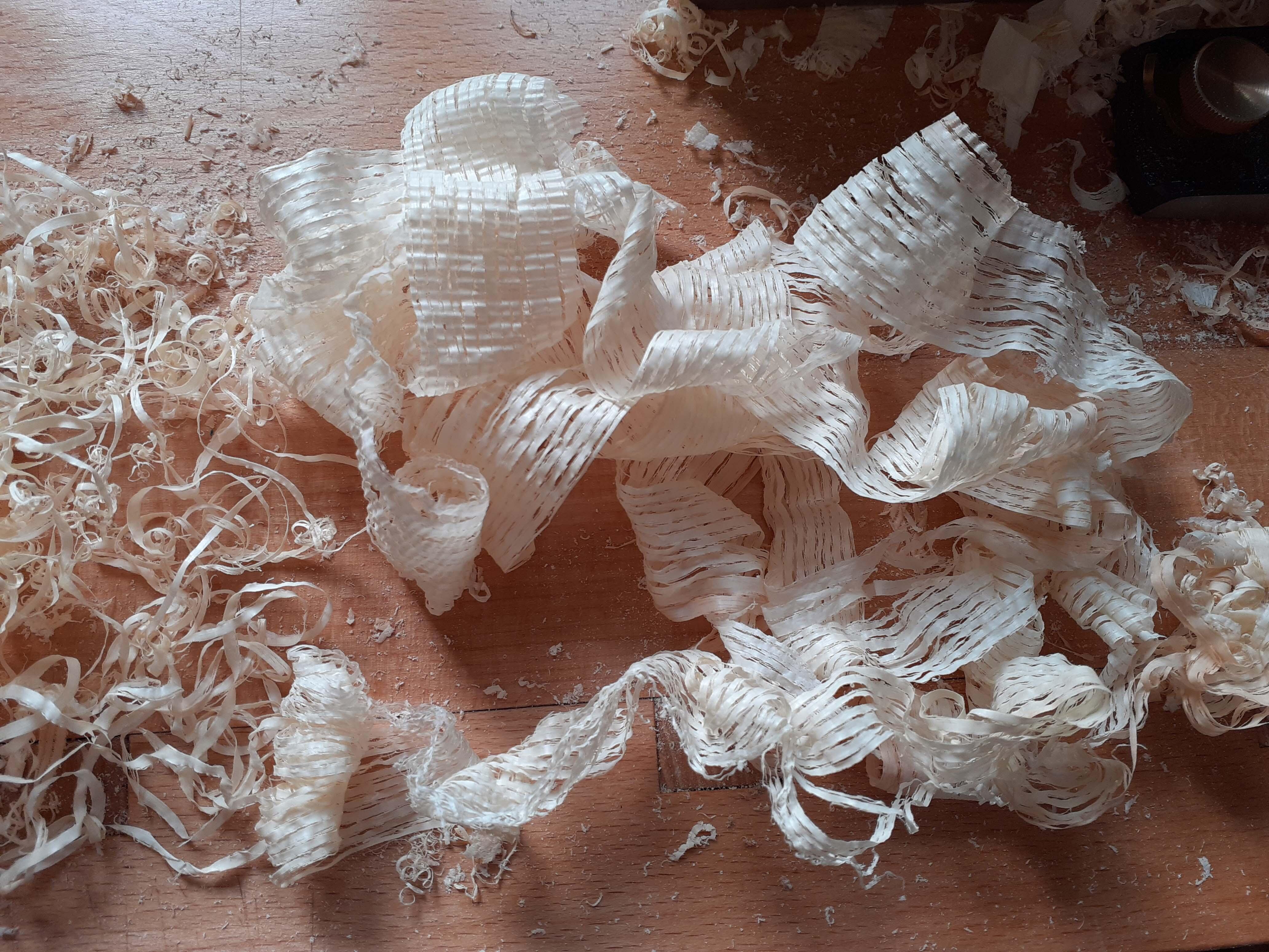

Craig Sawyers Posted August 10, 2021 Report Posted August 10, 2021 (edited) Ash plank, finished entirely with hand tools (planes and scraper). Well, not quite true, I dimensioned it using machine tools (radial saw and planer/thicknesser), and then moved to hand tools. Second pic is paper thin plane shavings from the process. This thing, once it has a coat or two of something to be determined, is a coat rack! Ā Edited August 10, 2021 by Craig Sawyers 8 Quote
swt61 Posted August 10, 2021 Author Report Posted August 10, 2021 And you can save those shavings to decorate gift boxes.Ā I'm actually being serious. I once wrapped a Christmas present with brown paper, and used curled shavings to make bows and decorations.Ā 1 Quote

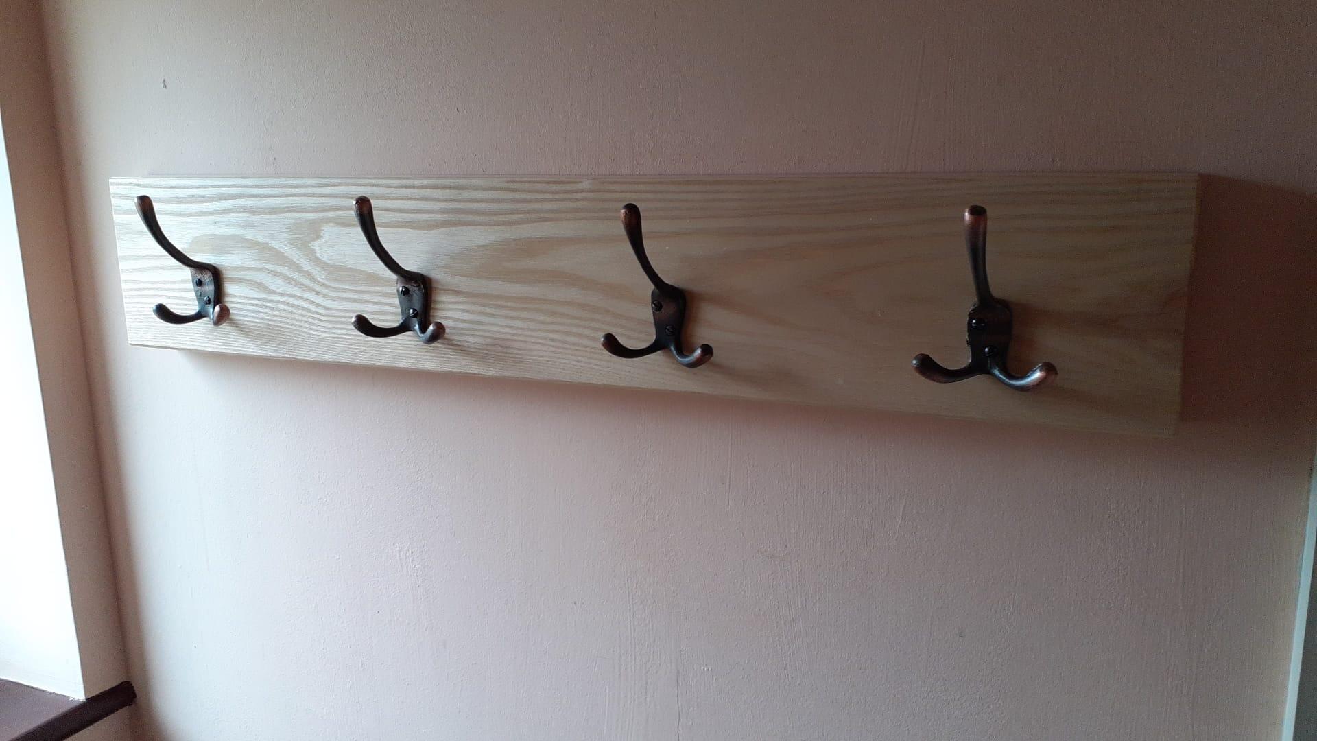

Craig Sawyers Posted August 10, 2021 Report Posted August 10, 2021 OK that works, while keeping the nice pale appearance of ash. Several coats of sanding sealer, then several coats of wax polish. Quote

Craig Sawyers Posted August 11, 2021 Report Posted August 11, 2021 Forgot to mention - one of the key things to getting shavings that thin are (1) An excellent plane - I use Clifton hand planes, patterned on the old bedrock design where you can change the mouth without removing the blade. And (2) An excellent blade. I use Ron Hock blades and chip breakers. These take a razor edge, and keep it for much longer than a regular plane blade. I can't remember whether I chose high carbon or A2. Given how long they hold an edge I think they are A2. https://www.flinn-garlick-saws.co.uk/acatalog/HAND-PLANES.html http://www.hocktools.com/products/bp.htmlĀ although I see that, like so many things now, quite a few are out of stock. Quote
dsavitsk Posted August 11, 2021 Report Posted August 11, 2021 9 hours ago, Craig Sawyers said: I can't remember whether I chose high carbon or A2. Given how long they hold an edge I think they are A2. I have several Lie Nielsen planes with A2 blades, and they are all very nice. But I recently picked up a Veritas shooting plane with their PM-V11 blade, and it is astonishing. It is, impossibly, both quicker to sharpen and holds an edge longer. It's nice enough that I find myself debating a Veritas low angle jack notwithstanding that I own the LN already. Quote
Craig Sawyers Posted August 11, 2021 Report Posted August 11, 2021 (edited) The Veritas (and Lie Nielsen) shooting planes are superb bits of kit - but not cheap for sure! But no half way decent manual hand tool (or machine tool) is cheap. Lie Nielsen's production has ground to a virtual standstill though as a result of Covid. They have started some manufacture again, but have left off manufacturing their lower sales volume products - like the scraping planes and shooting plane. In my early days of woodworking I made the mistake of buying Record planes - and the soles were like bananas. I tried in vain to flatten them, hours of work - and then they wouldĀ move again!Ā At least Clifton, Veritas and Lie Nielsen planes are already flat to high tolerance and stay flat. The other great planes are the ChineseĀ Quangsheng. Their hand planes are all bedrock design. I have some of their block planes, basically identical knock off of Lie Nielsen ones but half the price - but they are also great. Thick A2 or equivalent Chinese grade blades that hold a superb edge. I'm looking forward to a shooting plane from them! Edited August 11, 2021 by Craig Sawyers Quote
Craig Sawyers Posted August 14, 2021 Report Posted August 14, 2021 Finished coat rack, with wall fixings hidden underneath the outside hangers Ā 14 Quote

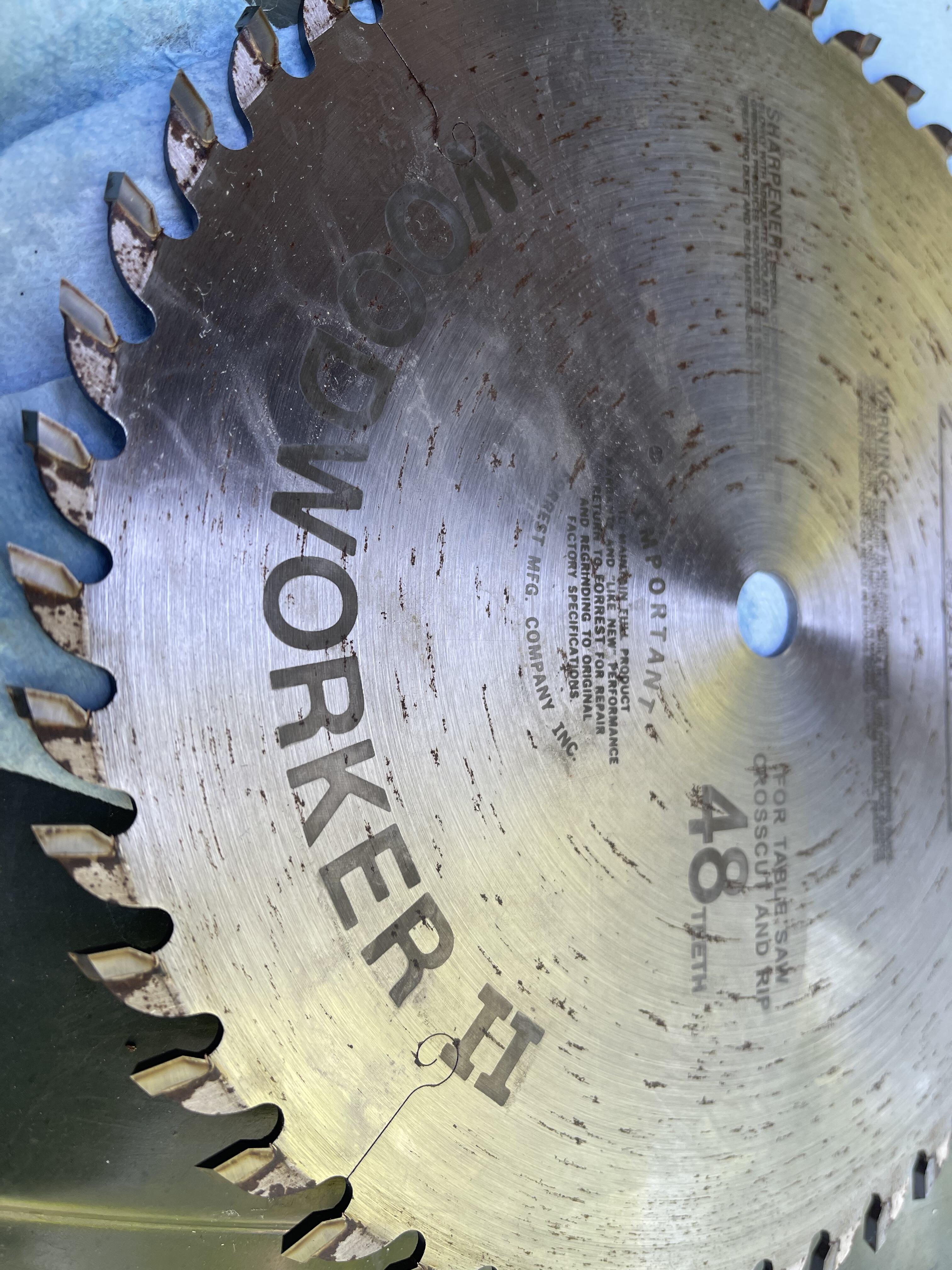

VPI Posted August 16, 2021 Report Posted August 16, 2021 My poor woodworking shop has been neglected for a few months and really shows it. The Jessem Router Table has rusty screws everywhere, several hand tools had a nice surface rust and even the Forrest is all rusted up from staying on the saw without proper service.Ā Might need to try some dehumidifier in the garage or finally put in a proper HVAC in there.Ā 2 Quote

Craig Sawyers Posted August 16, 2021 Report Posted August 16, 2021 42 minutes ago, VPI said: My poor woodworking shop has been neglected for a few months and really shows it. The Jessem Router Table has rusty screws everywhere, several hand tools had a nice surface rust and even the Forrest is all rusted up from staying on the saw without proper service.Ā Might need to try some dehumidifier in the garage or finally put in a proper HVAC in there.Ā Ā My shop is in the garage, with very poor sealing around the up and over door (and hence a battle with spiders!). But curiously, even given that the UK is permanently wet, I have no problems with rust. But I am rather paranoid about wiping tools (hand and machine)Ā with either rust preventative orĀ Camellia Oil. 1 Quote
dsavitsk Posted August 16, 2021 Report Posted August 16, 2021 Just now, Craig Sawyers said: But curiously, even given that the UK is permanently wet, I have no problems with rust. The UK is wet, but Chicago was built on a swamp. Things there just rust. The humidity has to be experienced to be understood. Quote
VPI Posted August 16, 2021 Report Posted August 16, 2021 It is funny that the Forrest blade on the Mitre Saw is perfect. 1 Quote
Craig Sawyers Posted August 16, 2021 Report Posted August 16, 2021 20 minutes ago, dsavitsk said: The UK is wet, but Chicago was built on a swamp. Things there just rust. The humidity has to be experienced to be understood. Ah - OK. I've only ever changed planes at O'Hare, and haven't poked my head outside. Sounds like I missed an experience! Yeah - sounds like you need aircon in there. A dehumidifier is usually a waste of time unless it is industrial grade. Quote
swt61 Posted August 16, 2021 Author Report Posted August 16, 2021 (edited) 32 minutes ago, Craig Sawyers said: My shop is in the garage, with very poor sealing around the up and over door (and hence a battle with spiders!). But curiously, even given that the UK is permanently wet, I have no problems with rust. But I am rather paranoid about wiping tools (hand and machine)Ā with either rust preventative orĀ Camellia Oil. I think it's the humidityĀ that's a problem in the Chicago area. Anchorage can be very wet, and it's right next to a large body of saltwater. Rust isn't a big problem though, because it doesn't get warm enough for the salt or water to evaporate into the air. You don't even smell it, though you're right next to it. As for You Tube... check out a young man by the name of Olivier Gomis. Mostly a wood turner, but he takes it to another level. I think he's across the channel from you. But he could be Belgian as easily as French. Amazing work for such a young guy. He has an amazing imagination. And he works in a pretty limited space. Edited August 16, 2021 by swt61 Quote

Craig Sawyers Posted August 17, 2021 Report Posted August 17, 2021 My shop at the moment is 18.5C (65F) and 67% humidity on the meter I leave in there. But it is only 8:20 am here. I used to have a dehumidifier, and the bucket used to fill up daily - but it had no real effect one way or the other on the not-really-a-problem rust. Since it was just cluttering up my already small shop, I just got rid of it. It is so compact that in order to put long planks through the bandsaw, I have to open the garage door, and put height-adjustableĀ roller supports outside. Needs must and all that. Quote
