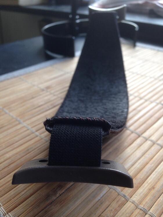

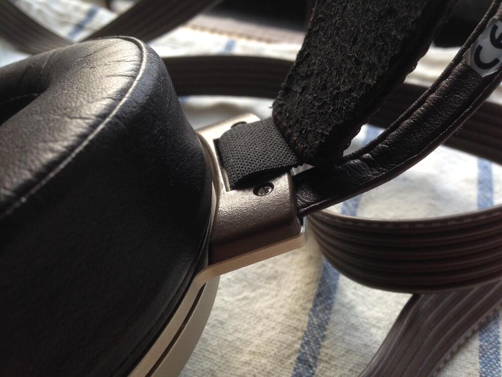

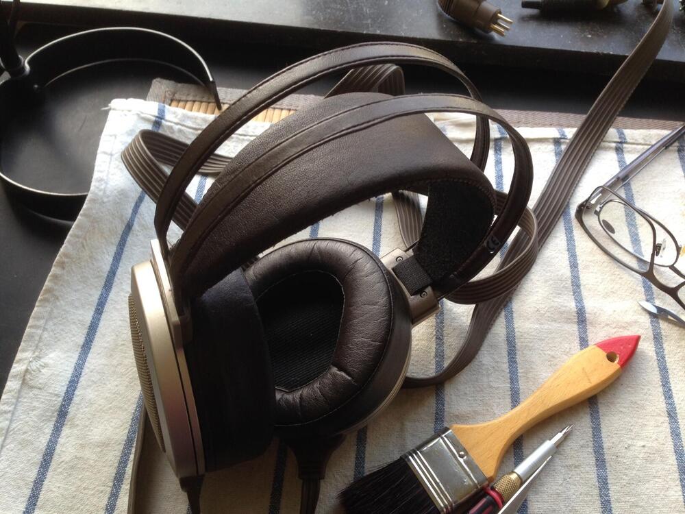

Sebtdi Posted July 23, 2021 Report Posted July 23, 2021 (edited) Does anyone know where to purchase a replacement elastic band for the Stax 007? Ideally same brown color. I have a larger head and the stock elastic is too tight, ideally would be great to have a looser fit. The rest of the fit is Ok the earcups seals pretty good but not as good as my 009. Thank you https://drive.google.com/file/d/1ns4Td8NJxBoQq_3J8vfCkfhP8J5gyJY_/view?usp=sharing Edited July 23, 2021 by Sebtdi wrong message Quote

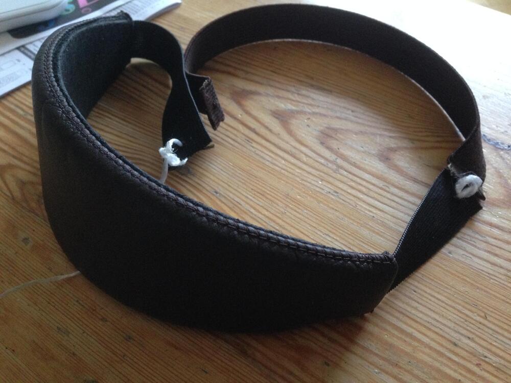

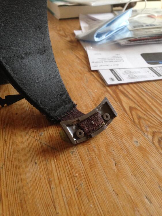

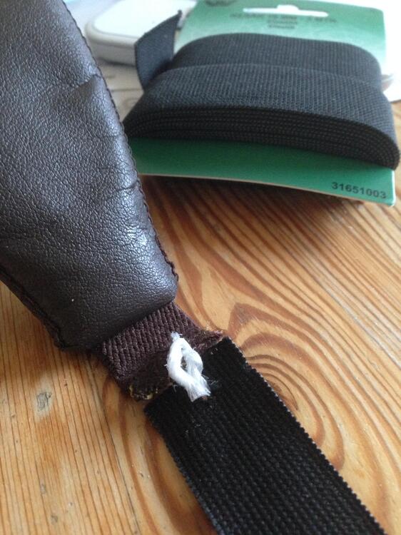

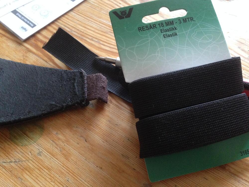

padam Posted July 26, 2021 Report Posted July 26, 2021 You may try something similar: https://www.head-fi.org/threads/the-stax-thread-iii.677809/page-881#post-13808930 Or you can just wait until it stretches out enough. If you switch to another one, it will also be tight at first, which is less of a problem than being too loose (oh wait, this sounds a bit weird) Quote
spritzer Posted July 28, 2021 Report Posted July 28, 2021 Indeed, that's and excellent way to fix it. If the elastic has stretched too much the same can be done by opening up one side and shortening the elastic. Quote
