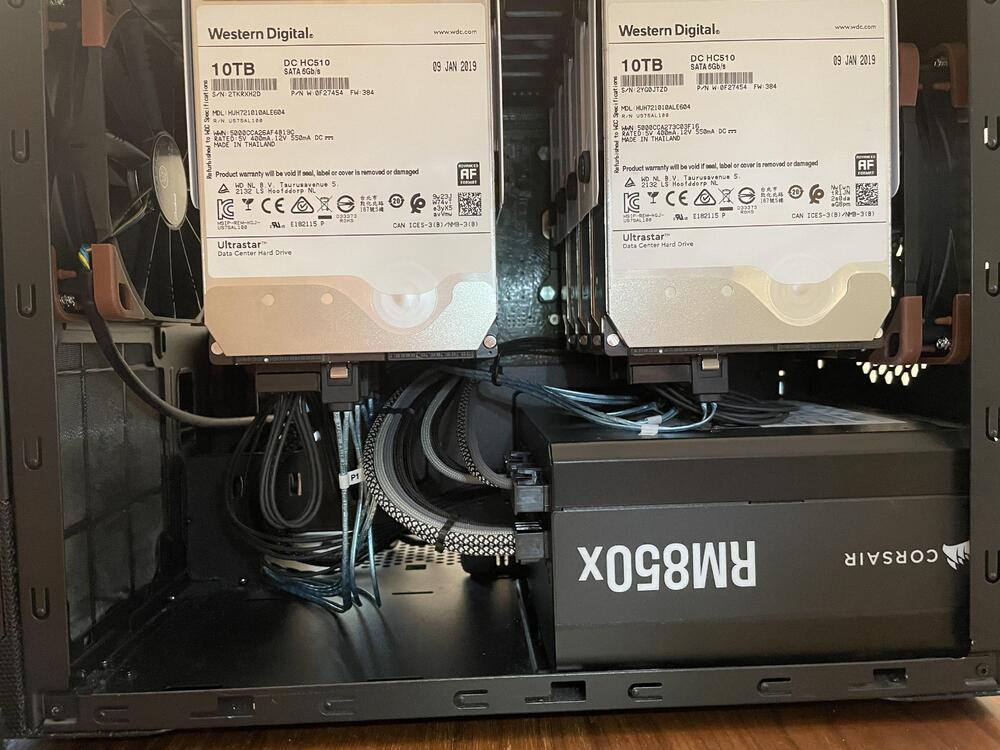

luvdunhill Posted November 21, 2021 Report Share Posted November 21, 2021 I did some wiring clean-up on this side of my server… now just need to do the other side! 1 Quote Link to comment Share on other sites More sharing options...
