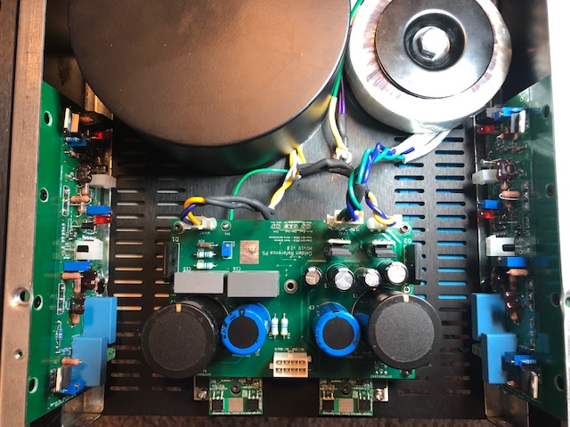

Sebtdi Posted June 28, 2021 Report Posted June 28, 2021 Hello Folks Finished the power supply section this weekend. Question from a newbie perspective: looking for instructions how to adjust/test for the High Bias voltage before installing the new Carbon boards.. R21-50K ? This is for a Golden Reference LH+LV Version 2.0 Readings: Bias H to ground = 436 V U7 Current regulator pad IXCY10M90S (right of R21) to ground = 650 V B+ = 418.5 V B- = -417.6 V Thank you Quote

Sebtdi Posted June 29, 2021 Report Posted June 29, 2021 8 hours ago, Sebtdi said: Hello Folks Finished the power supply section this weekend. Question from a newbie perspective: looking for instructions how to adjust/test for the High Bias voltage before installing the new Carbon boards.. R21-50K ? This is for a Golden Reference LH+LV Version 2.0 Readings: Bias H to ground = 436 V U7 Current regulator pad IXCY10M90S (right of R21) to ground = 650 V B+ = 418.5 V B- = -417.6 V Thank you I was able to replace a Zener diode to 100V instead of 130V - now have 580V bias supply Thanks to Kerry for his assistance! Quote

starcat Posted June 29, 2021 Report Posted June 29, 2021 (edited) On 6/29/2021 at 3:55 AM, Sebtdi said: I was able to replace a Zener diode to 100V instead of 130V - now have 580V bias supply Thanks to Kerry for his assistance! Very nice, congrats! Are you building the amp and PSU in separate chassis? Need moar pics 🙂 Edited July 11, 2021 by starcat Quote
waltzingbear Posted July 4, 2021 Report Posted July 4, 2021 that is Kerry's mini PSU board that contains all GRHV & GRLV supplies, so that is a one chassis Carbon. Quote
