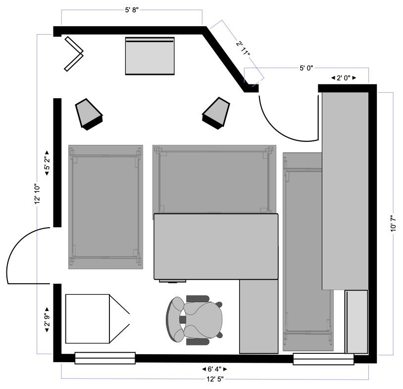

morphsci Posted June 18, 2020 Author Report Posted June 18, 2020 All good information and I agree with all of it. I plan to spend a lot of time tweaking the sub placement, crossover point and level. I have a copy of the Stereophile review of the Cicadas which has a nice set of measurements to start from. I wish the sub had a continuous phase adjustment but it just has a switch, a minor quibble. I am still trying to decide if I want to go with the T/5i (Down firing 10” woofer) or the T/7i (10” front firing woofer and 12” down firing passive radiator). Not a huge difference in either price or size between them. I have always liked the REL approach to subwoofer design, especially for stereo uses so I will likely go that route since I should just try them. I am just not sure which one will work better as I have relatively little room to move things around much as you can see in the floor plan below. 1 Quote
Dusty Chalk Posted June 18, 2020 Report Posted June 18, 2020 Yeah, if you have the freedom to move the sub closer or farther away, that’s the same thing as continuous phase on the Sunfire. 2 Quote
morphsci Posted June 18, 2020 Author Report Posted June 18, 2020 13 minutes ago, Dusty Chalk said: Yeah, if you have the freedom to move the sub closer or farther away, that’s the same thing as continuous phase on the Sunfire. Yeah, I actually did know that but I totally forgot. 🤦♂️ Thanks for refreshing my aging memory. Quote
ironbut Posted June 18, 2020 Report Posted June 18, 2020 I've had good results using the old subwoofer/listening spot trick. Put your sub at your normal listening spot, put on some music with lots of info below 100hz and move around the room listening for the most balanced bass. Where it sounds best is a good place to place the sub. 3 Quote
