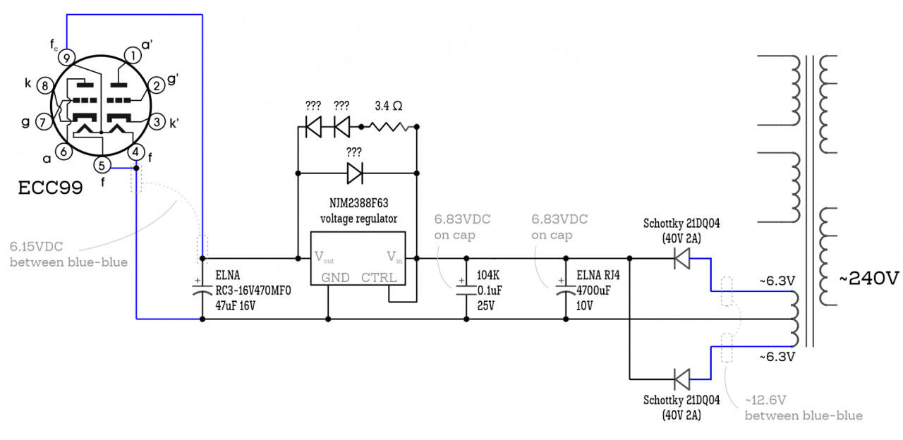

jsts Posted May 17, 2020 Report Posted May 17, 2020 (edited) Folks, I replaced all the electrolytic capacitors in my SRM-600. I can't say for sure if this has happened before, but this (photo) capacitor at 10V 4700uF is heating up. Not very much, around 55C. The headphones aren't plugged in. Can you tell me if this capacitor is in normal operation? Does it have to warm up? My SRM-600 for 230V voltage. First, I supplied a cheap Jamicon TKR472M1AJ26 capacitor. It was heating up.Then I decided to place EEUFR1A472L Panasonic Low ESR capacitor. However, it's warming up, too. I checked the diodes next to it - they're not broke. On the cap about 7V. Any other caps running cold. Only 4700uF/10V running warm. I double-checked all capacitors parameters and they match (or exceed) the original: Original: ELNA LAH400V221MS36 220uF 400V 25х45mm/10mm <--- Rated ripple current (RRC Arms) = 0.87 Replacement: TDK/EPCOS B43642B9227M0 220uF 400V 25x35mm/10mm <--- RRC = 1.03 & ESR at 100 Hz = 460 & Impedance = 680 Original: ELNA RJ4 4700uF 10V 12.5x25mm/5.0mm <--- RRC = 1250 & ESR = 0.11 Replacement: Panasonic EEUFR1A472L 4700uF 10V 12.5x30mm/5.0mm <--- RRC = 3630 & Impedance = 0.013 Original: SANYO 35ME470HC 470uF 35V 10х16mm/5.0mm (S.E.8N Black 85°C Standard series) <--- RRC = 585 Replacement: TDK/EPCOS B41888C7477M000 470uF 35V 10х20mm/5.0mm (B41888C7477M000) <--- RRC = 1500 & ESR at 10 kHz = 0.050 & Impedance = 0.046 Original: ELNA RC3-16V470MF0 47uF 16V 85°C 6.3x5.0mm/2.5mm (RC3 F0 Blue 85°C) <--- RRC at 85°C = 70 Replacement: HITANO E5R 47uF 25V 105°C 6.3x5.0mm/2.5mm <--- RRC at 105°C = 60 Original: ELNA RC3-50V100MF0 10uF 50V 85°C 6.3x5.0mm/2.5mm (RC3 F0 Blue 85°C) <--- RRC at 85°C = 40 Replacement: ELZET CD50H 22uF 50V 105°C 6.3x5.0mm/2.5mm <--- RRC at 105°C = 40 Before the replacement, I did not check if the 4700uF/10V had been warmed. This could be his normal operating condition. It is simply not clear to me which components of the circuit can affect it: from the transformer comes two BLU-wires at 6.3V AC current, then there are two diodes in parallel converting to DC current, and then there is a 4700uF/10V capacitor, which receives these 6.3VDC. There is simply nothing to break. Any suggestion? Edited November 24, 2024 by jsts Large size of attachments. 1

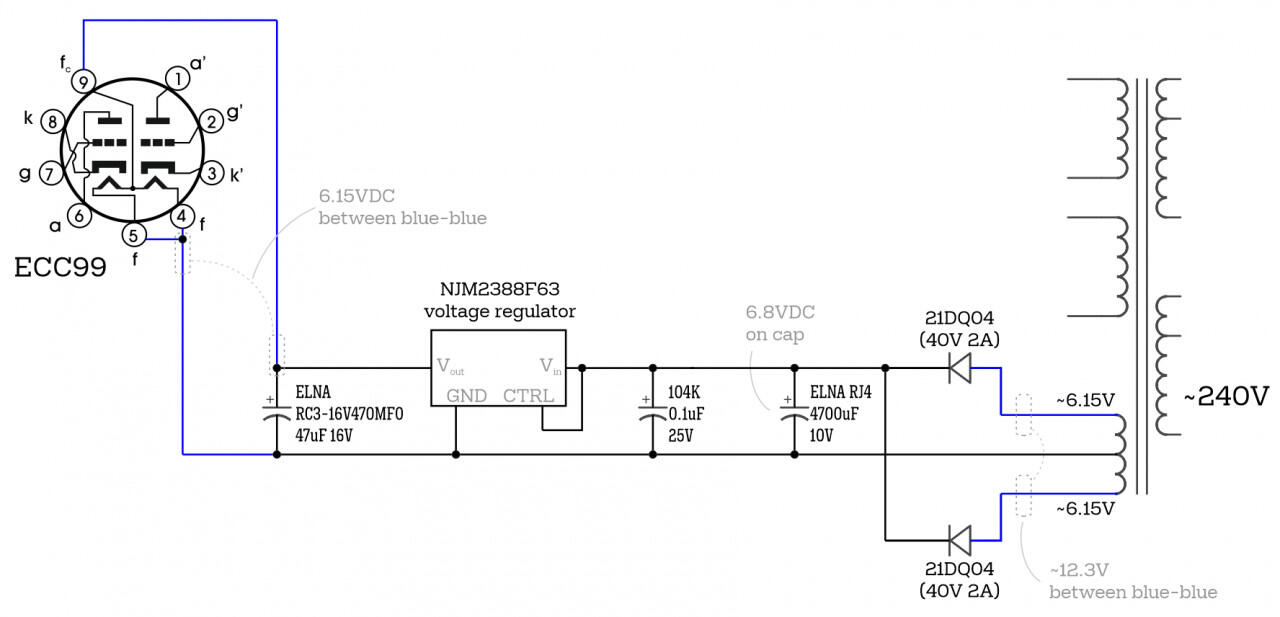

jsts Posted May 24, 2020 Author Report Posted May 24, 2020 (edited) I've measured all voltages: - measured blue to blue = 12.3VAC - measured on the capacitor 4700uF/10V = 6.8VDC - measured at the tube filaments after the regulators = 6.15VDC - measured everything referenced to black -347V Two diodes is 8B 21DQ04. I dropped them off and checked them out. They are guaranteed to work (they pass in one direction and infinity in the other). Circuit: All that remains is to return the old capacitor and see if it will warm up. If so, that's his normal state. Edited November 24, 2024 by jsts
kevin gilmore Posted May 24, 2020 Report Posted May 24, 2020 any ac voltage on the filament? likely the regulators are on the verge of dropping out of regulation. is your 230v about 3% low? 1

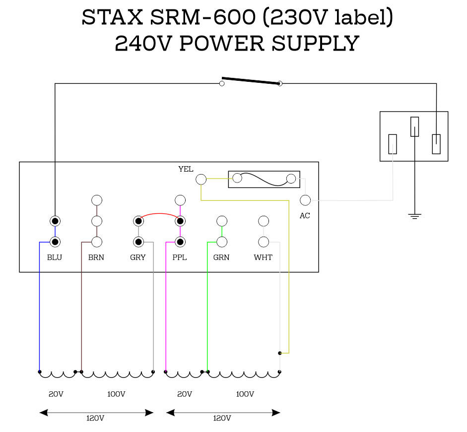

jsts Posted May 24, 2020 Author Report Posted May 24, 2020 (edited) Clarifications: - It turns out that all the wings in the transformer are connected. Thus, it works at 240V. - The voltage in the power outlet is 230±5V (the input voltage fluctuates within 2-3%). - there is no AC-voltage on the tubes. Up-to-date tube power supply circuit: I can rewire the power supply to 220V. Edited November 24, 2024 by jsts

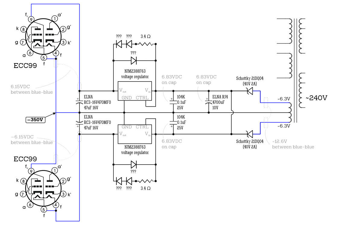

jsts Posted May 25, 2020 Author Report Posted May 25, 2020 (edited) Up-to-date tube power supply circuit (around voltage regulator): Edited November 24, 2024 by jsts
jsts Posted August 21, 2020 Author Report Posted August 21, 2020 (edited) I'm still alive 🙂 and finally I found an oscilloscope. Up-to-date tube power supply circuit: I'm looking at a 4700µf/10V capacitor (where I previously measured 6.83 volts with a multimeter): The total pulsation is about 2 volts. Voltage (real) is 7.62 volts. I look at the leads to the tubes (where I previously measured 6.15 volts with a multimeter): That's 6.33 volts, all right. I draw a conclusion that the capacitor 4700µf/10V heating is a working design and so conceived by the manufacturer. I will try to replace it on Panasonic EEUFS1A752L 7500µf/10V. Edited November 24, 2024 by jsts
jsts Posted August 27, 2020 Author Report Posted August 27, 2020 Finished the experiment. First put a Panasonic EEUFS1C512L 16V/5100μF capacitor. It also warms up, about 55C. That is, the increase in voltage rating has not changed the situation. Then I put a Panasonic EEUFS1A752L 10V/7500μF. It is warmed up, but less, about 49C. That is, a 60% increase in capacitance rating led to a 10% decrease in temperature. Left 10V/7500μF, can no longer improve, 20000μF nowhere to place.
