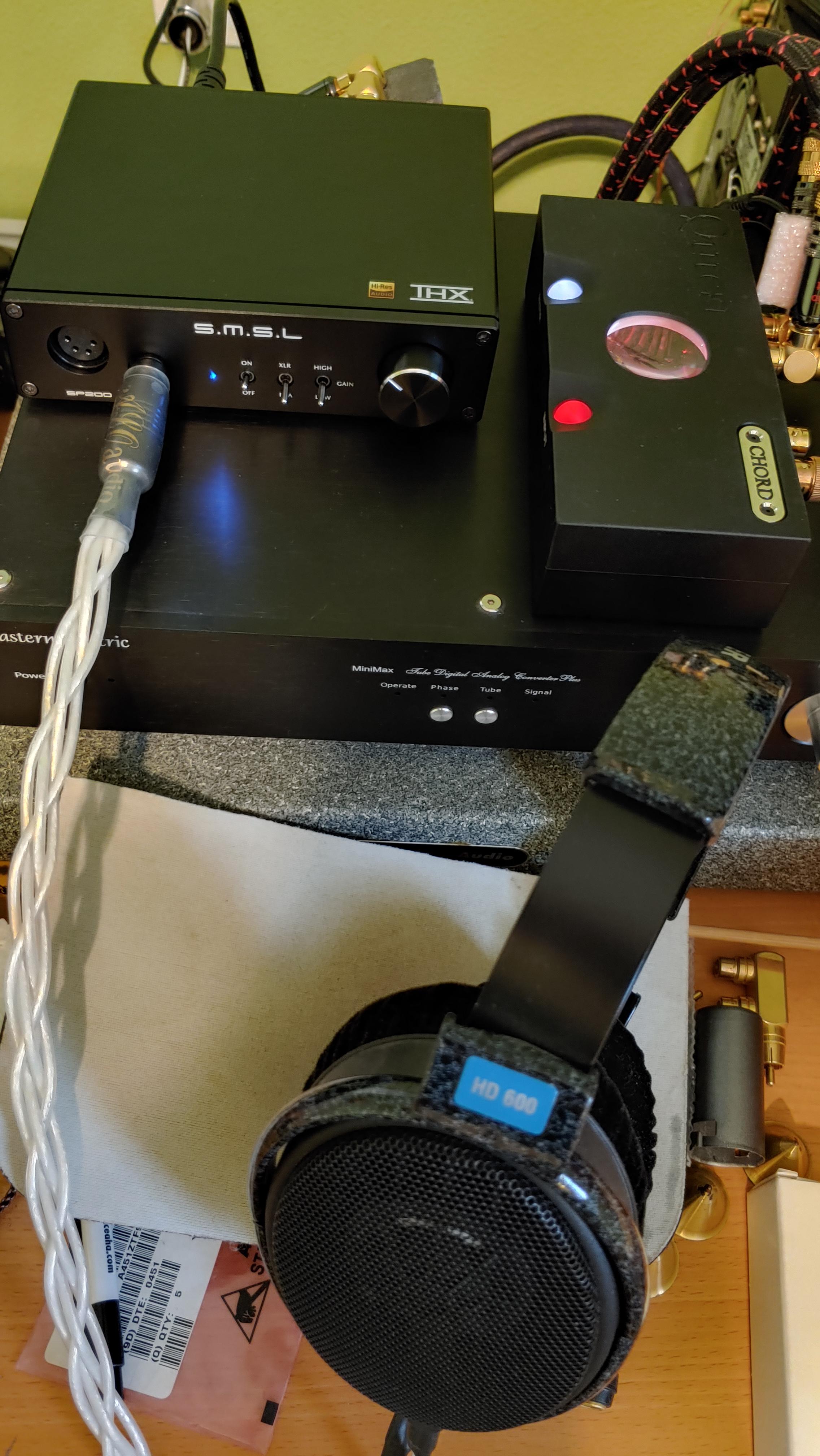

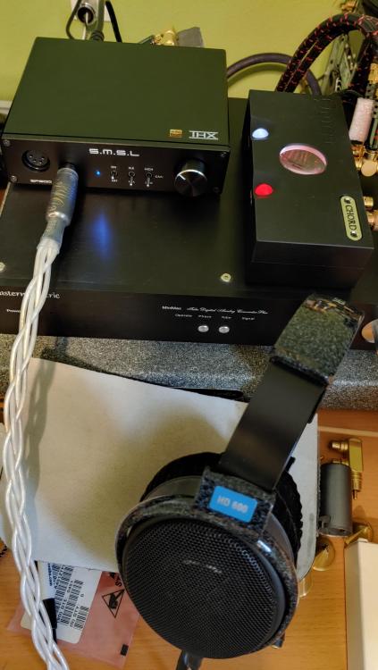

Jon L Posted December 6, 2019 Author Report Posted December 6, 2019 Huh... I guess this THX technology business is not ALL hype after all. In my Holiday shopping binge, I couldn't resist buying the SMSL SP200 THX tech amp for measly $260 +tax. Boy, cheap headphone amps have come a long way since I was last into dynamic headphones years ago... Sennheiser HD600 with ALO cable sounding mighty fine burning in the amp. 1 Quote
purk Posted January 11, 2020 Report Posted January 11, 2020 Better than the Gilmore Lite MK2? Love the look of the upgrade cable! Quote

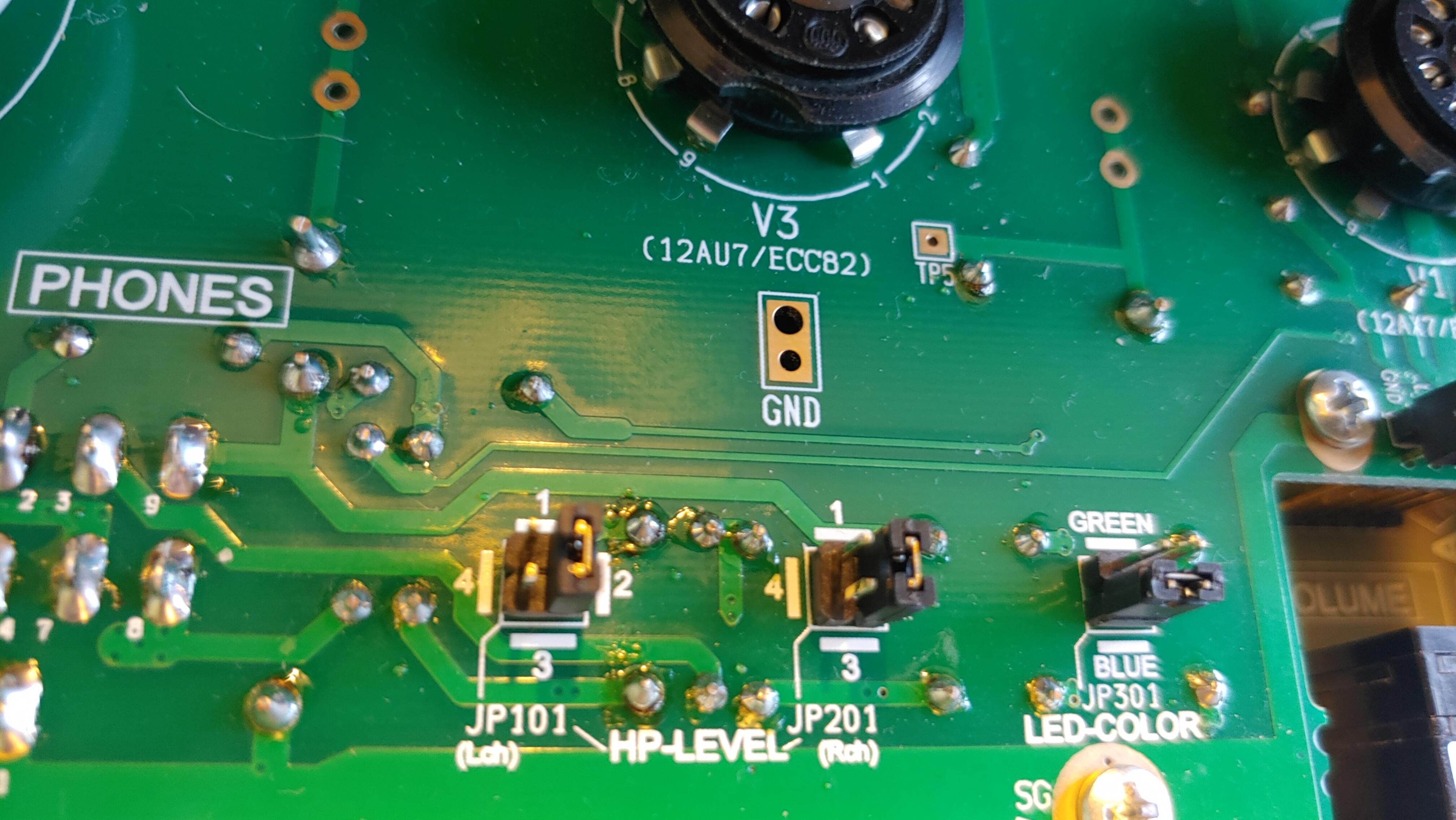

garageboy Posted March 7, 2020 Report Posted March 7, 2020 What does the headphone out section add in the circuit? Quote

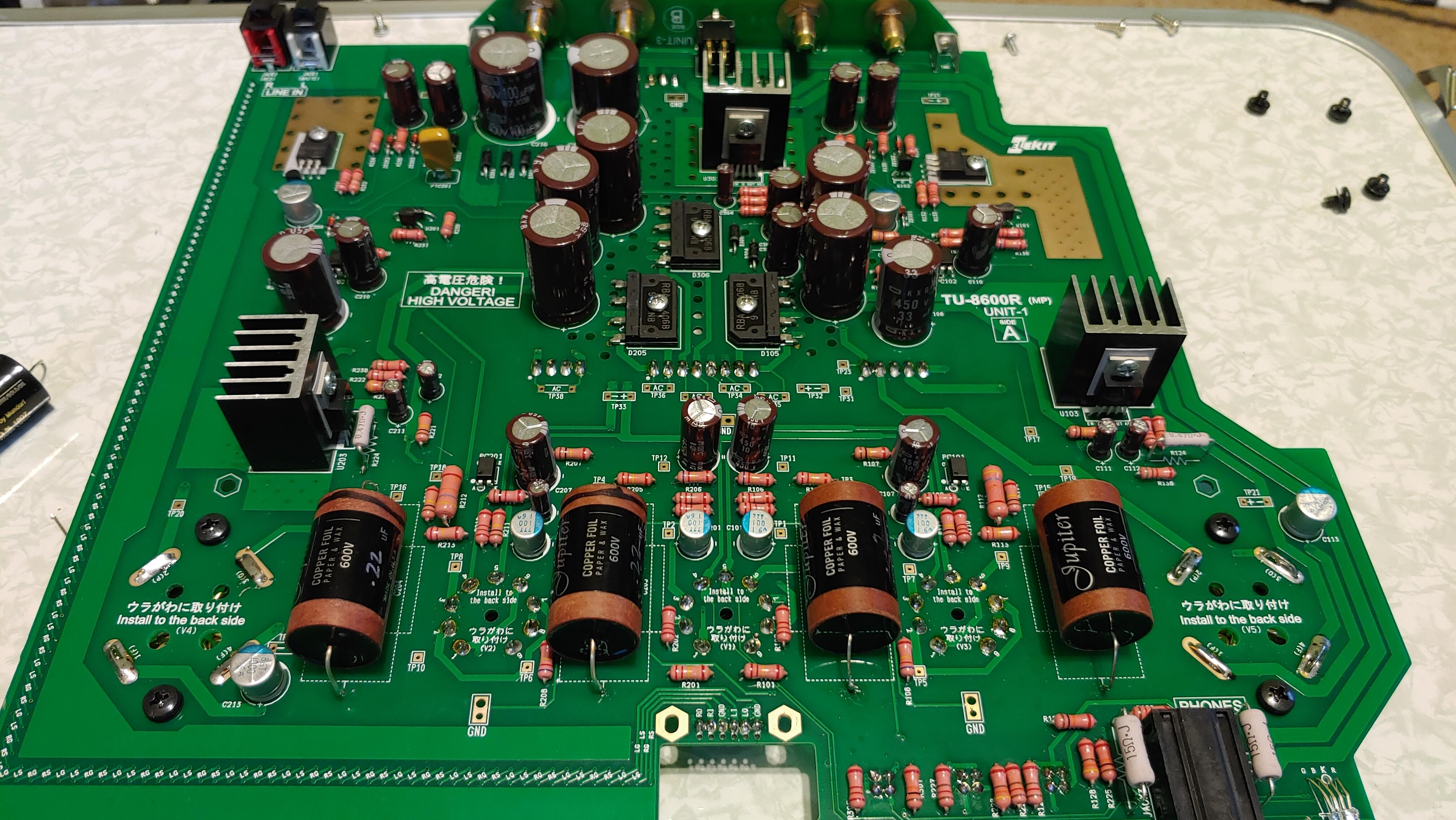

Jon L Posted March 8, 2020 Author Report Posted March 8, 2020 (edited) Headphone section is just adding resistors, the number of which is determined by Jumpers on top of the board (first photo is showing top of circuit board). The bottom of board shows Jupiter Copper Foil caps I rolled in place of (upgraded) Mundorf Silver/gold, and bottom right of photo shows resistor arrays for headphone output. It's too bad the headphone jack cannot deliver enough power for my Abyss because it would have been so much more convenient to keep my speakers hooked up to speaker posts and Abyss to front headphone jack, which automatically cuts off speaker outputs 😞 Edited March 8, 2020 by Jon L 1 Quote
spritzer Posted March 8, 2020 Report Posted March 8, 2020 I'd like to know what they were smoking when doing that input trace... clearly needs more vias... 1 Quote
garageboy Posted June 6, 2020 Report Posted June 6, 2020 I wonder if it's possible to jumper/bypass the resistors on the output - so you can use the headphone out direct from the transformers Quote
justin Posted June 9, 2020 Report Posted June 9, 2020 On 3/8/2020 at 4:43 AM, spritzer said: I'd like to know what they were smoking when doing that input trace... clearly needs more vias... some sort of PCB twisted pair? or speed holes Quote
