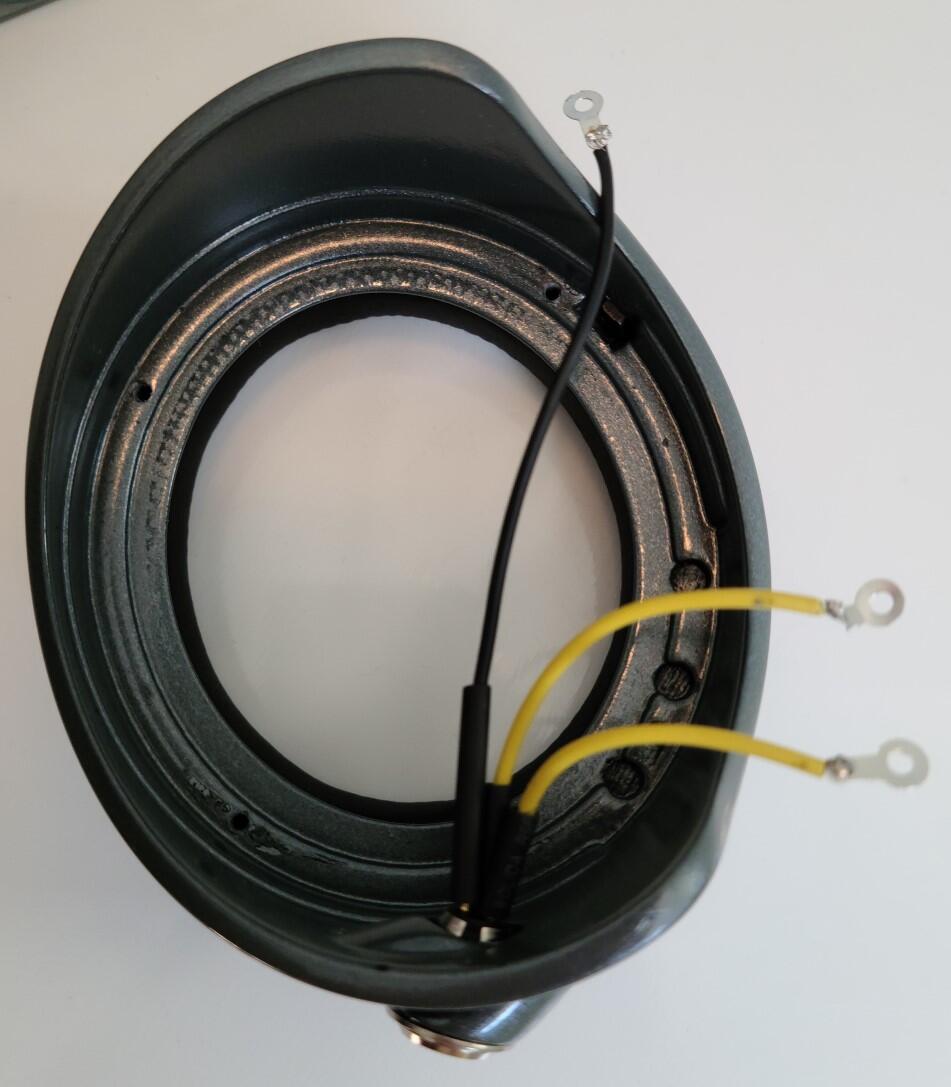

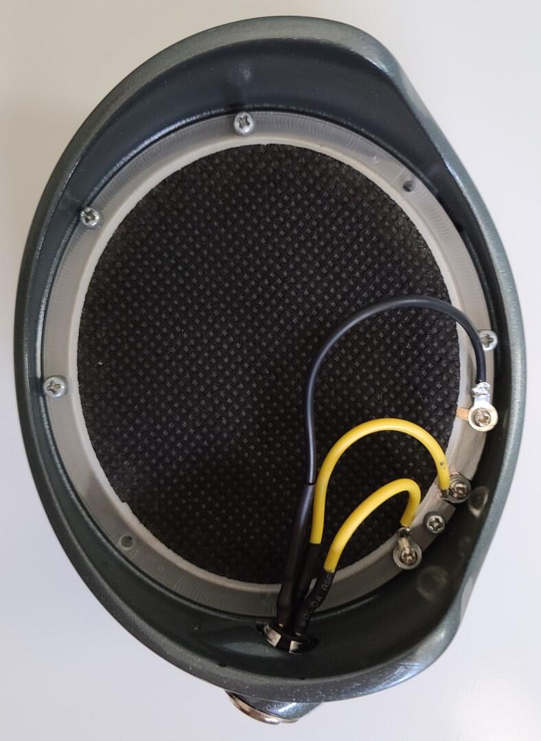

PolloLoco Posted June 12, 2020 Report Share Posted June 12, 2020 I bought a pair of Kaldas RR1 cups/drivers/pads from the previous owner about 2 months ago. They squealed, Aumkar had generously replaced the headphones for him - and didn't require shipping back the original bespoke hardware. These were among the first RR1 produced. I've been totally stir crazy due to the lockdown. Though the most I'd played with electrostats was removing rotted foam from a set of lambdas, I figured this might be a fun project to tear down, and if I'm lucky restore. I modded an old Hifiman headband, and bought a cable from Mjolnir audio. I immediately heard the electric squeal, but it would periodically go away. I had a full 2 hour stretch of silence where I realized these were awesome headphones. Though I was biased towards my Koss ESP95X - after a head to head listening session, I had to admit I liked the Kaldas more for everything but treble. Unfortunately, the squeal and/or buzzing from the left earcup grew to become practically continuous. So I used Joamat's instructions to investigate and completely disassemble the left earcup. They were fairly easy to disassemble, except for one bolt that sits right behind the mini XLR connection. The mini XLR pins being so small, and me being TERRIBLE at soldering - I tried to avoid undoing the solder joint, but broke one of the wires. If you do this, be careful to undo the wired connections last, there are tiny M2 nuts that will fall out if you're not careful. After that, I found basically the same issue that Joamat found, the Bias wire was broken, and there were strands inside the female thread of the housing. It's possible that one strand got into the driver and caused the whine and buzzing. I liked the bolted assembly, and wanted to keep the headphones easy to disassemble, so I soldered in M2 terminal connections as shown. I had to use longer heat shrink tubing because I had wiring exposed at the mini XLR connection. I used a grinder on a dremel tool to make a larger hole in the cover - I found when I assembled initially, that I caused a short and lost volume out of the left earcup. To fix it - I ended up resoldering two of the wires at the mini XLR connection. Then I blew compressed air across the driver and stators, being careful to expose the driver for the most minimal time possible. Then I reassembled as shown including the two dust covers. Eager to test my work, I reassembled the headphones and connected to my Stax SRM 717. The left earcup was completely silent - success! Funny thing - the right earcup started squealing even louder! So I repeated the process of soldering terminal connections. When I reassembled, the right earcup still squealed. I was super frustrated, but went back and did the step I skipped, I blew compressed air across driver and stators. And that seems to have solved the final issue. I've now listened for about 10 hours with almost complete silence. To be honest there's been a handful of times, totaling maybe 30 seconds where I heard a slight buzzing, and thought "Oh no! Not again!" But shifting the earcup slightly cleared it immediately. My ears touch the dust covers, so I suspect it's a different issue entirely. Perhaps with a shift, my ear presses against the stator. The final picture is of my Frankenstein Kaldas RR1 conquests. I contacted Aumkar, not for help - but to suggest a few manufacturing improvements based on my findings. Aumkar was very kind, suggested that I solder directly to the bolts - and then informed me that he'd already incorporated all of the manufacturing improvements I suggested. So if you order a Kaldas RR1 conquest now - it will be more robust than the initial versions. Overall - I think this is a great product, and Aumkar has been a pleasure to chat with. If you're willing to buy an energizer separately, these sound better than the Koss, and far better than the L300/L500 I used to own. I hope Kaldas will produce a sequel. I like these headphones so much I'm having Vesper Audio quote out slightly thicker pads so my ears don't touch - and I ordered touch up paint to fix a couple spots I scratched or gouged during my project. 7 1 1 Quote Link to comment Share on other sites More sharing options...

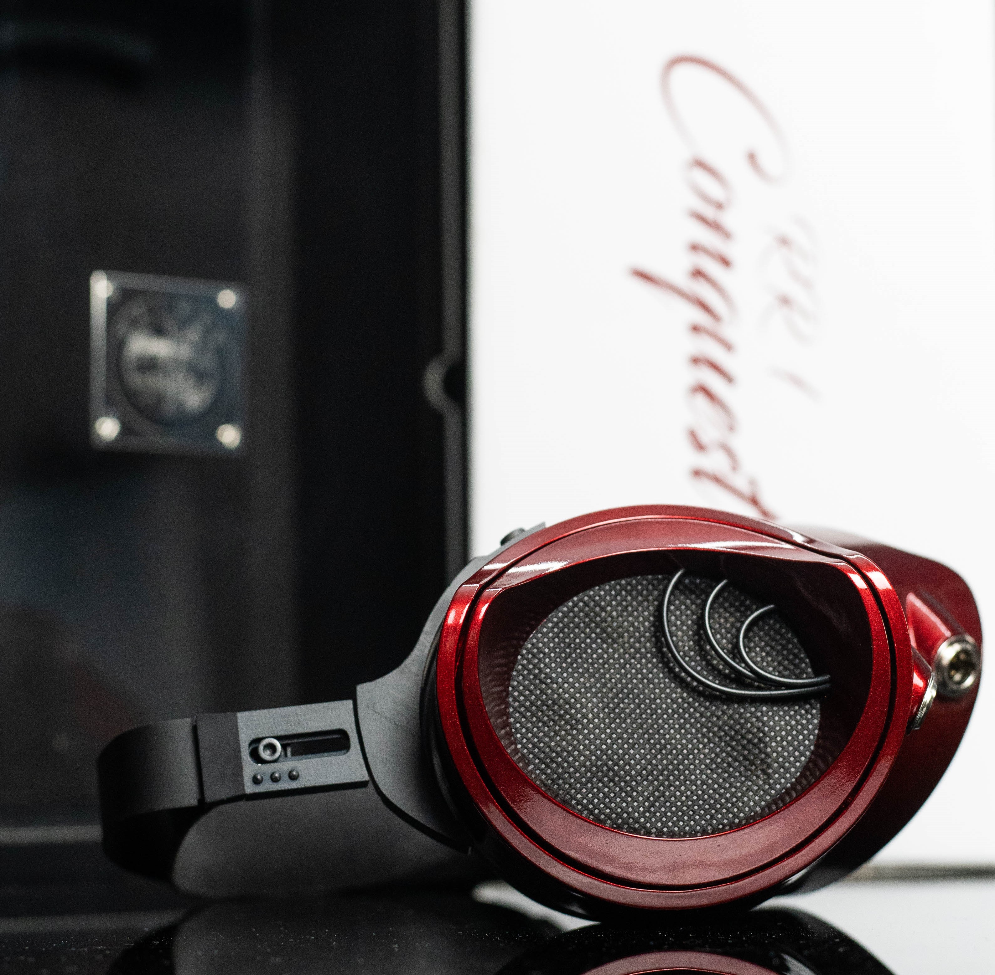

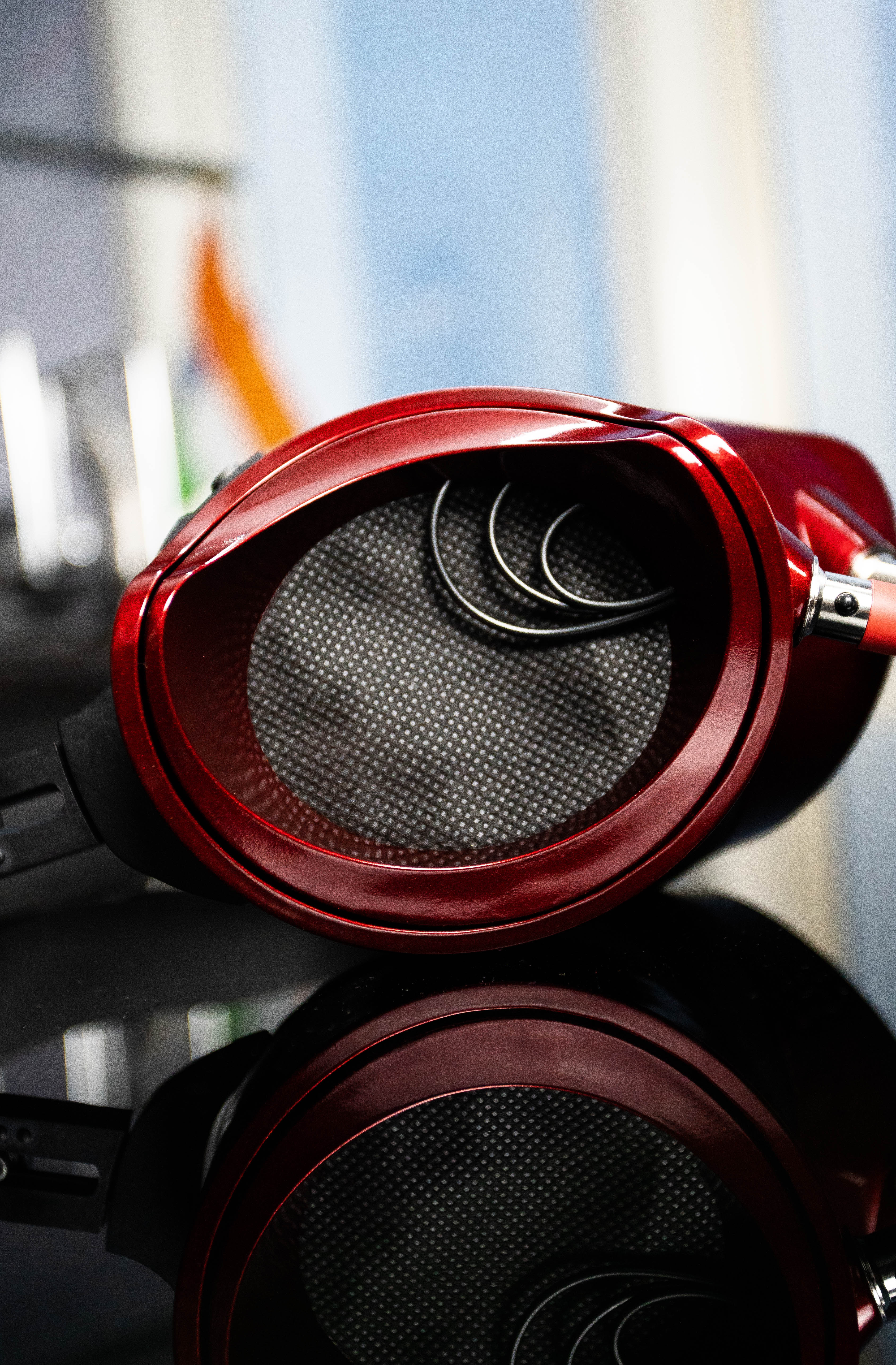

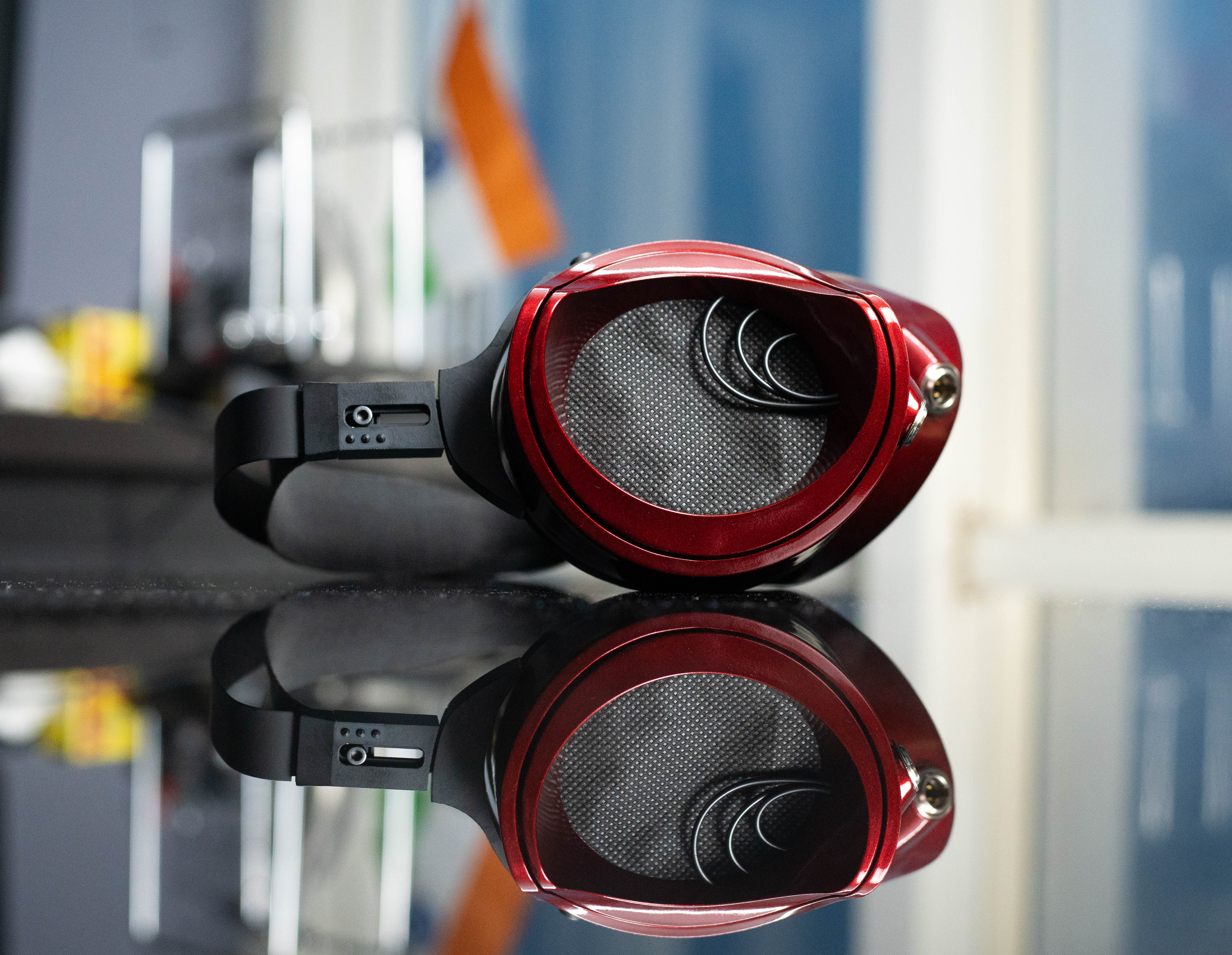

Aumkar Chandan Posted November 3, 2020 Report Share Posted November 3, 2020 Here are some photos of a recent Bespoke unit we delivered - 7 Quote Link to comment Share on other sites More sharing options...
Lord_Rexter Posted November 3, 2020 Report Share Posted November 3, 2020 Hmm so you have resumed taking in Bespoke orders, good news, Aumkar ✌️ 1 Quote Link to comment Share on other sites More sharing options...
morphsci Posted November 3, 2020 Report Share Posted November 3, 2020 I am not especially fond of red headphones, but I find these really stunning. Excellent job. 2 Quote Link to comment Share on other sites More sharing options...
