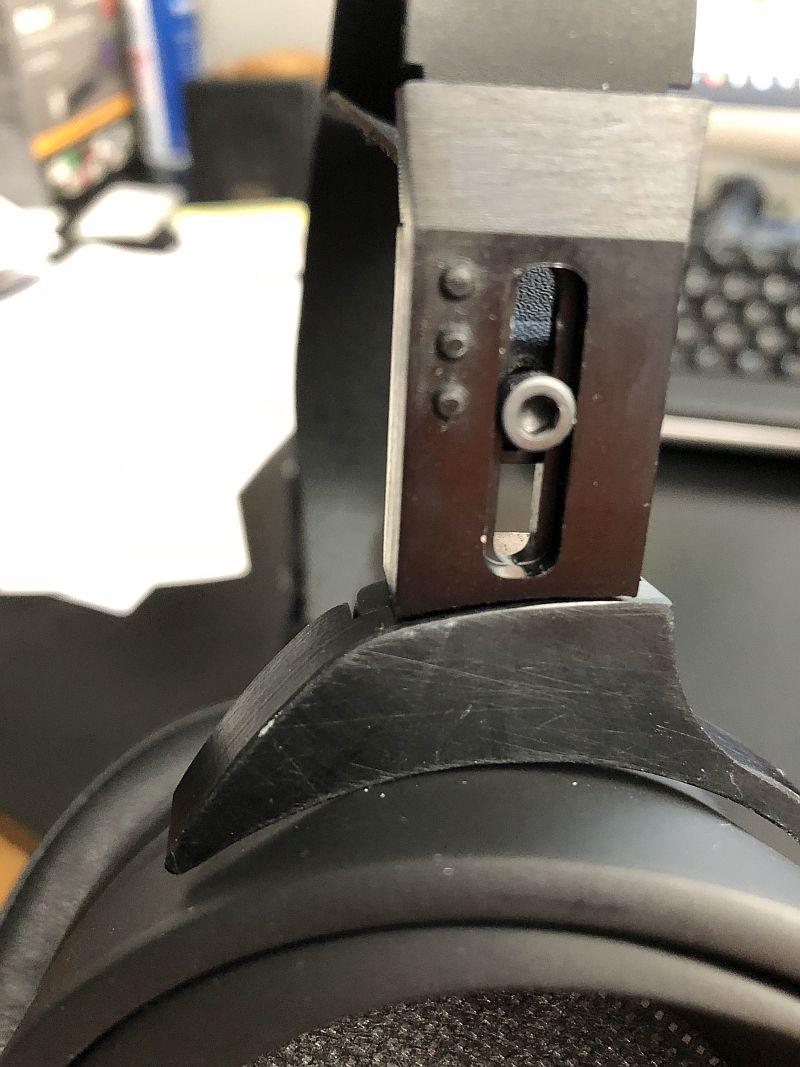

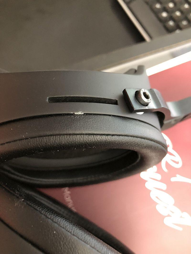

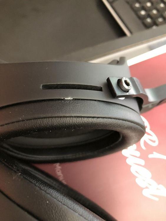

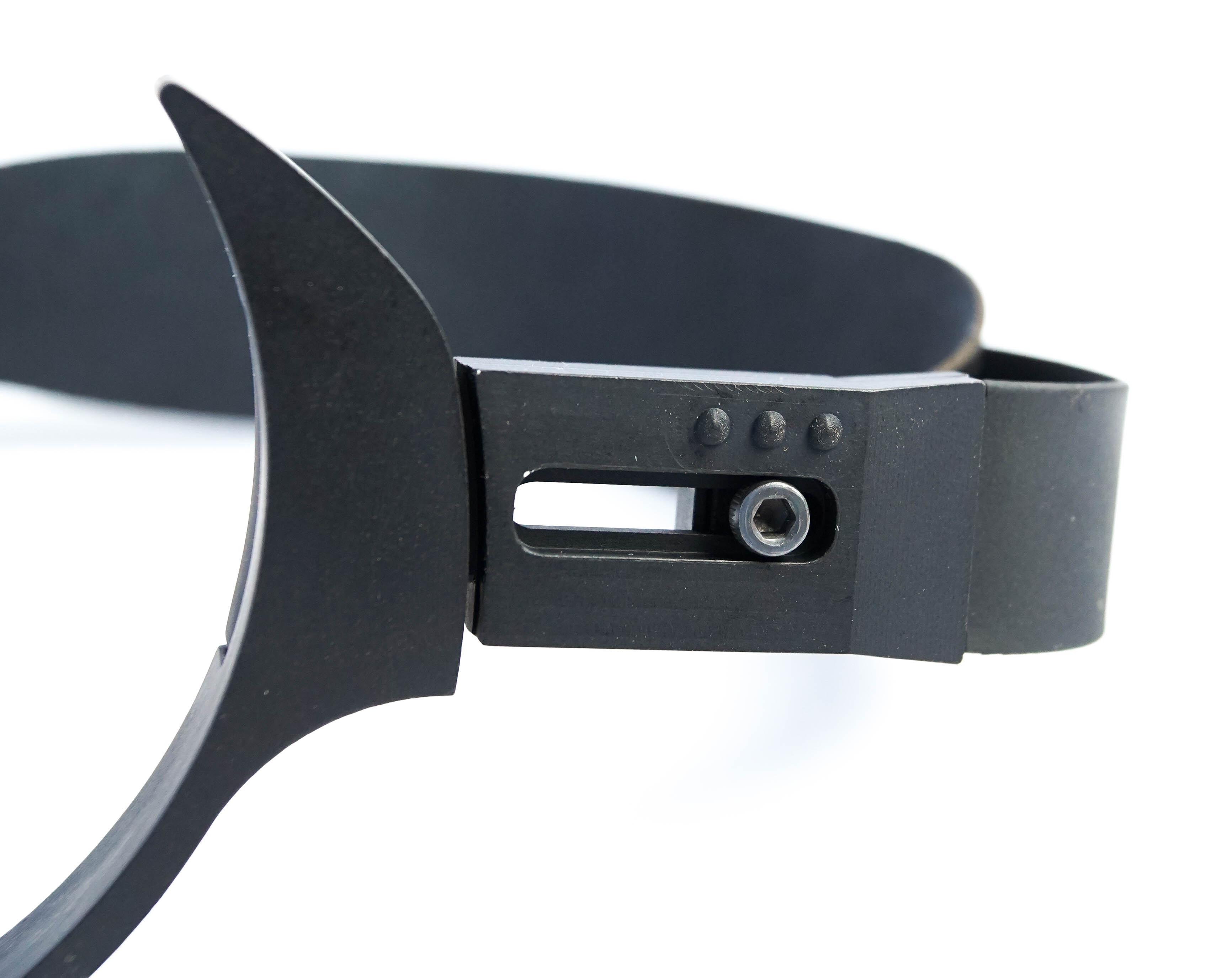

skullguise Posted January 31, 2020 Report Share Posted January 31, 2020 (edited) I did pick one of these up....unfortunately have not had SO much time to listen, but first impressions and maybe 10-15 hours worth are good. Great bass, soundstage, and top to bottom balance. Some musicality/transparency I still like a little bit better with SR-007 Mk II, but this is no slouch at all! My complaints were that the workmanship can be improved. Mine came with several marks or imperfections on the metal portions of the headband and related, and one ugly mark on one of the earcups. For the $, though....it is REALLY nice! Edited February 1, 2020 by skullguise 1 Quote Link to comment Share on other sites More sharing options...

skullguise Posted January 31, 2020 Report Share Posted January 31, 2020 Premium has a longer cord and supposedly better packaging. It IS a nice wood box with acrylic top and a badge. I got that because I had the $ to spend and it was the only one in stock. They claimed the scratch in the earcup was likely from shipping, but not sure....it looked like it was well-protected, at least that spot....and it didn't quite line up with anything that looked like it would scratch it. Some pics of my nicks and such below. 2 3 Quote Link to comment Share on other sites More sharing options...
jose Posted January 31, 2020 Report Share Posted January 31, 2020 Ummm….. I expected a little more attention to detail. I was about to finish the purchase when I saw your photos. I think I'll wait a little to see if unfortunately your problem has been a coincidence. 2 Quote Link to comment Share on other sites More sharing options...
skullguise Posted January 31, 2020 Report Share Posted January 31, 2020 I think they'll do their best to improve. There are admittedly some corners that may be cut for $500. I think that the more I listen, the less I'll be bothered by the imperfections/issues. 1 Quote Link to comment Share on other sites More sharing options...
jose Posted January 31, 2020 Report Share Posted January 31, 2020 6 minutes ago, skullguise said: ...I think that the more I listen, the less I'll be bothered by the imperfections/issues. I´m glad skullguise I wouldn't like to offend anyone with what I'm going to say. I don´t doubt that it sound good and their price is quite "affordable" but... For less than that, we would be quite rude to other (included Stax). I´ll think about it for a few days. Maybe they have stock of the premium version again. Quote Link to comment Share on other sites More sharing options...
Aumkar Chandan Posted February 1, 2020 Report Share Posted February 1, 2020 Yes, those imperfections of the Aluminium on Todd's headband is indeed correct. There is a story behind it though, mid-way in our production our Anodizing guy decided to go rogue. The finished parts weren't dark enough and for some reason he was not able to rectify it. We were left with some inventory that was fair but far from perfect and as a small Manufacturer, we couldn't afford to scrap it. Eventually, we did find a reliable Anodizing company and have been working with them since December albeit, they are interesting to deal with as well. This leads me to believe either there is some money to be made in the Anodizing industry or the entire industry has undercut itself beyond sustainability. Furthermore, we made some changes to our tool-paths as well and have added an additional facing operation on all sides to improve the surface finish without needing additional processes like brushing or sand-blasting. This may seem like something to do since the beginning but since we don't have a 5-Axis that we own, it adds more machining time and lowers our output even more. Every single part is made in-house. We also have transitioned from 3D Printed Earcups to full Injection Earcups. Again, to improve our production rates so we can focus on things that are more delicate and intolerant. Anyway, I do take the responsibility but just wanted to share why. With vertical integration although QC is in our hands, it is challenging to be this stringent at this price point especially when you are running out of Capital. 7 1 Quote Link to comment Share on other sites More sharing options...
Torpedo Posted February 1, 2020 Report Share Posted February 1, 2020 Thanks for the clarification, Aumkar. To my eyes the blemishes look rather acceptable. I understand we're paying for very good sound quality at a price point, not for luxury finishes. 1 Quote Link to comment Share on other sites More sharing options...

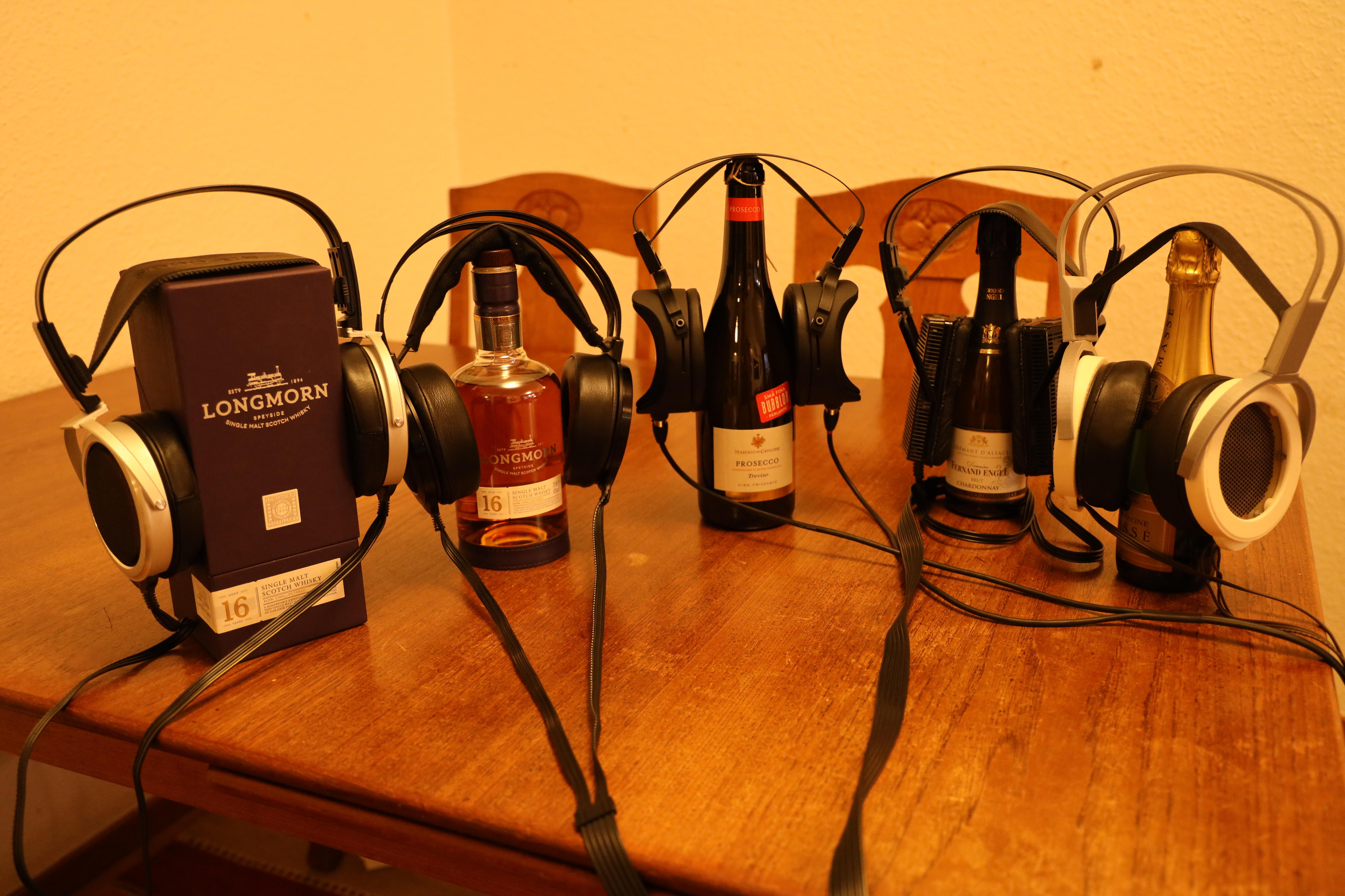

JoaMat Posted February 7, 2020 Report Share Posted February 7, 2020 Finally she (in the middle, on the Prosecco) arrived from India. Surrounded by her new family. 17 Quote Link to comment Share on other sites More sharing options...
Kerry Posted February 8, 2020 Report Share Posted February 8, 2020 Multi-purpose stands... Very nice 1 Quote Link to comment Share on other sites More sharing options...

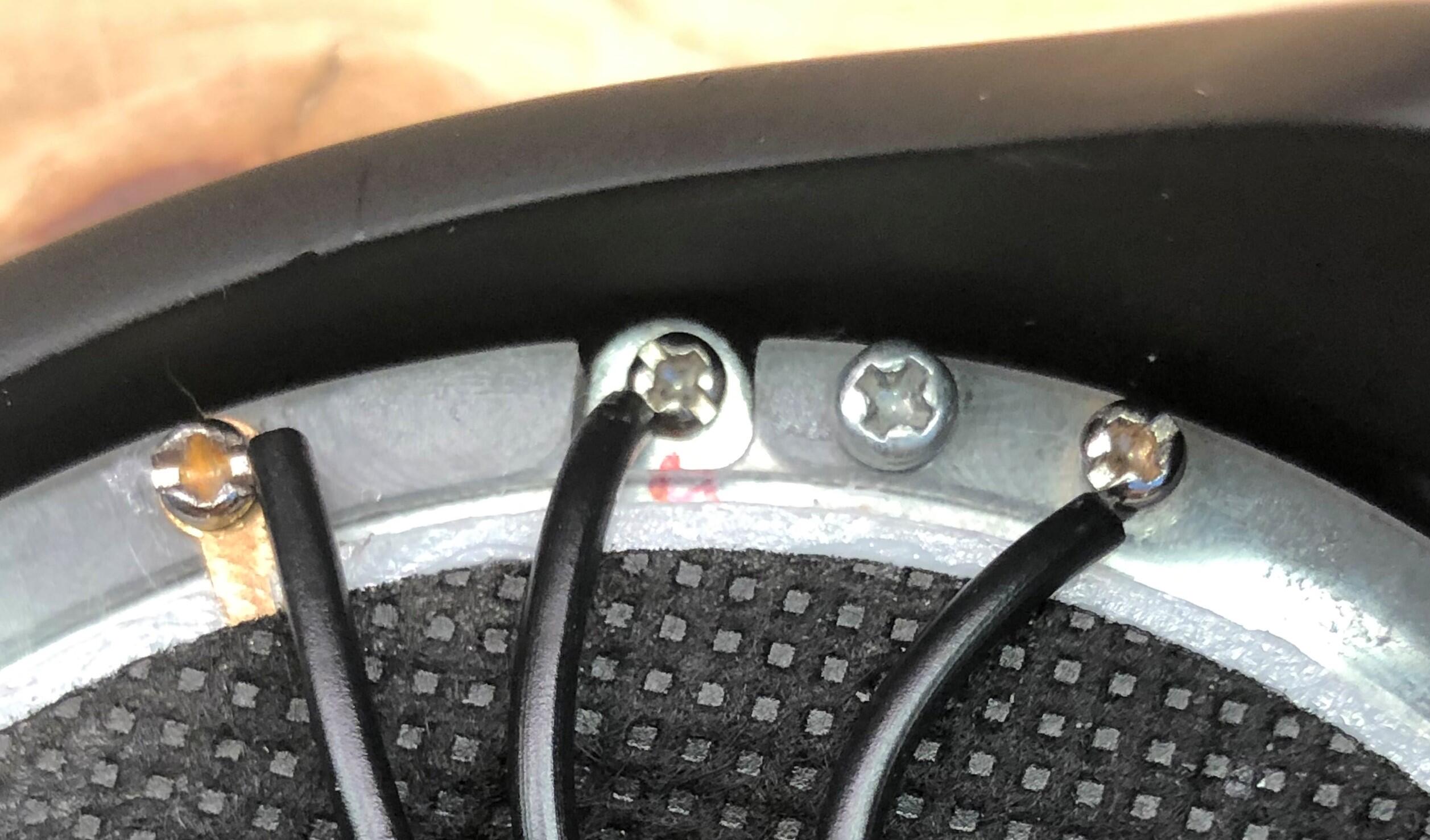

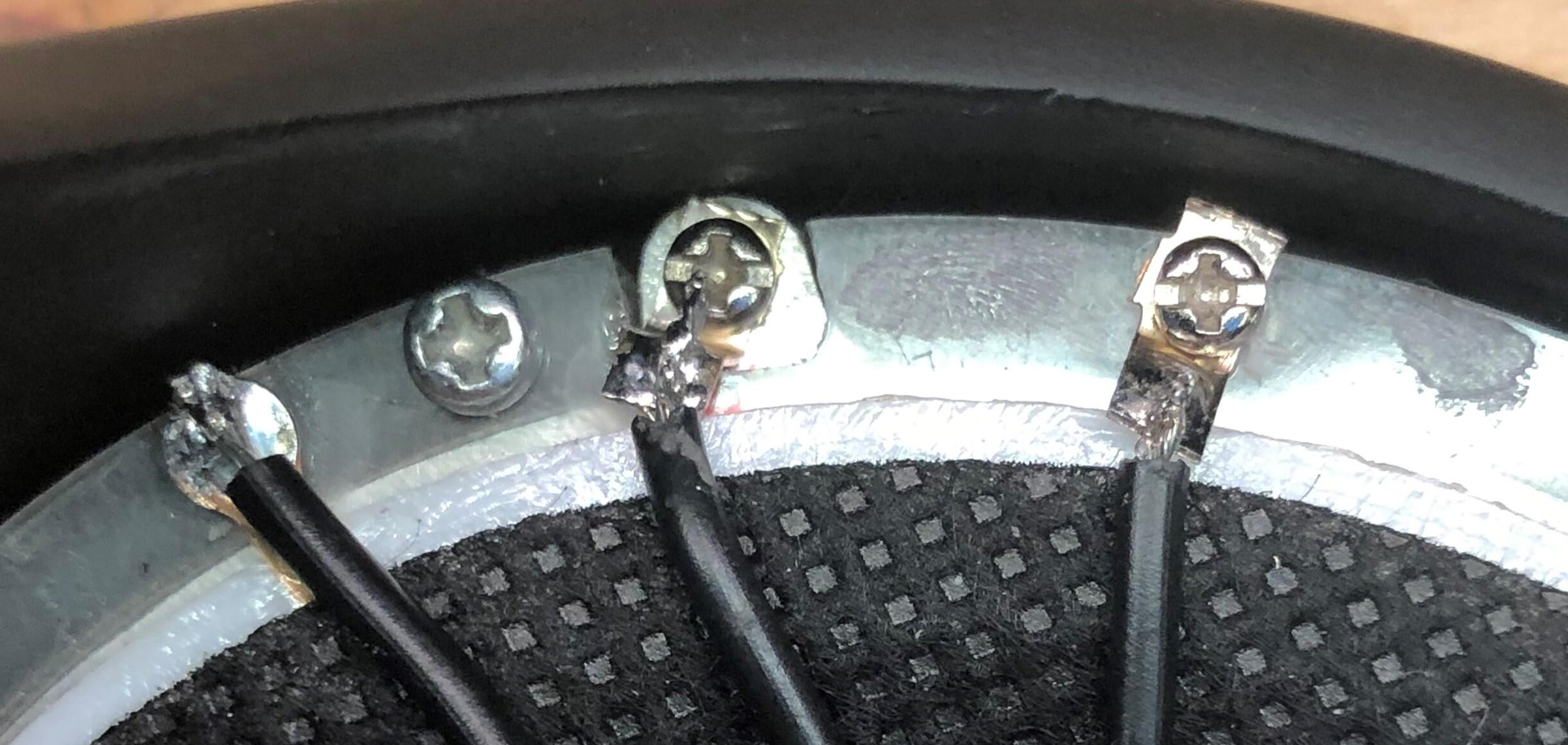

JoaMat Posted February 10, 2020 Report Share Posted February 10, 2020 (edited) Now I’ve listened to the RR 1 headphones for a couple of days and I still take vitamins from the left cabinet. Suddenly the right side begin to play very low, which gave me a good reason to disassemble the headphone. It turned out that the wire to front stator was loose. Wires are connected to stators and diaphragm by running M2 bolts through holes in the driver unit and with wire simply put in their respective hole with its bolt. As some of you maybe know I dislike things like terminal blocks and want wires to be soldered direct in place. So now wires are soldered in place with solder lugs and I’m happy again. Edited February 10, 2020 by JoaMat 1 1 Quote Link to comment Share on other sites More sharing options...
Aumkar Chandan Posted February 10, 2020 Report Share Posted February 10, 2020 (edited) Interesting, not sure how the bolt would come loose. Stators are now laser-cut Brass, you can directly solder onto them if you like. The front Stator connection might be challenging due to packaging reasons but it is workable if you want to solder it and not use our bolt method. Furthermore, every part of the Driver is serviceable because it’s all bolted and no glue is used. Spacer is Aluminium though. Edited February 10, 2020 by Aumkar Chandan 1 1 Quote Link to comment Share on other sites More sharing options...

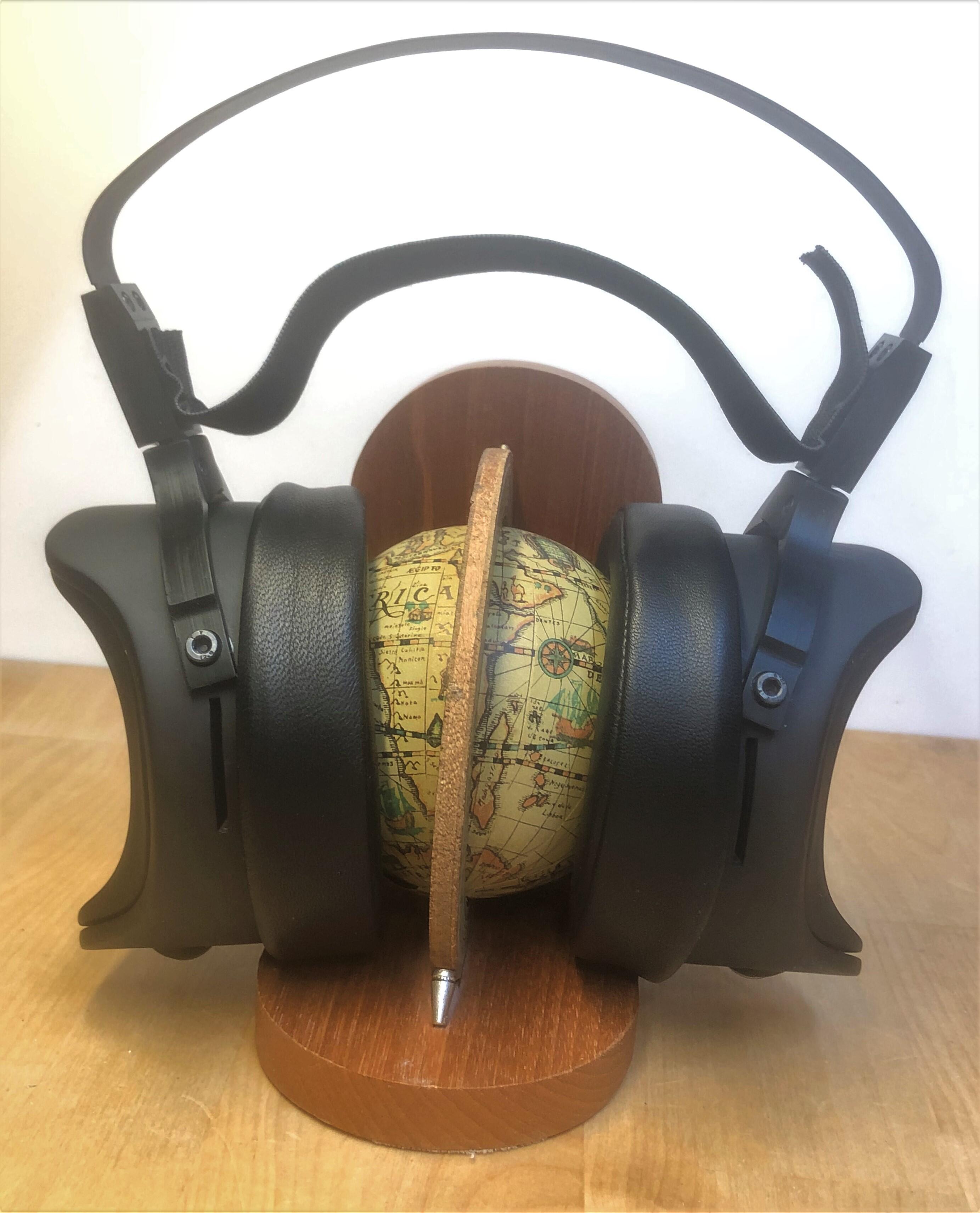

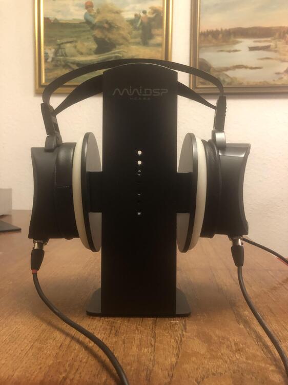

JoaMat Posted February 10, 2020 Report Share Posted February 10, 2020 The bolt was OK, the wire though was broken. Maybe the bolt damage the wire when it was tightened. Anyhow I got the opportunity to see how the RR 1 is built. I also disassembled the driver unit. Spacers seem to be about 1.3 mm thick and the sound when knocking the diaphragm it sounded about right. And yes, everything is easily accessible, except the pads maybe. Bottom line: I like the design. P.S. As the original pads were removed I took a pair of 007 pads 7 1 Quote Link to comment Share on other sites More sharing options...

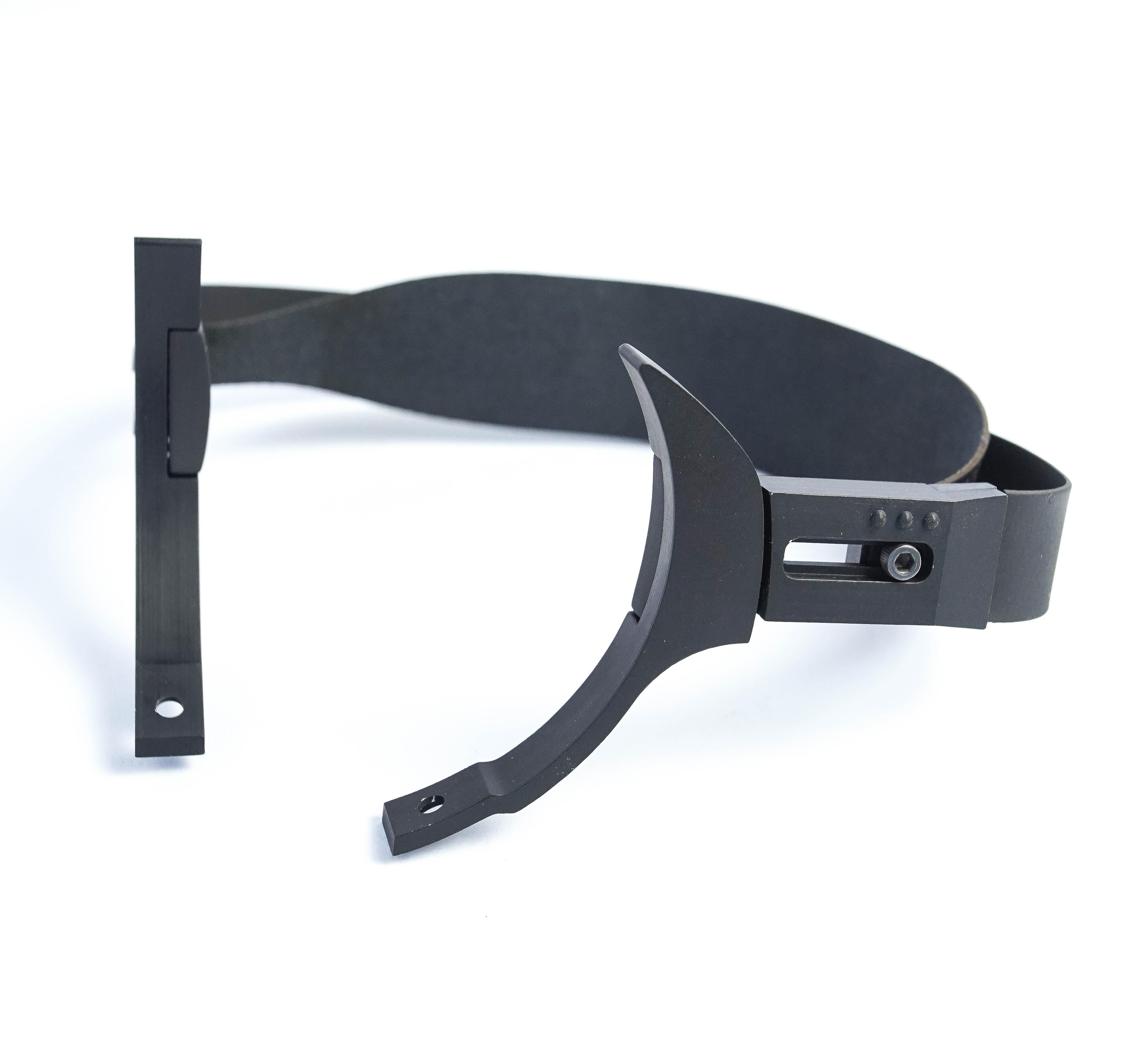

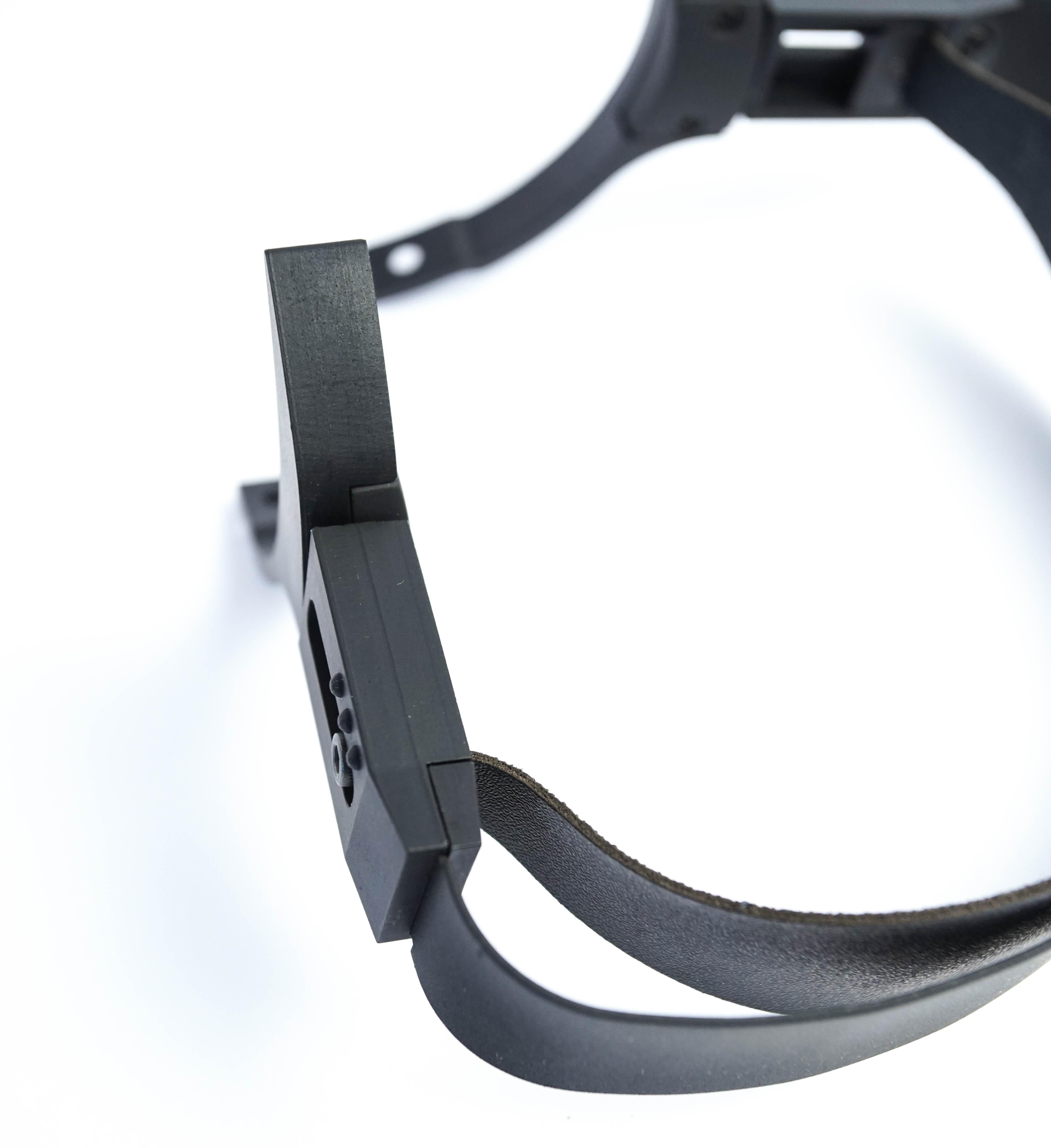

skullguise Posted February 11, 2020 Report Share Posted February 11, 2020 Hey all, as a follow-up on my posts, Aumkar and team sent me a new headband assembly; just received today and it looks much nicer! 9 Quote Link to comment Share on other sites More sharing options...

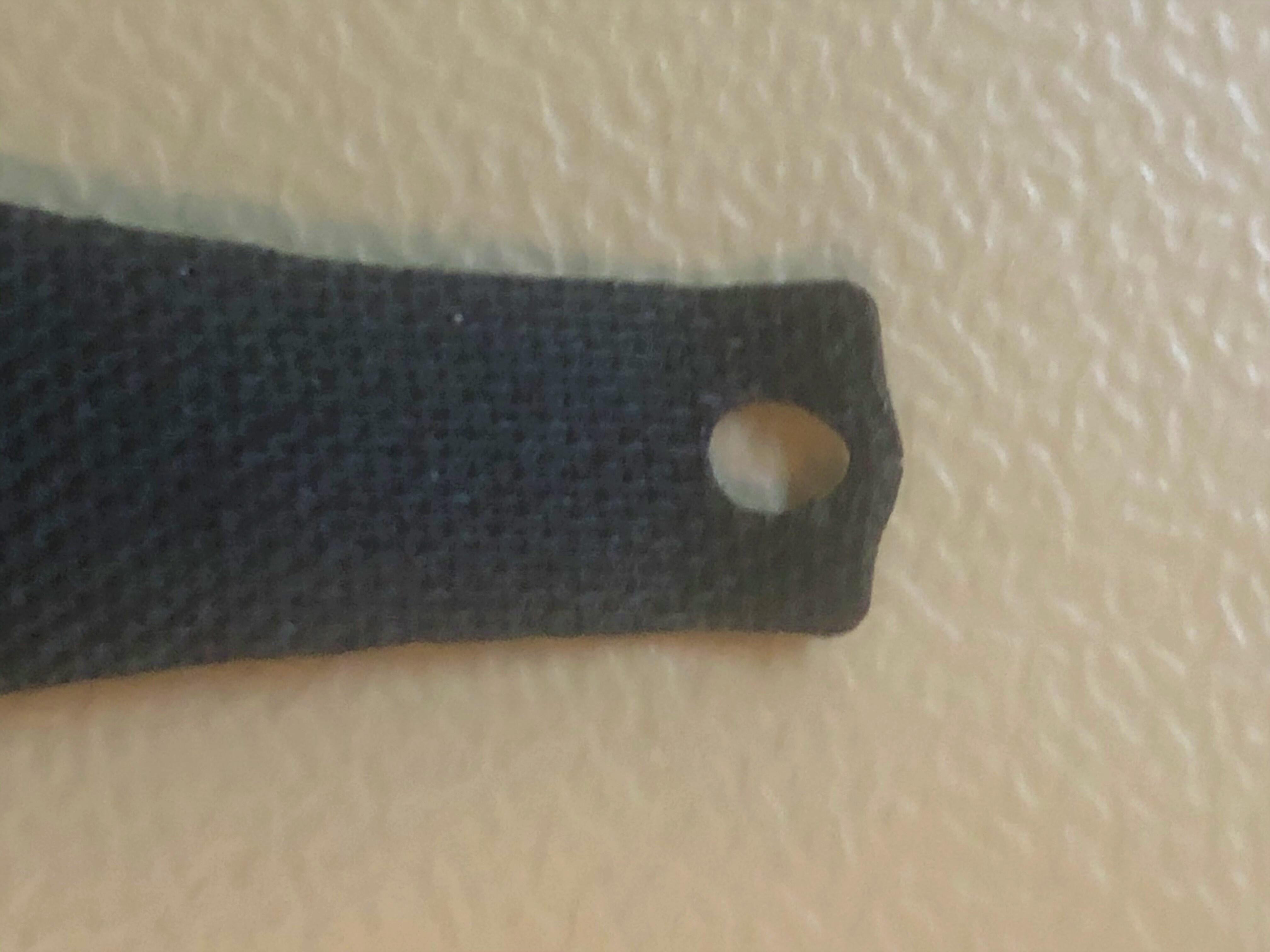

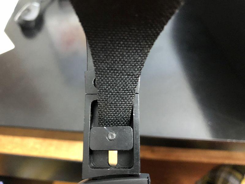

JoaMat Posted February 11, 2020 Report Share Posted February 11, 2020 Removed head band and it looks like this. I suspect it will break, probably sooner than later, so I took some of my wife’s elastic band and replaced the original band. I’m using same elastic band with my two kitchen made headphones and I’ve found the elastics quite comfortable. 2 Quote Link to comment Share on other sites More sharing options...
