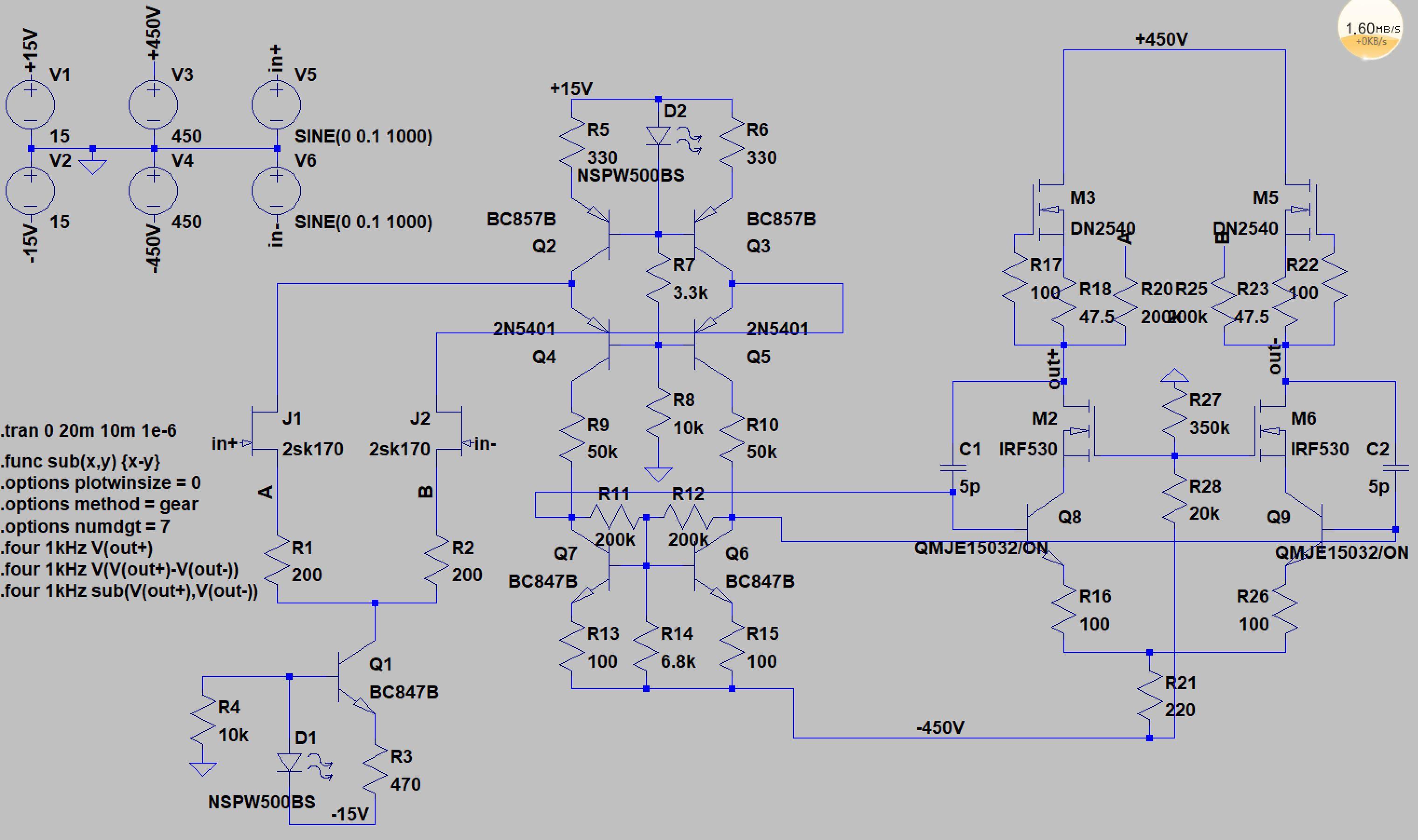

Posted
Since the KGSSHV Carbon is famous as a reference of electrostatic amp, I think it would be better to do some spice simulations to check the baseline of its circuit.
Many components were not found in LTSPICE so I used similar ones instead. It works except the quiescent current at the output stage is large. (Anyone could please tell me what it is ?)
Now I meet a problem, that is, how to use the fourier transfer directive (.four) on the voltage between two output ? I tried many way but all failed:
Fourier components of V(out+)
DC component:-3.16154
Harmonic    Frequency     Fourier     Normalized     Phase      Normalized
 Number       [Hz]       Component     Component    [degree]    Phase [deg]
    1       1.000e+03    9.355e+01    1.000e+00       -0.93°        0.00°
    2       2.000e+03    2.356e-02    2.518e-04      -94.27°      -93.34°
    3       3.000e+03    2.172e-04    2.321e-06      -21.46°      -20.53°
    4       4.000e+03    5.108e-05    5.460e-07      128.27°      129.21°
    5       5.000e+03    3.615e-06    3.864e-08     -154.01°     -153.07°
    6       6.000e+03    5.703e-07    6.096e-09      -51.12°      -50.18°
    7       7.000e+03    1.475e-07    1.577e-09        7.65°        8.58°
    8       8.000e+03    1.874e-07    2.003e-09       16.11°       17.04°
    9       9.000e+03    8.659e-07    9.256e-09      164.63°      165.56°
Total Harmonic Distortion: 0.025185%
.fourier quantity "V(v(out+)-v(out-))" not pressent in data.
Thank you.
Yes I can check it in the FFT draw, but still want a text report.

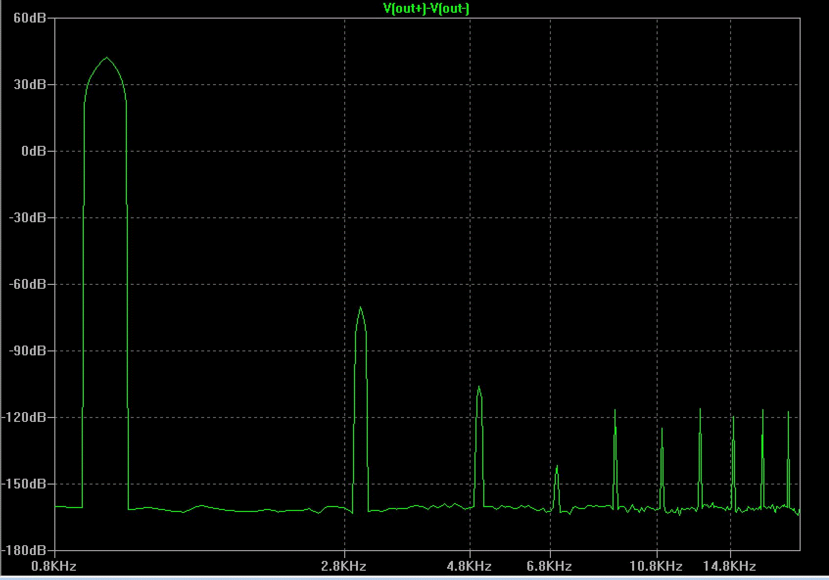

Posted
find the solution, just input V(out+,out-) will be OK.
Fourier components of V(out+,out-)
DC component:-6.40787e-008
    1       1.000e+03    1.441e+02    1.000e+00       -0.93°        0.00°
    2       2.000e+03    5.728e-08    3.976e-10       -3.00°       -2.06°
    3       3.000e+03    1.966e-04    1.365e-06      -22.41°      -21.48°
    4       4.000e+03    1.111e-07    7.712e-10       -0.34°        0.60°
    5       5.000e+03    2.646e-06    1.837e-08     -164.58°     -163.65°
    6       6.000e+03    1.705e-07    1.183e-09        2.85°        3.79°
    7       7.000e+03    2.017e-07    1.400e-09       20.00°       20.93°
    8       8.000e+03    2.243e-07    1.557e-09        1.29°        2.22°
    9       9.000e+03    1.429e-06    9.920e-09      163.50°      164.43°
Total Harmonic Distortion: 0.000136%
the THD is fairly good
