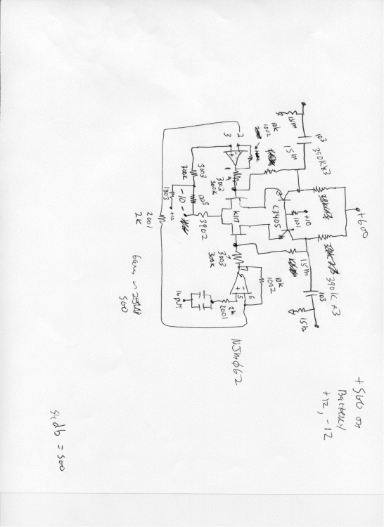

kevin gilmore Posted April 8, 2019 Report Posted April 8, 2019 (edited) The srm-001 is an opamp driving a fet that drives a transistor (cascode) into a load resistor and is cap coupled to the output. (cascode differential) The jade2 is an opamp driving a transistor that drives a mosfet (cascode) into a load resistor and is cap coupled to the output. The calculation of output capacitance is flat out wrong as the middle of the cascode is AC ground. (cascode differential) Just about identical. Obviously the jade2 consumes a bunch more power and puts out a bunch more power. I own 2 hifiman products. Both are built like shit. I'm unlikely to buy hifiman products ever again. Edited April 8, 2019 by kevin gilmore 7 1 3 Quote

kevin gilmore Posted April 9, 2019 Report Posted April 9, 2019 history lesson (unless birgir says otherwise) As far as I can tell the first stax amplifier to use differential cascode circuit is the srm-1 first introduced in 1979 long before hifiman was even a company 2 1 Quote
spritzer Posted April 10, 2019 Author Report Posted April 10, 2019 Yes, I think that was the first one. I can't find the schematic with a quick search but it should be here somewhere. Then we had the SRM-1 Mk2 first version in 1982 but in reality, most of that improvement had already been done to the later SRM-1 amps. It's fun to open those up... you never know what you are going to find. Quote
