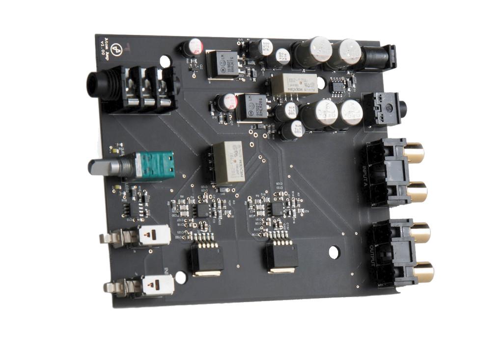

Veri Posted November 15, 2018 Report Posted November 15, 2018 Would like to hear some thoughts from the experts here? Most commercial boards are thrash just looking at the head-case forum posts. or you guys are super sceptical or both. No picture of backside PCB (yet) though. Thanks for any insight Cheers Quote
kevin gilmore Posted November 15, 2018 Report Posted November 15, 2018 (edited) lets see jds atom $99 opamp and output buffer, lots of feedback, dual power supply, probably the lowest thd of the bunch. made in usa schiit magni3 $99 discrete current feedback amp, minimal feedback, dual power supply, probably the highest thd of the bunch. made in usa monoprice liquid spark $99.99 voltage feedback amp, fair bit of feedback, rail splitter power supply, in the middle for thd.made in china sounds like a big pile of same same Edited November 15, 2018 by kevin gilmore 2 1 Quote
