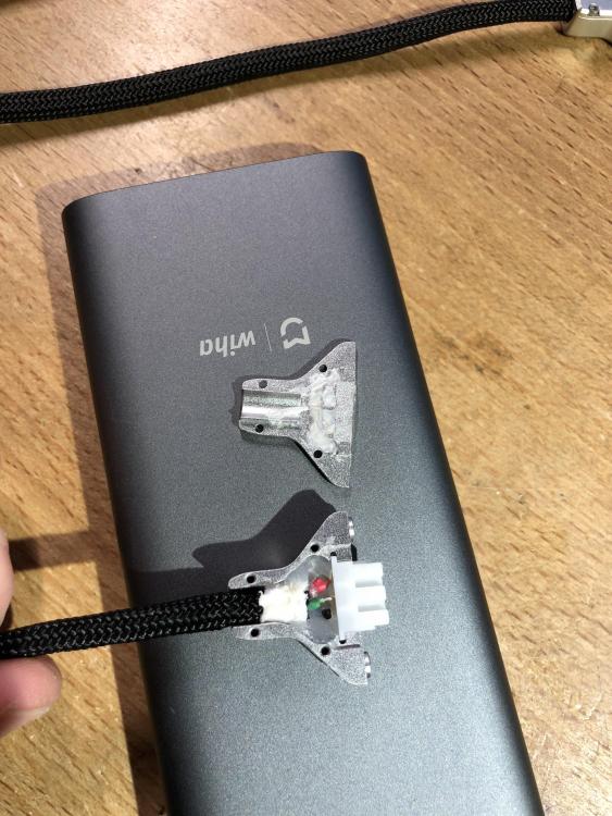

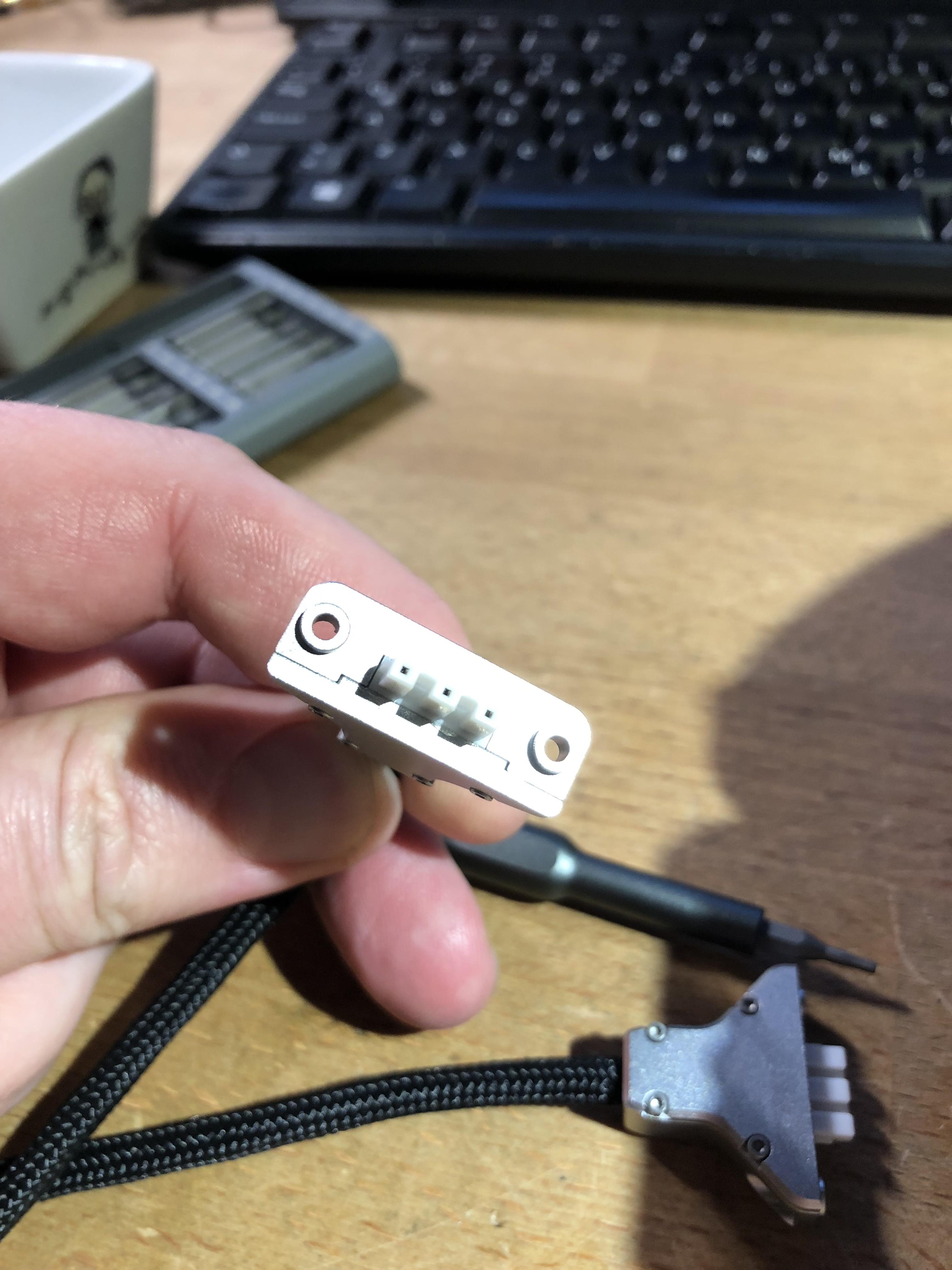

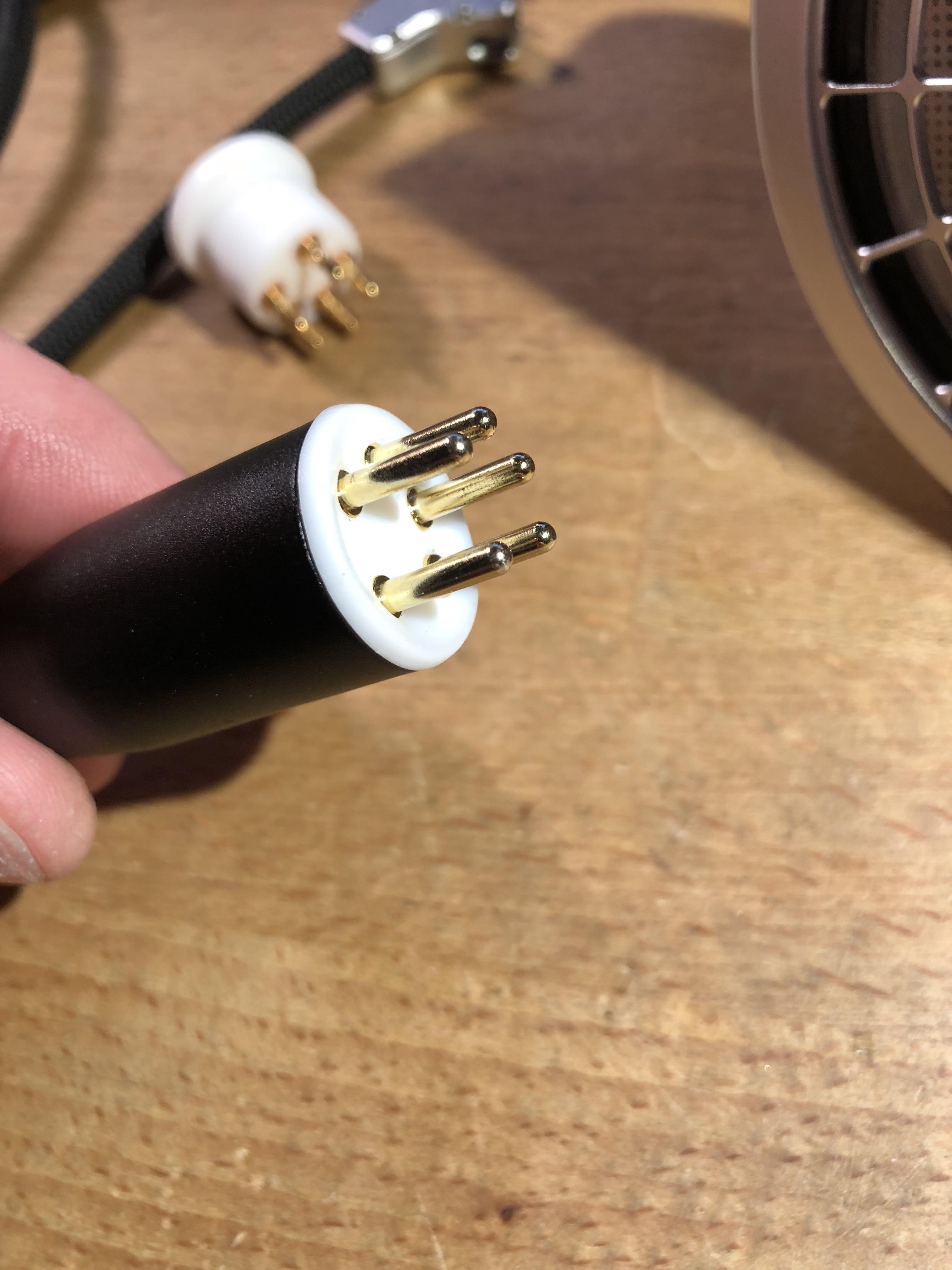

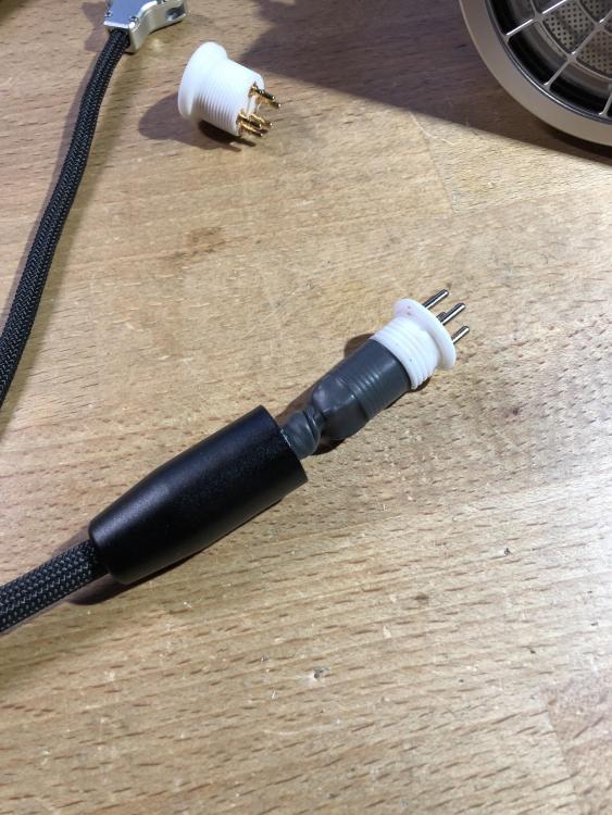

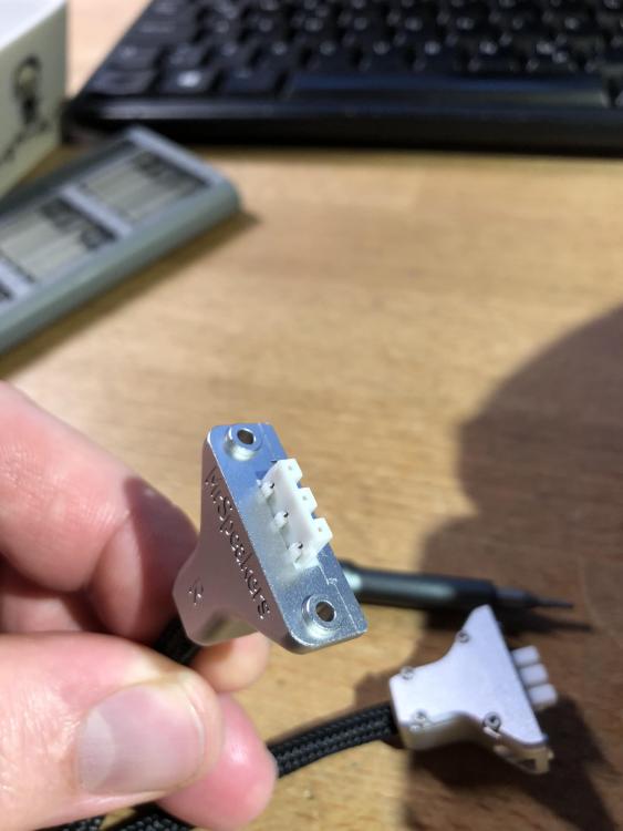

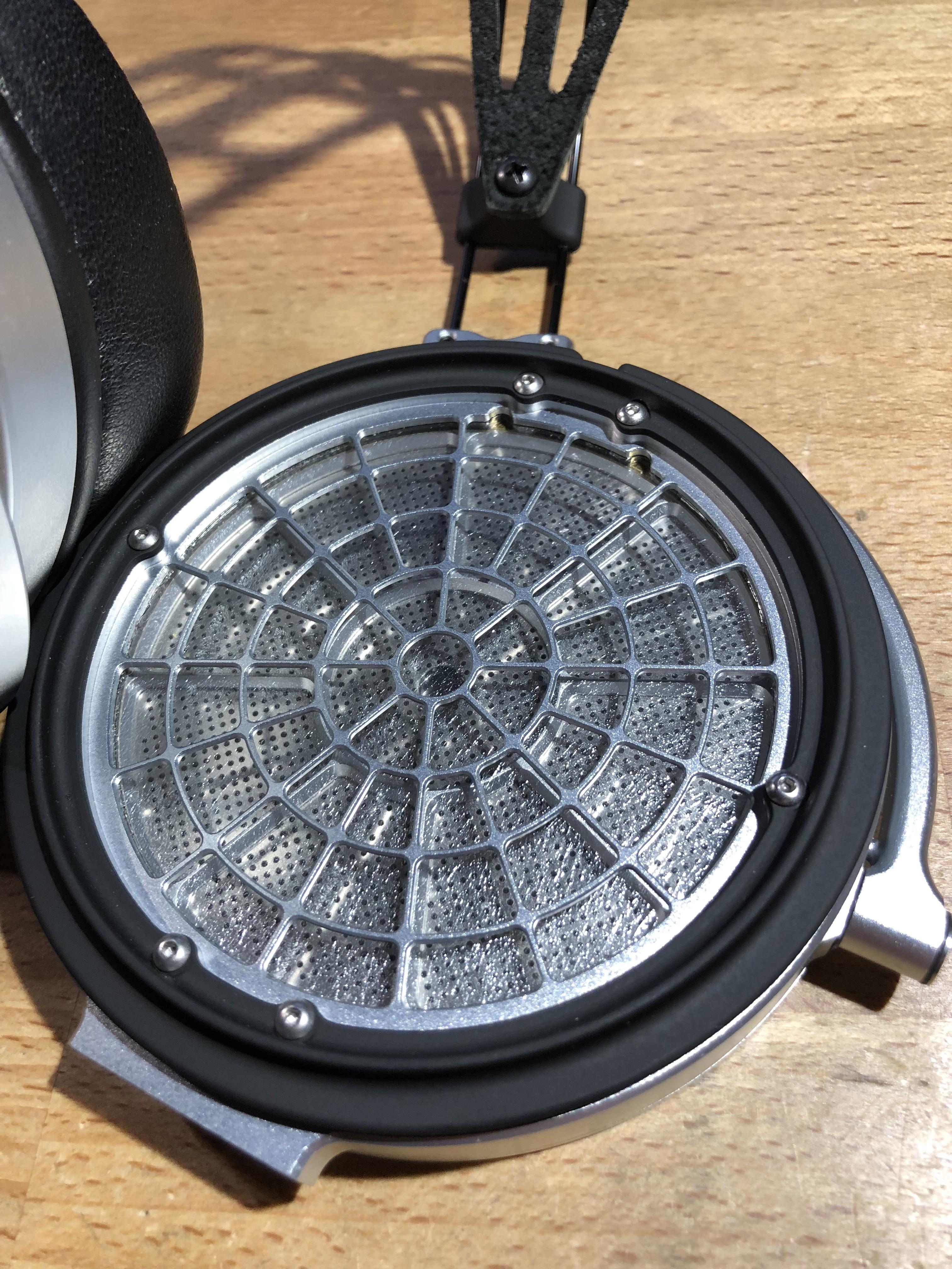

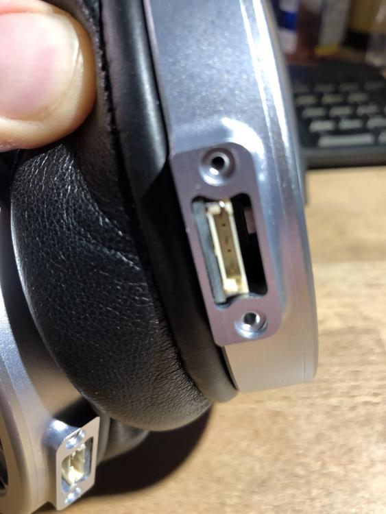

spritzer Posted October 30, 2018 Author Report Posted October 30, 2018 So here are some pics as I begin to take these apart. My main camera was out of juice so I just grabbed the phone for this. Not perfect but blame Apple then... First off the Stax plug: It's hard to see but the pins are in this concave indent and clearly meant to be like that (see the next pic) but this might be why some of the pins arrived bent. Put on a spare socket and twist to unscrew the metal cover. Bonus shot of the new threaded teflon Stax sockets... I'm glad they put heatshink over it all but it also means I won't remove it until I can completely take the cable apart. To give them a fair shake they have to be as close to stock as possible. The pins appear to be super long though by feeling around underneath it but further research will have to wait. Here are the actual earcup connectors, spaced some 4mm apart according to the Mitutoyo. I need to find out what these were originally used for but they follow the stock Stax wiring (center wire is bias) so they will be easy to convert to Stax wiring. Here is the receiving end which ended up a bit out of focus. I blame my friends at Apple...you know who you are... What this is like on the inside will have to wait a while as too busy to take them apart fully. I did get here though... Pull off the earpad and remove the stupid foam pad to reveal pretty much what is on the outside. The black bit is rubberized so we'll see how the baffle seal on these is. 3 3 Quote
