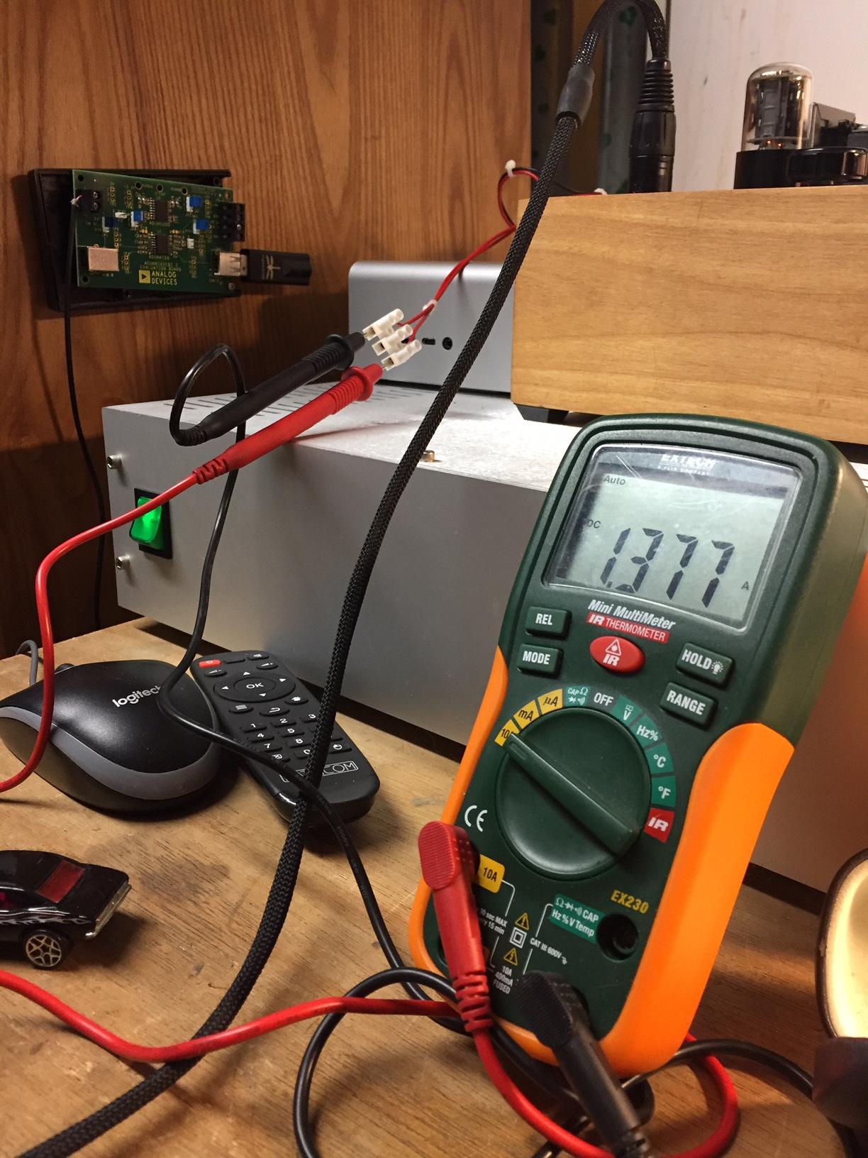

sbelyo Posted November 12, 2019 Author Report Share Posted November 12, 2019 built a tap of sorts to see what my STX build draws just to make sure the transformer I have is adequately sized. The max it pulled was 2.1 amps at 19Vdc durring a CPU stress test. Salas says make sure you have 2x the capacity. Just now, sbelyo said: built a tap of sorts to see what my STX build draws just to make sure the transformer I have is adequately sized. The max it pulled was 2.1 amps at 19Vdc durring a CPU stress test. Salas says make sure you have 2x the capacity. Pars built the Dynalo Mini in the picture Just now, sbelyo said: Quote Link to comment Share on other sites More sharing options...

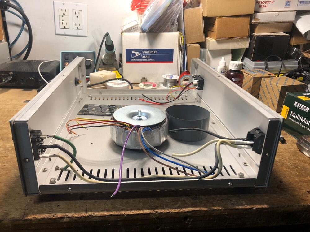

sbelyo Posted April 19, 2020 Author Report Share Posted April 19, 2020 better late than never... Assembled the case today 4 Quote Link to comment Share on other sites More sharing options...
sbelyo Posted July 6, 2021 Author Report Share Posted July 6, 2021 started this build this weekend... Quote Link to comment Share on other sites More sharing options...

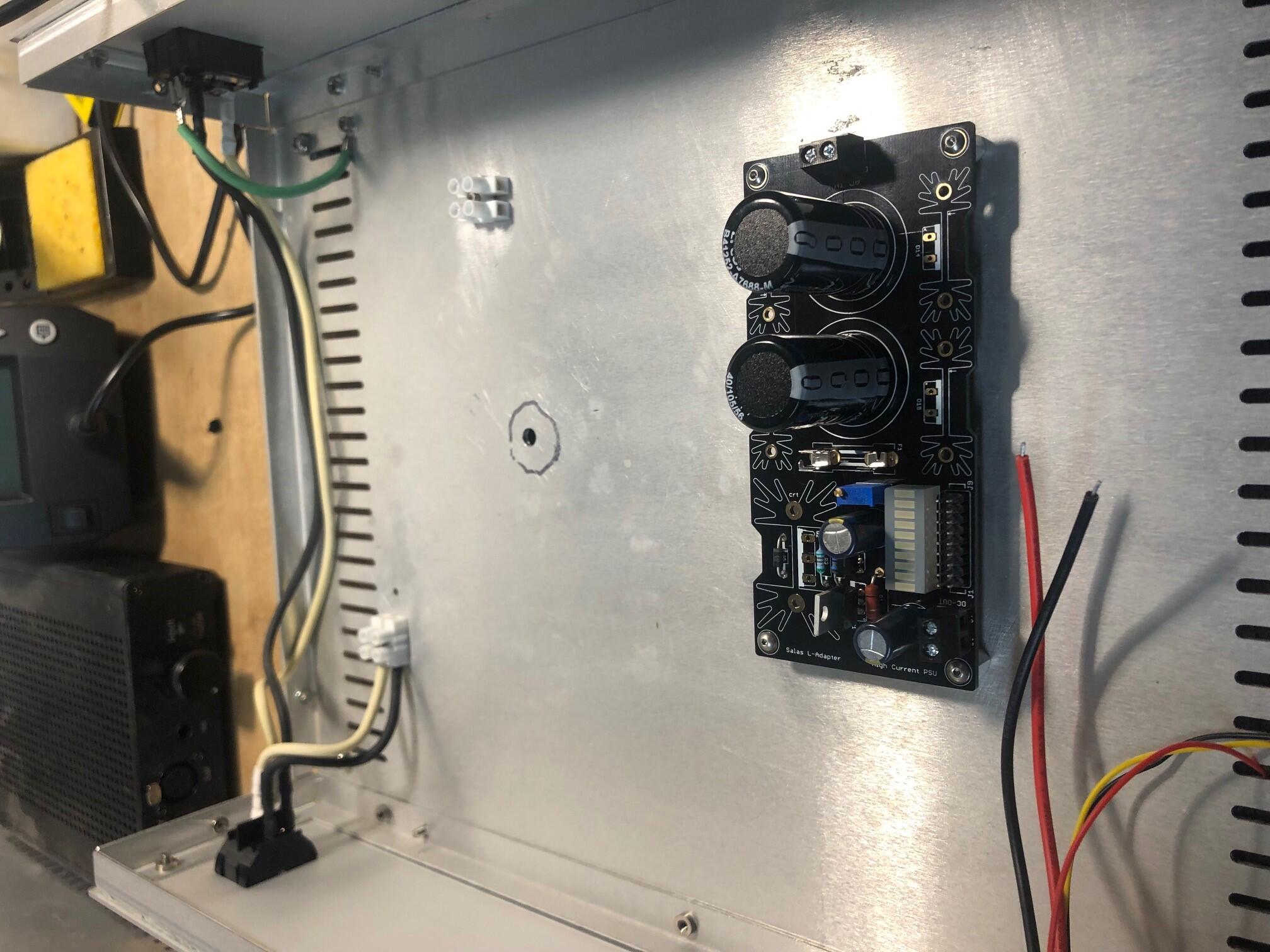

sbelyo Posted August 22, 2021 Author Report Share Posted August 22, 2021 making some progress... Just need to figure out the wiring for the voltage and current display Quote Link to comment Share on other sites More sharing options...

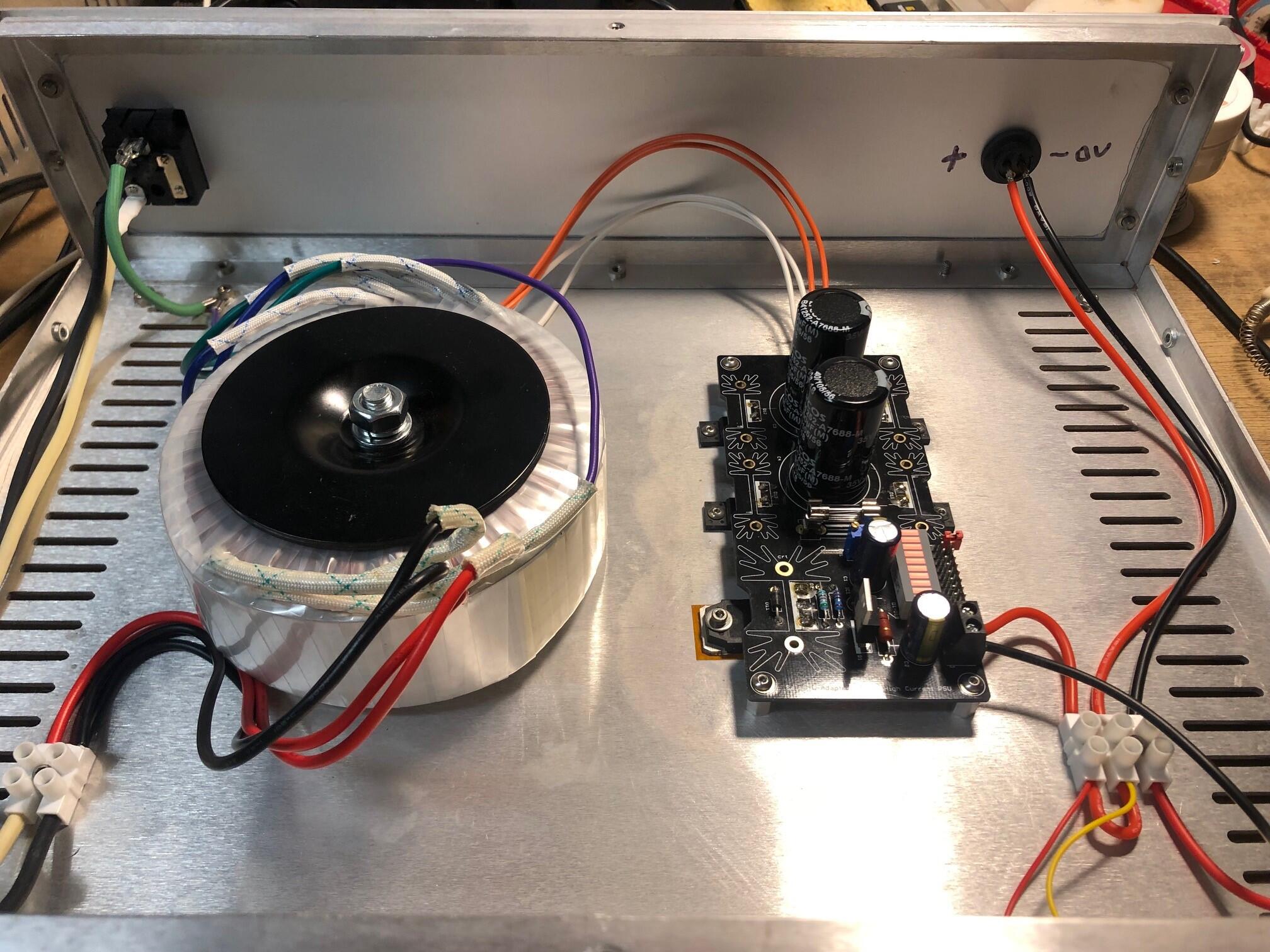

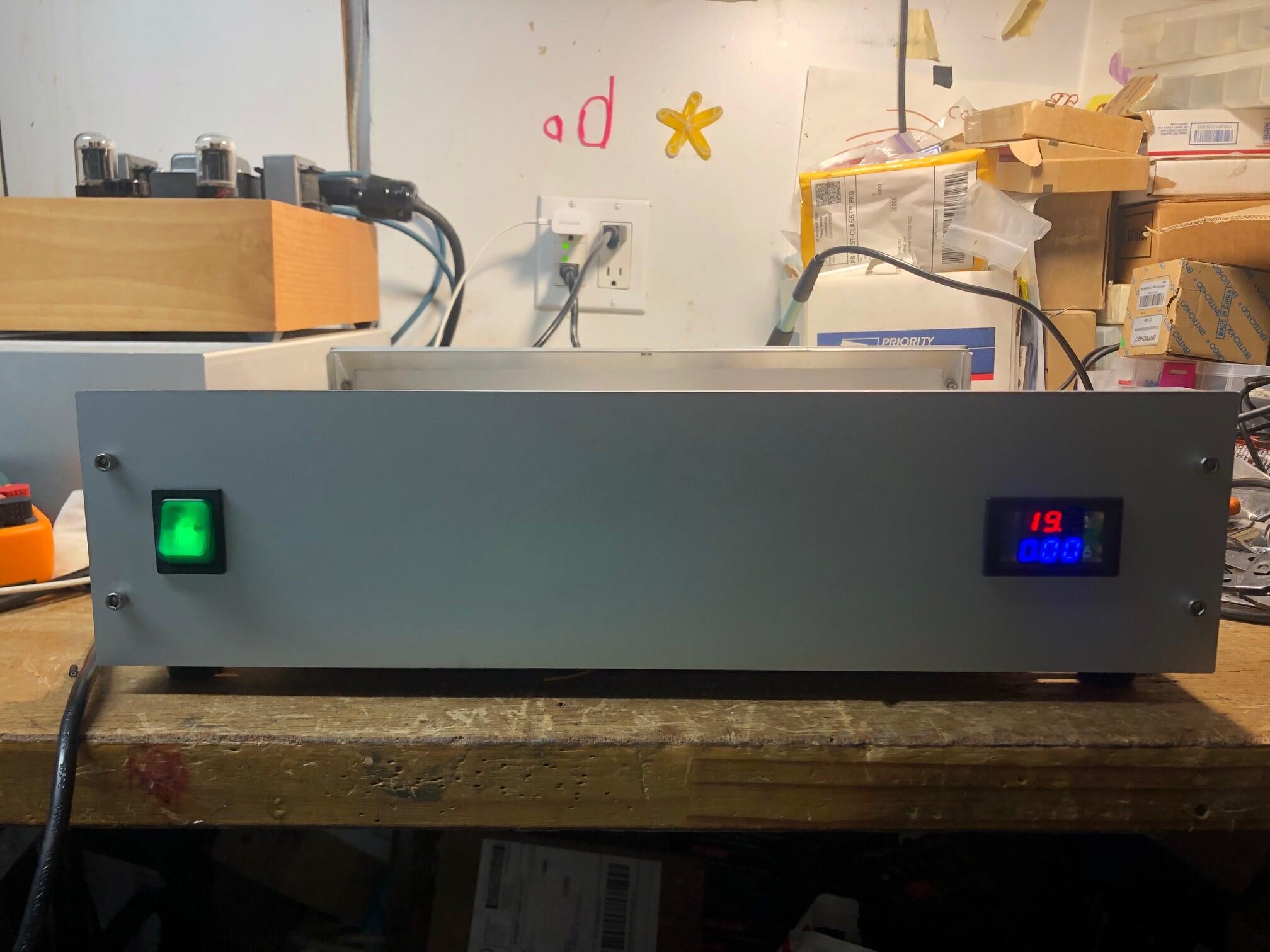

sbelyo Posted October 4, 2021 Author Report Share Posted October 4, 2021 Here's the completed working PSU. My first build of 2021 Quote Link to comment Share on other sites More sharing options...

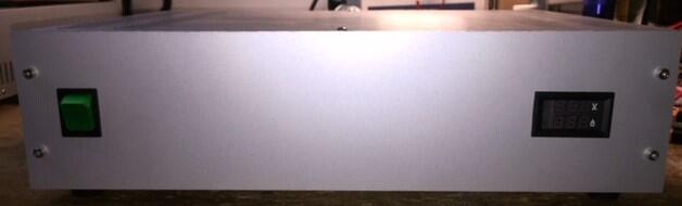

bbest Posted October 4, 2021 Report Share Posted October 4, 2021 On 7/4/2018 at 4:12 AM, sbelyo said: So I was thinking of building a linear psu for a new PC. I came across this kit on ebay https://www.ebay.com/itm/LPS200-Linear-Power-supply-kit-board-LPS-DC5V-9V-12V-15V-19V-24V-28V-L164-5/111964387845?hash=item1a1198fa05:m:m3fiLyO2CiBO8ZWg77rtjeQ Anyone ever use something like this kit? The Teradak products are really cool but pricey I used this one: https://www.diyaudio.com/forums/power-supplies/336685-adapter.html My project: Quote Link to comment Share on other sites More sharing options...
