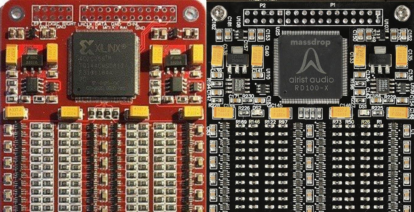

lkong Posted June 7, 2018 Report Posted June 7, 2018 https://www.massdrop.com/buy/massdrop-x-airist-audio-r-2r-dac/talk/2101227?utm_source=linkshare&referer=TYMJB2 On the left, sosolar's design since 2015, on the right "Massdrop Made" by Airist audio. That's a new low for Massdrop. Quote

justin Posted June 7, 2018 Report Posted June 7, 2018 having made lots of circuit boards its funny to read the comments of the people who are going with the "only so many ways to do it" this was copied down to designer personal preference level 4 Quote
kevin gilmore Posted June 7, 2018 Report Posted June 7, 2018 I expect that the fpga code has been leaked and pretty soon everyone will have 24 bit sign magnitude dacs that convert dsd. also this uses actual switches, not the 8 bit shift registers, so it's a better quality product than some of the stupidly priced things. massdrop seems to be doing their best to drop the bottom out of the audio market 2 Quote

kevin gilmore Posted June 9, 2018 Report Posted June 9, 2018 years ago I designed a r2r/sacd dac which I would still like to do. But the fpga code was something I knew nothing about, and when I went searching for someone to do the code I ended up with absurd prices in the $350k range. Now given the amount of time that may have been put into this, that was probably not completely out of the range of reasonable. Over the years that price has dropped, a lot recently, someone is willing to sell me the code for $5k. So its clear that the code has been ripped, or reverse engineered and the source code is now readily available. Its also clear from those pictures that the massdrop board is a virtual identical copy of the hibiki board. There is evidently software out there that will take gerber files and turn them back into editable layout files. my guess is that the firmware in the 2 boards is at least marginally different. so they are not the same even though from a hardware standpoint they are completely identical. in the end its probably going to be shown that even the stupid high priced spreads (msb,totaldac…) will have a code base that started at the same root. another year or 2 and this will all be public domain. Then the math wizzes out there will be able to work on the FIR and IIR code for optimization. 1 1 Quote
