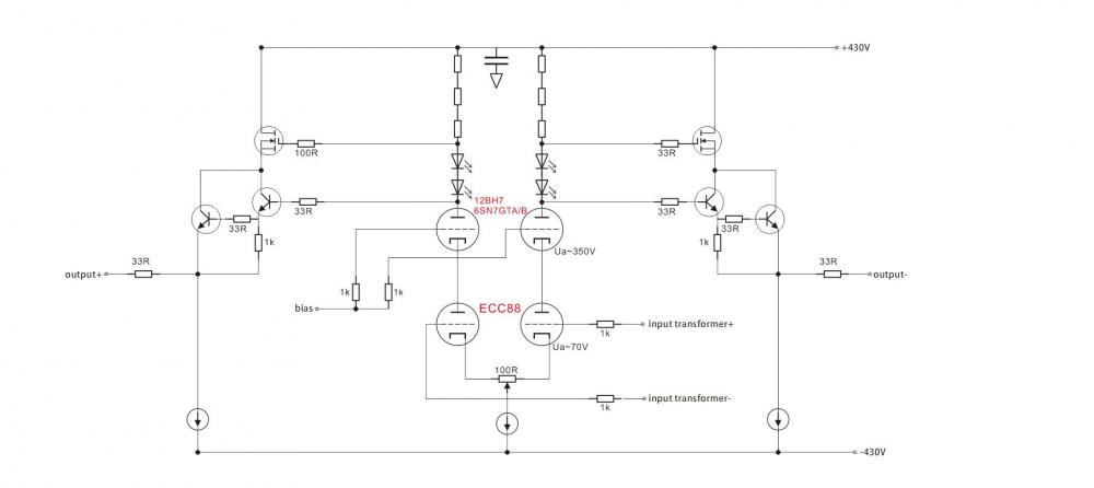

woodear Posted April 12, 2018 Report Posted April 12, 2018 Hi guys,here is my hybrid e-stat amp design using only ONE cascoded voltage gain stage and a solidstate buffer which translate the high output impedance of the voltage gain stage into low impedance. The cascode voltage gain stage uses an ECC88 as input tube, for its low noise and high transconductance, and a 6SN7GTA/GTB to bear the high voltage(anode voltage is around 350V to get reasonable voltage swing). This stage will get approximately 200x, or 46dB gain. And please note that, the grids of ECC88 is biased at around -420V, so you can't really go DC-coupled, coupling capacitors or transformers have to be used. As most digital source components today have an output level of about 2V rms for single-end and 4V rms for balanced outputs, an amp with 46dB gain can output 800Vrms with a 4Vrms balanced input,which already exceeds the power supply limitation of nearly all e-stat amps of the world, so a 46dB gain is definitely enough to properly drive a typical stax headphone, although most e-stat amps' gain is 54dB or 60dB. Finally, there are many options for the output buffer, such as two or single stage high-voltage BJT buffer like SRM-717 or KGSSHV, or a simple MOSFET buffer like Cavalli's designs. But for this amp, I used a cascode output stage, which was inspired by Beta22 output buffer . Quote

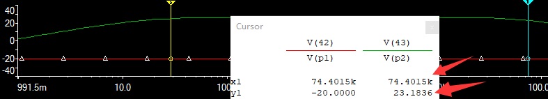

Kung Posted April 12, 2018 Report Posted April 12, 2018 it's good to see more es amp designs. The thd+n is really low about 0.005% fr(-3db)only reach about 11.6Khz and -6db at 19.9Khz from multisim ac analysis when gain is set at 46db,higher the gain the lower fr will be,not sure the circuit works properly ,btw it's easy to run kgsshv fr(-3db)over 110khz or even higher,and 2nd harmonic distortion of -79db and 3rd harmonic distortion of -61db at 1Khz Quote
kevin gilmore Posted April 12, 2018 Report Posted April 12, 2018 (edited) so all sorts of problems actually building this. 1) input transformer needs a center tap probably tied to about -420v 2) voltage swing on the ecc88 is such that you are going to loose 40v or more on negative swing 3) 6sn7 filaments would have to float and then you are still limited by the cathode to filament voltages to about 400V 4) 33R output resistor absolutely a bad idea 5) available 900V mosfets are high gate capacitance limiting frequency response 6) resistor plate loads for 6sn7 a bad idea 7) 900V npn output transistors no longer exist have to use obsolete parts, or currently best transistor is 800v no servo to control output stage dc Edited April 12, 2018 by kevin gilmore Quote
woodear Posted April 13, 2018 Author Report Posted April 13, 2018 On 2018年4月13日 at 12:55 AM, kevin gilmore said: so all sorts of problems actually building this. 1) input transformer needs a center tap probably tied to about -420v 2) voltage swing on the ecc88 is such that you are going to loose 40v or more on negative swing 3) 6sn7 filaments would have to float and then you are still limited by the cathode to filament voltages to about 400V 4) 33R output resistor absolutely a bad idea 5) available 900V mosfets are high gate capacitance limiting frequency response 6) resistor plate loads for 6sn7 a bad idea 7) 900V npn output transistors no longer exist have to use obsolete parts, or currently best transistor is 800v no servo to control output stage dc THX for pointing out these problems, Dr. KG, and below are my solutions: 1, you can find suitable input transformers by Lundahl or similar, for example LL1690. 2, that's correct, but 350V anode voltage on 6sn7 is OK to drive staxs, isn't it? 3, the maximum voltage between cathode and filament of ECC88 is +60, -120V, and for 6sn7, that is +100, -200V. So I actually used one transformer winding to supply the two filaments. 4, most STAX amps have 5k1 output resistors, but these resistor will degrade performance by adding internal resistance to the amp. When driving ES headphones, the headphones act as a variable capacitor load, or you can even say it is a condenser microphone, which can pick up signals as the diaphram's vibrating. A low internal-resistance amp can better control the diaphram by rapidly charging and discharging it. So a low internal-resistance(or output impedance) is better than a higher one, like you always prefer dynamic headphone amps or speaker power amps with very low output impedance. Another thing concerning the 33R output resistor is safety. In fact, I used a 1206 or 2010 SMD resistor here, when one headphone stator is shorted to ground or to the other, the resistor can function as a fuse, similar to the 5k1 resistor in STAX designs. I may also replace the 33R here with a 30mA or 20mA or 10mA fuse, but I havn't tried that yet. 5, of course I'm not using a 900V 36A jumbo power MOSFET. I tried many 900~1500V enhancement or depletion mode MOSFETs, including IXTY02N120P, NDFPD1N150C, IXTP01N100D, and stax mafia's favorate: IXCY10M90S. These MOSFETs have relatively small input capacitance, around 100pf.(when using depletion mode ones, the bias LEDs are not needed any more) 6, I use to use a cascode CCS, but then switched to resistor load because in my schematic, the three resistor actually make approximately a 140K resistor, which is close to a non-cascode CCS's internal resistance, and pure resistor load will simplify the entire design. 7, 8, the tail CCS on the ECC88 differential pair is adjustable, so you can get a nice output DC voltage by adjusting the current source, and the variable resistor connected to the cathodes of ECC88. Quote

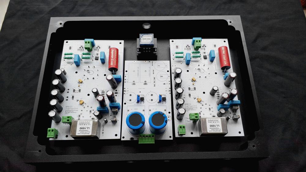

woodear Posted April 13, 2018 Author Report Posted April 13, 2018 23 minutes ago, Laowei said: Have you built it? How’s it sound? I've built 6 versions, and this is the latest one(PSU board not finished in this photo, and there is only one pair of 500V 180uf filter cap in side the main chassis, but the amp does have another pair of 180uf cap, and rectifiers and a 250W transformer in a separate PSU chassis, so altogether,360uf x2 for the HV power supply, which is perfectly enough capacitance). It sounds quite fast and transparent due to a single voltage gain stage design, when compared to other tube ES amps. And due to the low output impedance, the sound is relatively powerful sounding and the bass is tight, although it's not as powerful sounding as BHSE or KG GG. finally, it's a tube amp without global NFB, so you can hear the euphony of a non-NFB tube amp. Quote
JimL Posted April 13, 2018 Report Posted April 13, 2018 (edited) Hmm. I think you need to do a bit more math and some simple measurements. 1) The advantage of a cascode circuit is it has a high gain. The disadvantage is it has a high output impedance - roughly, the plate resistance. With a plate resistance of 140 kilohms into a MOSFET buffer with 100 pf input capacitance, that produces a -3 dB roll-off point of approximately 11-12 kHz, as Kung points out. Since there is no feedback to extend the frequency response, the amplifier will roll-off above that point at 6 dB/octave. You should be able to easily measure this using a sine wave generator, a good DMM, and a 100 pf cap as a dummy load. 2) Your notion that a 5.1k output resistor degrades the performance of the amp in controlling the diaphragm is questionable. Most electrostatic headphones approximate a 100 pf capacitor. The impedance of the headphone is therefore approximately 80 kilohms at 20 kHz. The traditional way of calculating the ability of an amp to control the transducer is the damping factor, which it the ratio of the impedance of the transducer divided by the output impedance of the amplifier. In this case, 80 kilohms divided by 5 kilohms is 16, which is perfectly adequate. Another way to look at it is to ask what the roll-off frequency of a 100 pf headphone is when driven by a amp with 5 kilohms output impedance - the answer is over 300 kHz, which is definitely sufficient. Edited April 13, 2018 by JimL Quote
woodear Posted April 13, 2018 Author Report Posted April 13, 2018 20 hours ago, JimL said: Hmm. I think you need to do a bit more math and some simple measurements. 1) The advantage of a cascode circuit is it has a high gain. The disadvantage is it has a high output impedance - roughly, the plate resistance. With a plate resistance of 140 kilohms into a MOSFET buffer with 100 pf input capacitance, that produces a -3 dB roll-off point of approximately 11-12 kHz, as Kung points out. Since there is no feedback to extend the frequency response, the amplifier will roll-off above that point at 6 dB/octave. You should be able to easily measure this using a sine wave generator, a good DMM, and a 100 pf cap as a dummy load. 2) Your notion that a 5.1k output resistor degrades the performance of the amp in controlling the diaphragm is questionable. Most electrostatic headphones approximate a 100 pf capacitor. The impedance of the headphone is therefore approximately 80 kilohms at 20 kHz. The traditional way of calculating the ability of an amp to control the transducer is the damping factor, which it the ratio of the impedance of the transducer divided by the output impedance of the amplifier. In this case, 80 kilohms divided by 5 kilohms is 16, which is perfectly adequate. Another way to look at it is to ask what the roll-off frequency of a 100 pf headphone is when driven by a amp with 5 kilohms output impedance - the answer is over 300 kHz, which is definitely sufficient. Hi JimL, 1, the input capacitance of MOSFET follower is not simply the input C shown in data sheet, when functioning as a follower, the AC voltage difference between MOSFET's gate and source is quite small(Vgs of the follower is roughly a constant DC voltage, the AC component is tiny), so the equivalent Cgs will not be as large as when S is grounded. the drain of the MOSFET follower is connected to power supply, so the capacitance between gate and the drain is only 1 x Cdg, therefore the Cin=Cgd+Cgs(1-gain of the follower), the gain is very cloase to 1, as a result, the Cin is quite close to Cgd. Kung might have used some high current, high voltage MOSs which have much higher input capacitance than just 100pf. However, things will get much more complicated when the output follower is cascoded like Beta22, it is just not easy to estimate the input C in this application. I'll try to simulate the schematic by myself this weekend, hopefully, with the help of my friends(pathetically, I'm quite slow when learning a new software) 2, I tried different output resistor values, from the classical 5k1 to 33R, then I found a low output impedance will lead to a more powerful sound, since non-NFB tube designs are often less powerful than BHSEs or Carbons, and bass is often less well controlled, so personally I do prefer the amp with very high damping factor. In fact, a number of power/headphone amps claim they have damping factor of x00 to x000... On 2018年4月12日 at 6:59 PM, Kung said: it's good to see more es amp designs. The thd+n is really low about 0.005% fr(-3db)only reach about 11.6Khz and -6db at 19.9Khz from multisim ac analysis when gain is set at 46db,higher the gain the lower fr will be,not sure the circuit works properly ,btw it's easy to run kgsshv fr(-3db)over 110khz or even higher,and 2nd harmonic distortion of -79db and 3rd harmonic distortion of -61db at 1Khz what output MOSFET are you using? Quote
Kung Posted April 13, 2018 Report Posted April 13, 2018 (edited) I try 02N120P as output fets,this time fr(-3db) can run up to 74Khz,and (-6db) about 114Khz. circuit works much better now. Edited April 13, 2018 by Kung Quote
woodear Posted April 13, 2018 Author Report Posted April 13, 2018 16 hours ago, Kung said: I try 02N120P as output fets,this time fr(-3db) can run up to 74Khz,and (-6db) about 114Khz. circuit works much better now. a 74kHz -3dB bandwidth is far more reasonable, the Cin of MOSFET buffer is certainly lower than 100pf. Quote
kevin gilmore Posted April 13, 2018 Report Posted April 13, 2018 the 5.1k resistors are to protect the headphones. Quote

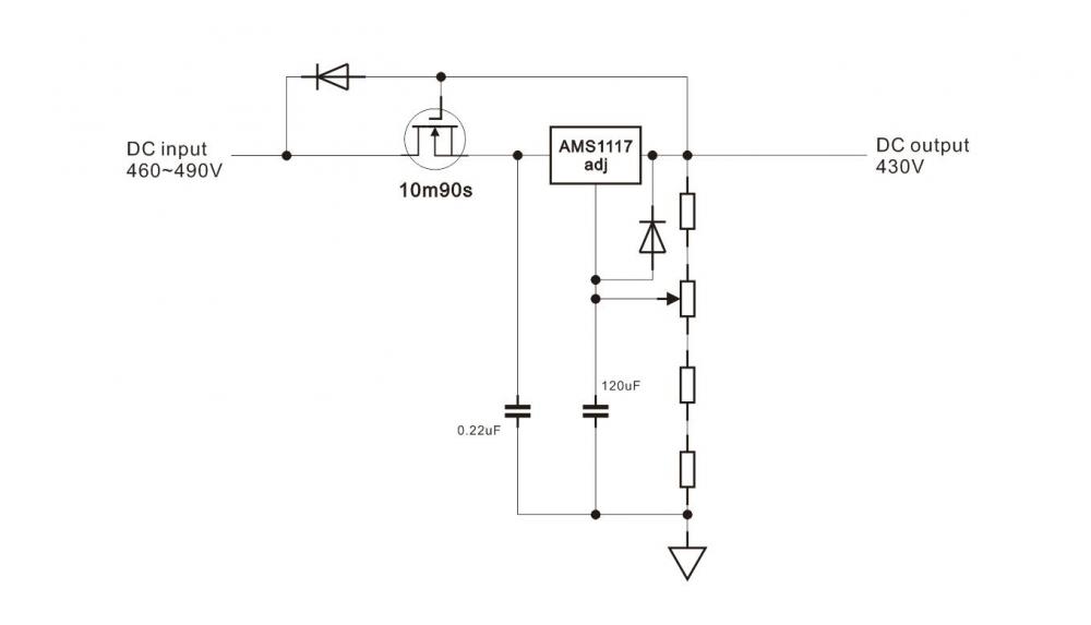

woodear Posted April 14, 2018 Author Report Posted April 14, 2018 The high voltage power supply is regulated, using a HV reg derived from John Broskie's idea of using high voltage depletion mode MOSFET, together with a 3-terminal voltage regulator IC, to form a simple but high-performance HV regulator. I did some modification on John Broskie's original design I use AMS1117adj instead of LT1085. AMS117adj has lower drop-out voltage than LT1085, and the 3A output current of LT1085 is basically unnecessary.(and AMS1117adj is cheaper) The large 120uf capacitor connected to the ADJ pin of AMS1117 lowers output noise, and also act as a free soft-start circuit, this cap will be slowly charged for about 2 or 3 minutes, until the output voltage finally reaches 430V. Quote

woodear Posted April 18, 2018 Author Report Posted April 18, 2018 This is a detailed(relatively) schematic of the latest version. The transformer should be a 1:1 input transformer with proper insulation(1000V or more), and a Faraday shield which is connected to ground plane. the plate load resistors are 2 or 3 watt 62k resistors. The power supply ripple rejection(PSRR) of resistor load is low compared to a constant current source load, so I added an active de-coupling circuit using only one enhancement MOSFET, and a few resistors and a capacitor, which significantly reduce power supply noise seen by the 4 62k resistors. -360V and -420V voltage reference is simply generated by a series of resistors forming a voltage devider, which is not shown here. the 100R variable resistor connected to the cathodes of ECC88 is bypassed using a 1000uf bipolar capacitor paralleled by a 22uf smaller bipoalar capacitor, in order to achieve a higher gain and 'higher distortion' or you can say a more 'tuby sound' , you can cancel these bipolar caps if you prefer lower distortion and a clearer sound . the tail CCS of ECC88 is a CCS using DN3135, not DN2540 which is a common STAX mafia choice. The capacitance of DN3135 is lower than DN2540. Some of you might have noticed that, in this amplifier, the dual-unit RK27 potentiometer doesn't seem to be andequate to control the volume of balanced audio signal. In fact, the volume control circuit here in this amp is different from how we normally use potentiometers---- it's a parallel connection instead of serial connection, the audio signal flows through the 6k8 resistors, and then, directly flows into the grids of ECC88, potentiometer is connected in parallel with ECC88's grids. This volume control circuit will deliver more transparent sound as audio signal does not flow thru the dirty and noisy carbon-film RK27 potentiometer first, then into the amp. Another thing concerning safety operation is that, since the center tap of the transformer is connected to approximately -420V, the variable resistors inside an RK27 are biased to -420V too, we DO NEED TO consider if the potentiometer can withstand such high voltage between the internal components and its housing. Luckily, Alps RK27 and RK16 have an electric insulation of >500Vrms as shown on data sheets, so -420V is safe enough. The input signal impedance of a signal transformer is usually suggested to be as low as possible. I used to connect a potentiometer before signal goes into input transformer, trying to avoid high voltage insulation issues, but as a result, the bass is massively degraded due to increased distortion when the transformer is fed by a high-impedance signal. And here are pictures showing my PCB design. The components on this PCB are mostly SMT parts, except large capacitors, and tubes. Please note that the output MOSFETs and their CCS loads are TO-252 IXTY01N100D, the heat becomes an issue in this situation. I experimented 8mA current, and the heat was OK, as the MOSFETs are heavily pressed onto the bottom of an aluminum chassis through a 0.5mm or 1mm silicon rubber pad. For a better reliability, I limit the current to around 5mA(a bit more than 2 watt heat per MOSFET), which is enough current to drive(although not perfectly drive) a STAX headphone. If you want MORE current, you can try to-220 package. top layer(cyan) bottom layer(grey) 1 Quote
