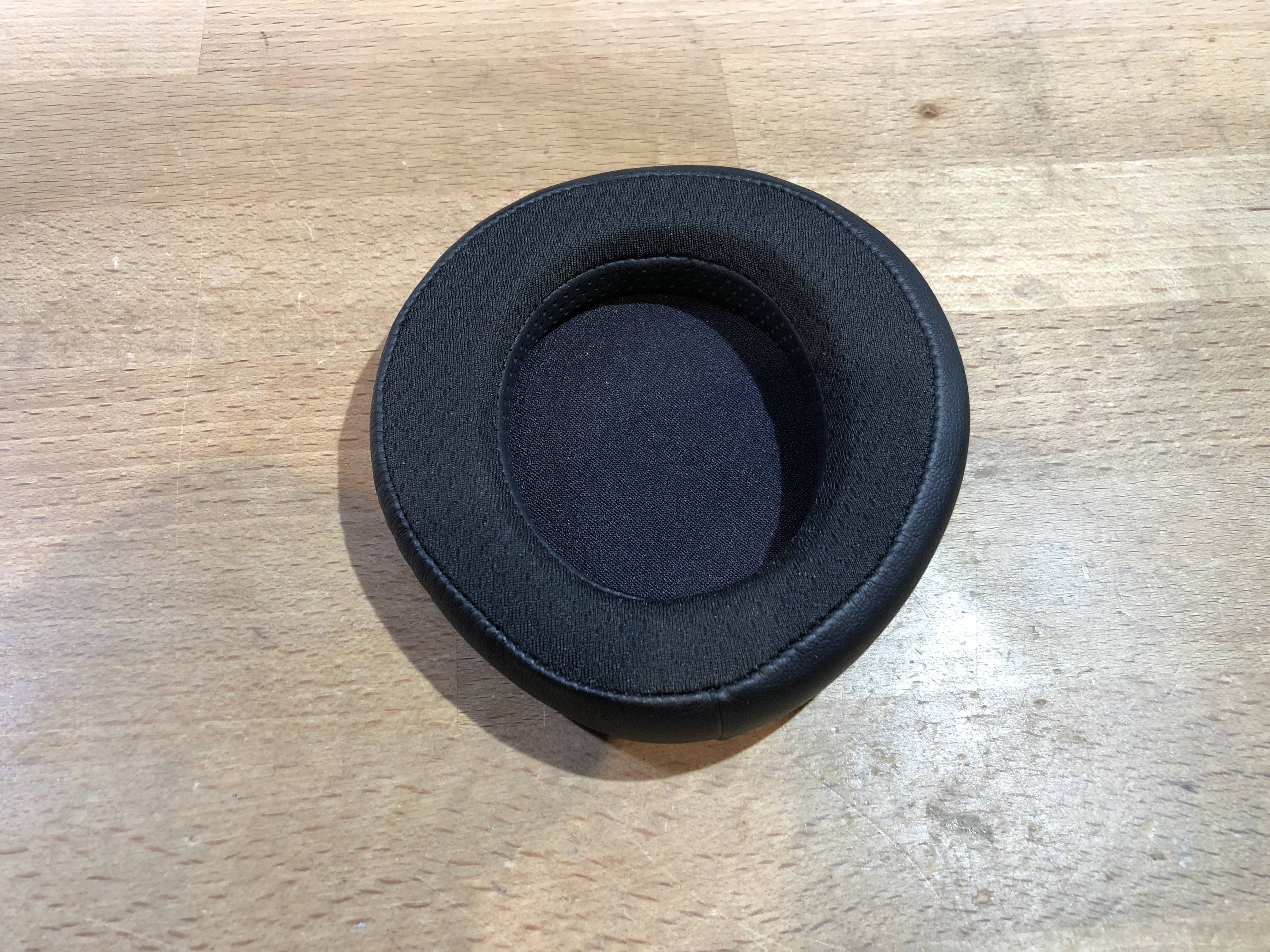

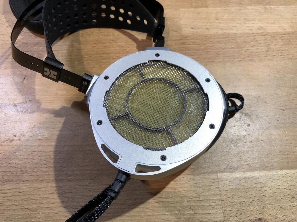

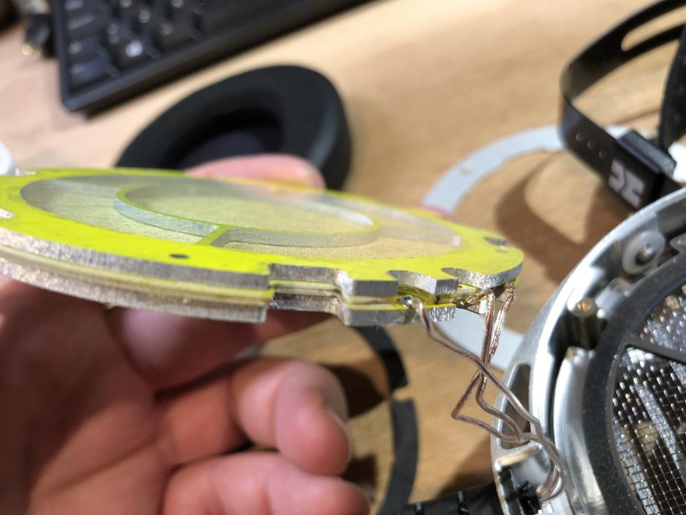

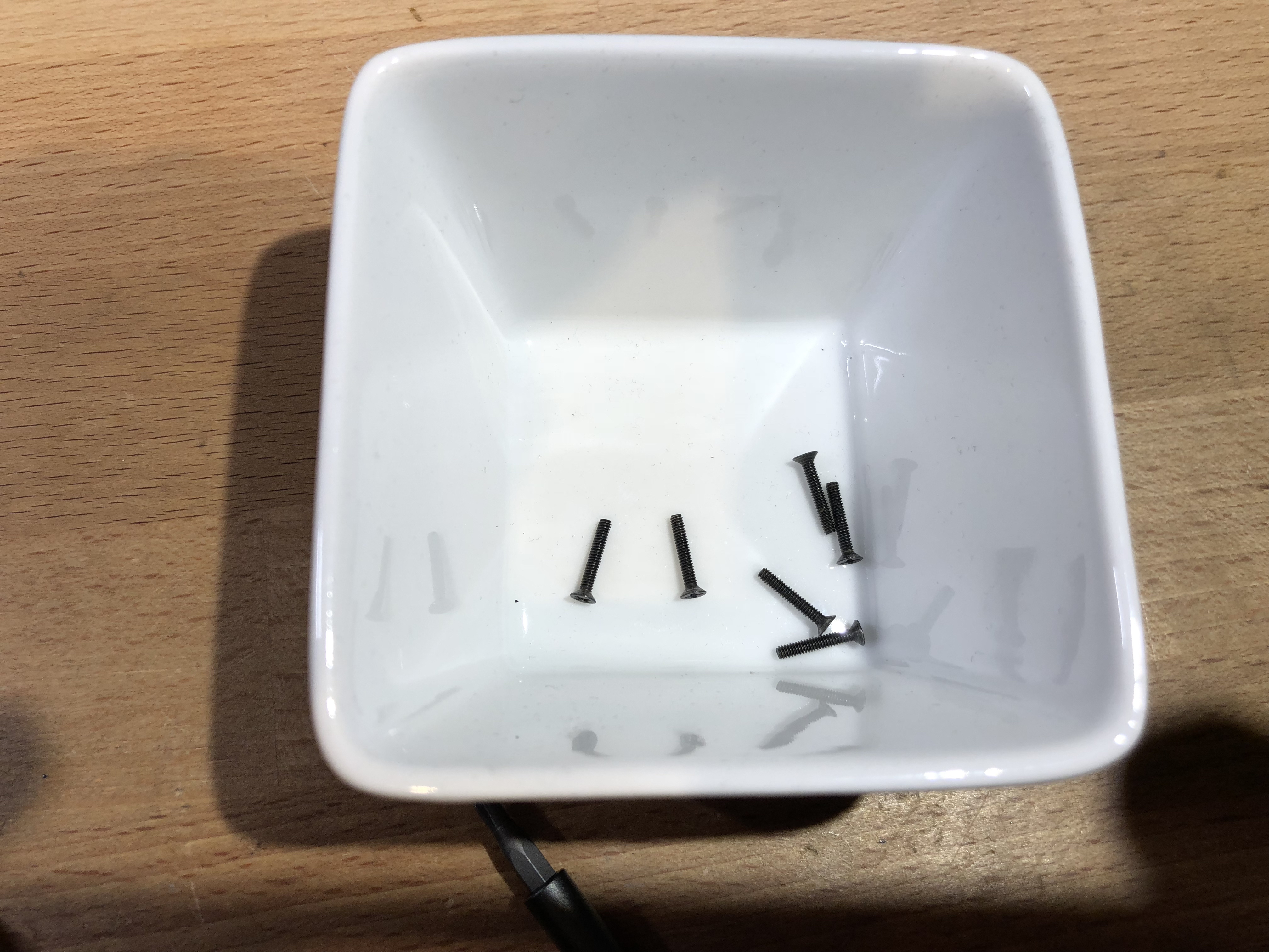

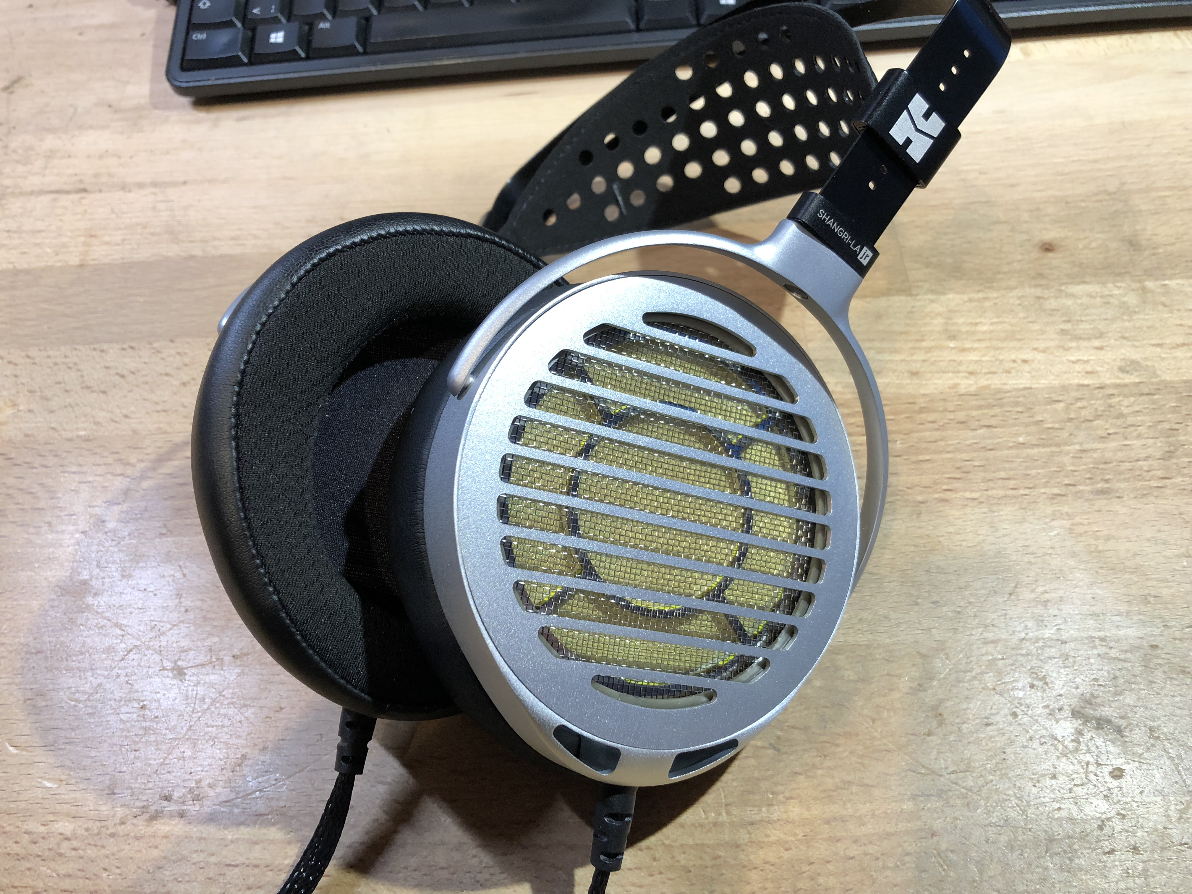

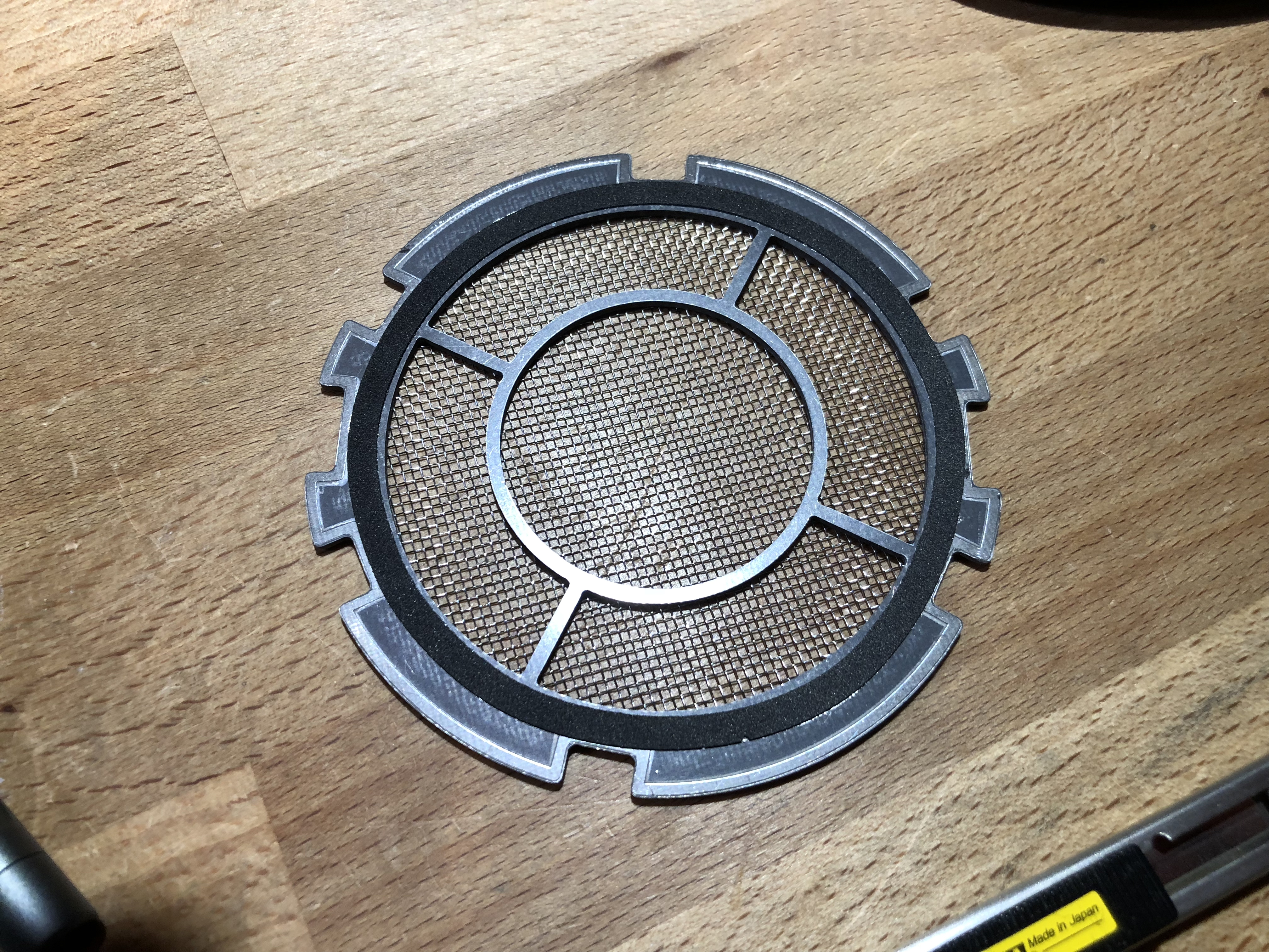

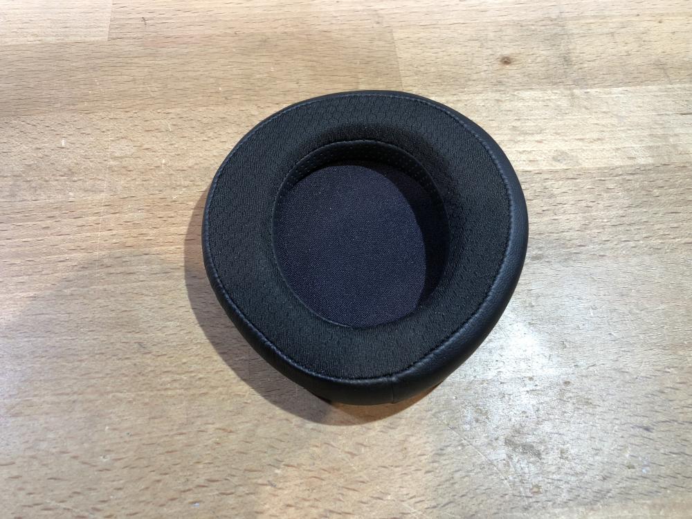

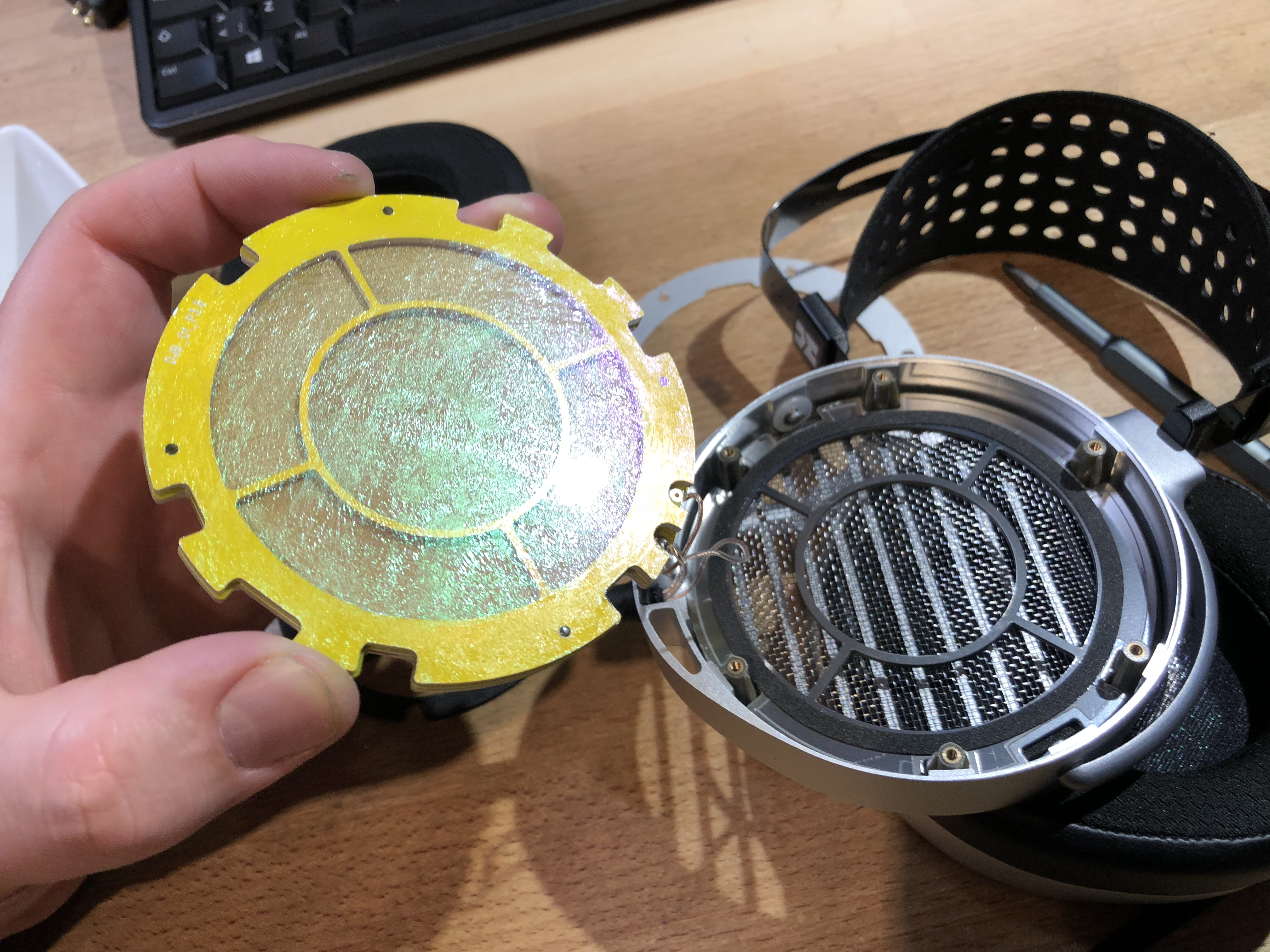

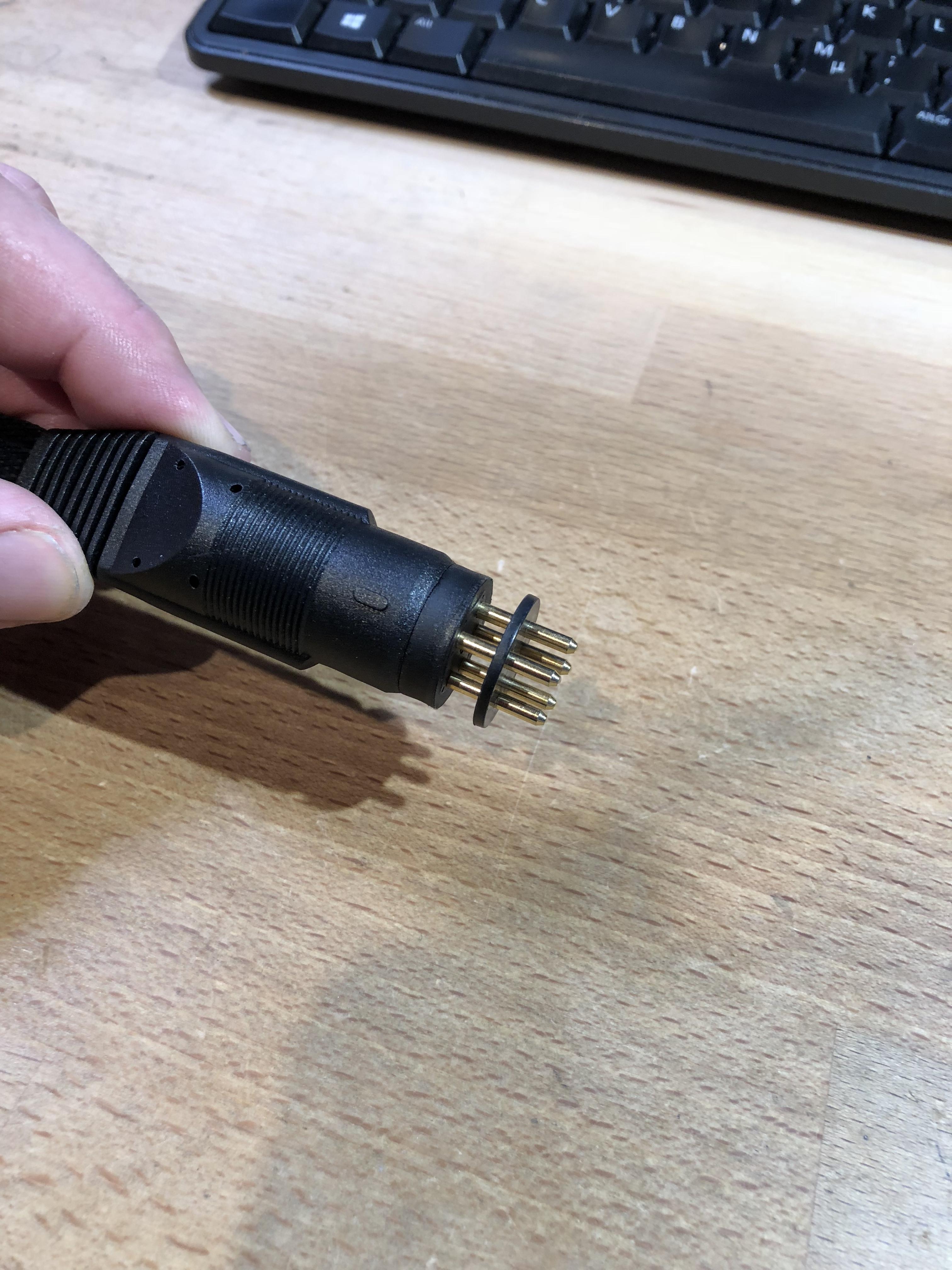

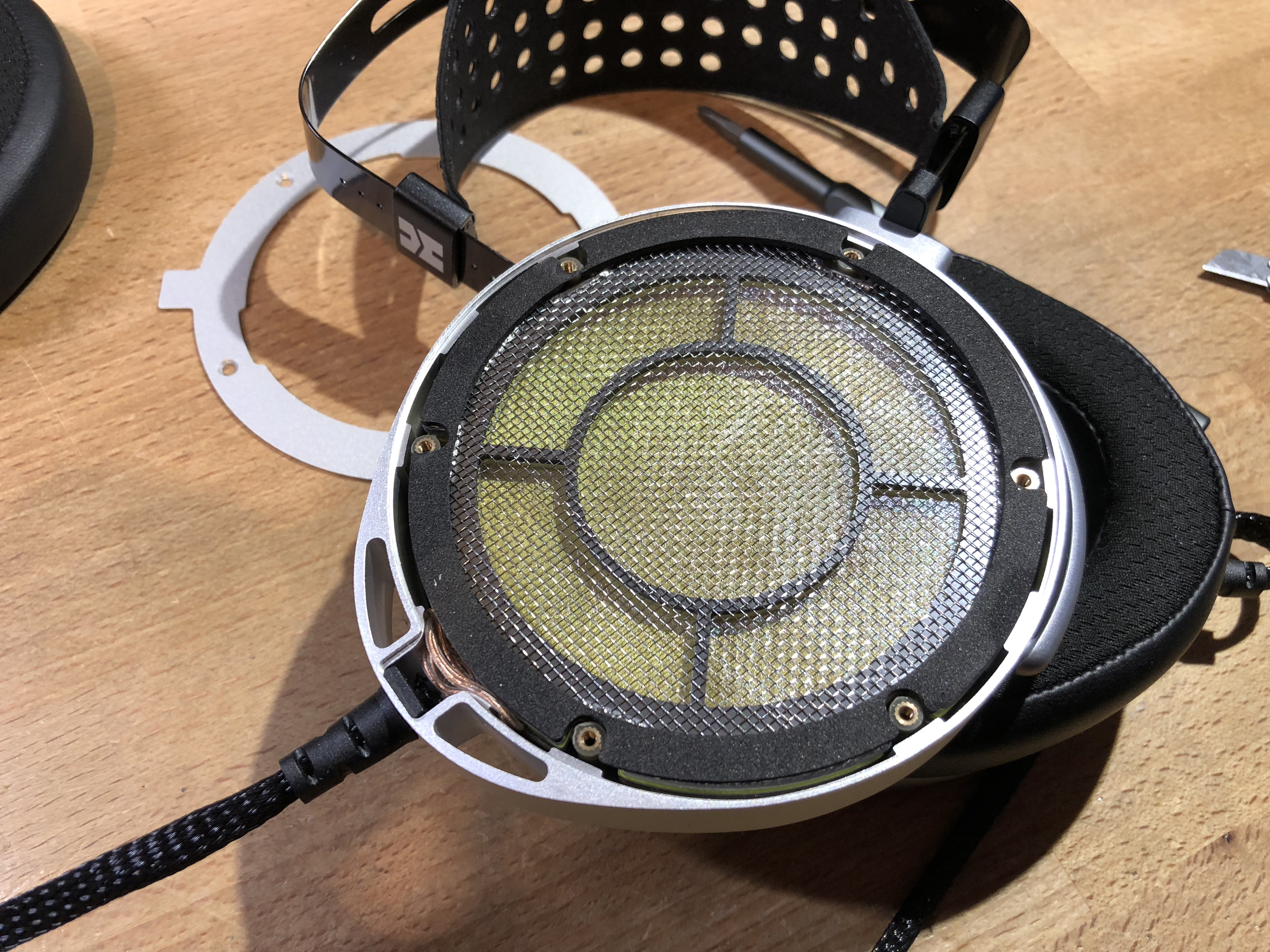

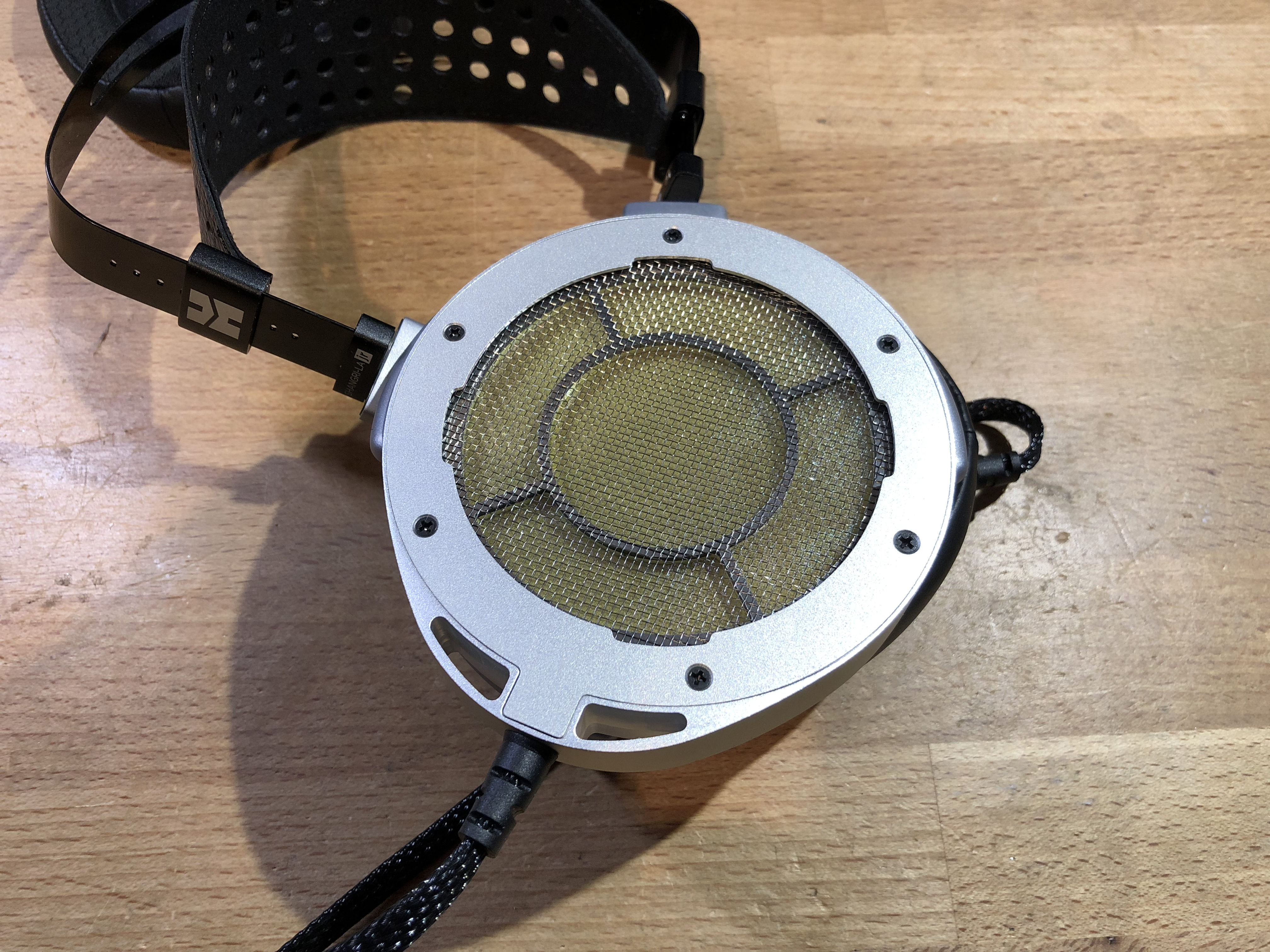

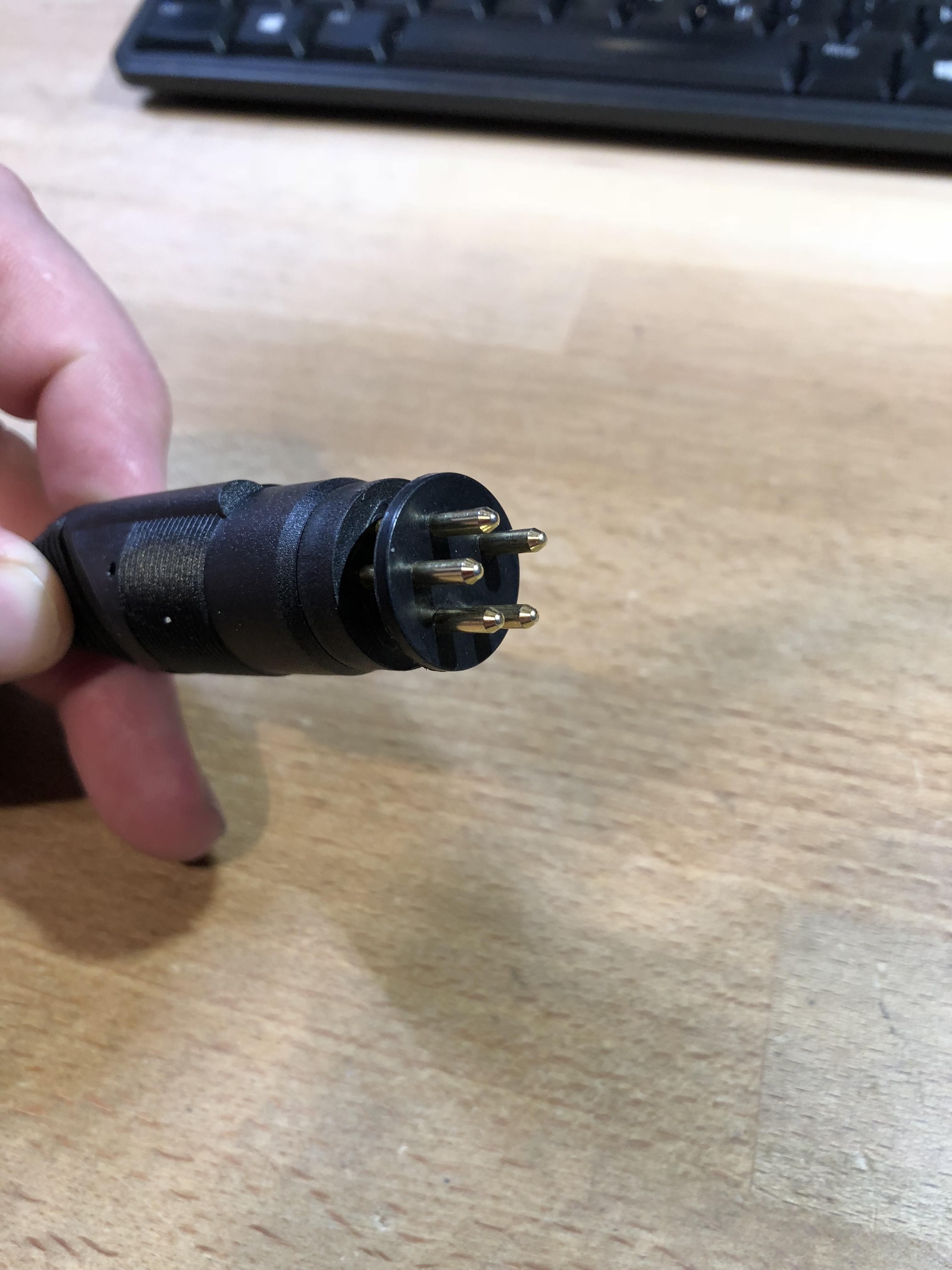

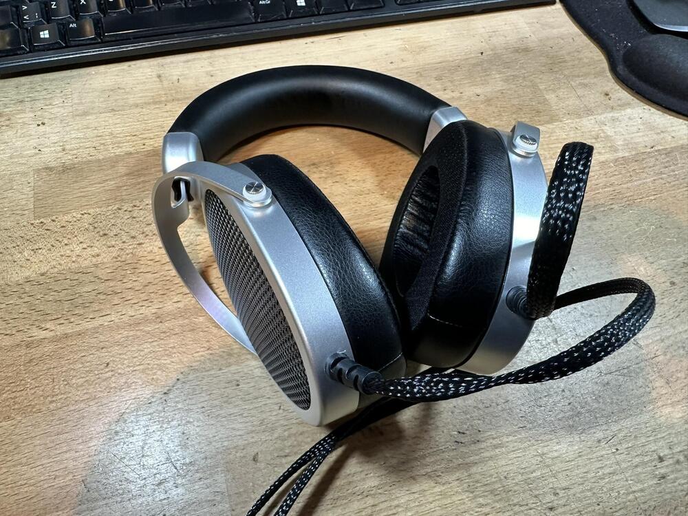

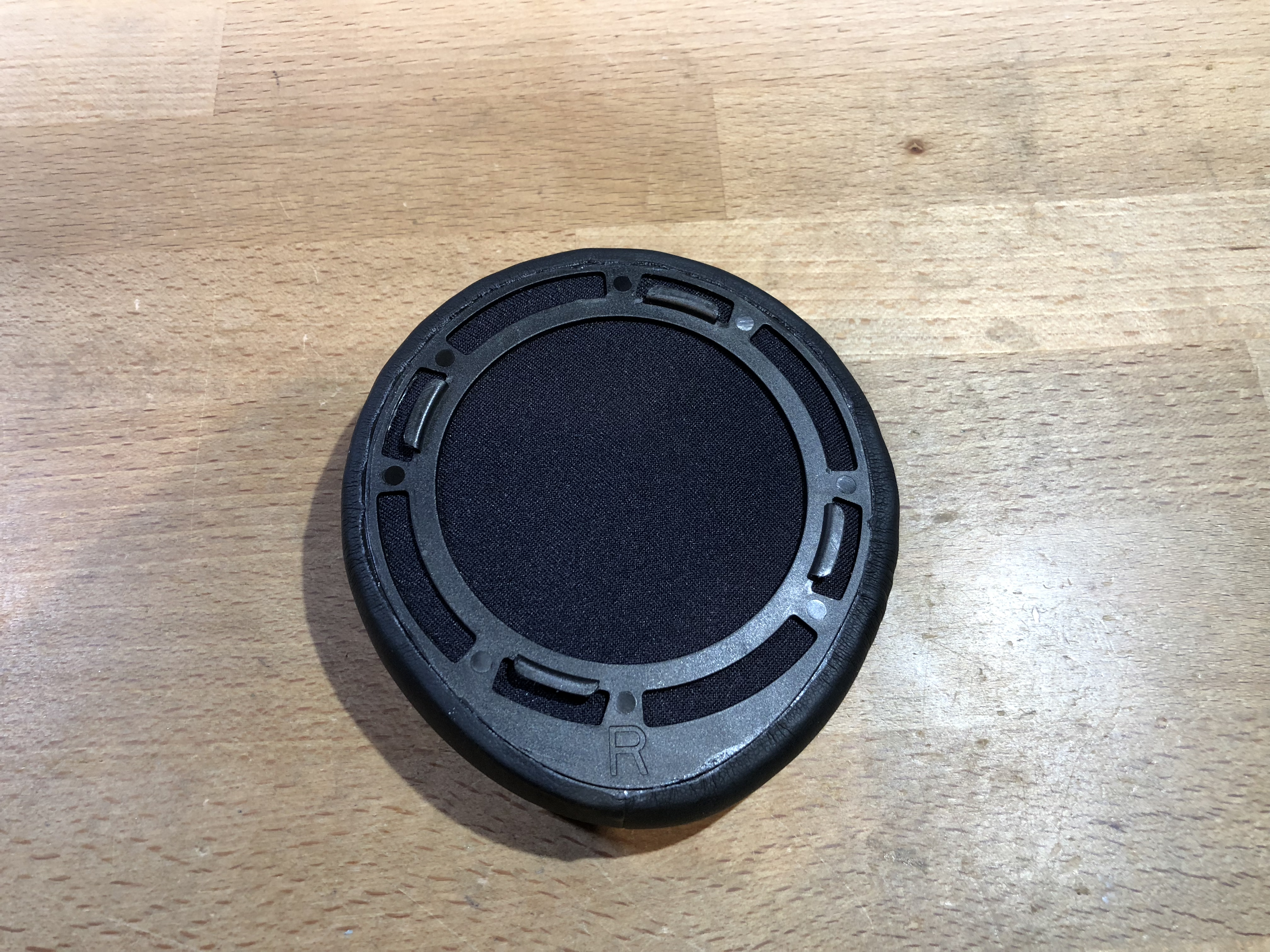

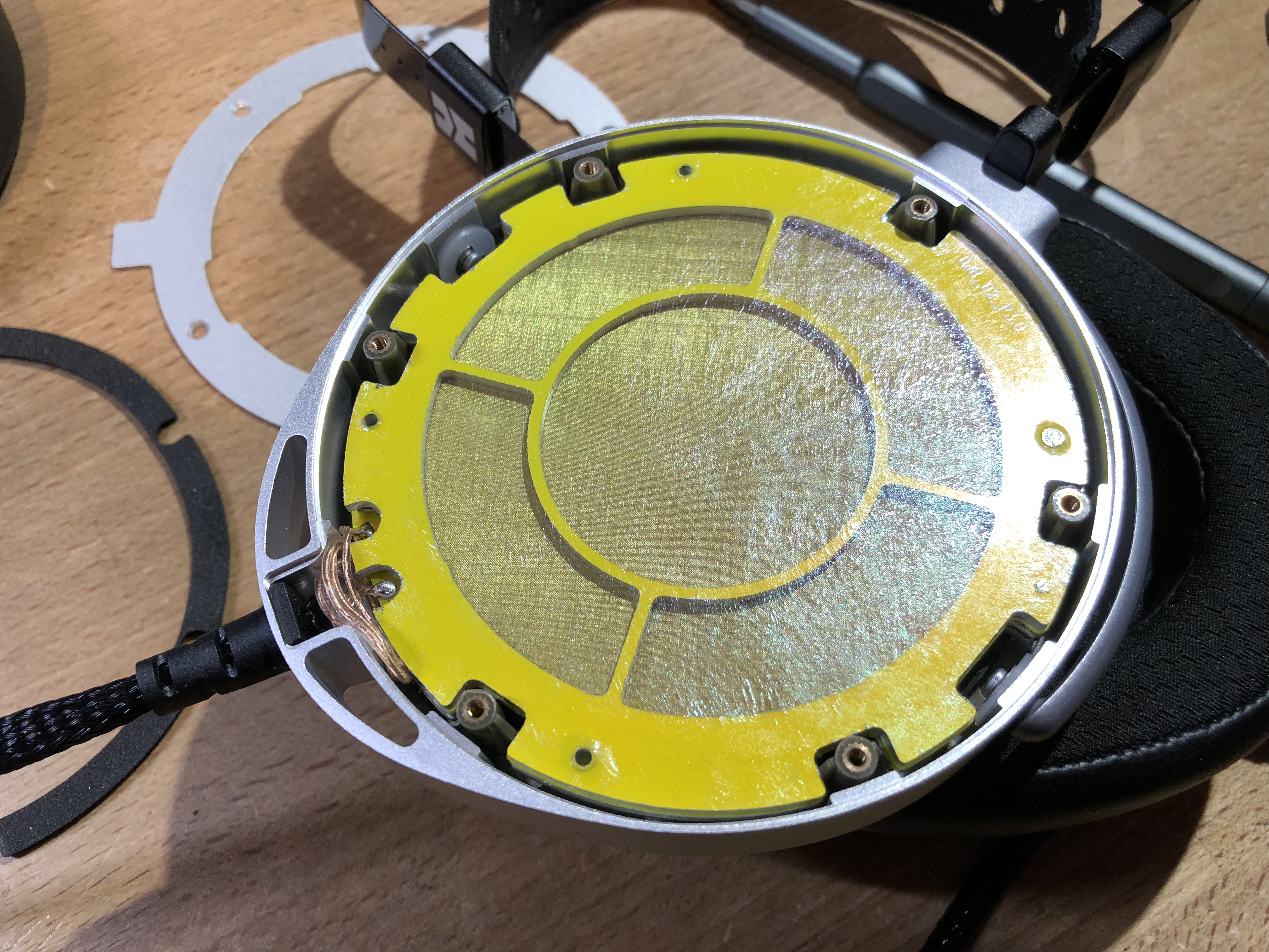

spritzer Posted April 27, 2018 Report Share Posted April 27, 2018 Well... I dug out the screwdrivers... Sorry for the crappy pictures, I just had the iphone to hand. First off, the true quality Stax plug: So that disk there normally sits flush with the plug as the pins are too long. They had that problem with the Jade so nothing has changed in a decade... Pure class. It is also incredibly crude. Funny how King Sound could make a ribbon cable and a proper plug at 1/8th the price... Speaking off the cable, you can barely make out the loose wires in there when I press it together. Here's the earpads...well one of them. They are pretty comfy but they do stink quite badly. No expense spared here... I did order some new pads to try out. Here is the baffle and the cable entry. The latter seems to not be molded around the cable so I might be able to remove this cable and put in a proper ribbon. Very long screws... They go all the way to the back of the housing which is plastic and has nice metal inserts. Now the baffle is off and it has this nice rubber gasket to maintain baffle seal. Now we can see the cable and the metal frame which provides the bulk of the assembly. Here is the back of the protective mesh. These are not the stators so why Hifiman uses this in the promo's as the stators is beyond me... Another gasket here which is good. Here we have the driver. There is a protective mesh but it is odd. It's not a solid sheet but some sort of a porous membrane. Copper mesh stators and the pitch is very fine. Finally the back of the drivers and the second protective mesh. You can also see the plastic frame which holds it all together. The drivers are glued together so I didn't want to mess with them more at this time. One funny thing, the cables inside the cups are really long. Like 10cm even though they would need only about 2cm or so... Over all, I'm impressed by the build quality. It's not Stax quality but they are getting better. I eagerly wait for the Mk2 version next month... 11 4 Quote Link to comment Share on other sites More sharing options...

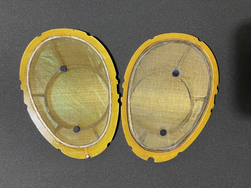

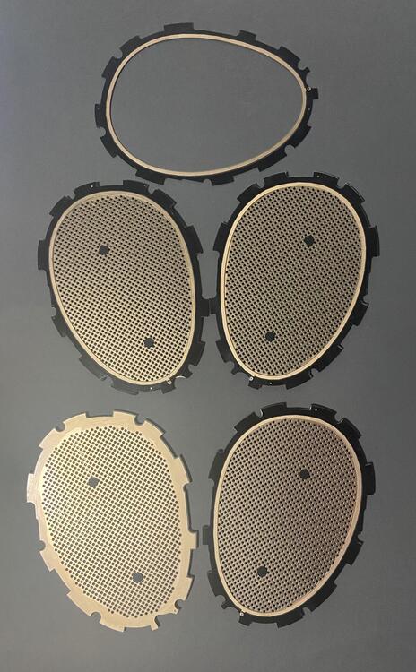

Whitigir Posted April 27, 2018 Report Share Posted April 27, 2018 Wow, the stator is something else. I can barely see the meshes. Can’t wait to see and learn more. Thanks Quote Link to comment Share on other sites More sharing options...

chinsettawong Posted April 27, 2018 Report Share Posted April 27, 2018 (edited) The construction looks pretty solid. But I don't like it that they glue the driver together. Edited April 27, 2018 by chinsettawong 1 Quote Link to comment Share on other sites More sharing options...
nopants Posted April 27, 2018 Report Share Posted April 27, 2018 the driver itself looks nice but the overall construction doesn't seem to warrant the asking price, unless I'm missing something I imagine the extra wire shoved into the cup is strain-relief insurance Quote Link to comment Share on other sites More sharing options...
spritzer Posted April 27, 2018 Report Share Posted April 27, 2018 The construction is ok but nothing more than that. As a contrast, the SR-007 drivers are in a resin case which is then screwed directly into the aluminum shell. This here reminds me more of the SR-Omega construction where the aluminum chassis is more for show. The extra cable inside the cups has to be there to protect the drivers should the cable be pulled out of the entry...but it's still a silly solution. I'm prepping the new cable for them so I'll do the swap soon. Quote Link to comment Share on other sites More sharing options...
arnaud Posted April 28, 2018 Report Share Posted April 28, 2018 Interesting tear down, thank you Birgir! The driver is effectively sandwiched between the housing the baffle plate through these rubber gaskets, quite different from Stax hard fixation style. Also, the wire mesh of the stator seems very very fine, that's interesting because I bet the airflow resistivity is actually orders of magnitude higher than than traditional perforated stators (that present little airflow resistance contrary to the common belief these days...). That fine wire mesh, ignoring the mechanical aspect for now, must certainly add significant damping to the diaphragm. As for the price drop, it's hard to imagine the SR009S release had no influence on that ;-) arnaud Quote Link to comment Share on other sites More sharing options...

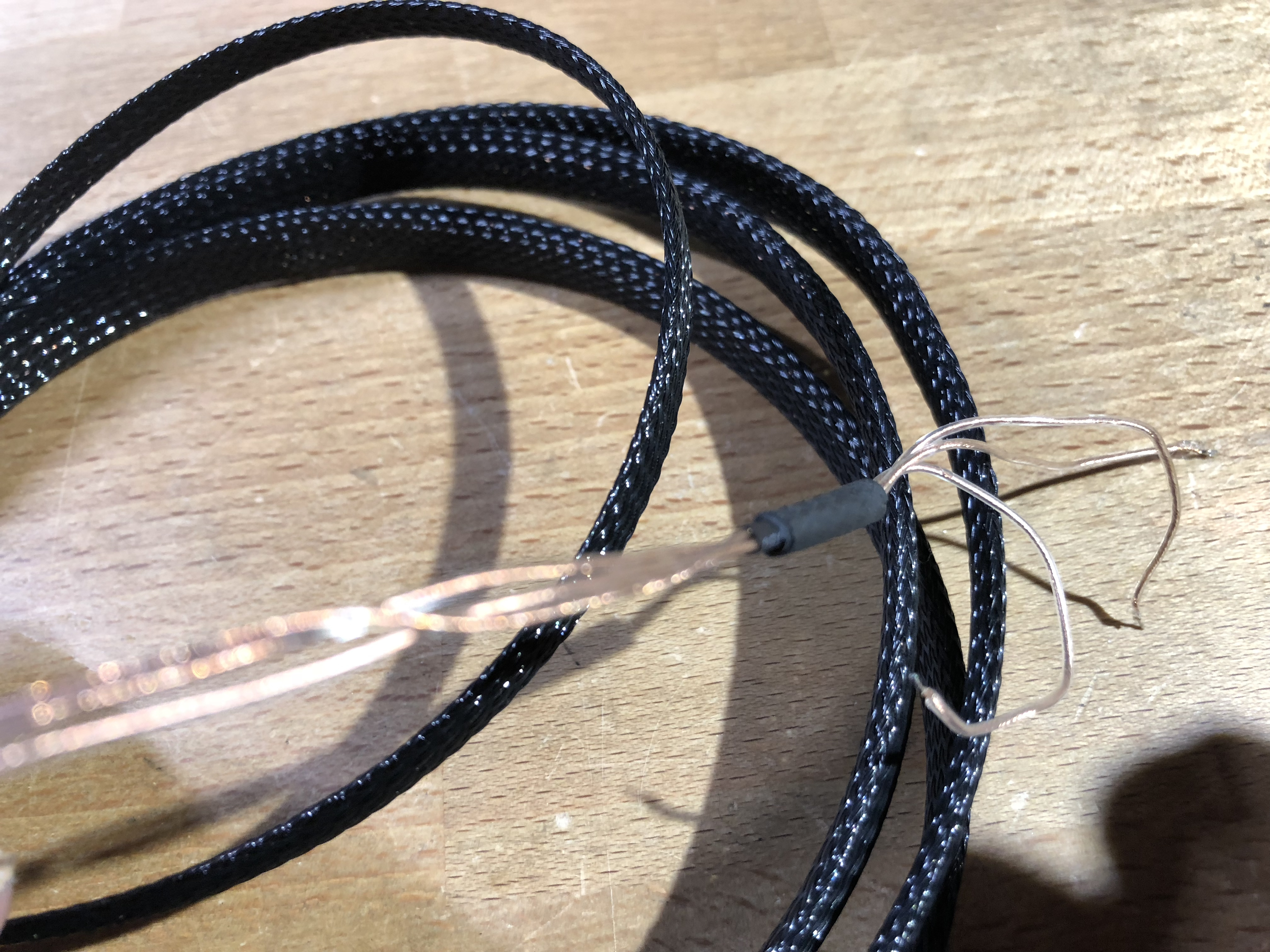

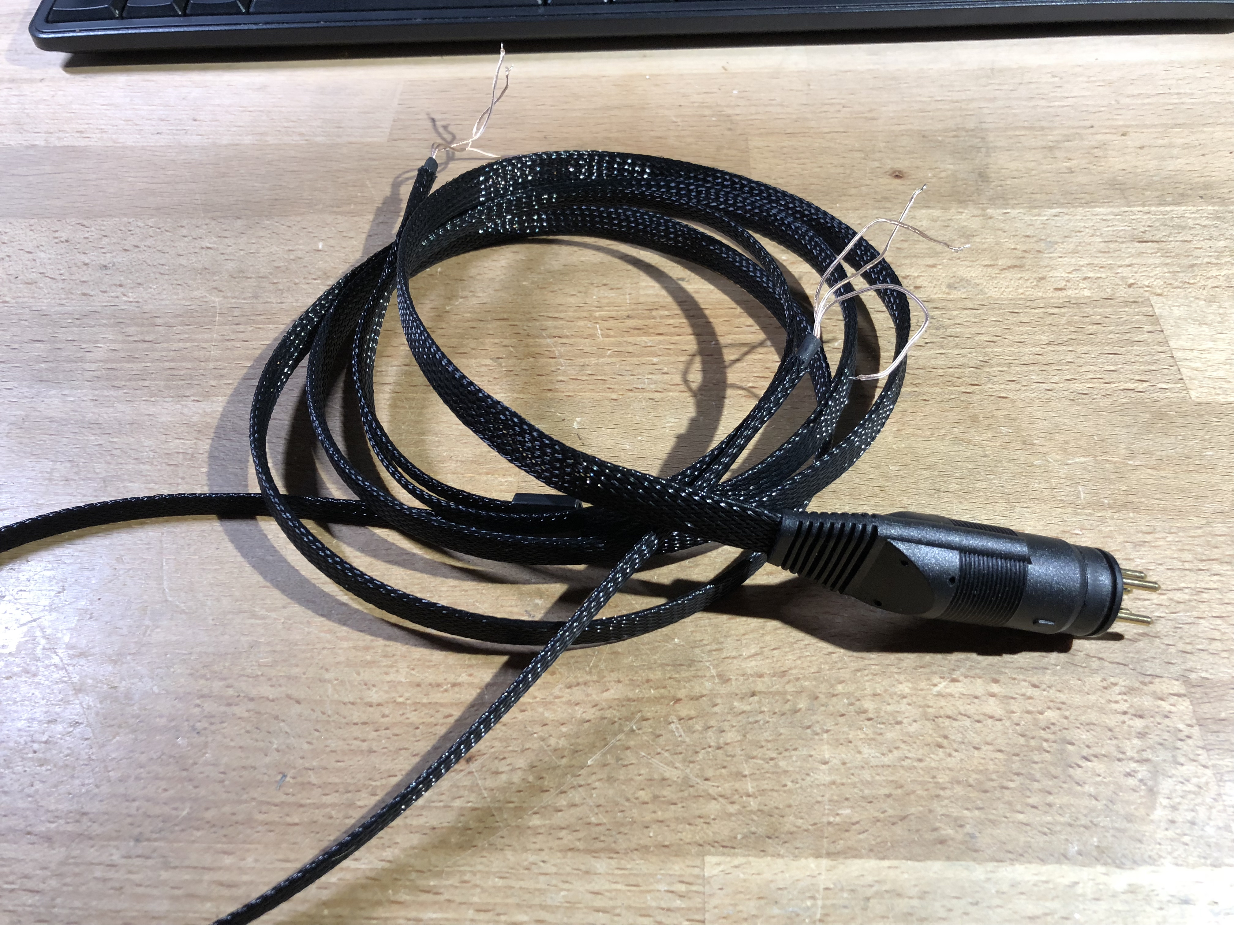

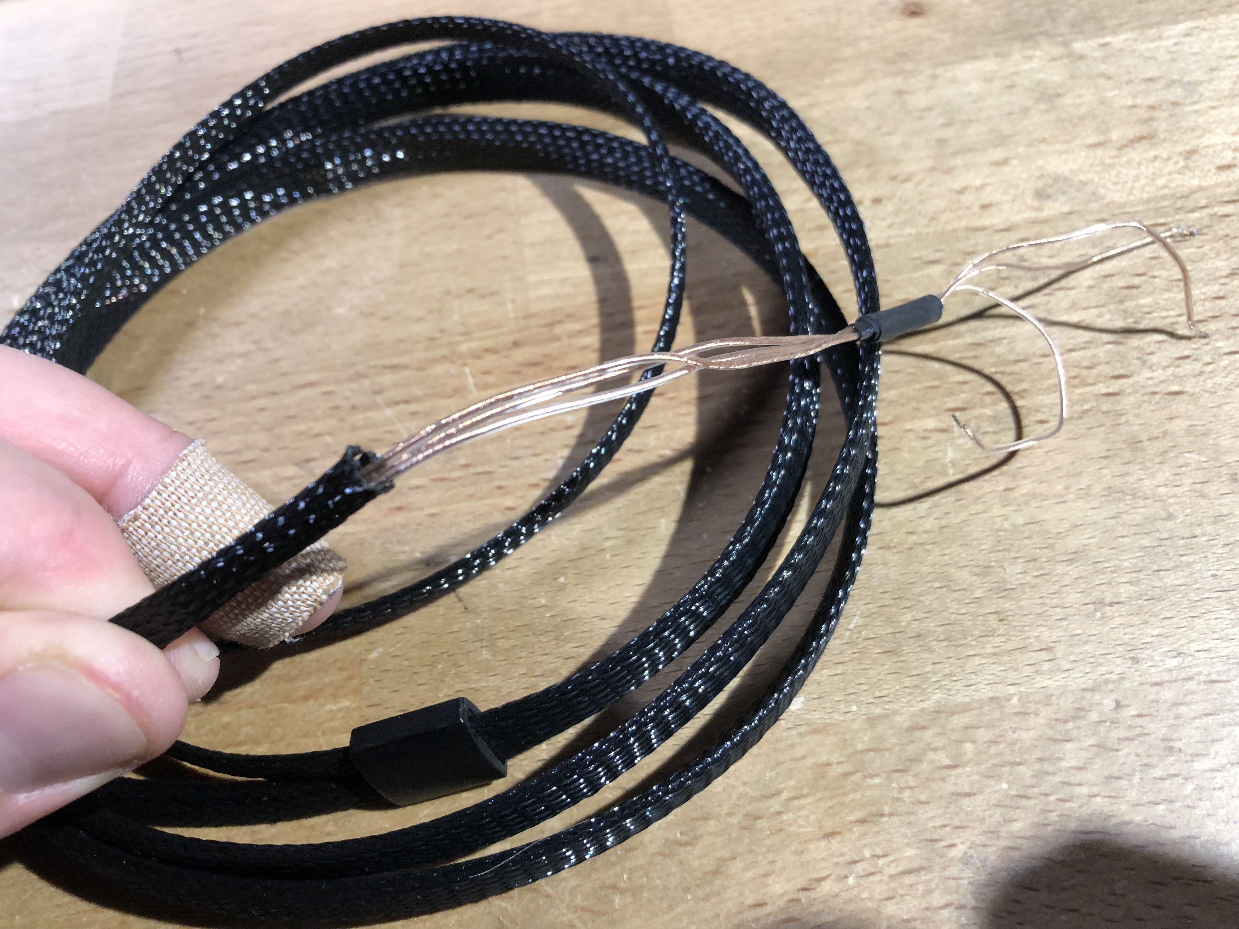

spritzer Posted April 30, 2018 Report Share Posted April 30, 2018 Good point about the mesh and that it might be even more restrictive. I for one have never felt there to be any real benefit to the mesh in practice but it's hard to know for sure without direct A-B comparisons of identical units except for the stators. In other news, the shitty cable is gone now in favor of a Stax SRE-950S extension cable. I did cut about 1M off it but now it actually reaches my amps... Here is what you get with your 4K$ headphones... It does weigh almost nothing but then again...there is nothing there. With a bit of force I managed to just pull the cables out of the cable entry so no molding going on there. Pull back the techflex and it is just loose wires with the heatshrink at the end used to hold it all together and to secure the cable in the cable entry. Three layers there that I count. Nothing else holding the cable in place unless I missed some glue but I don't think so. The insulation on the wires is also pretty thin and it feels like cheap PVC, it certainly melts easily. The outside diameter of the wires is 0.9mm and the wire itself is 0.3mm so the same on each side to insulate it. Me thinks this is not rated for 1000V+ use but I'd have to break out the HV test jig and zap it multiple times to see how it holds up. One other note, the drivers are wired up as inverted. I decided to keep it like that as it was simply easier to fit the much thicker Stax cables that way in the cups but it should make little to no difference. 1 1 Quote Link to comment Share on other sites More sharing options...
JimL Posted April 30, 2018 Report Share Posted April 30, 2018 Why am I getting the feeling that the Koss ESP950 is a better built headphone for a less than a tenth of the cost? 3 Quote Link to comment Share on other sites More sharing options...
spritzer Posted April 30, 2018 Report Share Posted April 30, 2018 ...because it kinda is? 4 Quote Link to comment Share on other sites More sharing options...
padam Posted April 30, 2018 Report Share Posted April 30, 2018 Sounds the same as before? (Those SRE-950S extension cables aren't that cheap) Quote Link to comment Share on other sites More sharing options...
spritzer Posted April 30, 2018 Report Share Posted April 30, 2018 I had one here so why not use it. As for a difference, there is a subtle one but it's hard to know with the shitty earpads. Those plastic clips are super annoying so I can't be sure if they are really sealing. Quote Link to comment Share on other sites More sharing options...
