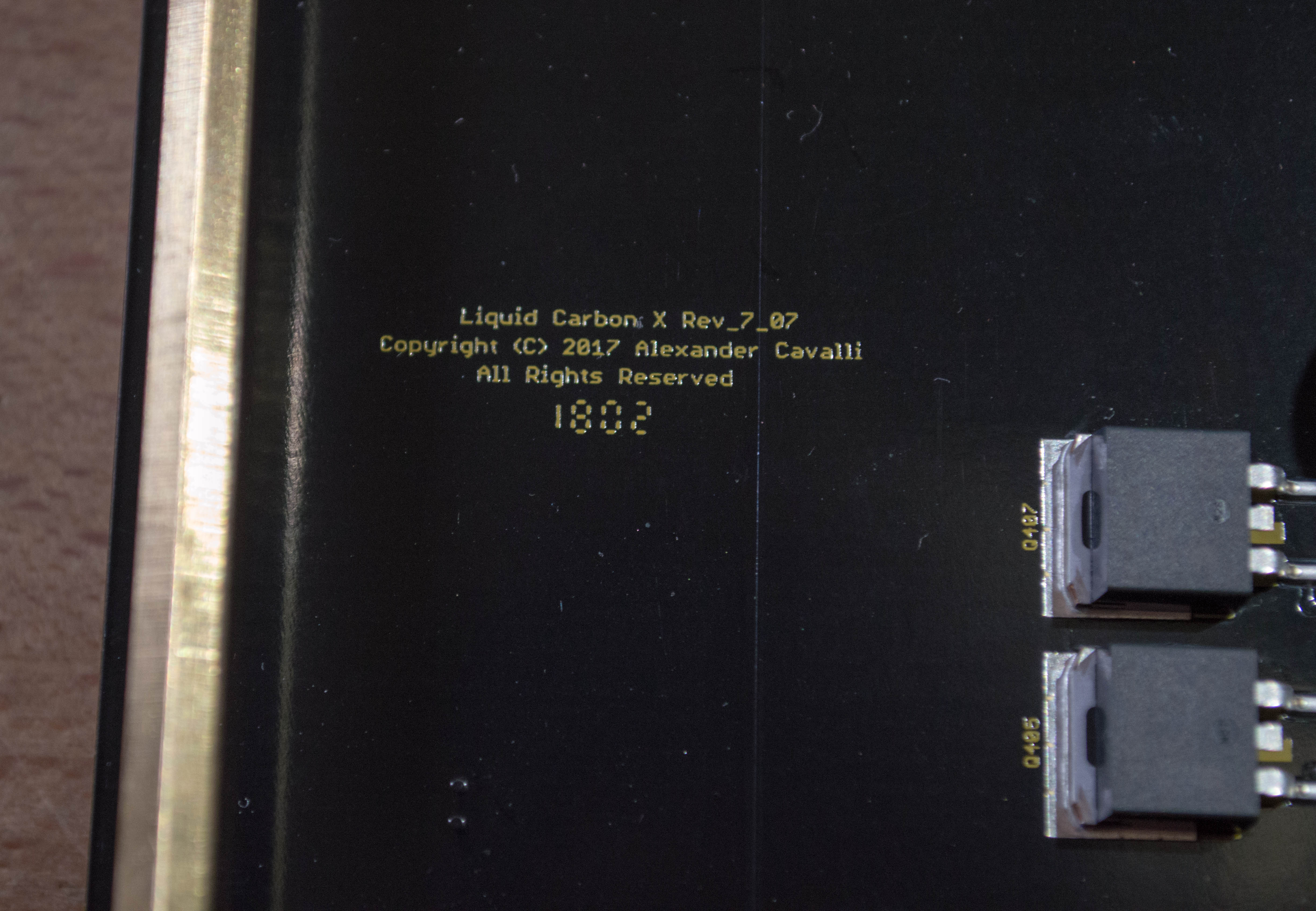

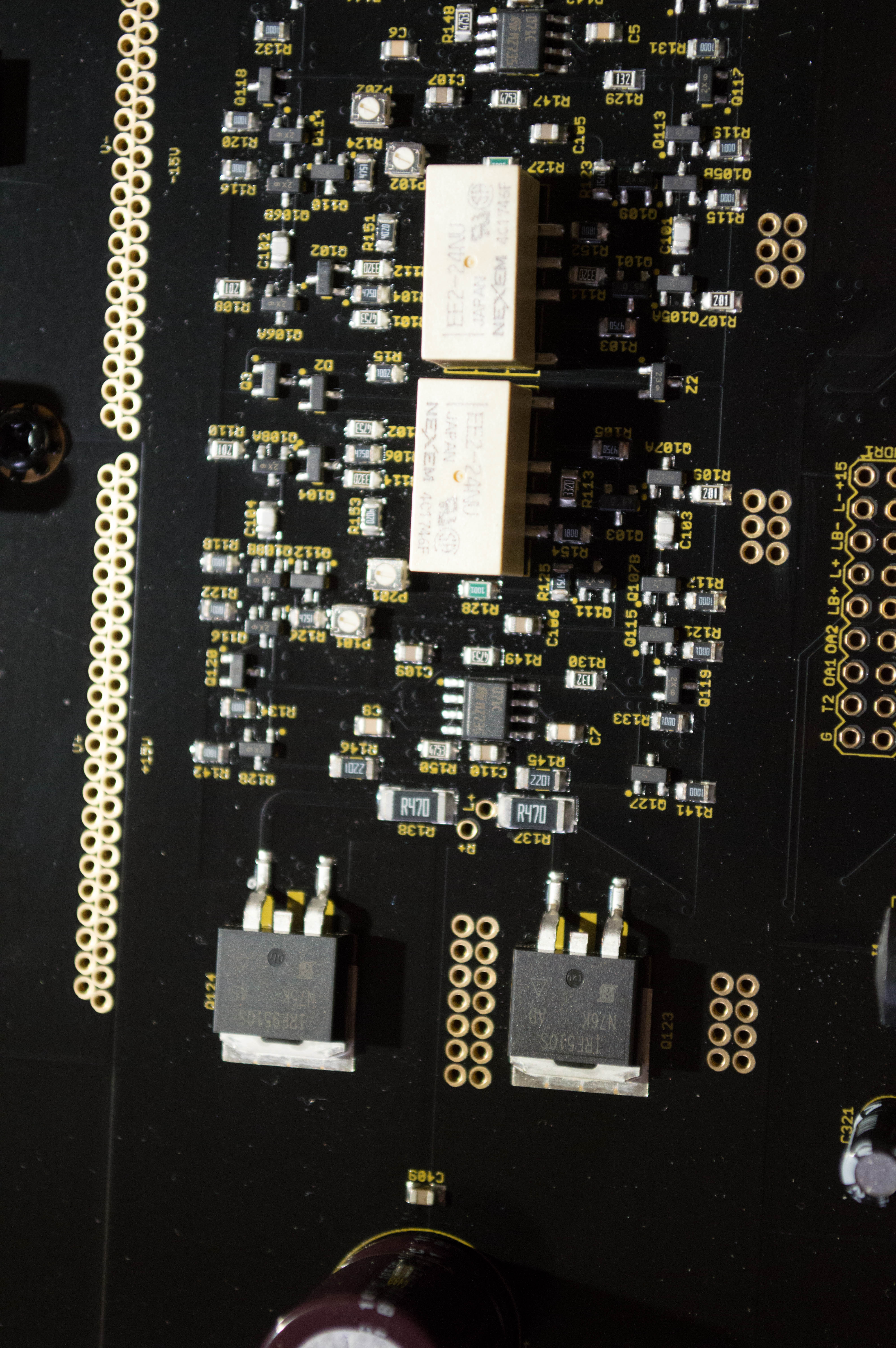

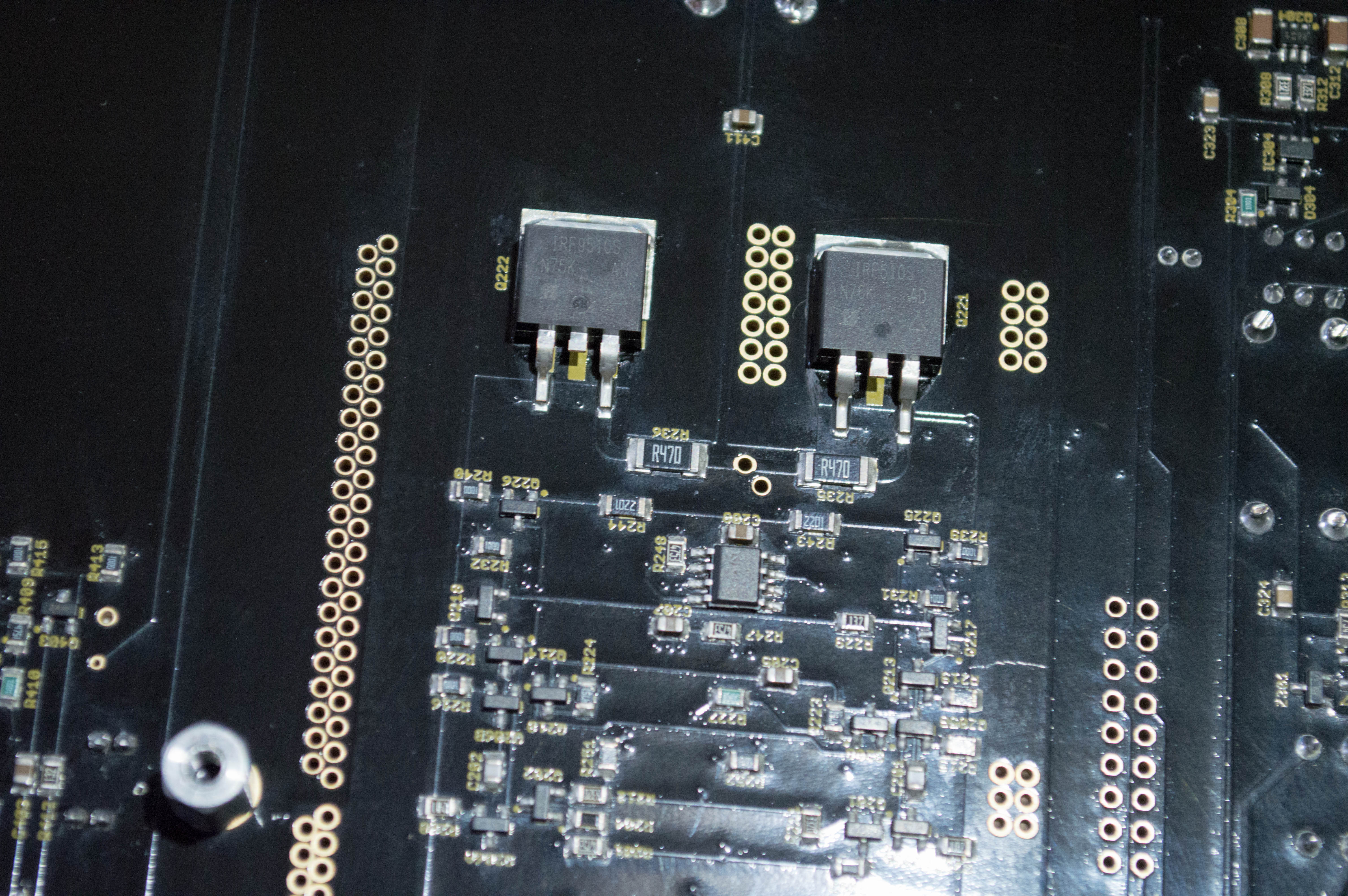

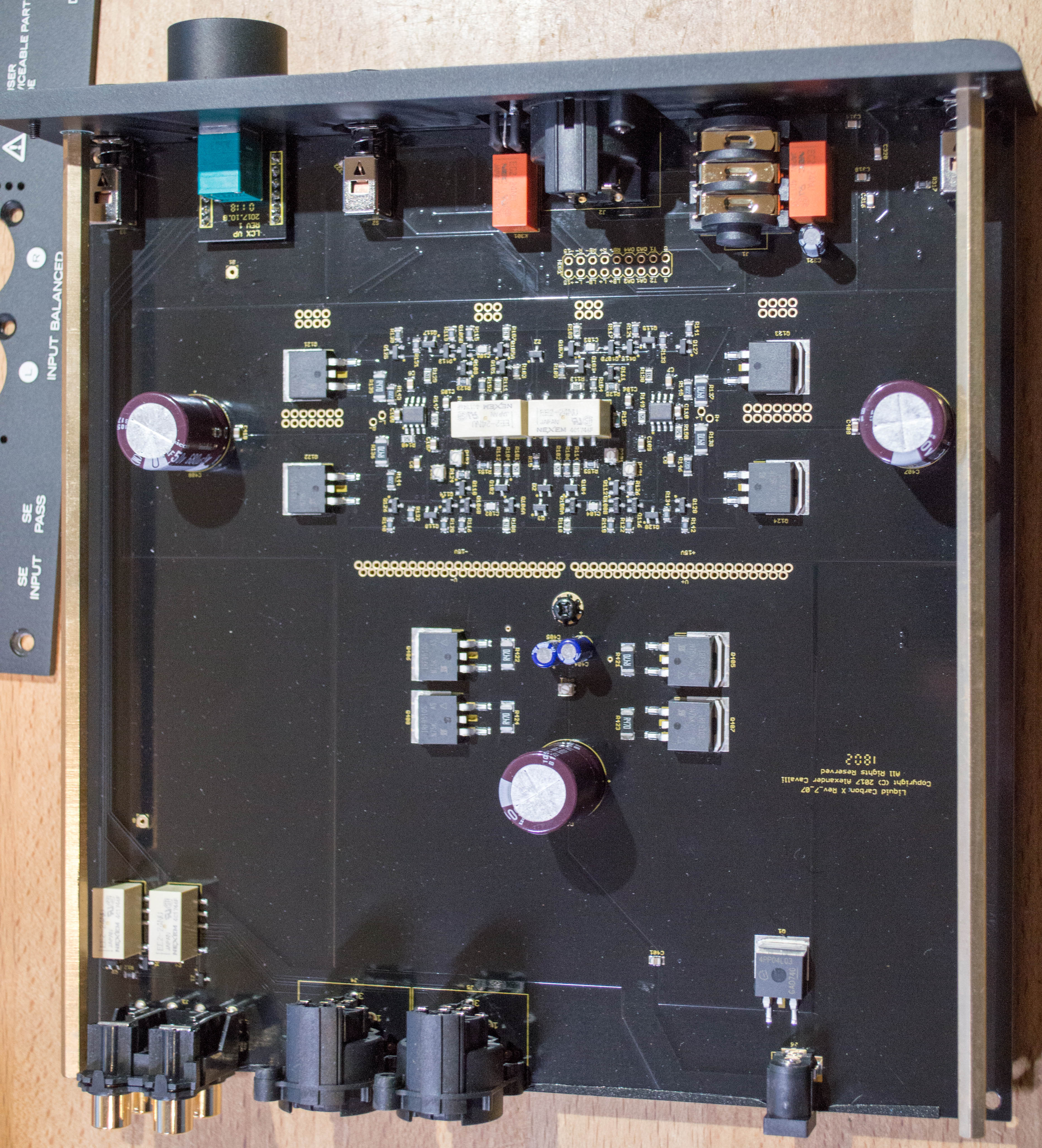

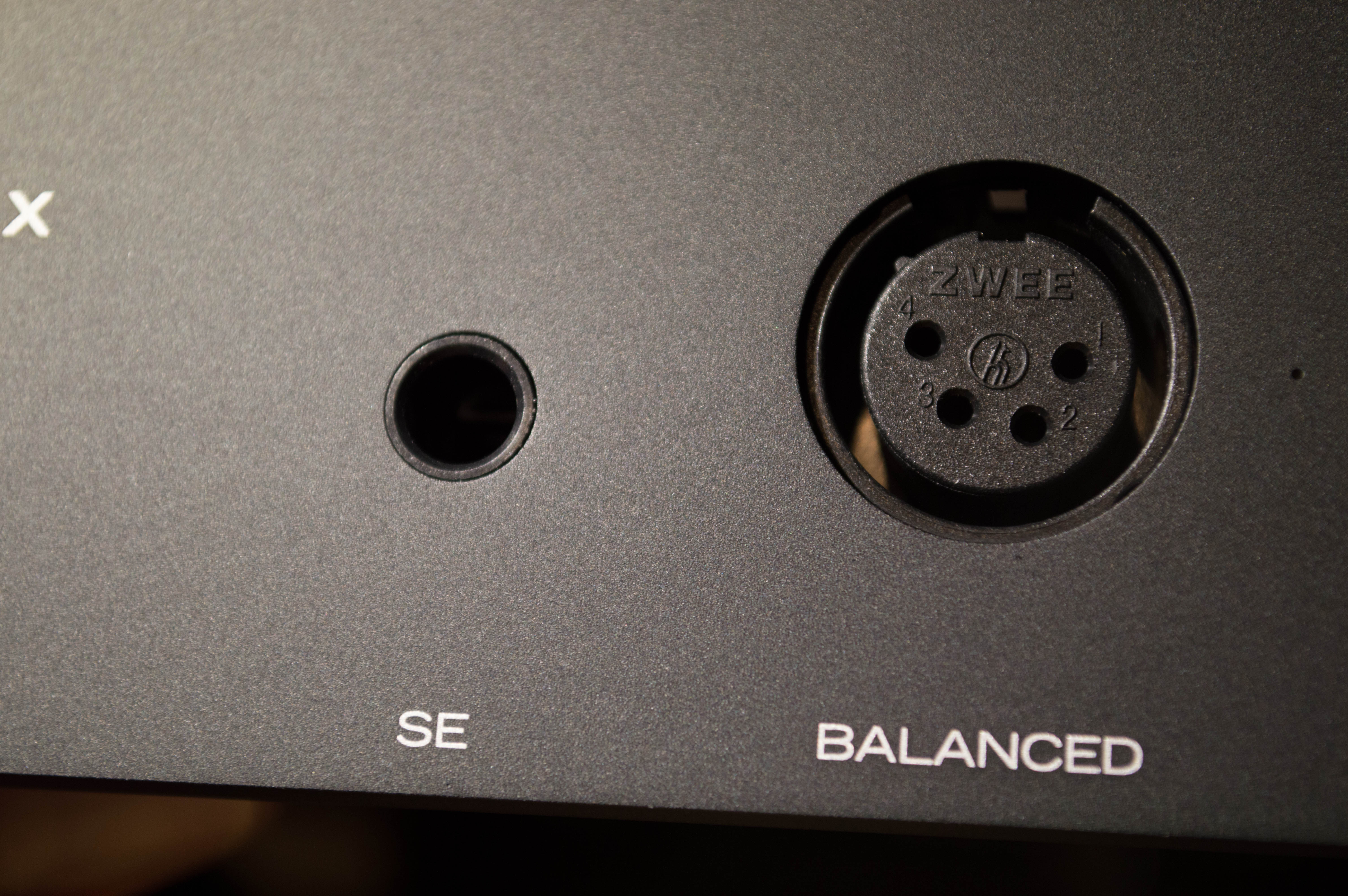

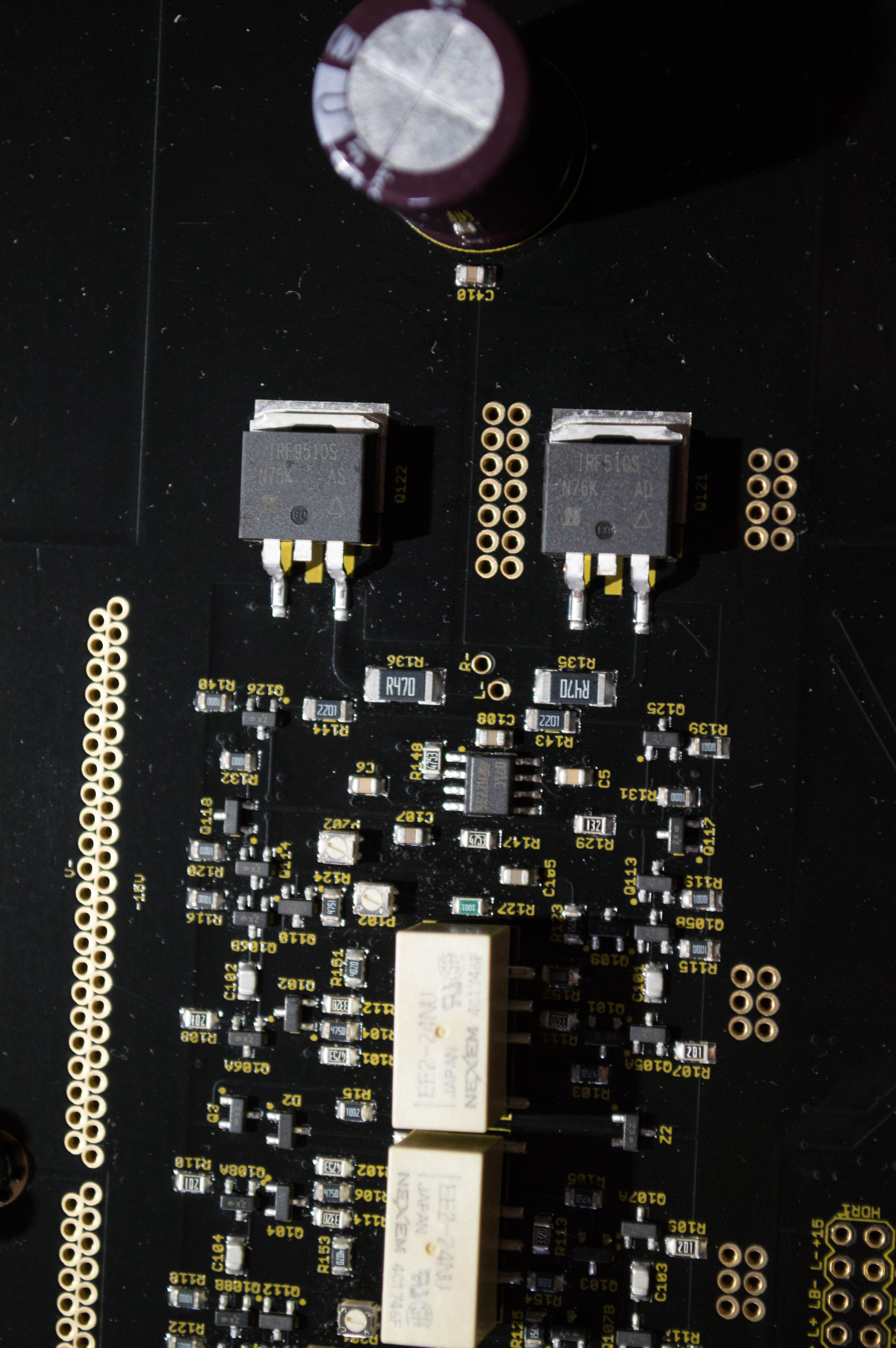

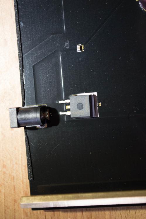

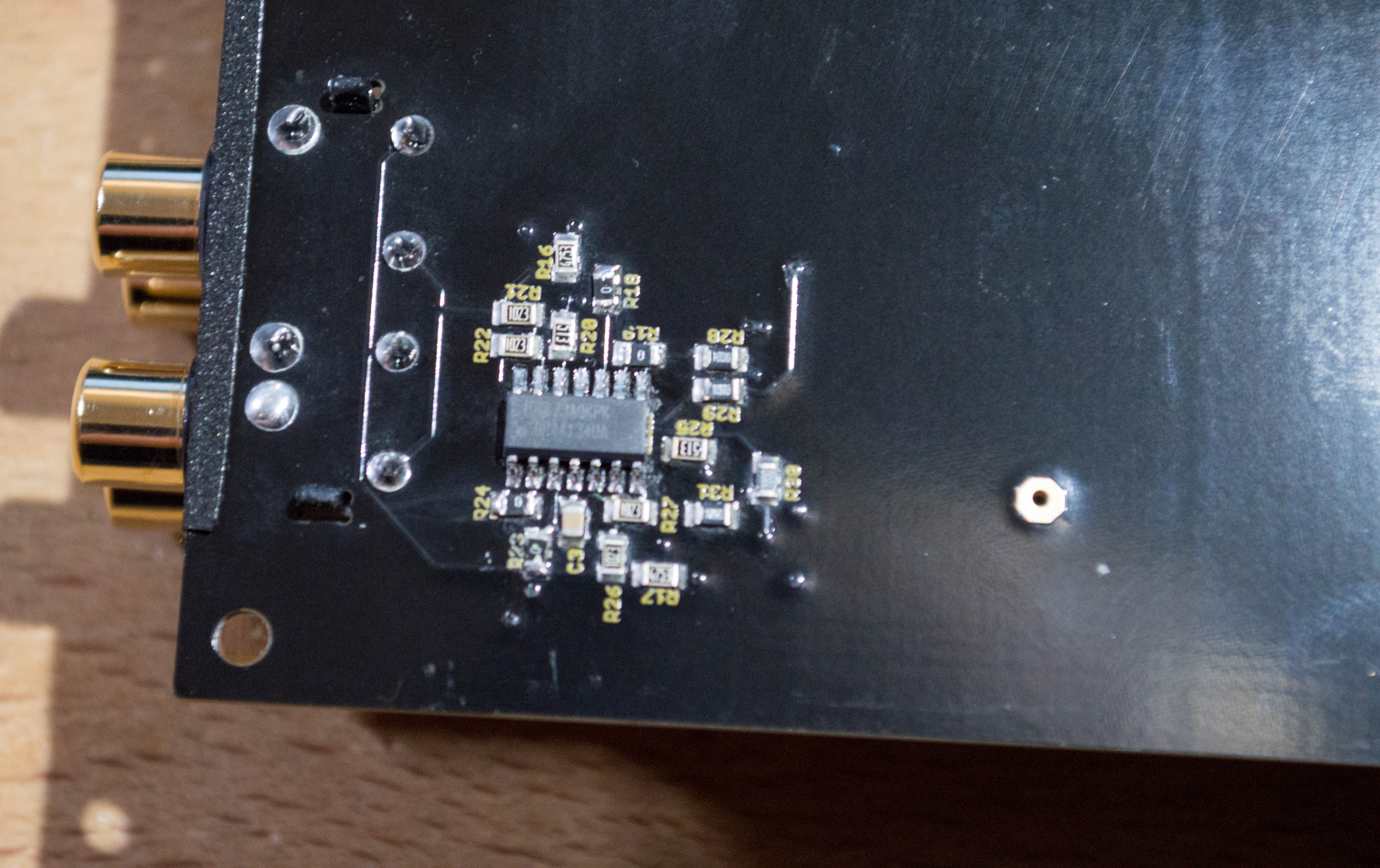

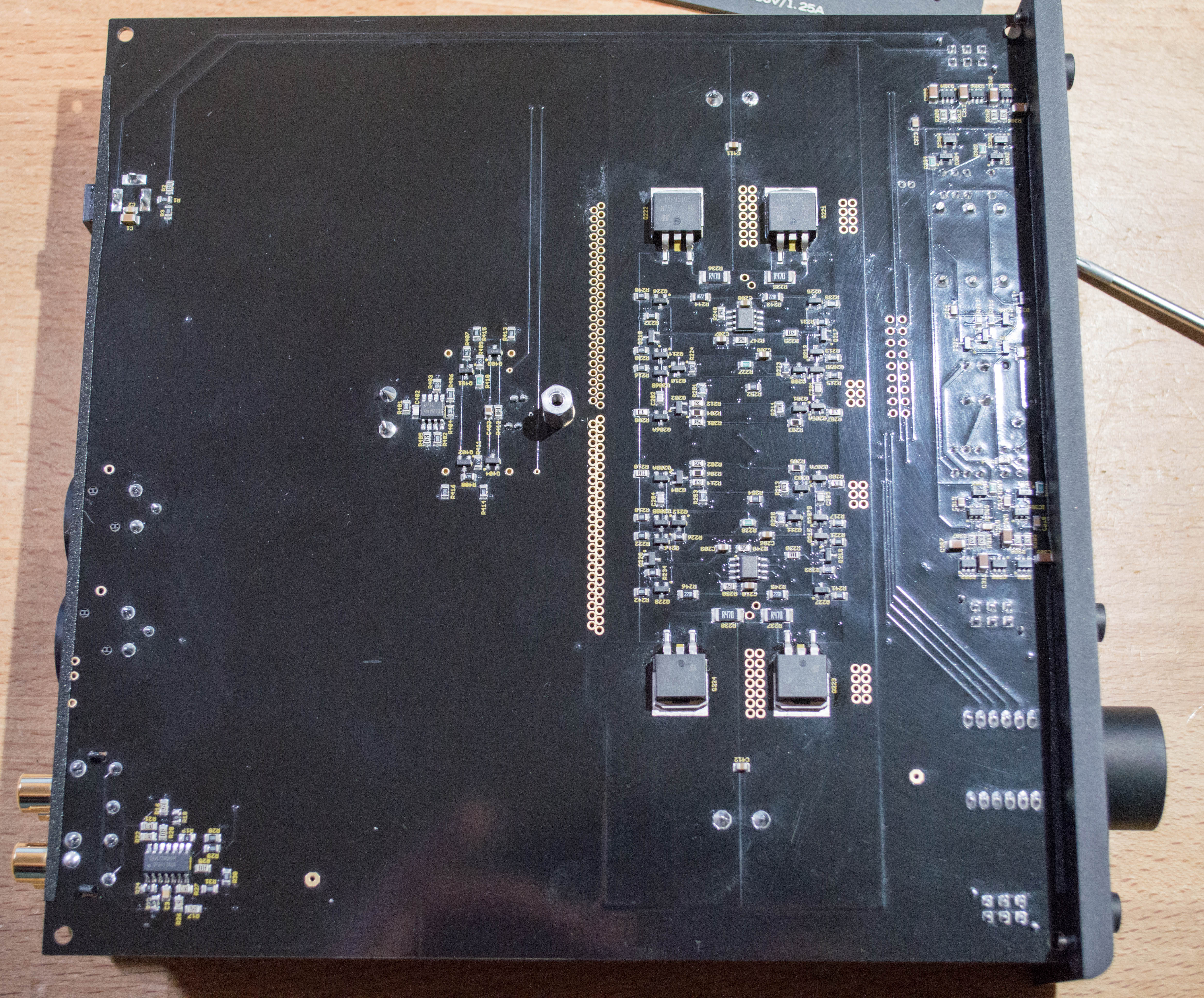

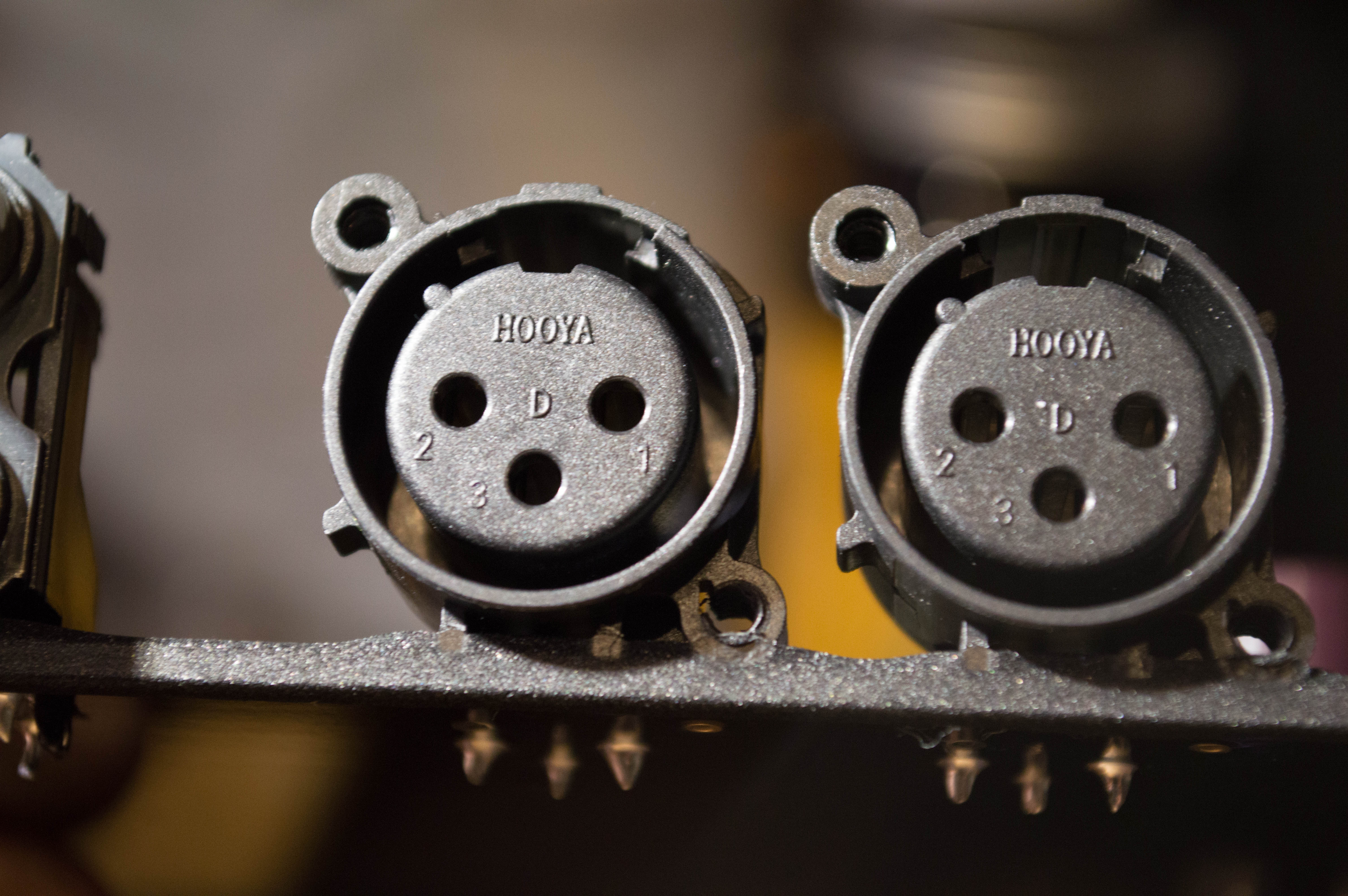

spritzer Posted March 2, 2018 Report Posted March 2, 2018 Needless to say, I invested in one of these works of art and well... it didn't disappoint. External build quality is way beyond the Cavalli Mk1 unit I had but inside...yeah.... So if anybody thinks this is good for 300$ they need their head checked. Every expense was spared here, just look at the high quality sockets used. I mean, who hasn't heard of the legendary "Hooya" sockets let alone "ZWEE". I mean quality stuff... Circuit looks to be identical to the LC minus the internal switcher. All the same issue as well plus the super cheap volume control... 2 1 1 1 Quote
skullguise Posted March 2, 2018 Report Posted March 2, 2018 Ha! And I thought there may have been a chance it would actually be BETTER built then the original.....silly me...... 1 Quote
lunaticbastard Posted March 2, 2018 Report Posted March 2, 2018 any chance you'll get this one? since the ads reading sounds very entertaining https://www.massdrop.com/buy/massdrop-x-thx-aaa-789-linear-amplifier?utm_source=Iterable&utm_medium=email&utm_campaign=ccu_Massdrop_x_THX_AAA_789_Linear_Amplifier&referer=4YGZFA&mode=guest_open&iterableCampaignId=251971&iterableTemplateId=359684 Quote

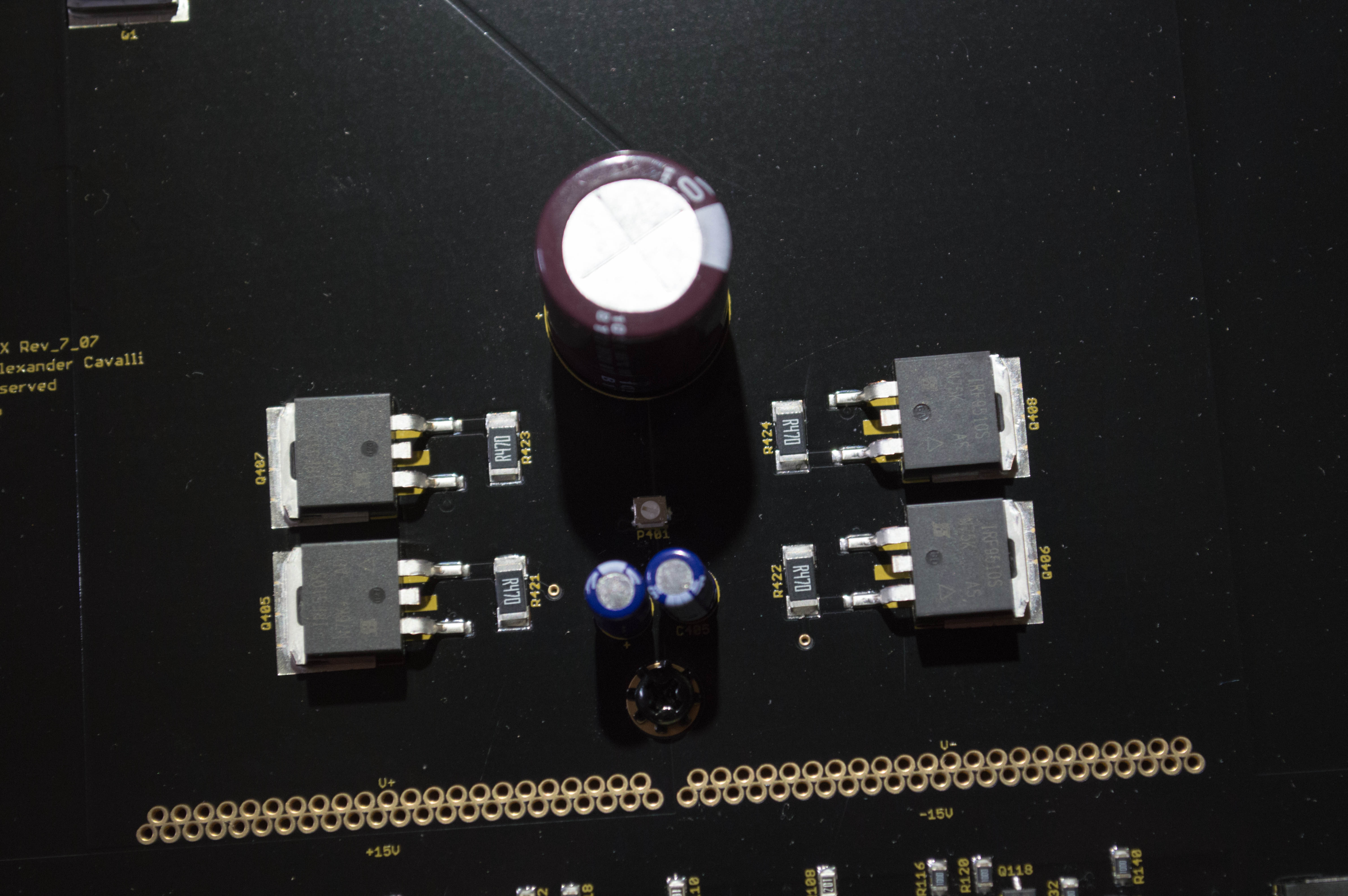

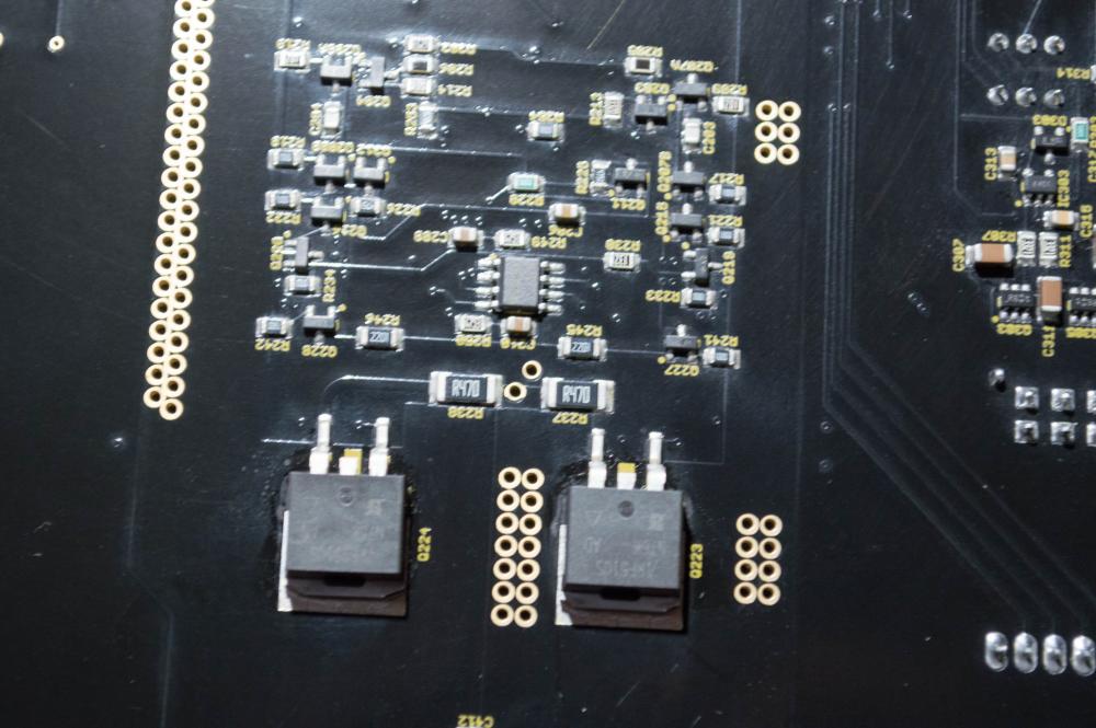

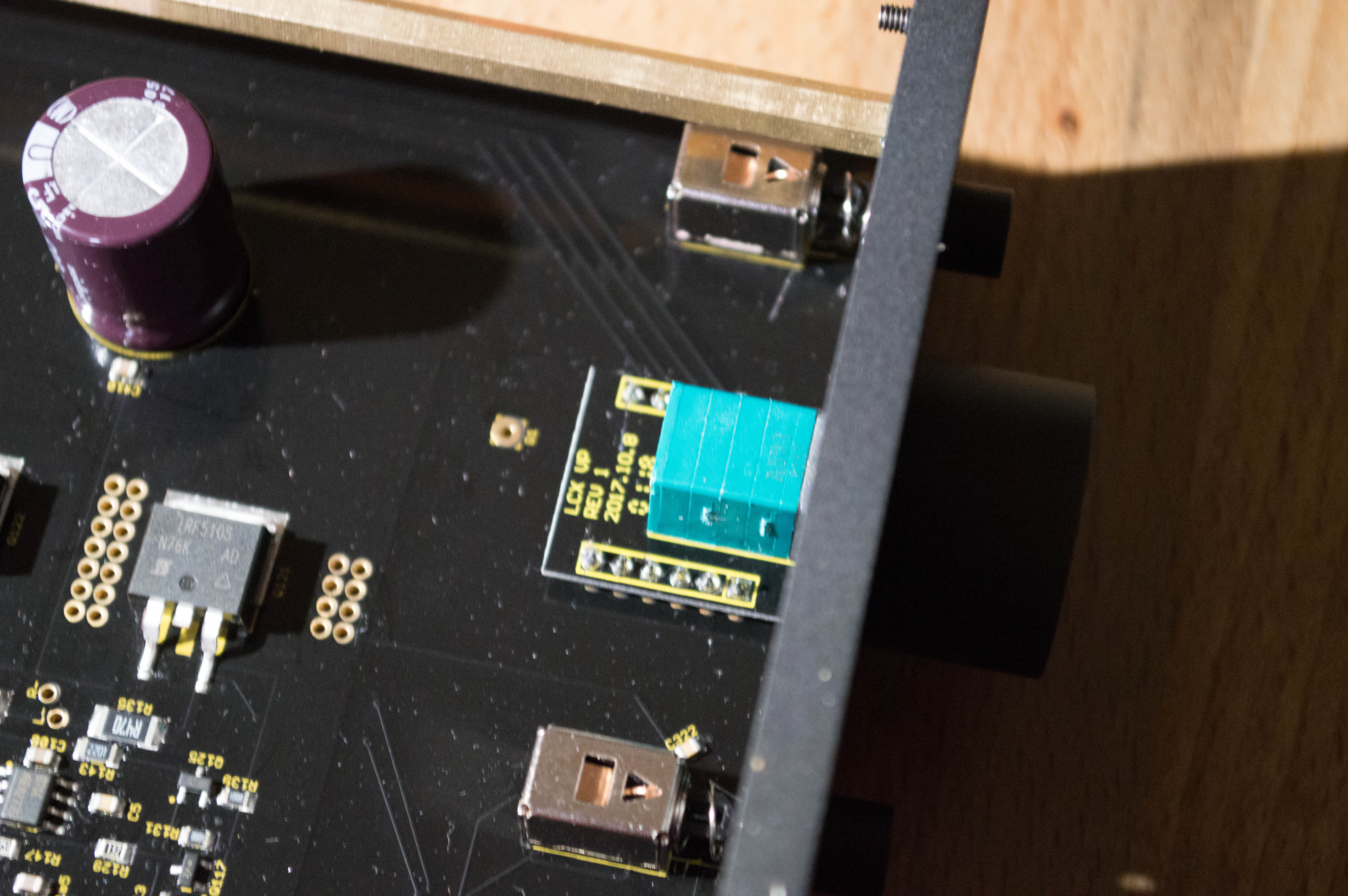

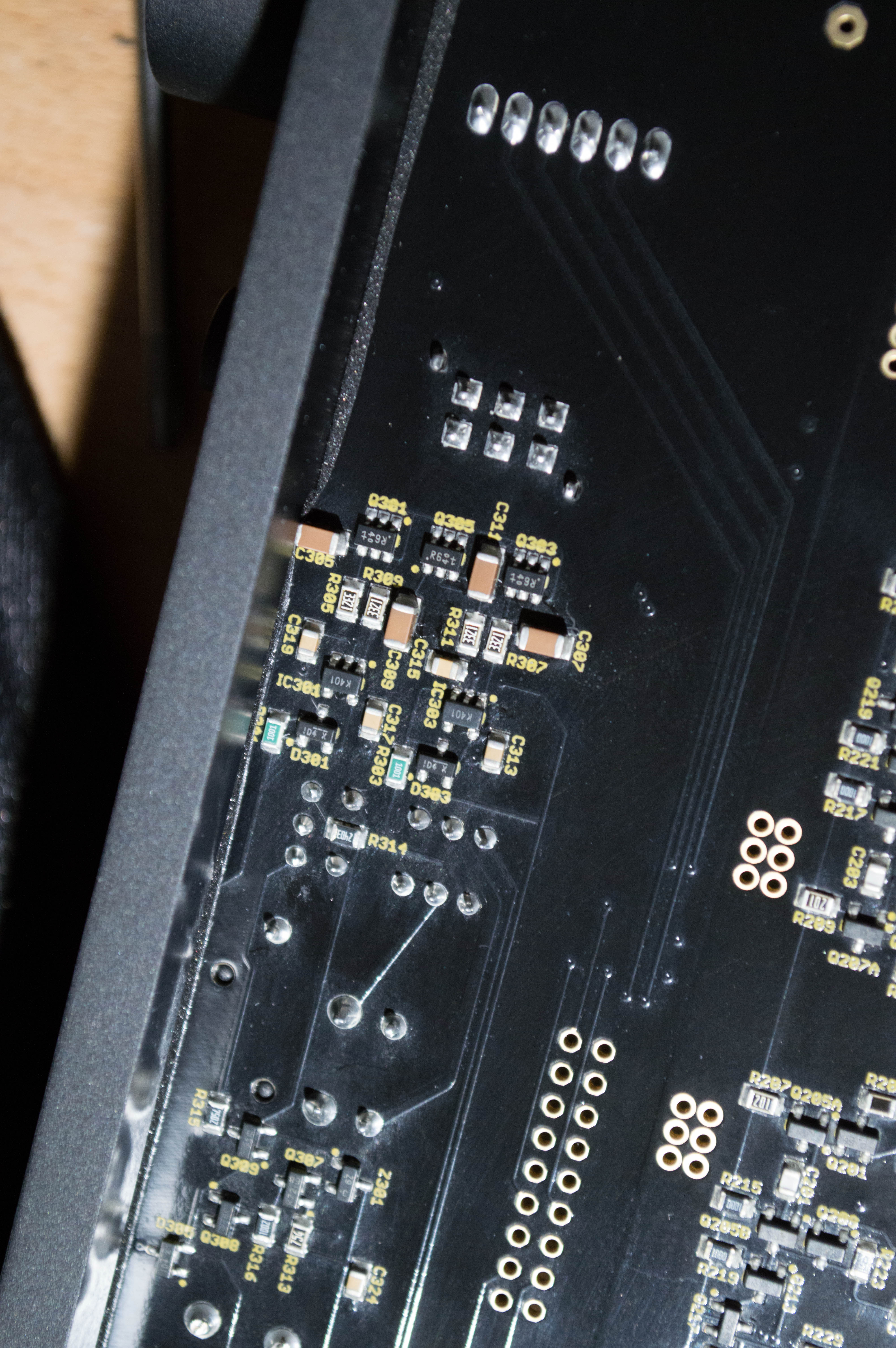

kevin gilmore Posted March 2, 2018 Report Posted March 2, 2018 well at least it has a dc protection circuit which the original did not have, and its sure going to need it, absolutely no heatsinking of any kind. OH look, a rail splitter that's necessary because of the ultra cheap single output switching brick. At least its actually built better than the original at less than half the cost. i'll bet that plugging in both unbalanced and balanced headphones is going to cause it to blow up. just like the original Quote
spritzer Posted March 3, 2018 Author Report Posted March 3, 2018 1 hour ago, lunaticbastard said: any chance you'll get this one? since the ads reading sounds very entertaining https://www.massdrop.com/buy/massdrop-x-thx-aaa-789-linear-amplifier?utm_source=Iterable&utm_medium=email&utm_campaign=ccu_Massdrop_x_THX_AAA_789_Linear_Amplifier&referer=4YGZFA&mode=guest_open&iterableCampaignId=251971&iterableTemplateId=359684 No, I only got the CTH amp as well which should be here soon. 1 hour ago, kevin gilmore said: well at least it has a dc protection circuit which the original did not have, and its sure going to need it, absolutely no heatsinking of any kind. OH look, a rail splitter that's necessary because of the ultra cheap single output switching brick. At least its actually built better than the original at less than half the cost. i'll bet that plugging in both unbalanced and balanced headphones is going to cause it to blow up. just like the original The lack of heat sinking will be a problem here, why they didn't use the nice chassis as some form of sinking is just beyond me. It's a nice sturdy aluminum shell so it could take some watts easily. I will probably blow this one up in the name of science... Notice the pissant 2010 0.47R resistors for the output devices... yeah they won't last long. 1 Quote

kevin gilmore Posted March 5, 2018 Report Posted March 5, 2018 I wonder if amb knows that alex is using his protection circuit? Quote
spritzer Posted March 5, 2018 Author Report Posted March 5, 2018 I very much doubt that AMB would be too happy about that. Quote

kevin gilmore Posted March 6, 2018 Report Posted March 6, 2018 massdrop and schiit seem to be trying to out cheap each other. clearly this thing is much better built than the original for less than half the price. whether the protection circuit will prevent it from blowing up if you insert unbalanced and balanced headphones is currently unknown. but cost cutting is evident everywhere. external switcher removes the need for line power inside the chassis (joutenheim) and the AC rated power switch. But rail splitter causes all sorts of issues. Virtually no heatsinking so the amp runs pretty much class B. etc the CTH is the same thing. More rail splitter because its single ended. Quote

kevin gilmore Posted March 7, 2018 Report Posted March 7, 2018 If the new LCX sounds worse than the original, its probably because of the rail splitter, otherwise the circuitry and parts are identical. I have never seen a rail splitter test well. The original squarewaves all burned up due to heat and other stupidity, but otherwise sounded really nice, still the only headphone amp I know of that is both current feedback and all of the voltage gain in the output stage. The re-done version is still a sweet but low powered amp. dynalo and supersymmetry dynalo still out perform everything else in their power class and as far as I know, no one has ever been able to burn one up. 1 Quote

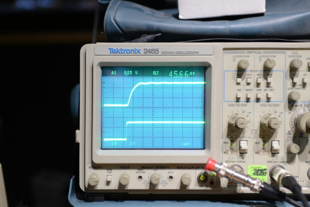

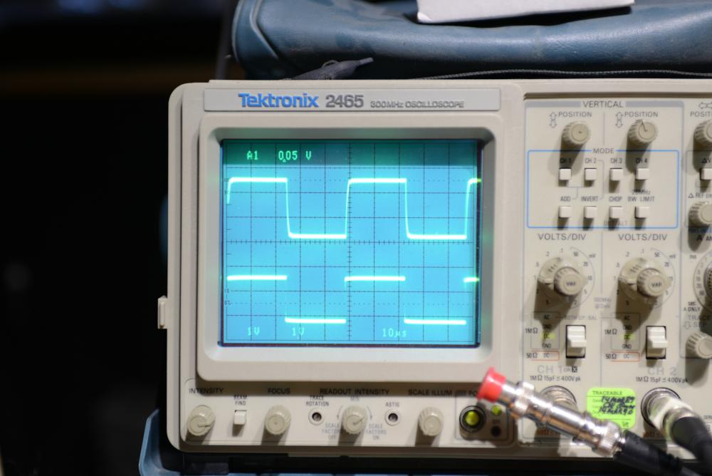

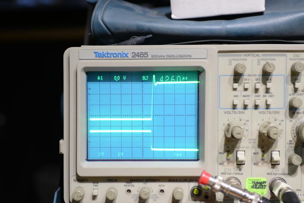

kevin gilmore Posted May 7, 2018 Report Posted May 7, 2018 (edited) so birgir sent me 2 pieces of cavalli to test all at 20khz into 50 ohms top is output, bottom is input first up is the CTH which does in fact invert phase, check out the feedback spike next is the lcx, much slower slew rates (mosfets, no surprise there) and the ringy dingy Edited May 7, 2018 by kevin gilmore 3 Quote
