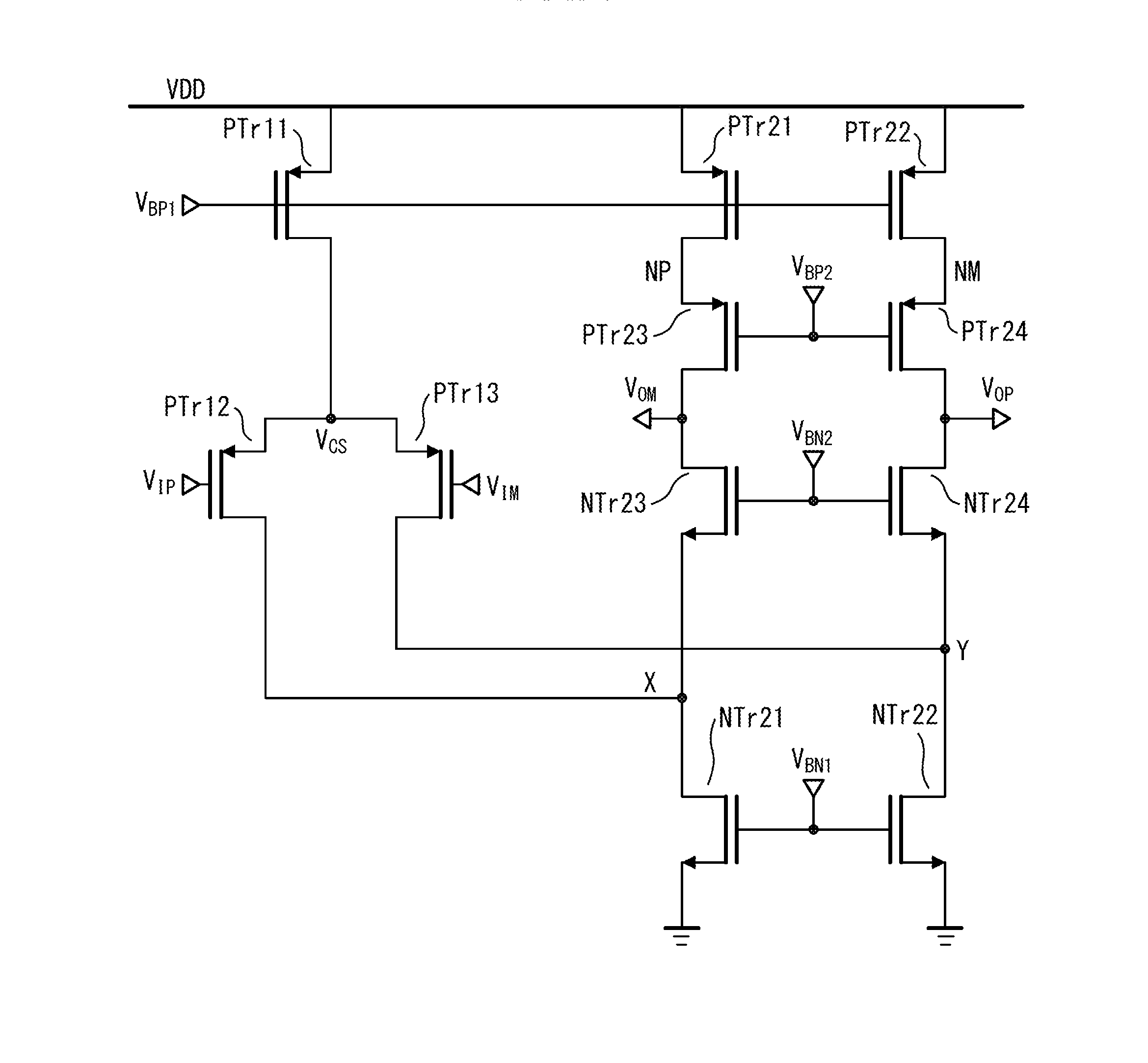

JimL Posted November 10, 2017 Report Posted November 10, 2017 (edited) Hmm... Let's see. Topology described as: BJT Folded Cascode+Tube with CCS, 6SN7GTB outputs. Max output 325 VRMS which calculates to 920 volts peak-to-peak - this suggests PS supply of around +/-300 volts give or take. So I Google searched folded cascode and came up with this image from a patent application - looks similar to the input and mid-stages of a Stax amp, but maybe with BJT input instead of FETs, and the CCS looks cascoded, so probably the output stage is similar to the SRX Plus, but without a tail current source. So, yeah, overall similar to a SRM-T1 with CCS in place of the output resistors, or a KGDT/KGST. Most likely passive PS, though. Edited January 30, 2018 by JimL Quote
