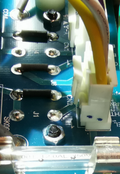

MasterBaiter Posted July 12, 2020 Report Share Posted July 12, 2020 I know it may sound stupid but can you give me more hints on how to change the voltage for t8000? I want to change from 120v to 220v. Also, should I need to chage fuze after changing voltage? maybe I need to rewire some lines in the picture but don't know what exactly should do. Quote Link to comment Share on other sites More sharing options...
kevin gilmore Posted July 13, 2020 Report Share Posted July 13, 2020 (edited) warning: check with ohmmeter to make sure the transformer is wired like all other stax transformers for 100v jumpers at J1,J3,J4 grey to white green to brn remove other jumpers for 120v jumpers at J2,J3,J5 grey to white purple to blue remove other jumpers for 220v jumpers at J5,J6 blue gry to purple remove other jumpers white ties to yellow thru fuse white,green,purple is one winding 0,100v,120v grey,brown.blue is other winding 0.100v.120v Edited July 13, 2020 by kevin gilmore Quote Link to comment Share on other sites More sharing options...

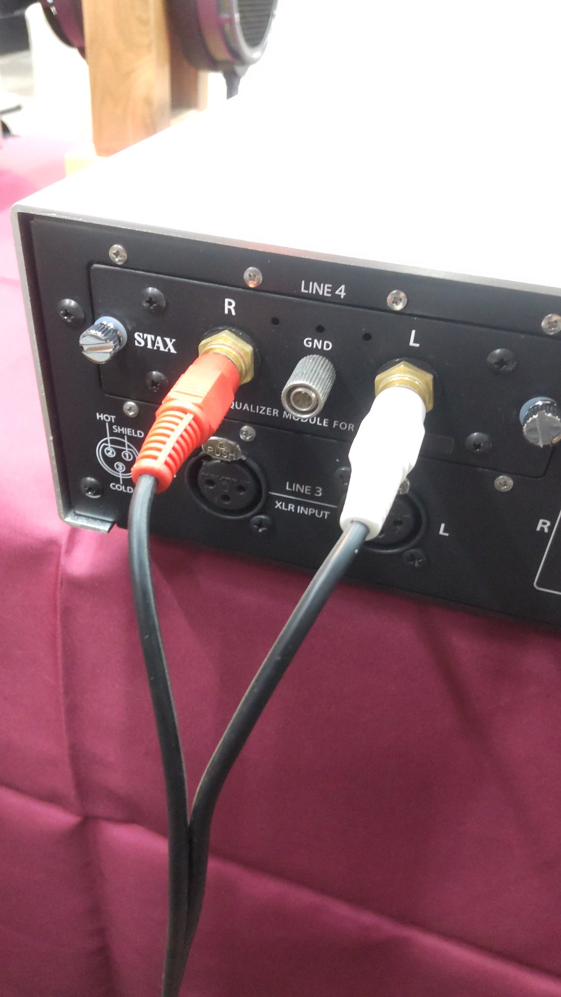

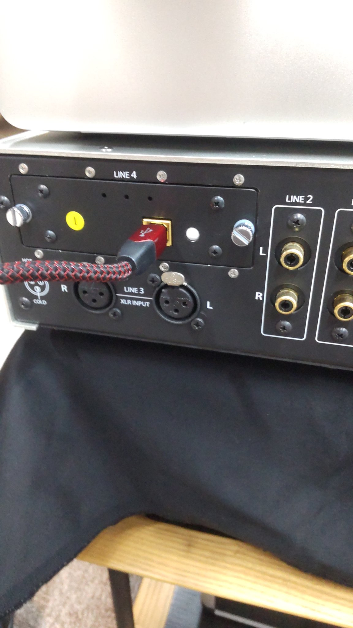

spritzer Posted September 1 Author Report Share Posted September 1 (edited) Now after only 7+ years of the T8000 being a fairly shitty amp... Stax have made extra input boards for them. No word on pricing yet but yeah... who fucking cares Edited September 1 by spritzer 4 1 Quote Link to comment Share on other sites More sharing options...
