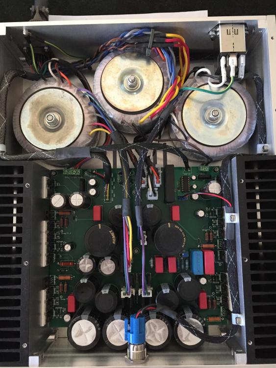

Kerry Posted May 5, 2017 Report Posted May 5, 2017 I'm using SumR now. Yes, I have pretty much the same space allowance as Kevin's. I did tweak some of the voltages so it dissipates a little less heat. 2 Quote
justin Posted May 5, 2017 Report Posted May 5, 2017 whats the transformer specs? i havent ever looked at that for the t2. looks like all 3 transformers are different? Quote
GeorgeP Posted May 5, 2017 Author Report Posted May 5, 2017 Looks like your LV has an extra winding(8VAC) and one of your HV traffos is missing the 75VAC? Would the standard windings also work for you or do you need these modifications? Quote

Kerry Posted May 5, 2017 Report Posted May 5, 2017 I used 425VAC, 270VAC & 70VAC for the negative rails, and yes I dropped the 75VAC (not used anyway) on the second transformer, which is 425VAC and 235VAC. I'm using the doubler for the bias so I could get away with lower HV on the positive rail. On the LV I added the 8VAC so I could power the digital attenuator which needs 5VDC. I'll probably need different from most, but thought I'd enquire anyway. Quote

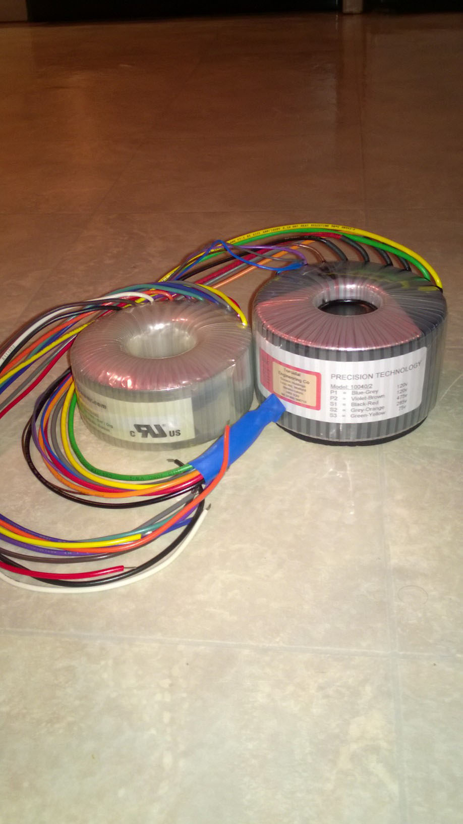

GeorgeP Posted May 5, 2017 Author Report Posted May 5, 2017 (edited) From what I recall from Paul (TEC), the savings lies in using the same core (assuming the volume is sufficient). PM me your specs. For reference, SumR on the left and TEC on the right (had this swapped - too sleepy with all the rain we've been getting): Edited May 5, 2017 by GeorgeP Quote
