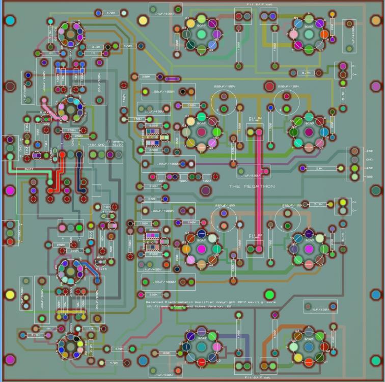

mwl168 Posted April 11, 2017 Report Posted April 11, 2017 (edited) Someone, who will remain unnamed here, got me interested in building a Megatron I got quotes back from the fab houses. If we can get 10 sets we can get the cost per board down to just under $40 USD (plus shipping from me to the participant). The PCB is 228mm x 228mm and will be 2mm thick with 4oz copper. I did some research and the only obsolete/hard-to-get part is the 4 2SA1968 which Kevin confirmed can be replace with KSA1156 mounted backwards. The board also uses 2 2SC1815 or MPSW06. I have a stack of the 2SC1815 so I am happy to supply them to the GB participants that need them (no cost). Please respond here if you are interested. Thanks! Edited May 8, 2017 by mwl168 Quote

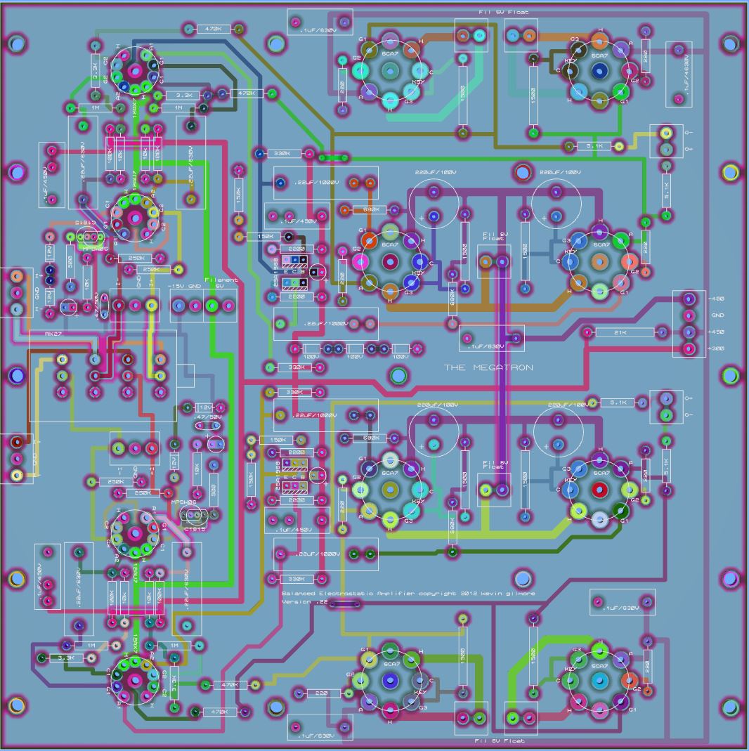

mwl168 Posted April 11, 2017 Author Report Posted April 11, 2017 (edited) Rendering of latest board: Edited April 11, 2017 by mwl168 Quote

mwl168 Posted April 13, 2017 Author Report Posted April 13, 2017 Looking at the latest Megatron Gerber file I downloaded and used in my 2nd post here, the front end 12AU7/12AX7 also uses 6.3V filament. I do remember reading on the Megatron thread that 12.6V filament can be used but will involve modification of the board. 3 hours ago, kevin gilmore said: no on the 3 terminal regulators. each output tube is 1.5 amps so that is 4 x 1.5 amp windings and 1 x 6 amp winding all the input tubes are in parallel, so 12V at 600ma Hi Kevin: Can you confirm if my observations below (from the Gerber) are correct? 1. The CCS EL34 tubes are the four EL34 on the outside edge of the board, each of these EL34 needs its separate filament winding and the filament supply wires need to be very short so the transformers pretty much need to sit right next to or below the board. 2. The output EL34 tubes are the ones in the center, two for each channel and can share one filament winding for each channel. 3. All the EL34 filament supplies need to be floated. Quote
kevin gilmore Posted April 13, 2017 Report Posted April 13, 2017 1 ) yes 2) yes 3) the 4 tubes in the middle can either float or tie to -vcc yes the front end tubes are 6.3v, so 1.2 amps 1 Quote

kevin gilmore Posted April 14, 2017 Report Posted April 14, 2017 (edited) 12v filament version posted pretty sure the original was done the way it was to accomodate the 6dj8 tubes for those that wanted to do that edit: the filaments of the output tubes are tied to -450v on the board Edited April 14, 2017 by kevin gilmore 5 Quote

mwl168 Posted April 14, 2017 Author Report Posted April 14, 2017 (edited) Yes. We will be using the updated board for the GB. Updated board image courtesy of congo5. Edited April 15, 2017 by mwl168 Quote
