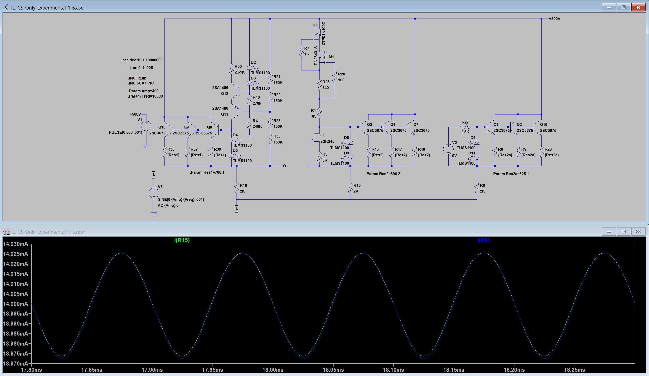

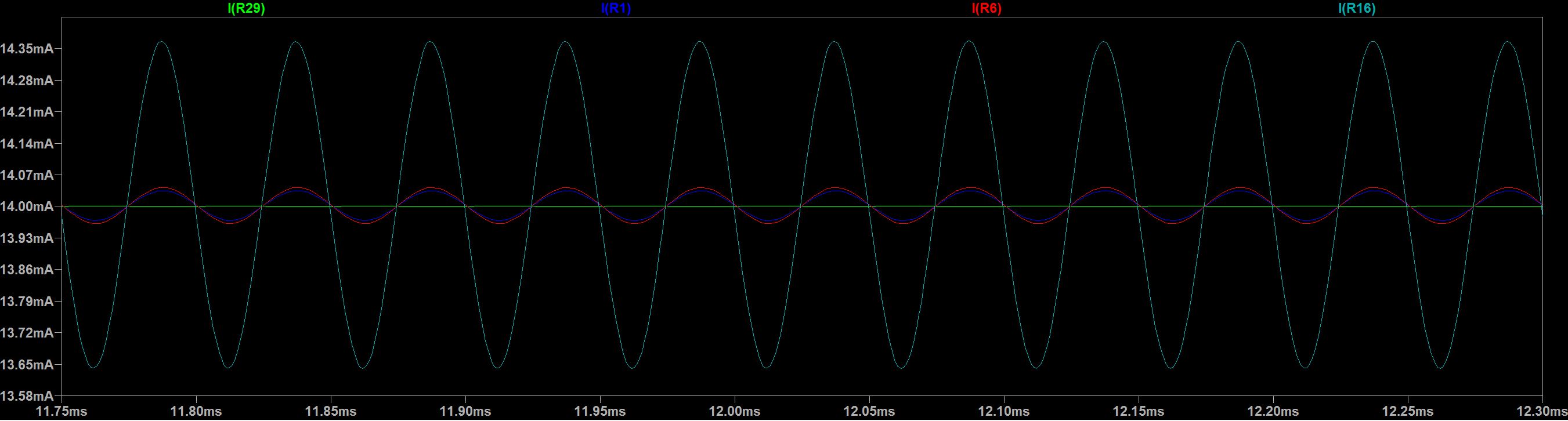

Posted (edited)

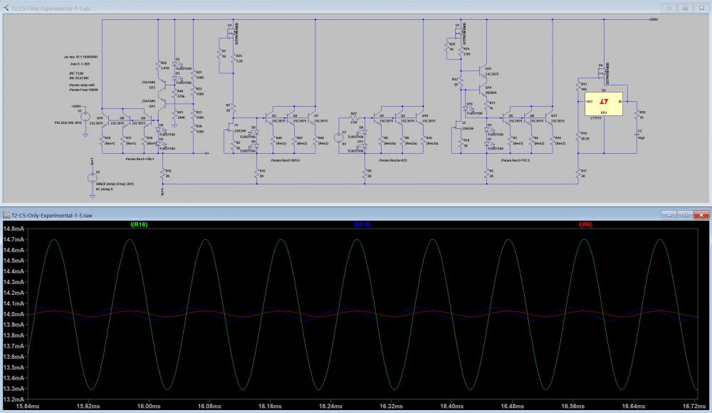

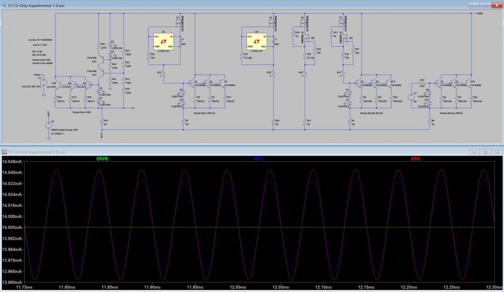

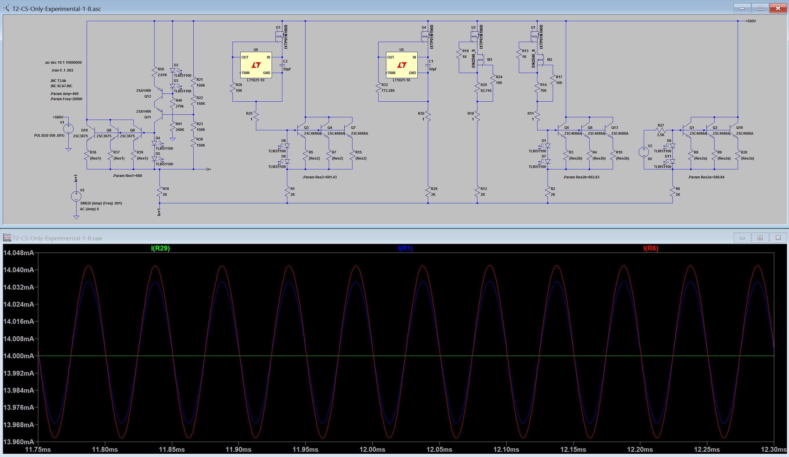

I saw some noise issues in the Spice model for the regulator version as well.  I could mostly control it, but not completely (especially once you go above 20KHz).
Here's another idea I came up with (CSS #2 and #4).  They will also support 1,000V.  You could improve it slightly by adding a DN2540, but I'm not sure it's worth it.  These other two models work almost as well as the battery at 10KHz and only a bit worse at 20KHz.  The second (#2 below) is probably the best bang per parts.  # 4 could be made to be a bit better, but I'm not sure it's worth it.
The results are for the first three only (which includes the battery that Kevin came up with).
R1 May not be necessary, but it felt good :)   I want to experiment a bit more with it.
Edited by Kerry
  • Like 4
Posted
Nice picture. If a1486 had been a kV device the T2 current source would be a better one? Most of the variation of the green curve must be due to the 150k resistors.
Posted
Ops! Kevin pointed out the resistors in this post.

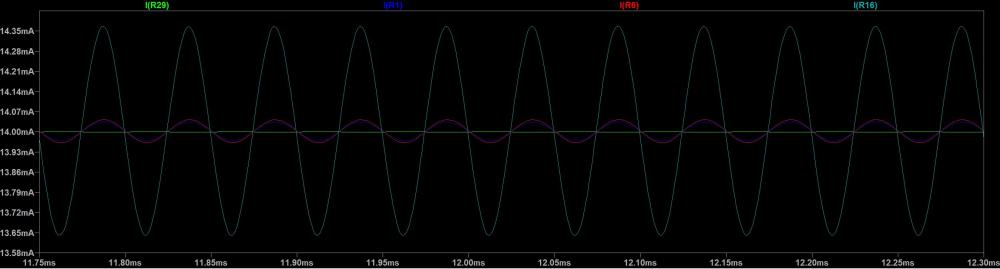

Posted

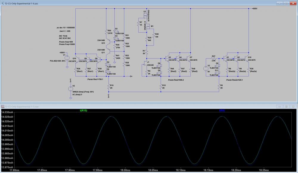

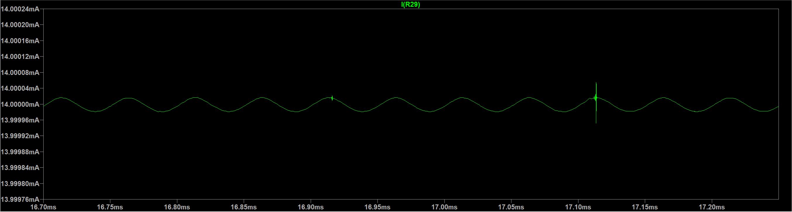

I was wrong about not cascading the MOSFETs.  It really did help.
At this point, spice is showing me the same results as the battery.  It would be nice if someone could check this to confirm.  The models I'm using for the IXTP01N device seem to be optimistic.  Note that J1 only helps if the top MOSFET performs worse.
So, if the model is right, then you don't need J1 and we're right back to what Kevin was suggesting :)

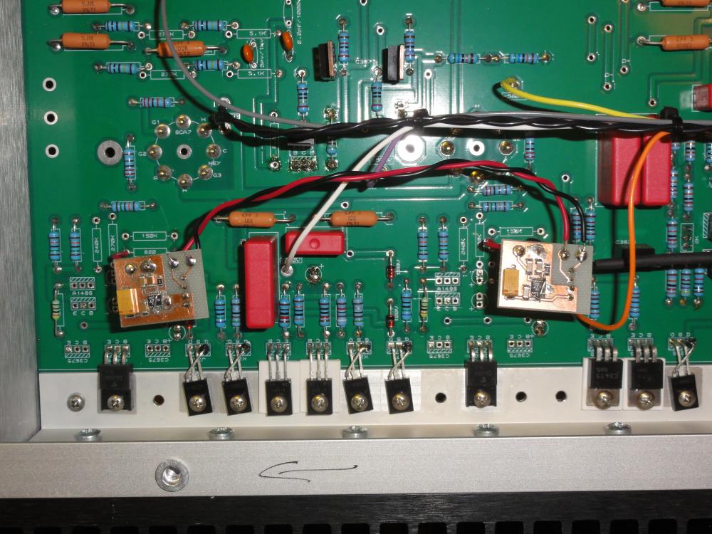

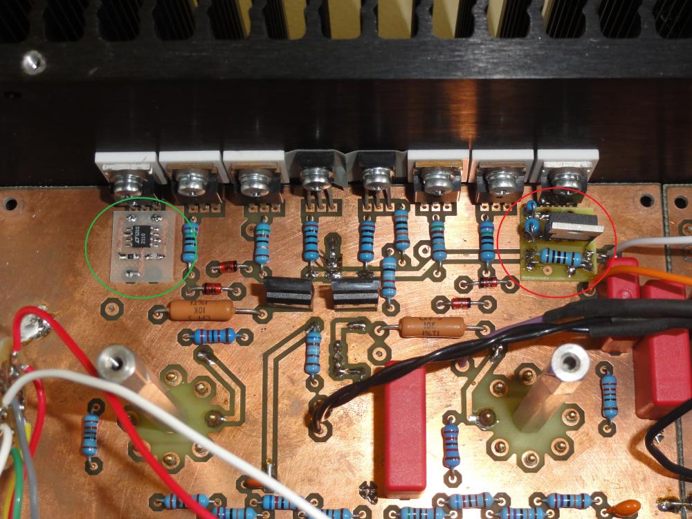

Posted

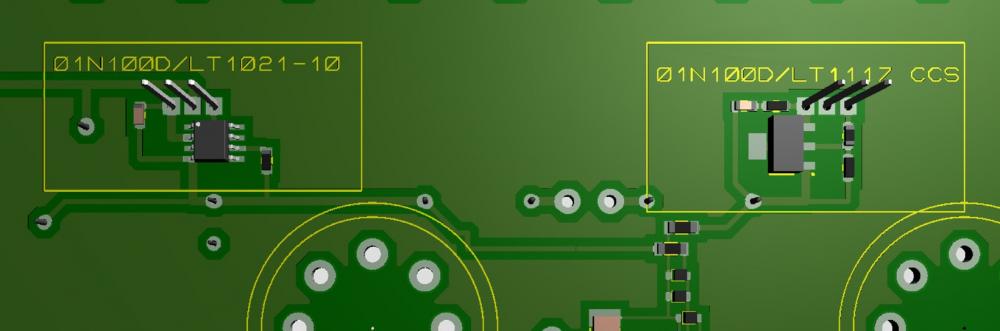

Today I’ve equipped my modified T2 with the 01N100D/LT1021 current source Kerry has simulated, see previous posts. From beginning it had a straight 10M90S set to 10 mA. When JimL came with the cascaded version I removed the two resistors at 10M90S and added a small board with the DN2540 and corresponding resistors(red circle below). Today I made new daughter boards containing LT1021, 1k resistor and 47pF cheremic capacitor (green circle).
Have listen to this for an hour. It works and I’m satisfied.
Thanks Kerry for coming up with this.
Below solar cell. Only for experimental purpose.

Posted
Excellent!  I'm curious if you were thinking of testing this same current source as a replacement for the battery (2mA to bias the CCS transistors) in the larger T2 as well.  I'm curious how it compares to the batteries.
Posted

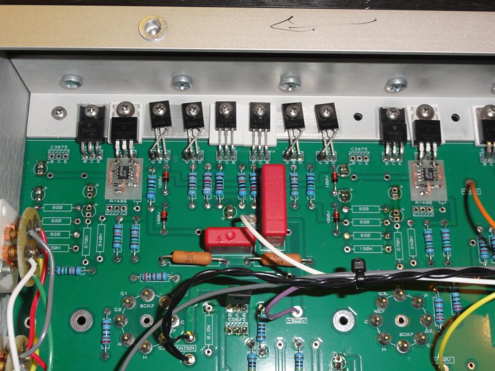

It was actually very easy to rebuild the large T2 with the DC/DC converters. Used same daughter board layout as for as for my modified T2, only had to move one hole 50th. I also have plenty of space since I only use one and not three output transistors and I found some nice spots for the daughter boards. One channel has the DC/DC converters and the other the newly made 01N100D/LT1021 boards. Both channels seem to work OK.
Below: Daughter boards with LT1021 and 01N100D on heat sink.DSC00314.thumb.JPG.bf657c27c07a11a515ab792fd91bf17f.JPG
Boards with DC/DC converters and LT3045.DSC00315.thumb.JPG.95b66265862e7a895def7efda0c5d353.JPG
