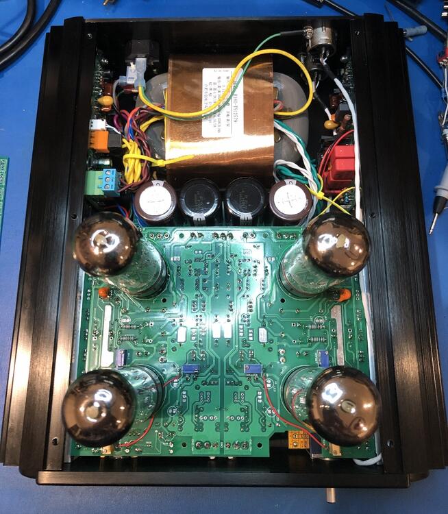

mwl168 Posted February 28, 2021 Report Posted February 28, 2021 Switched from Megatron to the Blue Hawaii this morning. Different sound signature but equally as satisfying. This one is not the BJT version but the one that uses 2SK216/2SJ79 with cascoded CCS and adjustable plate current.  4 Quote
