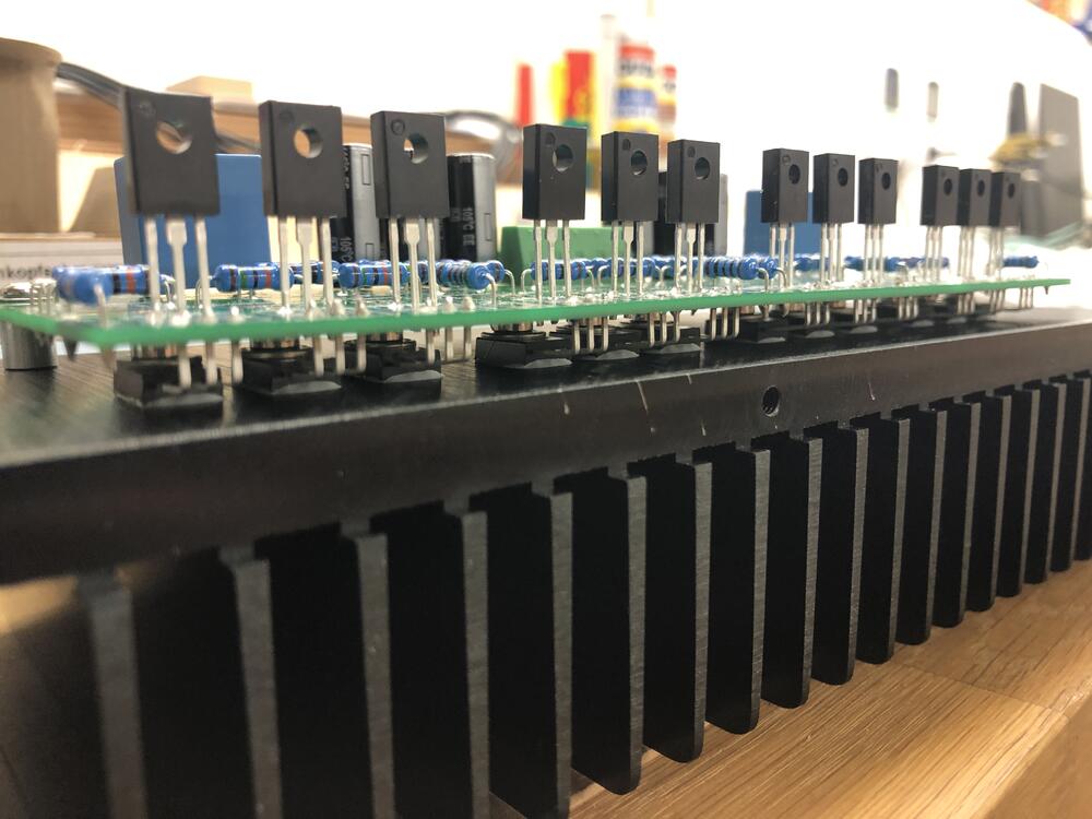

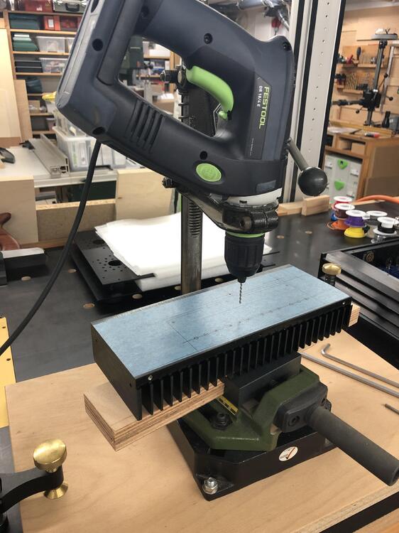

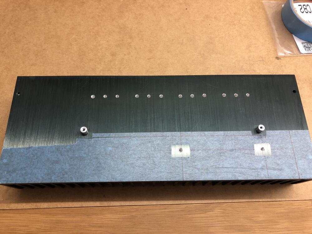

starcat Posted May 8, 2021 Report Posted May 8, 2021 Drilling and taping holes... amp boards now mounted to the sinks. 7 Quote

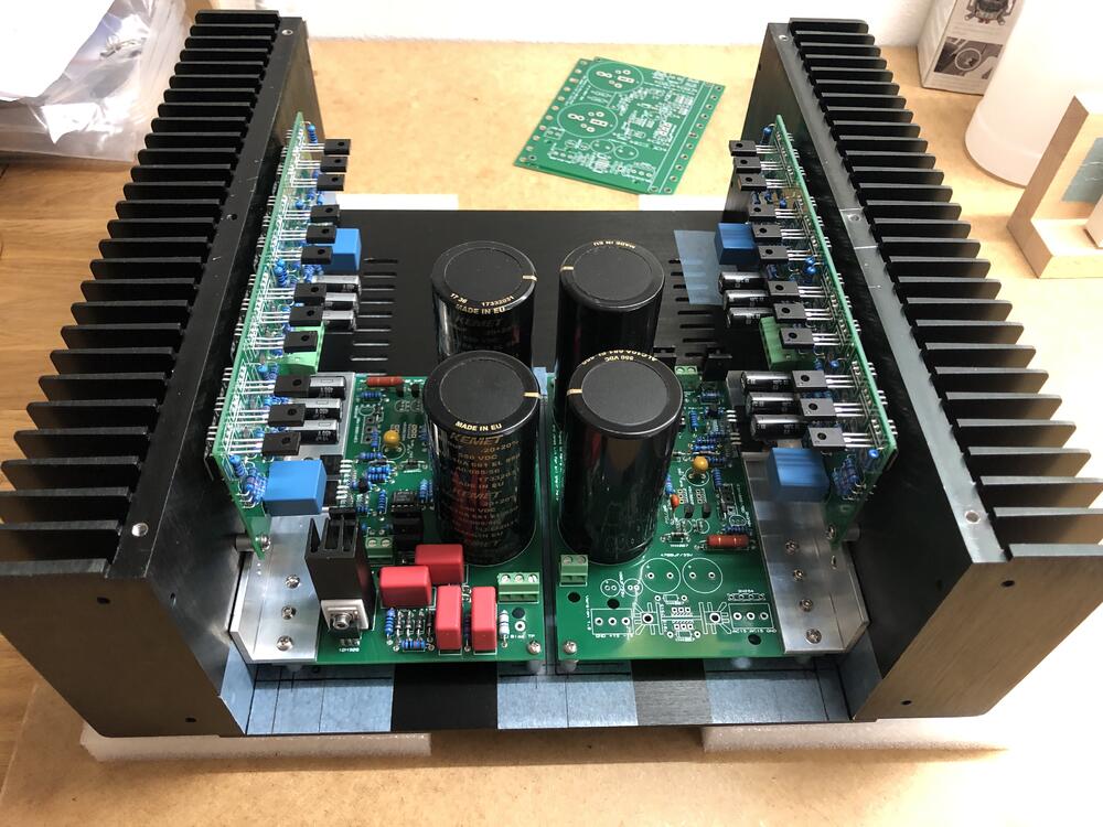

starcat Posted July 31, 2021 Report Posted July 31, 2021 Moving forward with the CFAE, drilled the bottom and completely mounted the toroid and GRHV. The C2M1000170D's are still missing. Probably I should replace them with the C3M0350120D. New front and back panels next. 2 Quote
