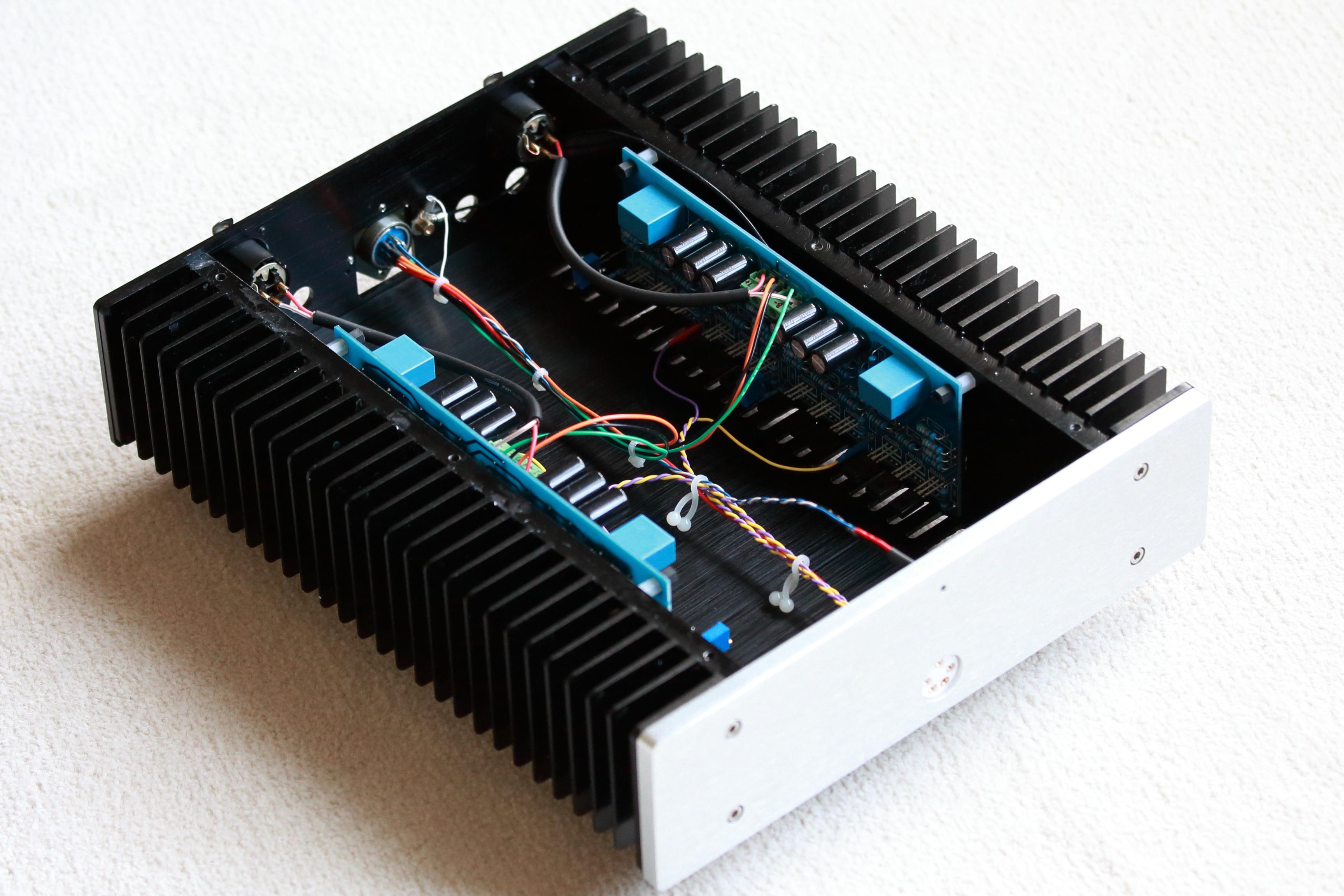

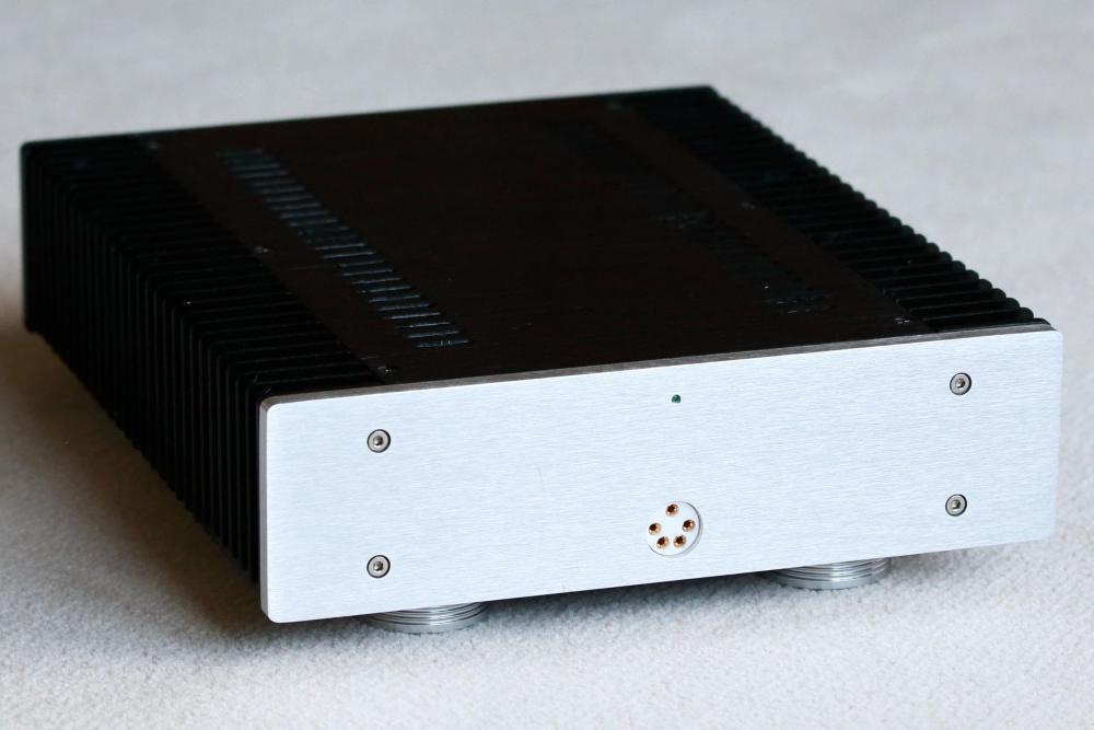

mwl168 Posted August 25, 2019 Report Posted August 25, 2019 Finally cased my ES CFA amp. Returned the bias resistors to 1M with the larger heatsinks. Running 20mA bias for the output sections. 10 Quote
joehpj Posted August 30, 2019 Report Posted August 30, 2019 On 8/26/2019 at 12:16 AM, mwl168 said: Finally cased my ES CFA amp. Returned the bias resistors to 1M with the larger heatsinks. Running 20mA bias for the output section. It was quite hot in this size with that current of my build. Is your amp running hot too? Quote
mwl168 Posted August 31, 2019 Report Posted August 31, 2019 8 hours ago, joehpj said: It was quite hot in this size with that current of my build. Is your amp running hot too? Where I live, the ambient temperature at this time (end of August) is around 70 F, about 22 Celsius. The heatsink temperature of the amp gets to about 45C fully warmed-up. When I first cased the amp, the ambient temperature was around 27 Celsius and the heatsink was ~ 48C not quite 50. I can see the heatsink hit high 50's C in Taiwan where the ambient temperature can easily hit low to mid 30's C this time of the year. Quote
soundwave Posted September 13, 2019 Report Posted September 13, 2019 Stax DIY newbie here. Great looking amp @mwl168 A couple of questions if I may: 1. This is probably a stupid question, but how do you adjust the volume on this amp? ? 2. What are the width and depth of this chassis? Is the front plate available also in black? 3. Roughly how much did this cost? Quote
mwl168 Posted September 13, 2019 Report Posted September 13, 2019 (edited) 1. I use the digital volume on my DAC but you can easily add a volume control to the amp. 2. This chassis I use is quite small - dimension is 160mm x 70mm x 311mm. It's only for the amp circuits and you cannot fit the entire amp in it. There is a PSU in a separate chassis. As an example, you should be able to fit the entire amp including the PSU in a chassis like this. 3. My rough estimate for parts alone would be about $700 US that also covers chassis, transformer, connectors, wires and a reasonable 4-gang volume pot. Like most things these days, labor is the biggest investment. Cost can escalate quickly if you start getting into fancy chassis, volume pot and boutique parts (resistors, capacitors, wires, etc.). Edited September 13, 2019 by mwl168 1 Quote

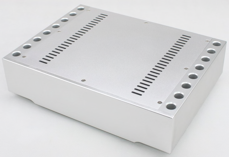

starcat Posted March 3, 2021 Report Posted March 3, 2021 (edited) This looks like a very nice case for a dual chassis design for the static CFA3. PSU chassis: mount the kgsshvpssicfetsinglenewrightsws and kgsshvpssicfetsinglenewleftsws GRHV boards on the sinks together with goldenreference6d GRLV in the middle/front and a transformer in the middle/back. Might be even room for two GRLV and two transformers for total symmetry. Amp chassis: two balanced CFA3 boards mounted on the sinks. Will be pretty empty in the middle. The internal hight of 73mm might get tight but probably enough to fit the 63.5mm wide balanced boards; or mount them horizontally with some L-brackets. What do you think? I think I might go for it. Chassis dimensions in mm are: outside W360xD270xH86, inside W280xD255xH73 Or just use single chassis with both CFA3 boards mounted on the sinks and a kgbhultraminipsv4 board in the midfront and a transformer in the midback. Edited March 3, 2021 by starcat Quote

jose Posted March 3, 2021 Report Posted March 3, 2021 CFAe runs hot, VERY hot. I would prefer a "normal" heatsink... 1 Quote

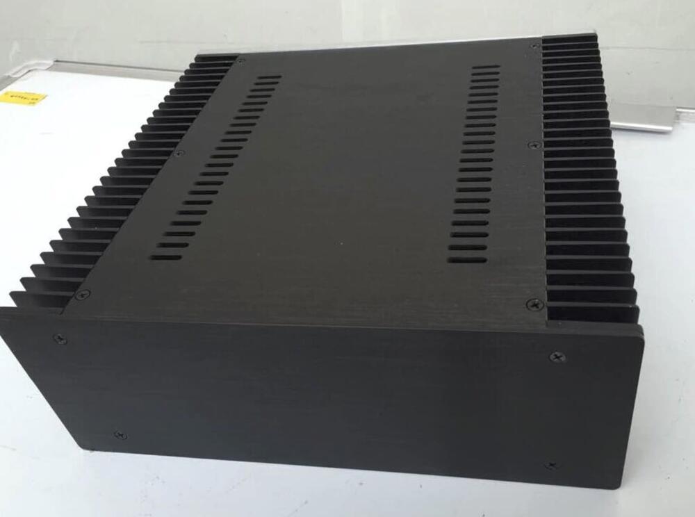

starcat Posted March 3, 2021 Report Posted March 3, 2021 Hmm, you might be right Jose, but the fins of the small enclosure Michael used above doesn't look like being much more of actual real estate... Btw, which one is it exactly? This might fit in the two balanced boards, the BH mini PSU and a transformer in the back. Bit too high probably but for the sake of bigger sinks. Chassis dimensions in mm are: outside W320xD315xH120, inside W220xD300xH112 1 Quote
