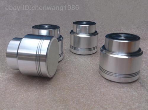

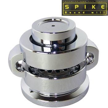

I found some of these feet at hifi collective. They are not crazy money and look well made. My only worry may be stray magnetic fields as the structure looks open.
Others are available but more money, more than I would pay. Has anyone tried a Mag Lev support for their gear?
These on Ebay are cheap. I would need 5 per speaker.
Clear Audio feet, but only take 4K per feet. Not enough for speakers.

I've certainly toyed with the idea before. The problem is that you cannot passively magnetically levitate something (actually not true - see below), so all the audio feet have a tie-wire or guide rod to maintain stability. Which adds a bit of friction, so it is never truly maglev.
The Japanese train uses dynamic control to keep it stable in the air - and you have to be darned sure of the control systems!
