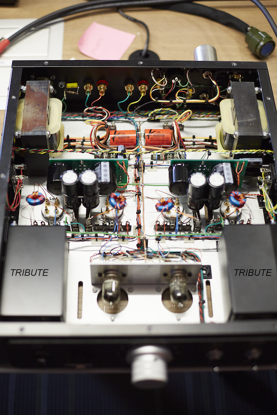

mtoc Posted July 8, 2016 Report Posted July 8, 2016 someone posted a pic of the $7k amp, spent me a few minutes to dig it up. input and output both using transformers. Quote
kevin gilmore Posted July 8, 2016 Report Posted July 8, 2016 capacitors floating in air filament transformers also floating in air with chipamp drive circuits not really a headphone amp is it. Quote
bozebuttons Posted July 8, 2016 Report Posted July 8, 2016 41 minutes ago, kevin gilmore said: capacitors floating in air filament transformers also floating in air with chipamp drive circuits not really a headphone amp is it. Studio Headphone/Speaker amp. Quote
wink Posted July 8, 2016 Report Posted July 8, 2016 So, what did you expect for $7k amp, quality, perhaps..? Quote

mtoc Posted July 10, 2016 Report Posted July 10, 2016 Btw, that $7k amp is single-end essentially, although using some input transformers to convert the signal to balanced, long live single end tube stuff (some tell me with tubes you can't go balance without breaking the bank). I remember one of kevin's designing ideals is avoiding any transformers in the signal paths. Quote

kevin gilmore Posted July 10, 2016 Report Posted July 10, 2016 (edited) 1 hour ago, mtoc said: Btw, that $7k amp is single-end essentially, although using some input transformers to convert the signal to balanced, long live single end tube stuff (some tell me with tubes you can't go balance without breaking the bank). I remember one of kevin's designing ideals is avoiding any transformers in the signal paths. I read some of what you have written elsewhere, and its becoming clear you don't have any idea what you are talking about. The apex amplifier linked to above is a single ended amplifier, that is there is a single output tube driving an gapped output transformer that carries the full dc of the power supply. The rise time and fall time of the output signal is not the same. The eddie current tube amp pictured above is a push pull amplifier with 2 output tubes per channel. The output transformer is not gapped, and there is no dc in the transformer. The rise and fall time of the output signal is the same. In fact with both input and output transformers, that amplifier can be considered as fully balanced, and fully differential. Big difference in the kind of sounds that these amplifiers make. Now, since a couple have sent me emails about the black widow, here is my explanation of whats wrong with the picture above. Now maybe in the 2 box version the board had to be that size, and was obviously stuffed into a box of a specific size. But designing that way is stupid. In the single box there is all sorts of room to make the board bigger and do a much higher quality layout with better and bigger heatsinks, and having the left and right channels be absolutely identical. The worst offender of differences in left and right channel layout was the melos, but the liquid fire, liquid lightning and especially the liquid glass are in the running. The power supply board is obviously new, full ground plane on top, suitably sized heatsinks secured to the board etc, why use an amplifier from 2007. The stax mafia can (and probably should) do a much better layout with larger heatsinks, identical channels etc. There is absolutely nothing unique about the circuit design. If its going to be eye candy on the outside, it really needs to be eye candy on the inside if its going to command a premium price. Edited July 10, 2016 by kevin gilmore 2 Quote
PretentiousFood Posted July 10, 2016 Report Posted July 10, 2016 24 minutes ago, kevin gilmore said: The eddie current tube amp pictured above is a push pull amplifier with 2 output tubes per channel. Parallel SE, they say. Balanced in with an input transformer, single ended gain stage, interstage transformer, parallel single ended output stage, floating secondary for "balanced" output. Quote
kevin gilmore Posted July 10, 2016 Report Posted July 10, 2016 Sure looks like 4 input wires and 2 output wires to the transformer, but what do I know. parallel dual single ended output stage sounds like push pull to me. Quote
