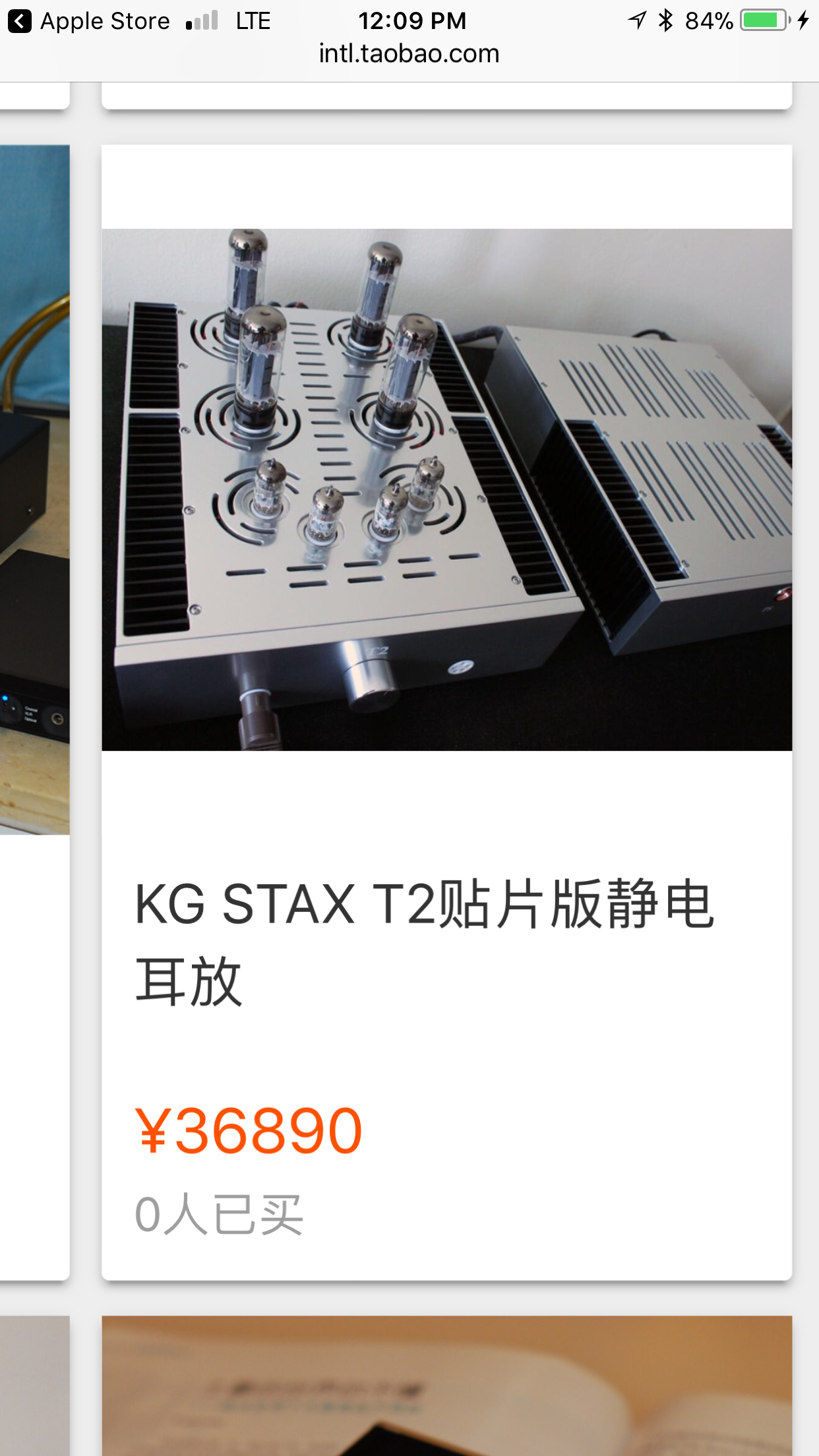

Laowei Posted November 6, 2017 Report Posted November 6, 2017 Shit, there’s even a faked Kerry built T2! 1 1
spritzer Posted November 6, 2017 Author Report Posted November 6, 2017 Nope, those are his pics. It's a fake listing... 1

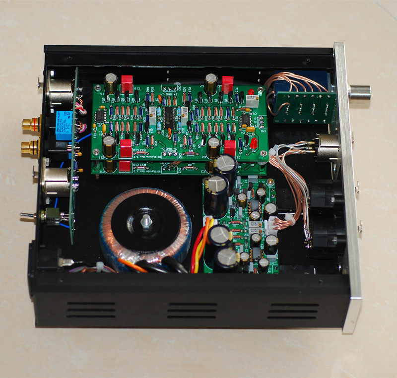

dcpoor Posted November 6, 2017 Report Posted November 6, 2017 Their dynalo mk2 is tempting for the price. lol https://item.taobao.com/item.htm?spm=a1z10.1-c.w4004-2626060199.28.362e04f1hau2JY&id=548593598961 how does the power supply in this thing look?
kevin gilmore Posted November 6, 2017 Report Posted November 6, 2017 (edited) Those are a clone of my older boards, but a different power supply. For the price looks like a great deal. Looks well built sanded off chips in the power supply a nice touch Edited November 6, 2017 by kevin gilmore

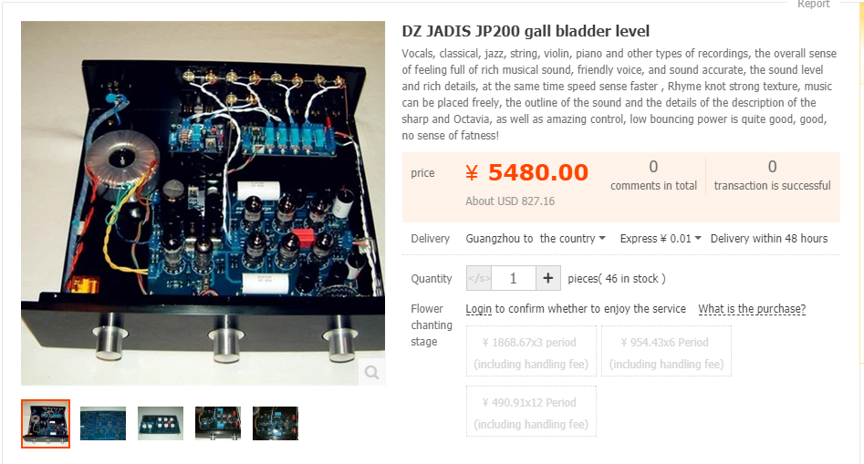

skullguise Posted November 6, 2017 Report Posted November 6, 2017 Browsing the site, finding some interesting things. Thanks to Google Translate, I now have a new build level to always shoot for: 1 3
penmarker Posted November 7, 2017 Report Posted November 7, 2017 37 minutes ago, mwl168 said: "gall bladder" level? WTF? Its the Google Translate doing its magic. IIRC transformers are translated into "cows". I've bought a Naim NAP200 assembled board once. They replaced all polystyrene caps with mica and the 2922 are fakes - among others. In retrospect, for the amount of work needed to redo the thing I should've started with a blank board.
Pars Posted November 7, 2017 Report Posted November 7, 2017 3 hours ago, kevin gilmore said: Those are a clone of my older boards, but a different power supply. For the price looks like a great deal. Looks well built sanded off chips in the power supply a nice touch The power supply looks like it could be a goldenreference clone? Different layout, and nice touch with the chips as you noted. Makes me long for the beautiful beautiful music!
kevin gilmore Posted November 7, 2017 Report Posted November 7, 2017 (edited) yes its a goldenreference clone, but without the lt1010 reference chips. So they went with something a bunch cheaper for the reference. also they turned the tantalum into electrolytic which adds a bit more noise. still for the price, I can't even buy all the parts the way I build them for what they are selling it for. Edited November 7, 2017 by kevin gilmore
mwl168 Posted November 7, 2017 Report Posted November 7, 2017 (edited) 4 hours ago, skullguise said: Browsing the site, finding some interesting things. Thanks to Google Translate, I now have a new build level to always shoot for: All joke aside, although I could not find the original ad at TaoBao, I bet the "gall bladder" translation comes from that Chinese often refer to vacuum tube as "gall bladder",akin to what we sometimes refer to vacuum tube as "valve". Has been the case as long as I could remember. Edited November 7, 2017 by mwl168
joehpj Posted November 7, 2017 Report Posted November 7, 2017 Yes. Chinese often call tubes as "gall bladder". It's just one word in Chinese. As an abbreviation.
